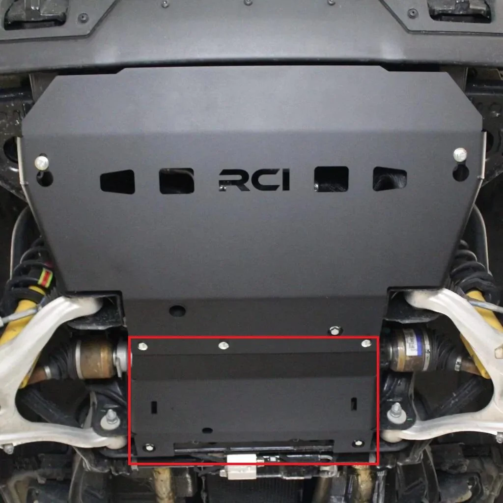

I noticed my Ronin weeped after install when I did the next oil change. Strange though i've done about 5 oil changes since then and no weeping... Amsoil Signature 5W30
Mine weeped "always" and I like the double o-ring design on the UPR, just not that I have to drop the skids.
I have too many projects to complete on the Bronco, but I plan to fab a plate with 3 welded nuts to allow for the mid-skid to be dropped without having to remove the entire front skid. I have the RCI aluminum skids that for the front skids is two parts.
They use carriage bolts at the front of the back skid (circled in red) and it would be difficult at best to reach the middle one. I plan to grab some 3/8" socket button head bolts to replace them and with the plate that I will fab (2" x 1/4" x 12" or so) it will make that process much easier.
Ford Bronco Under engine armor, Oil drain RCI
