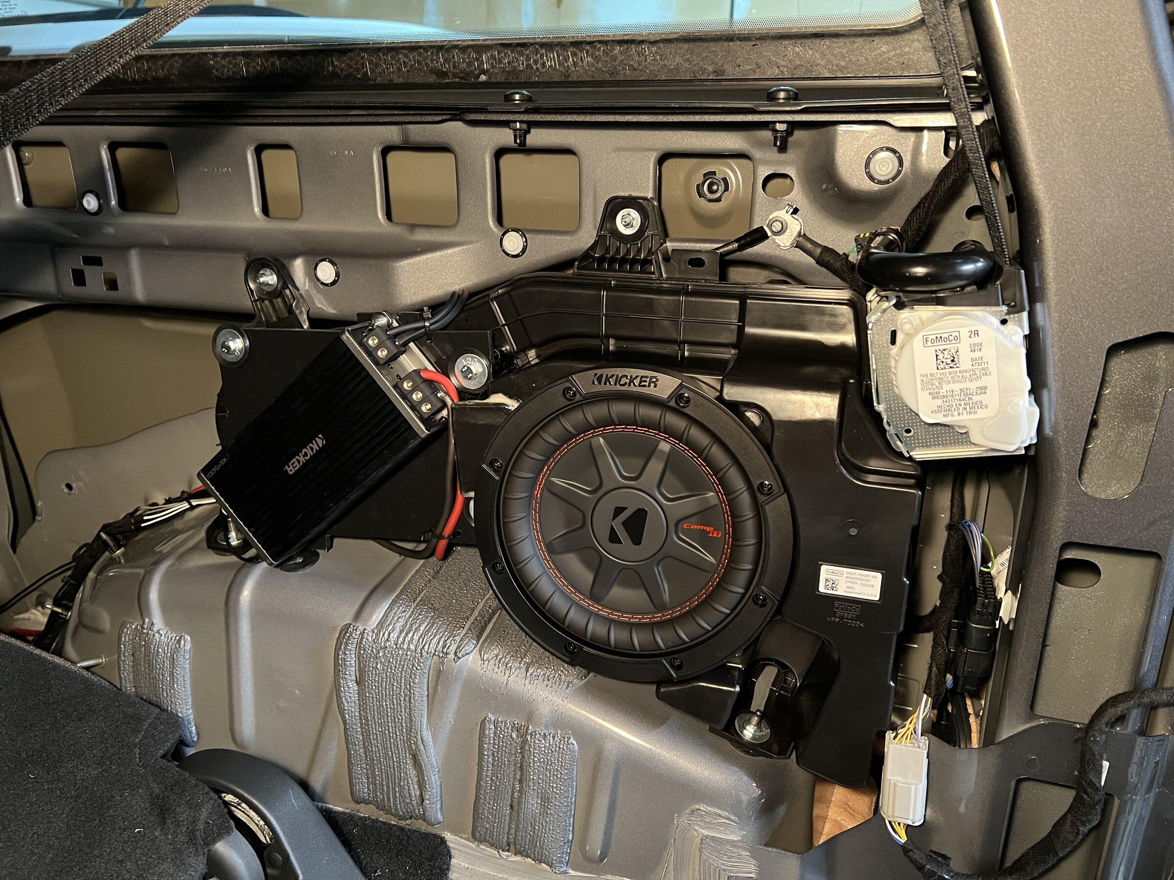

Finally, some pics where someone mounted pod tweeters. Did you have any issue with this mounting location? Does it rattle at all with midrange beneath the grill, etc?After 2 weeks I finally finished installing my 1000watt JVC amp, dual 12 inch kicker comp c in a 32/17/16 ported enclosure (with a bass knob), Pioneer 4inch TS-G400 in each dash corner and rear pods, and 6 3/4 inch Kicker 46CSS674 in the (ironically) kick panels. I hope the amp installment can give some ideas. Feel free to ask any questions.![]()
Didn’t have any rattle at all. Highly recommend it, as it really fills in the top end of the EQ very well across the whole car. I just ran the wiring directly down the kick panel and under dash, took some persuasion but there’s a clear cut path.Finally, some pics where someone mounted pod tweeters. Did you have any issue with this mounting location? Does it rattle at all with midrange beneath the grill, etc?
Awesome, I feel like that is a much easier way that mounting on the a pillar with ducts and airbags. Appreciate the feedback! It looks fantastic.Didn’t have any rattle at all. Highly recommend it, as it really fills in the top end of the EQ very well across the whole car. I just ran the wiring directly down the kick panel and under dash, took some persuasion but there’s a clear cut path.
