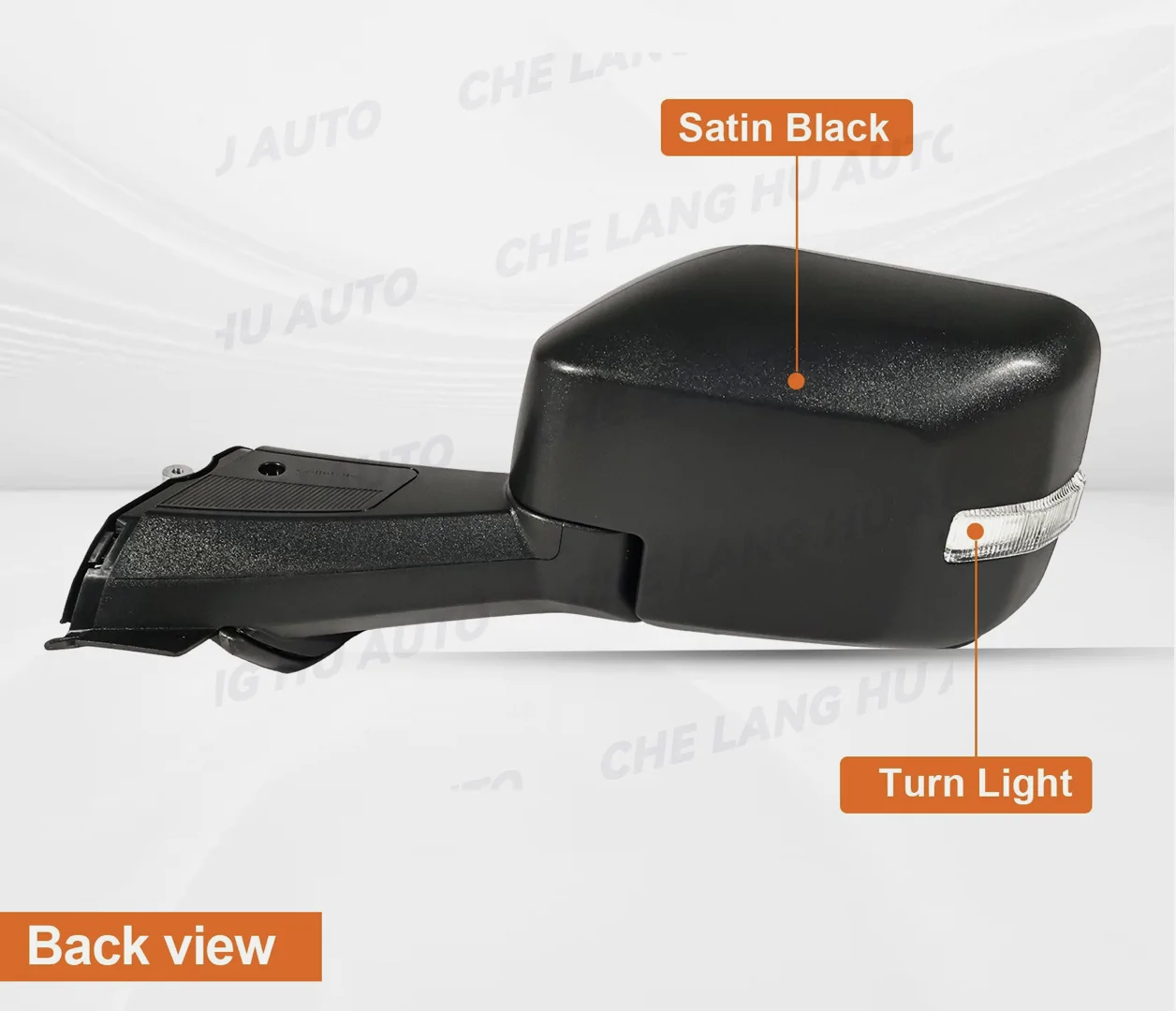

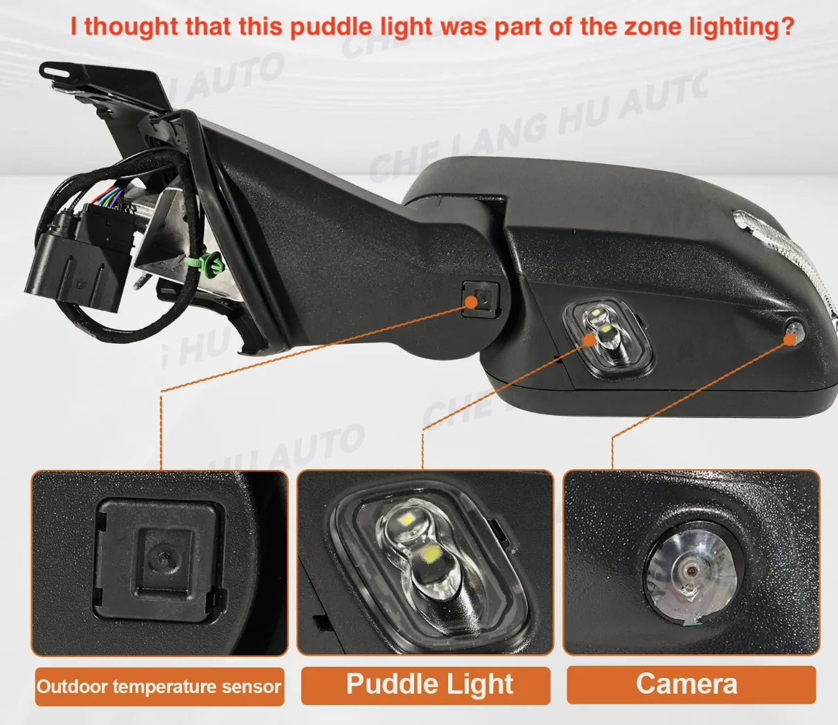

I had the same question in reference to the side mirrors. Someone did not like our Bronco as they took a hammer or something similar and damaged our drivers side mirror beyond repair and it is DOA. While looking for a drivers side mirror replacement I came across these:
Ford Bronco Two questions Screenshot 2026-05-10 at 2.06.31 PM
Ford Bronco Two questions Screenshot 2026-05-10 at 2.07.15 PM

,that's part of the the "zone lighting " lights up all around the truck if you want
they got rid of it on the mirrors in 2026, (along with the garage door opener in the visor and auto dim rear view mirror on some of the higher trims?? )

Part of LUX package, or whatever it’s called these days, if they even offer it anymore.

Puddle light
Ford Bronco Two questions Screenshot 2026-05-10 at 2.22.59 PM

1) I noticed in the video of the Bronco factory build process - they show "integrated" turn signal lights on the mirror. I just got a 2026 OB and it does not have them. When did they take them out and was there a reason? Seems like it would be mandatory for safety.....
Those white lenses on the ends of some Broncos mirrors are white spot lights, not turn signals, controlled by a switch near the headlight switch. Their usefulness is very limited tho, because they deactivate automatically above 6 mph for regulatory reasons.
US and Canadian regulations to not require turn signals located on the front fenders or side mirrors, They are merely optional here. But in Europe and China, turn signals on the fender or mirror are mandated. Thus some cars, like Ford Focus and C-max, that sold in both NA and European markets did have turn signal lights in the mirrors of US cars.
I think part of the confusion is that Ford used the base part number (-13B374/5-) for the Bronco’s spot lights that is the same as the base part number typically used for mirror turn signals (e.g. Focus, C-Max), so the part databases call them “turn signals“ even tho they are just spot lights.
