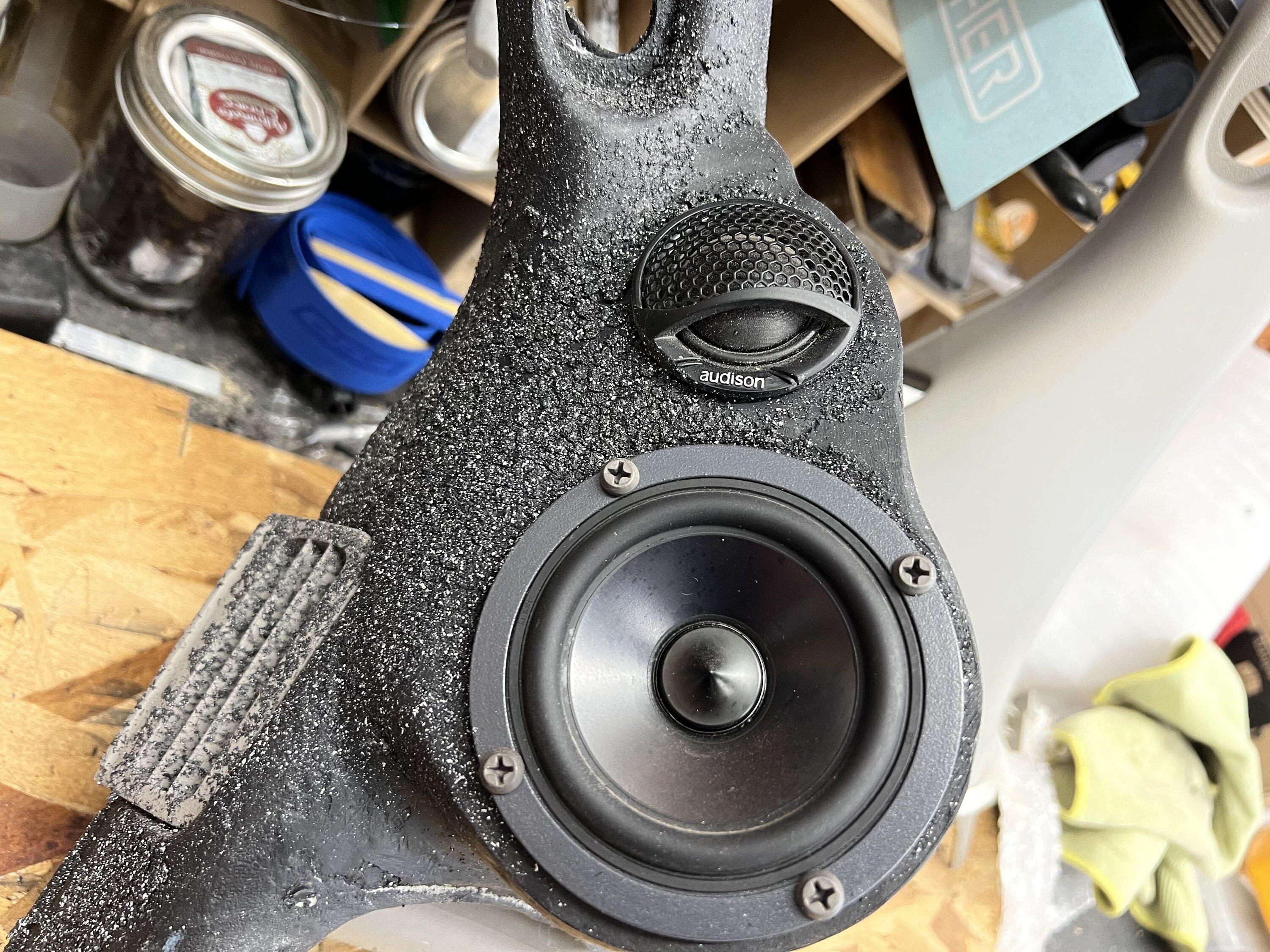

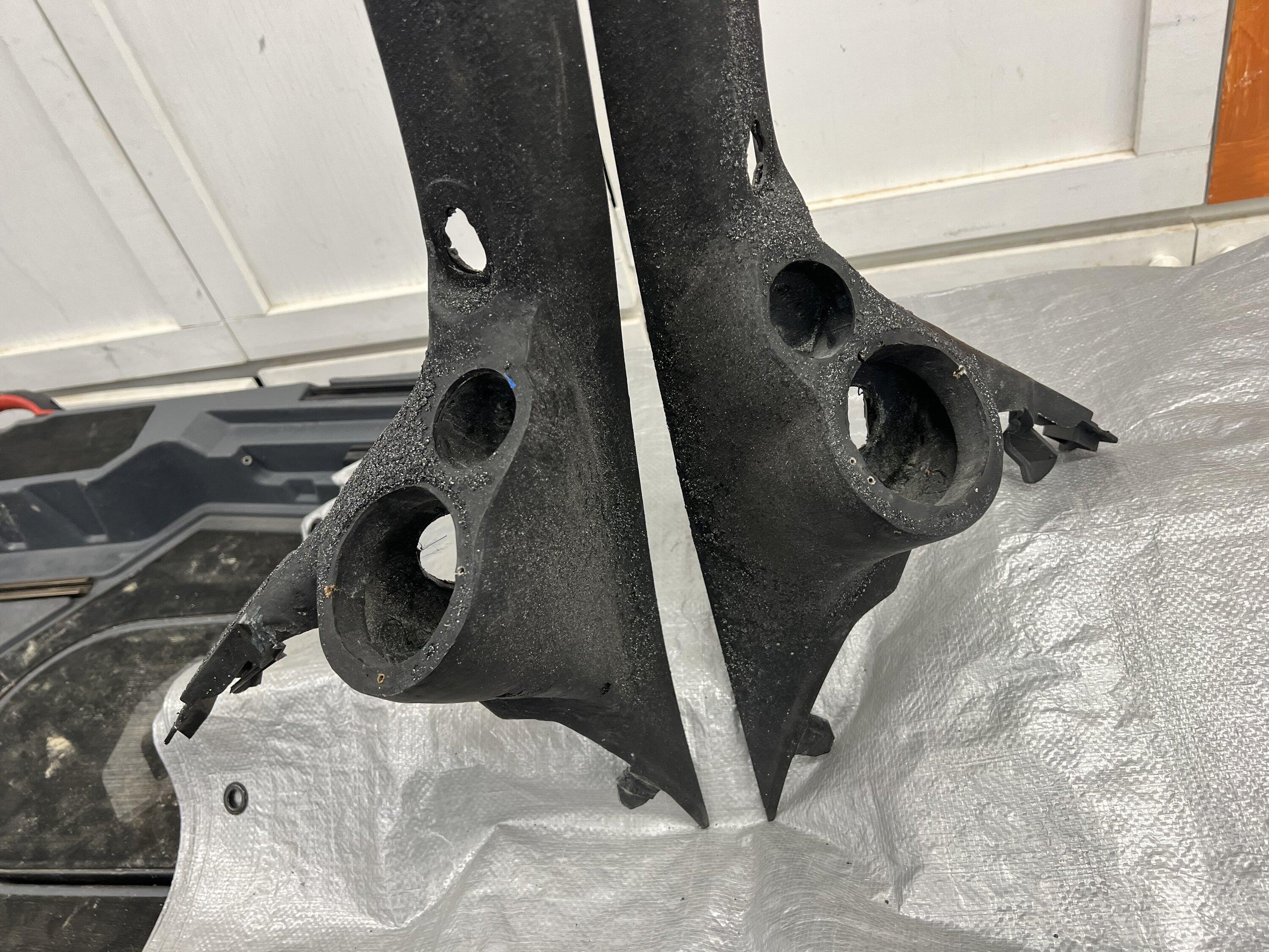

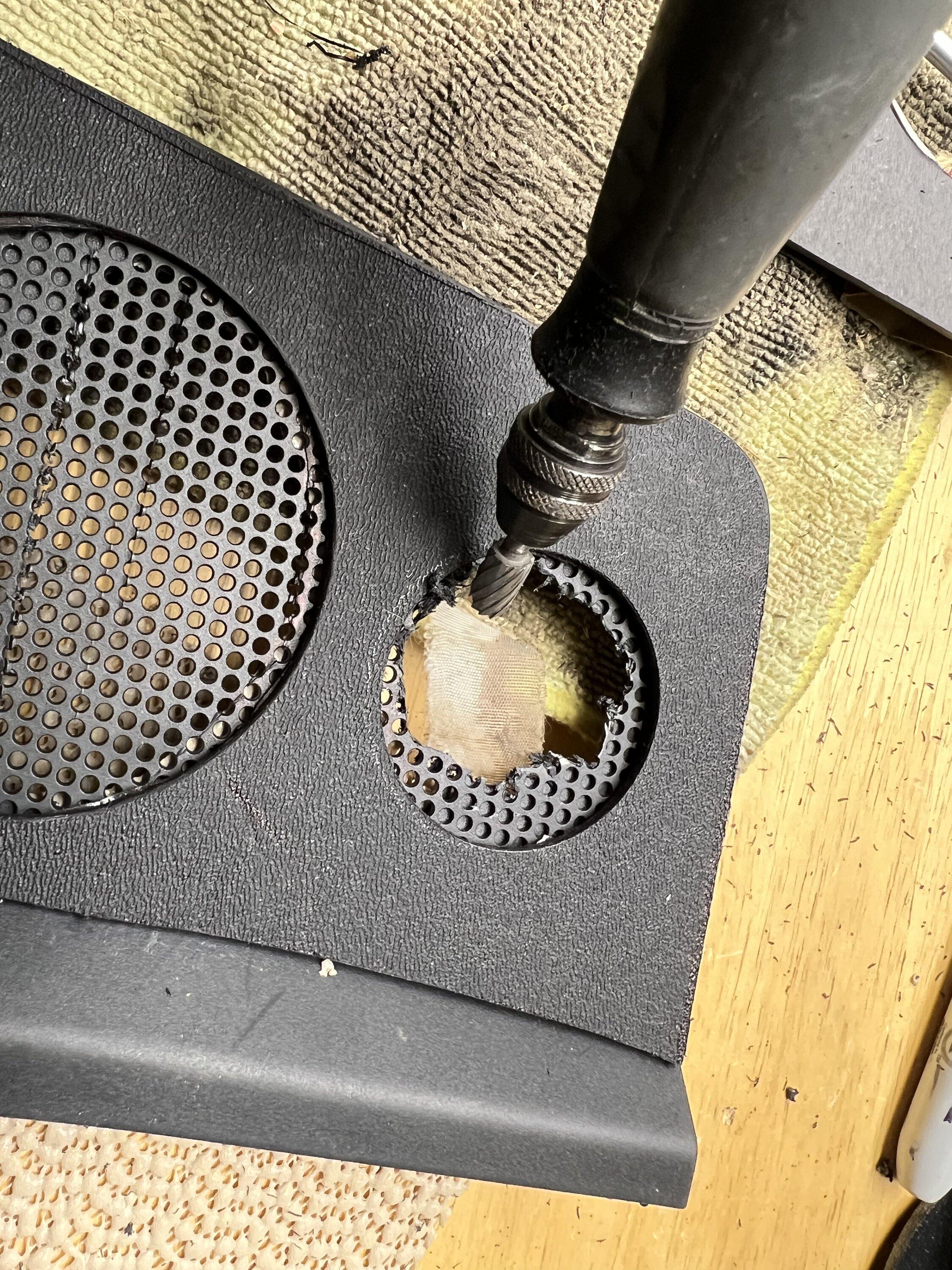

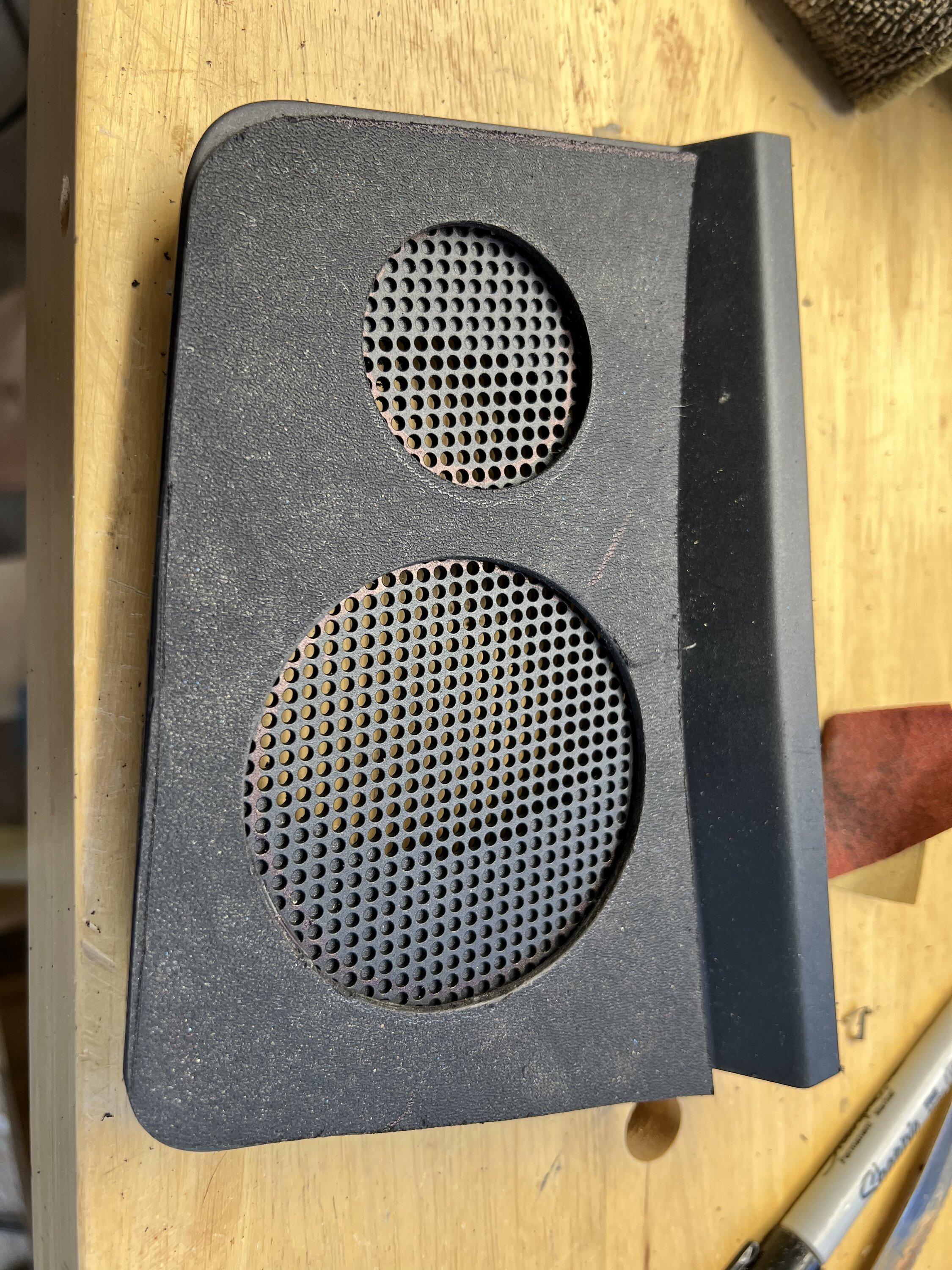

I did in my Xterra and was phenomenal sound 600$ set of mid/ twees lots of work sanding forever ! Was it worth it
I say , Yes i used laser to pin point direction from both pairs
In Bronco there is airbag jot sure how much room there is

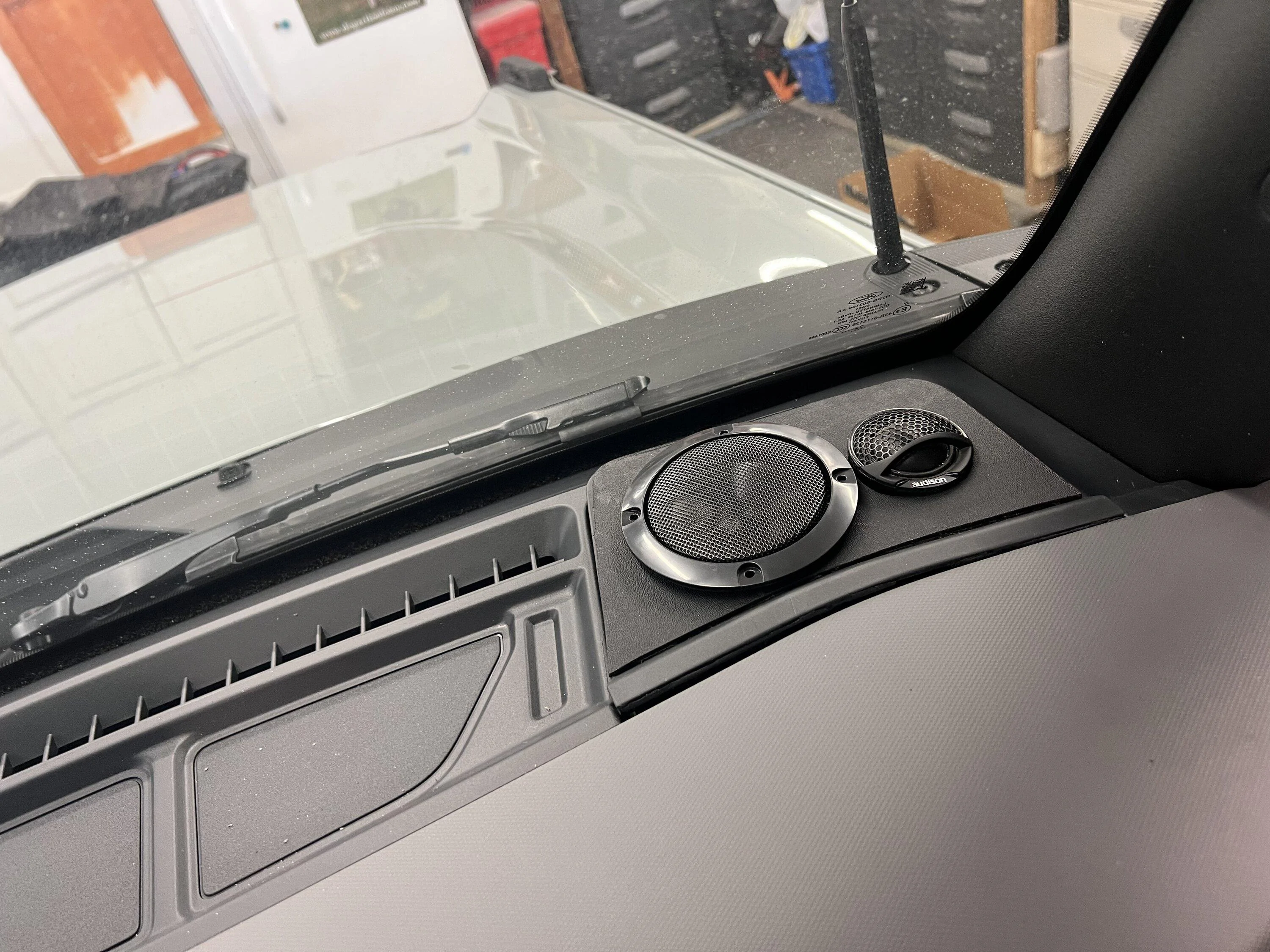

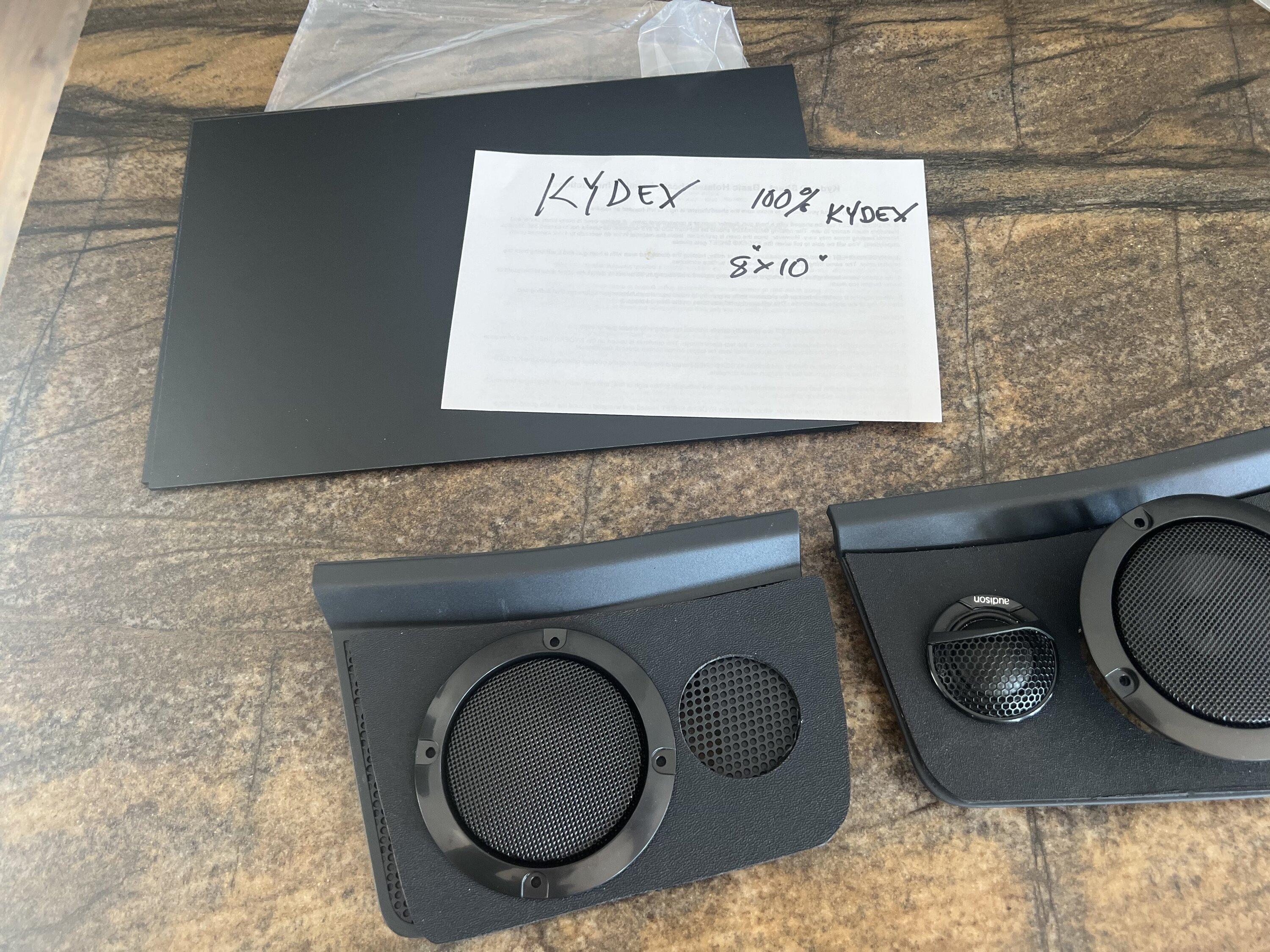

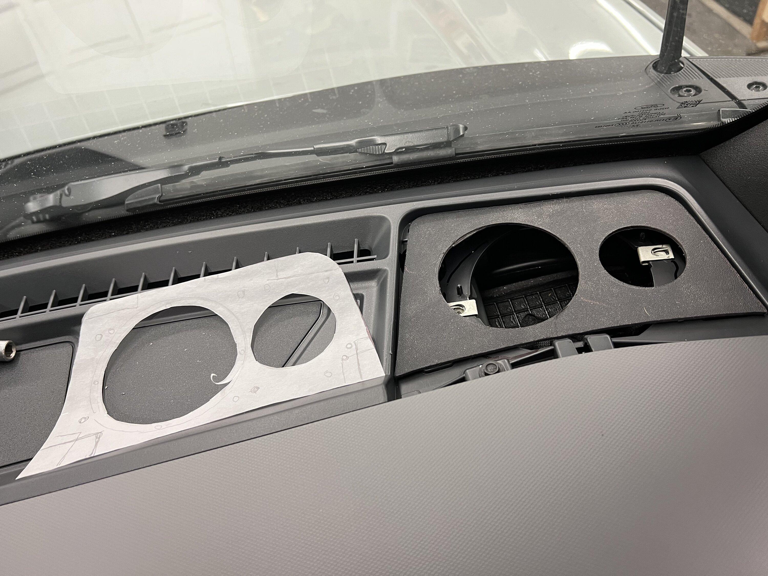

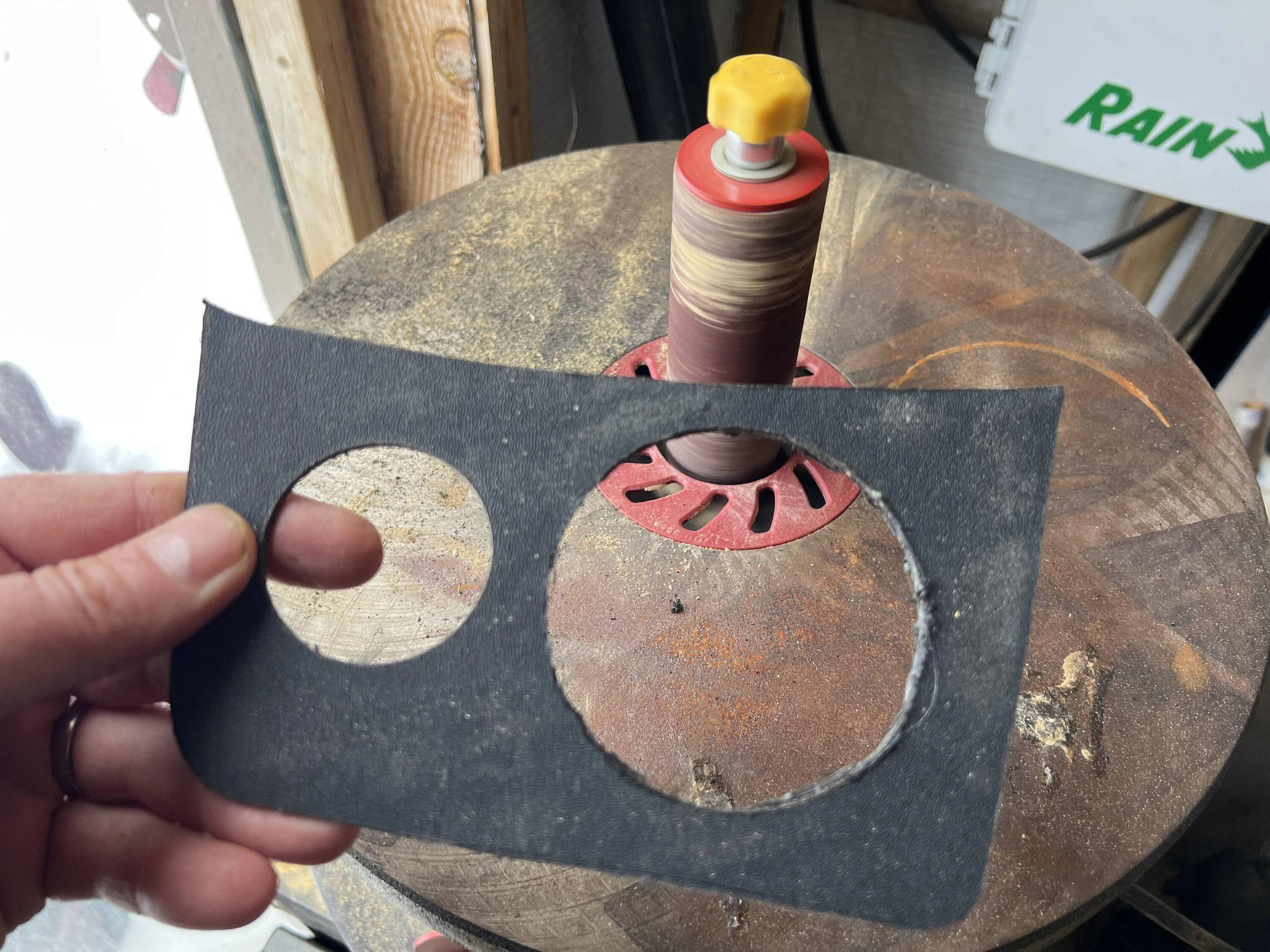

I just finished nice 3Way mod in my dash fabricating plates for same pair of tweeters and mids
