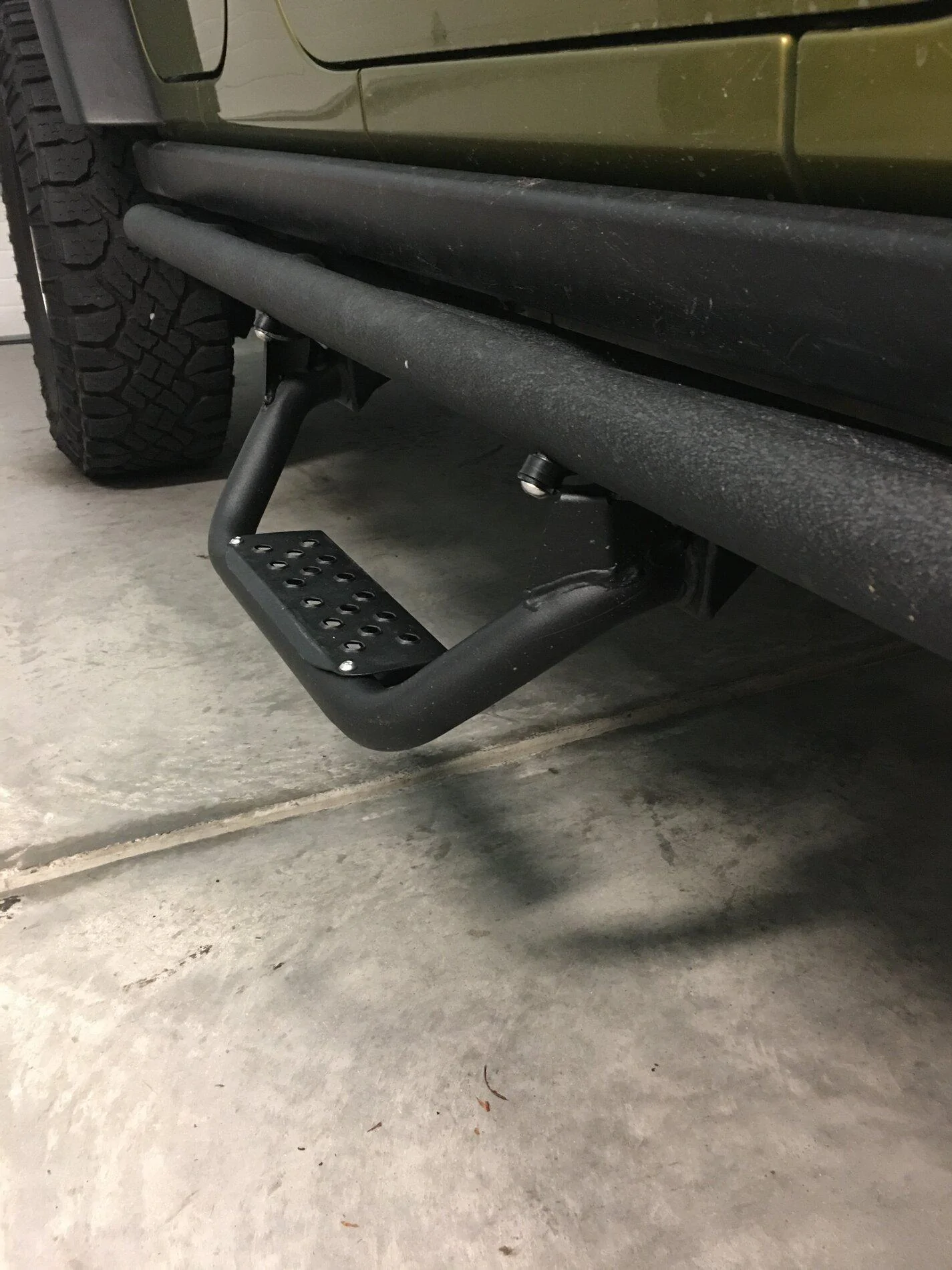

I left my Rubirails on just for looks when I put the rock sliders on which makes if hard to use as a step. Also in the picture is the GoRhino step I bent slightly and installed using nutserts and some delrin bushings, so I can remove it when wheeling.
