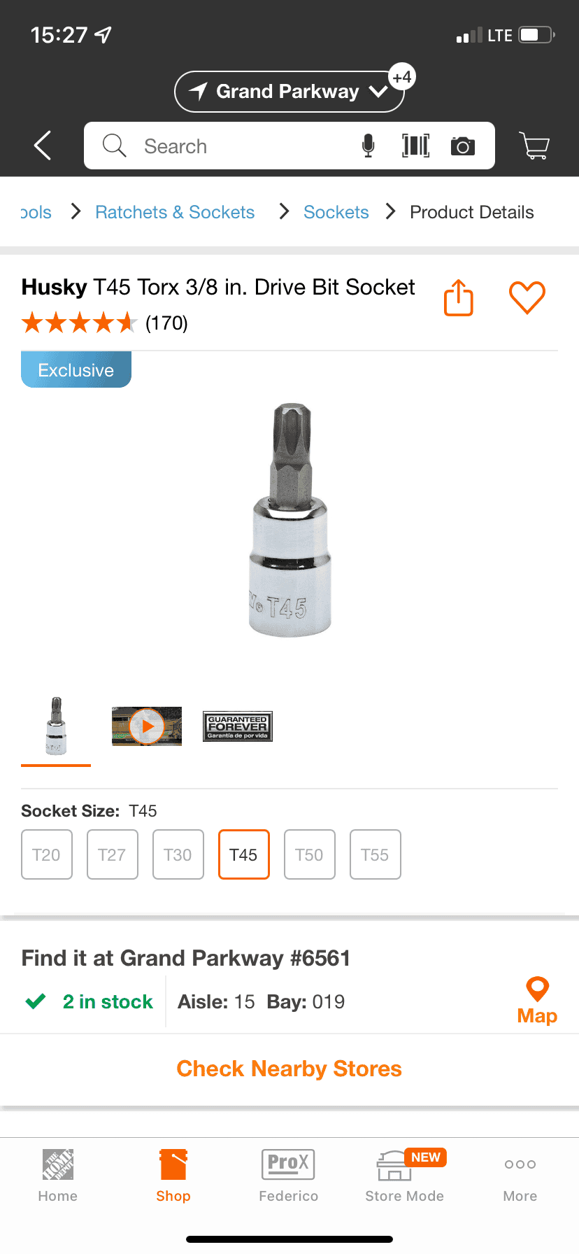

Hi here is a video of a guy that uses the T plus Tork bits
I understand but there is thread that also says 45 torx and having both for mine, the one that helped me was the regular one.
This is what I bought and was perfect match. Didn't have any issue :)
