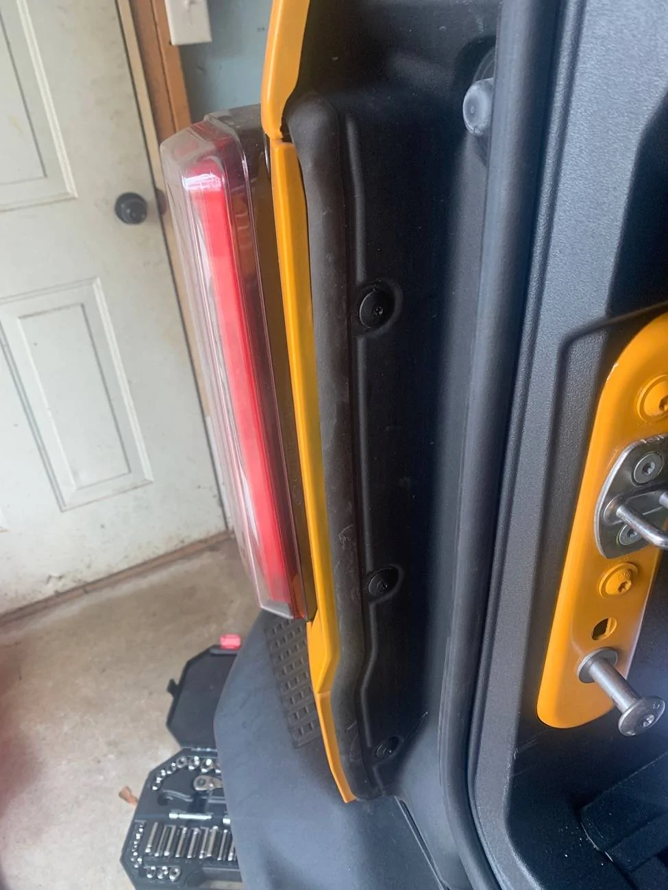

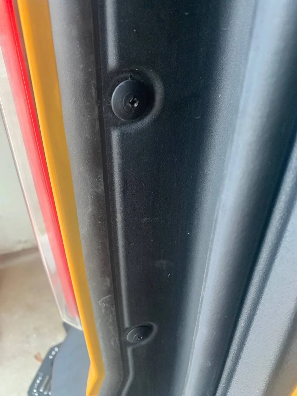

I’m installing a curt wiring harness. I need to remove the trim to access my taillights. There are 4 Phillips trim fastener screws that need to be removed initially.
they just spin and won’t pop out with force. How do I remove them please?
Thanks.

Sometimes i've had to apply upward pressure on the whole faster (pry up) to get the screw to back out.

Apply upward pressure to the underside of the whole collar while using a Phillips with almost zero pressure to unscrew the center plug. Just have to distort the channel enough for the plastic threads of the center plug to gain traction. Worst case just pry it out with your trim tool

I had already tried applied pressure to the screws and collar but it did NOT work. I’ll try that again later and maybe it will magically work. Thanks

It's not really a screw in the center - it's flimsy plastic. It's more like a drywall anchor, or the old push-pin style fender brackets. They just thought for some stupid reason that being able to unscrew the post rather than pop it out was better... Except the inner threads don't hold worth a crap and they just sit there and spin in a stripped out hole.
Take a small screwdriver or knife to get an edge of the inner screw head lifted up a bit. Use pliers or a prybar (the metal red-handled one in the kit @Wolford678 linked is perfect for this and exactly what I use) and pry the screw out of the inside of the fastener. You won't break it.
Do not try to just pry the entire fastener out of the hole without removing the inner screw part first - some of those posts they are installed on behind there are just flimsy aluminum tags and you can bend the crap out of them.
Once the screw is out of the center (or at least halfway out), the outer piece pops right out.
If you get one that's really really stuck - I have heated up a Phillips head screwdriver with a lighter, pushed and melted it into the plastic head, and got them out that way too - but that's kind of a last resort type thing.
When installing them, you don't need to screw them in at all - just push the screw down in.
The Phillips heads on those things are maddening and I have been replacing them with regular push-pin style every chance I get.

The heating tip is genius for the one I striped the Phillips part. I’m going try to lift the anchor with a knife and rip it out with pliers right now.
Using a small pen knife to lift the screws and up and a screw driver to rip it out worked! Thank you so much man. I was seriously loosing it.
