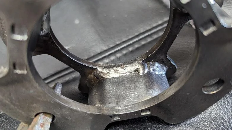

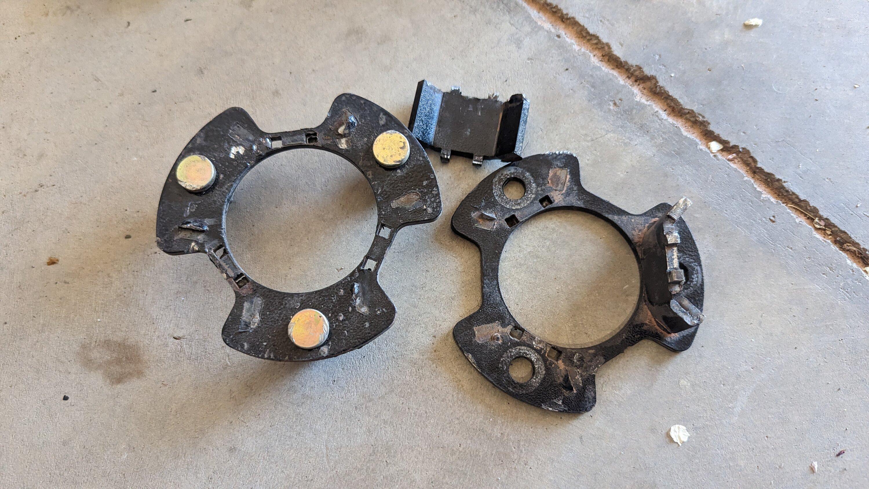

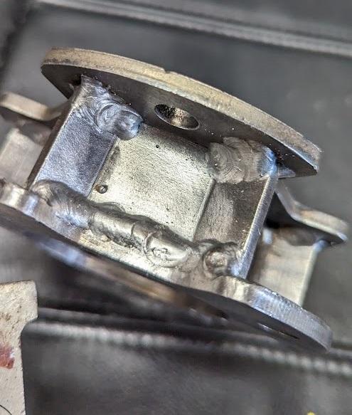

So I'm cooking up a kit to run regular coilovers instead of ones with Bronco-specific top hats, but in the meantime I have the Stampede in less than 3 weeks so I ordered up some cheap spacers again. This time I'm going to reweld them before installation. It wasn't my preference but it's quick.
Just a couple more tack welds that's all

It's not my finest work but the spacers should hold together now.

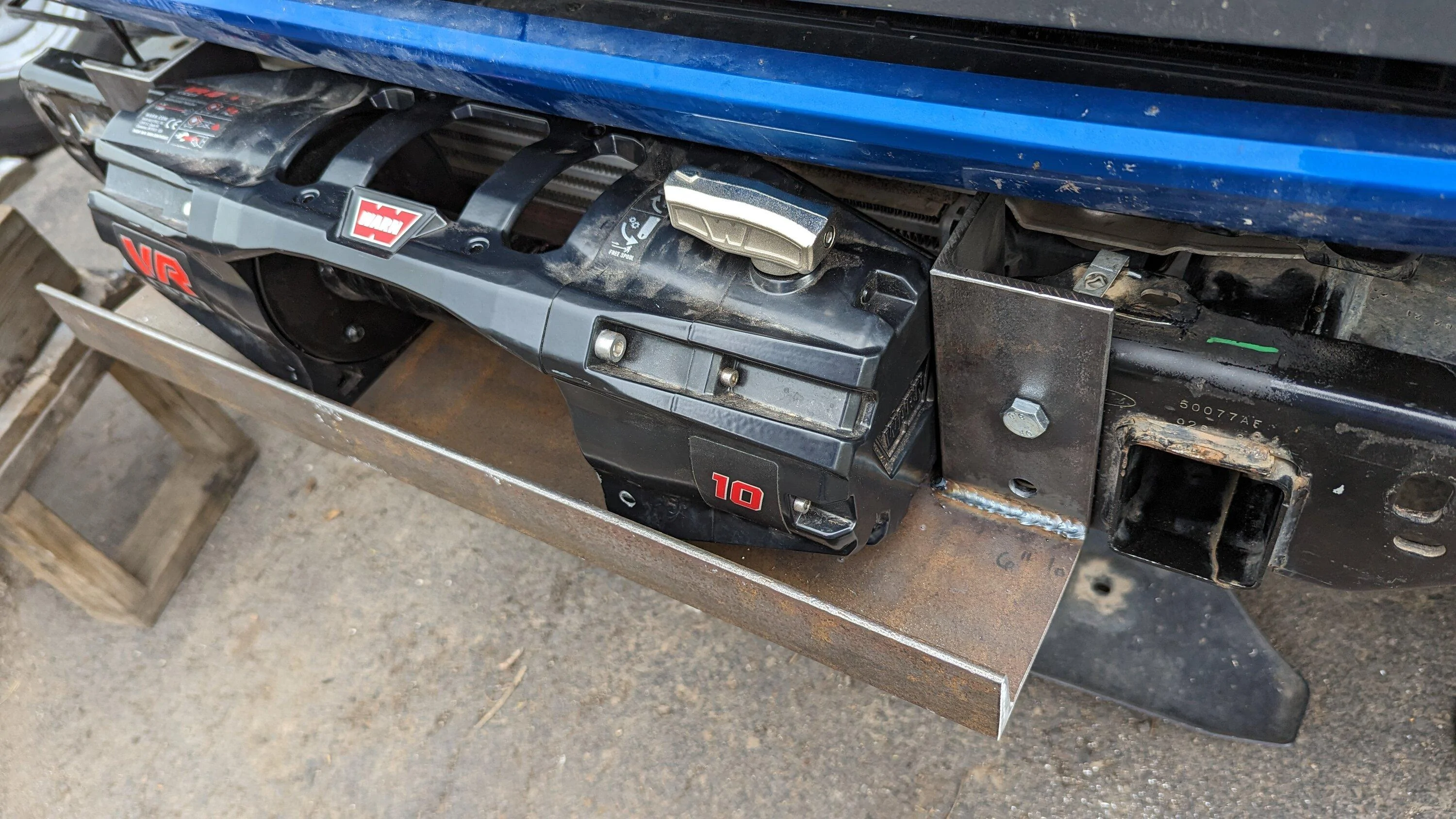

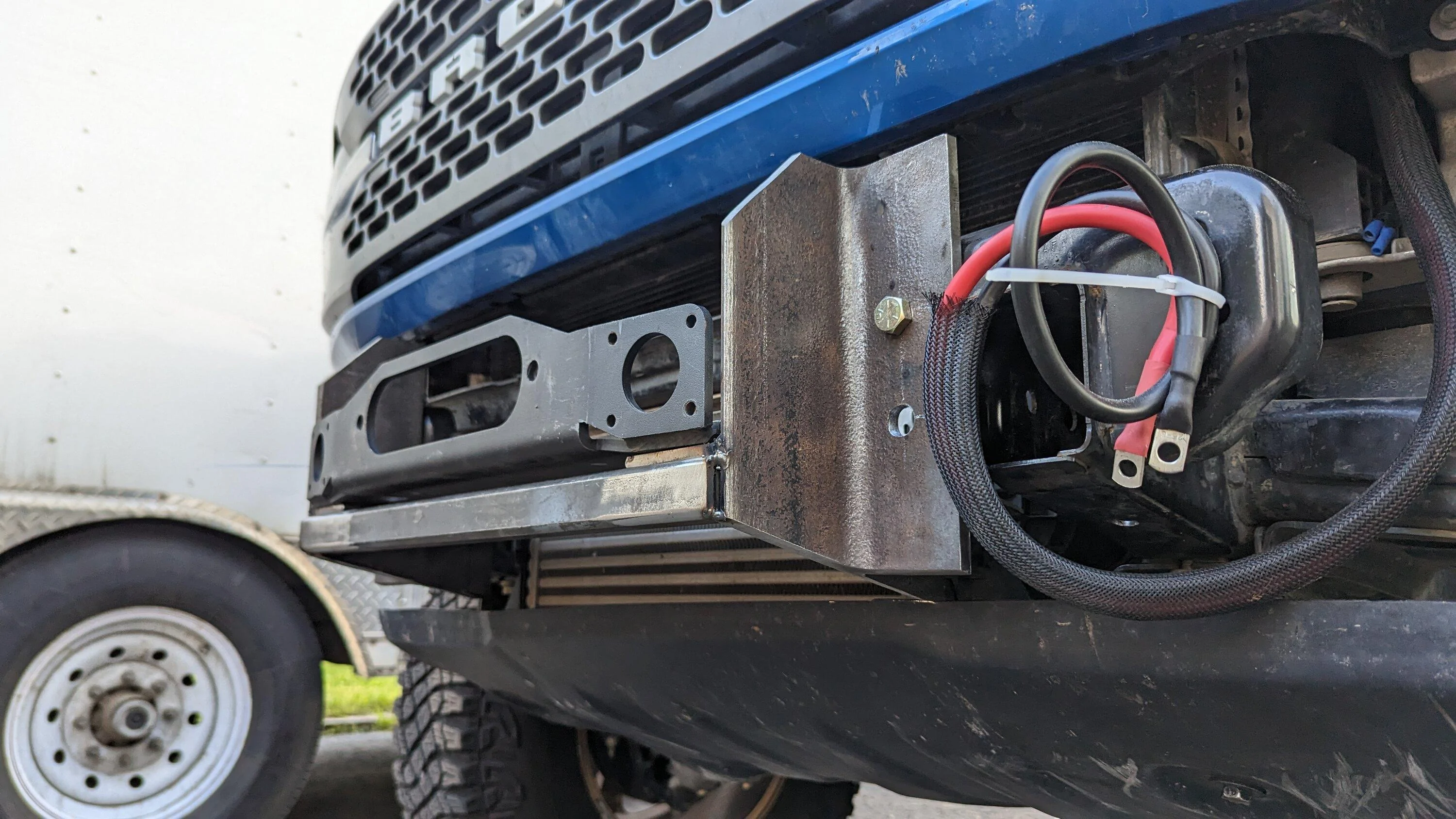

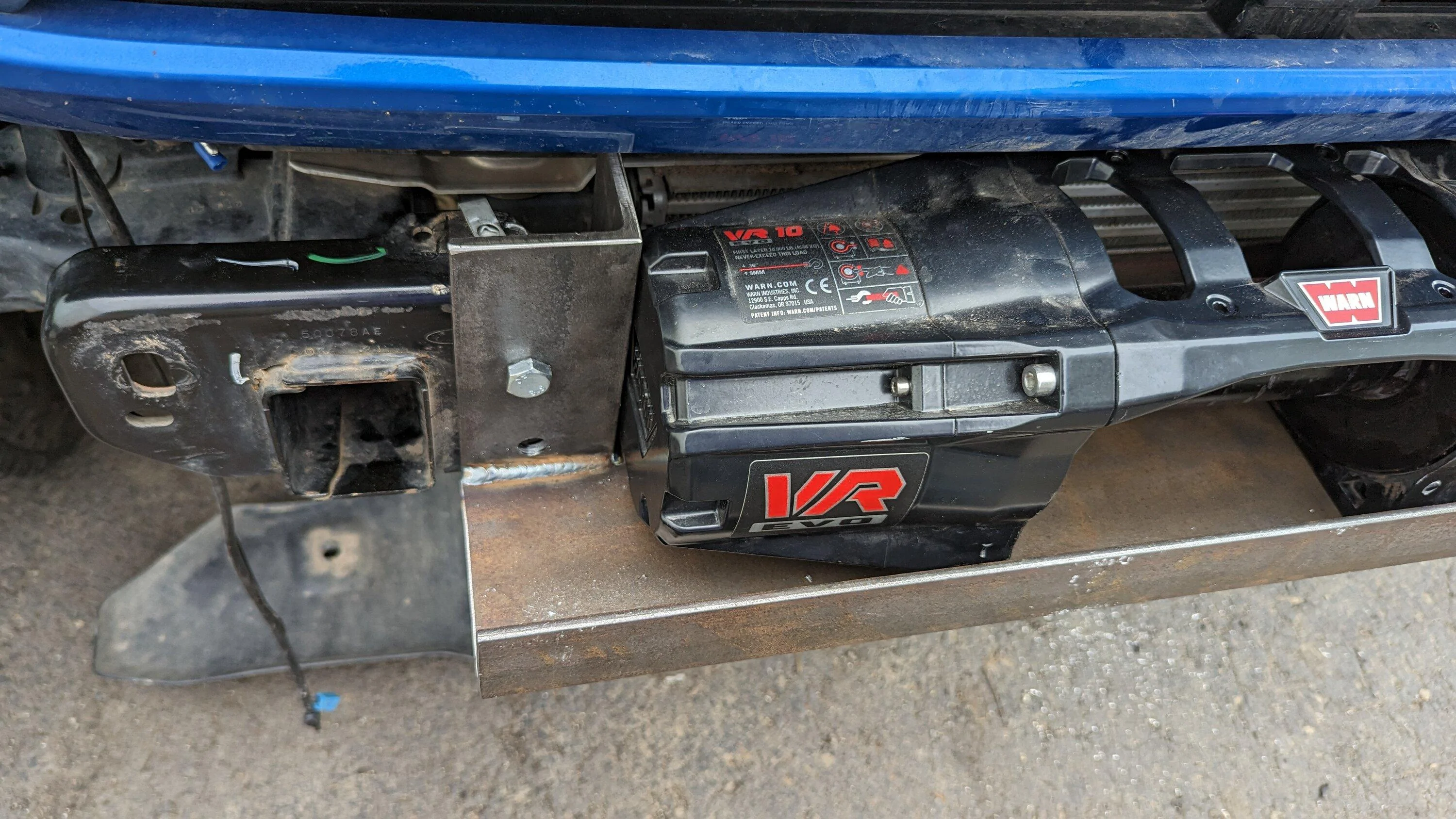

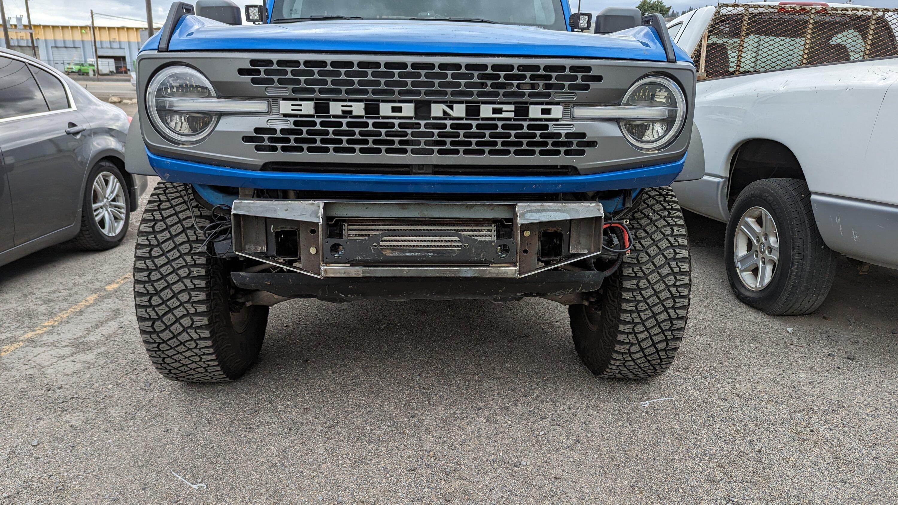

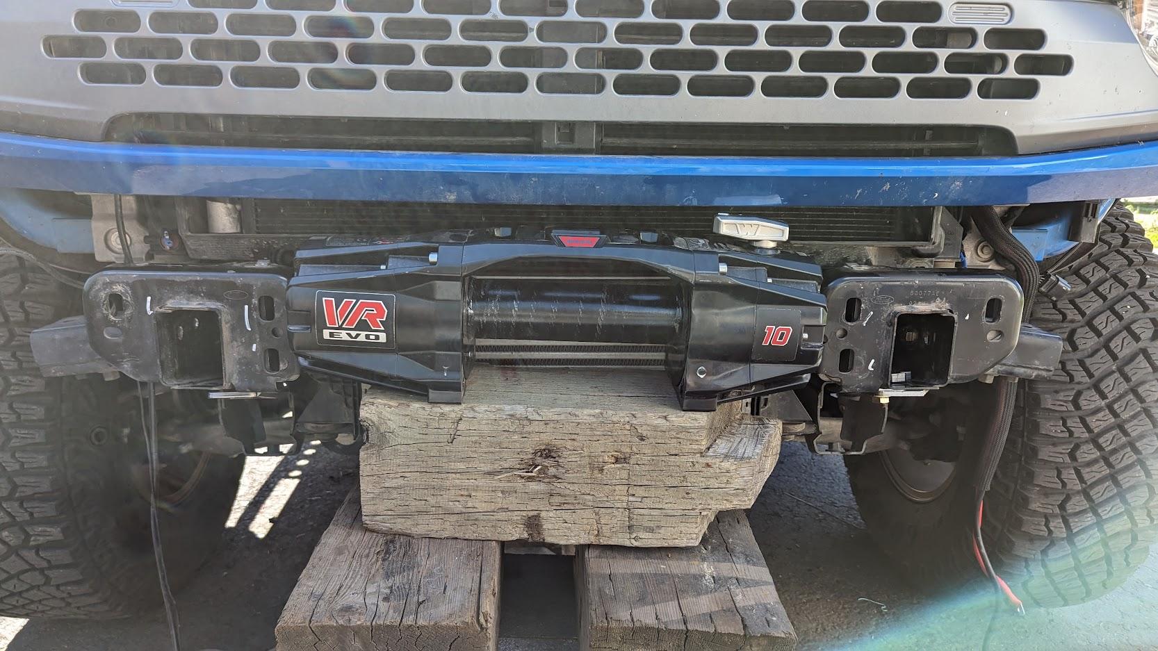

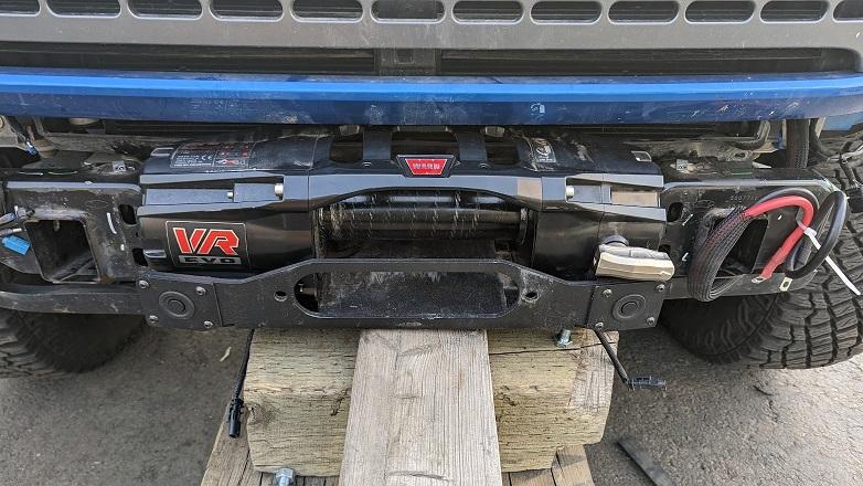

Called an audible on the winch plate, the RC plate is the perfect width as well and tucks in even tighter.
Also ordered the JKS max tire kit, those crash bar mounts are looking too ugly.

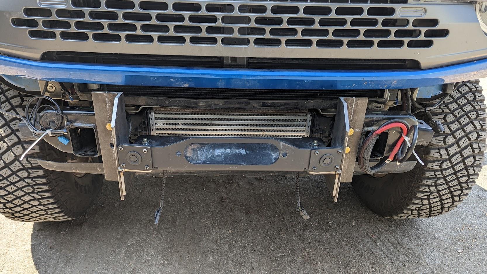

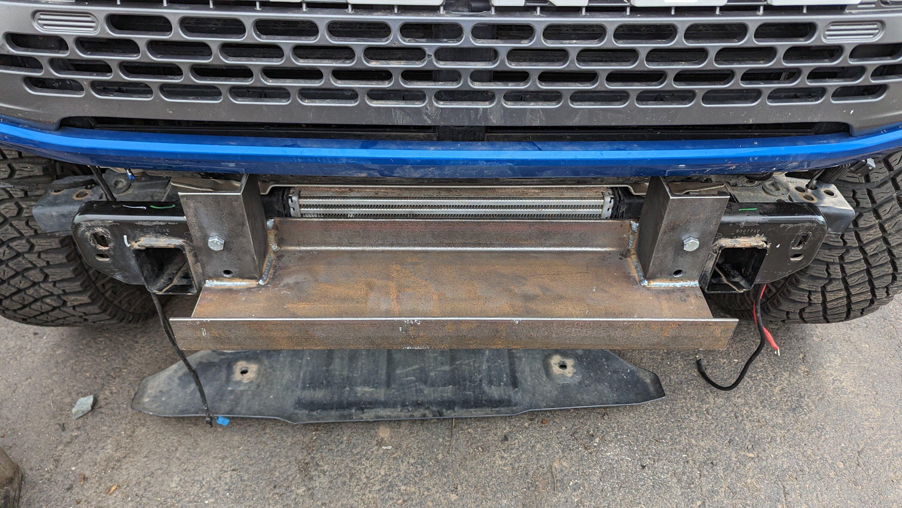

OK now we're shaping up. I need to angle back the bottom to meet the skid plate but the bolt in winch plate will make working on it much better, can pull the winch out without removing the whole bumper.

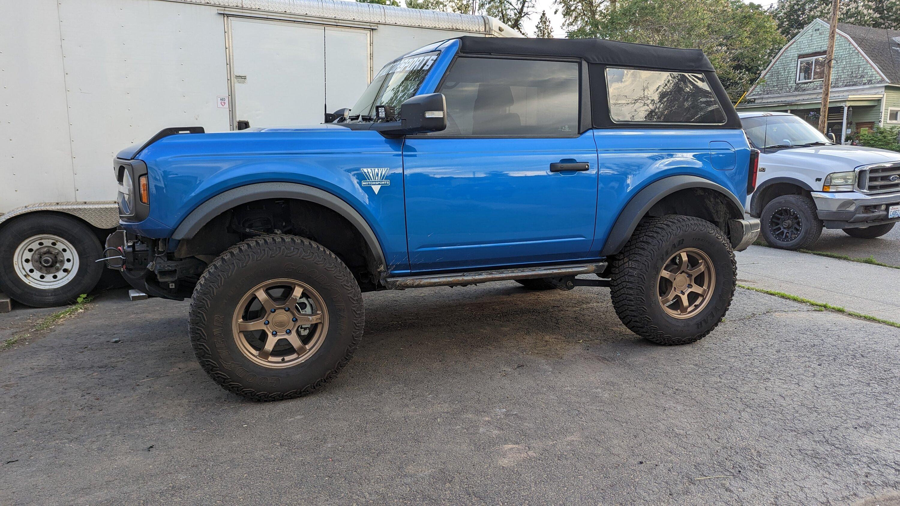

Finally got the rear spacers back in. The passenger side doesn't seem to droop as well as the first time is did it, it was really a struggle to get the extra length in. The driver side dropped away another 2" or so and made easy work of it. Still sitting almost an inch higher in front without the weight of the winch and bumper.
Speaking of which, I have the profile dialed in, now to start building out.
