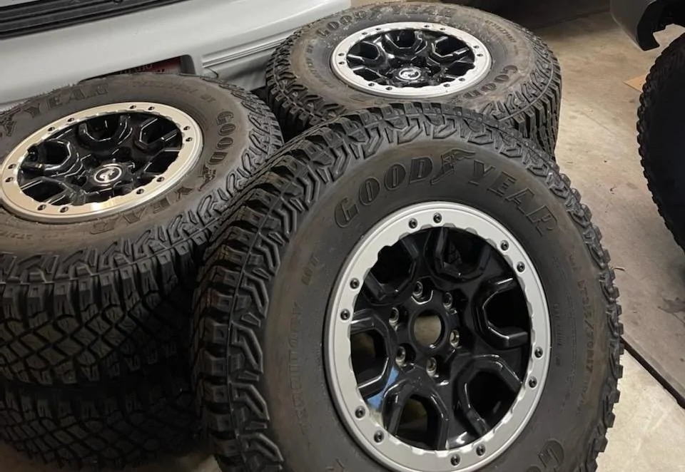

I'm such a glutton for punishment. Was looking at the Interco blem list and the wheels started turning, then this happened.
Beadlocked 37s are now on the menu.

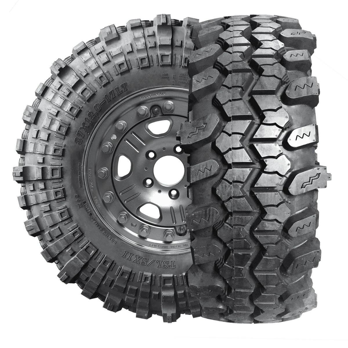

This damn rig is such a black hole for money. Five 37x14.50x17 Interco SX2s ordered up for $1800 shipped.

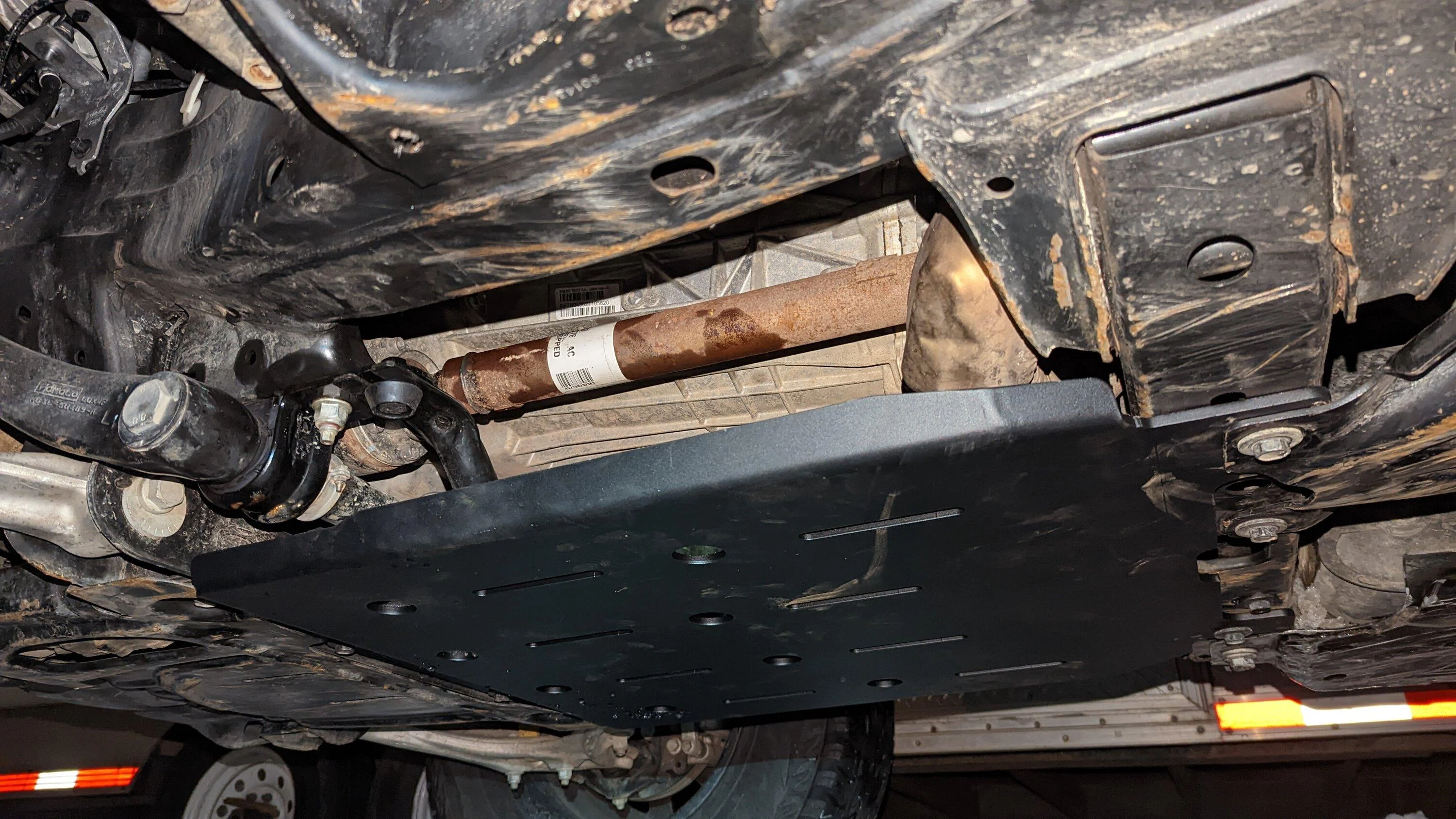

Armor!
The Mabett 4dr skid fits the 2dr just fine. It doesn't give up any significant clearance. I kept the bar from the disco skid for a little more protection.
I skipped the included hardware and reused the OEM bolts. The included conical bolt protectors are aluminum and would be smashed into the bolt heads instantly, making the next removal a major chore.
There appears to still be enough room to snake my arm up to replace the oil filter, so I shouldn't have to remove the skid too often.
One of the frame rail captured nuts for the t-case skid broke free. I'm going to have go back and try to fish a wrench in there to replace it some day.
Do you think this would work on the 2.7 as well?

Bias ply tires........got them on my 72 thinking about it on the 22. Can't wait to hear about handling and what air pressure you run on the street.
P.S. if it sits over a week they will flat spot bad

These are going to be my new play tires, they won't get street driven much.
