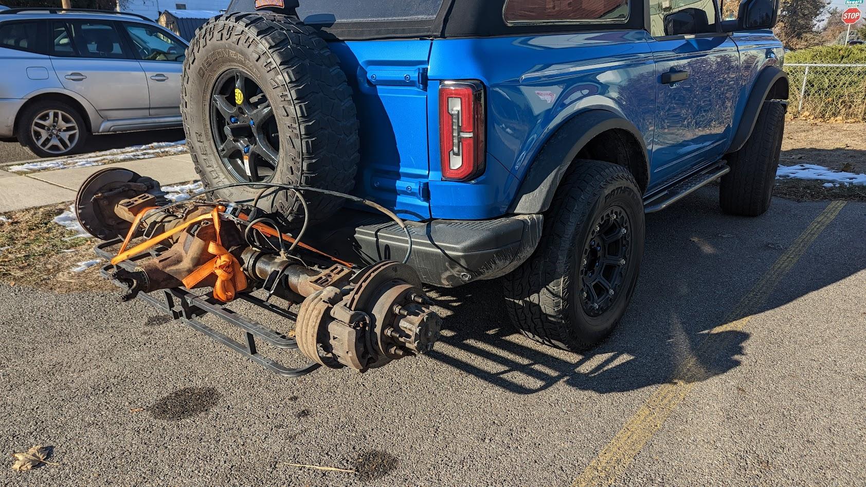

Bronco putting it work today to help his older brother out. That 10.5 is at about the limits of a basket carrier on a Bronco. Handling felt less than optimal.
If only you had a mOaR door, this would have fit inside - with room to spare!

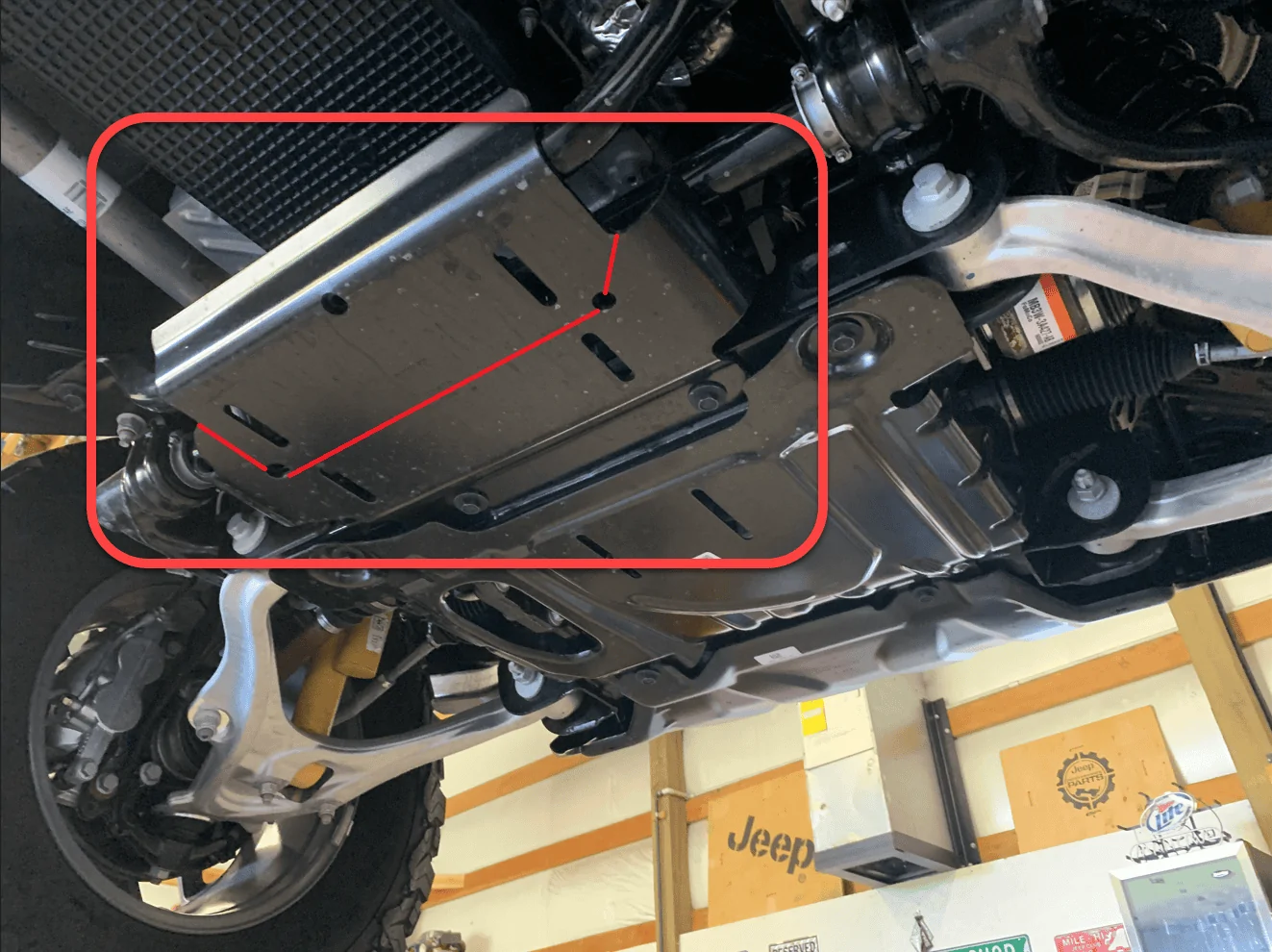

The Mabett 4dr skid fits the 2dr just fine. It doesn't give up any significant clearance. I kept the bar from the disco skid for a little more protection.
I skipped the included hardware and reused the OEM bolts. The included conical bolt protectors are aluminum and would be smashed into the bolt heads instantly, making the next removal a major chore.
There appears to still be enough room to snake my arm up to replace the oil filter, so I shouldn't have to remove the skid too often.
One of the frame rail captured nuts for the t-case skid broke free. I'm going to have go back and try to fish a wrench in there to replace it some day.

So are you doubled up right here, or did you remove the original plate from the bar?

I've been considering this plate simply based on the price point and it being lightweight aluminum, so I'm definitely looking forward to your review (y)

I didn't think about using it until after the new skid was installed, because it didn't look like it would fit under. After I got it installed I noticed there was a bunch of room and lo and behold the bar fits tightly. I cut it here so I could bolt it to the aluminum if I wanted to. That allowed me to fish it in there without dropping the skid again. You might be able to save more or even all of it.
