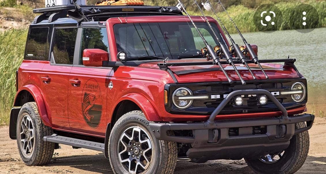

Wonder if I can use this to rig something up like this? I'm dying to have this setup for fishing
We are sure you can make something like that. We do not have plans to add that currently. But the possibilities with this mount are nearly endless.

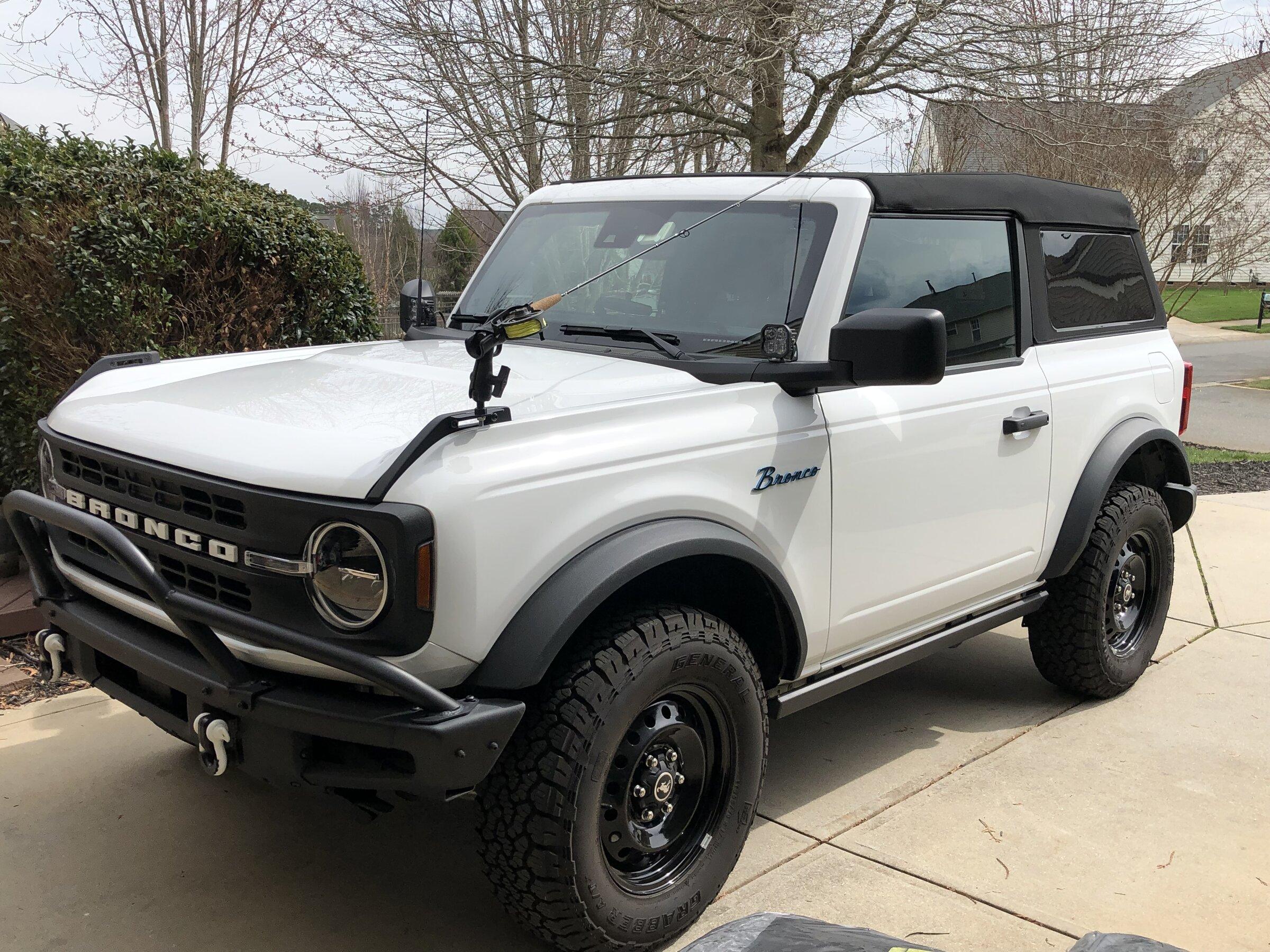

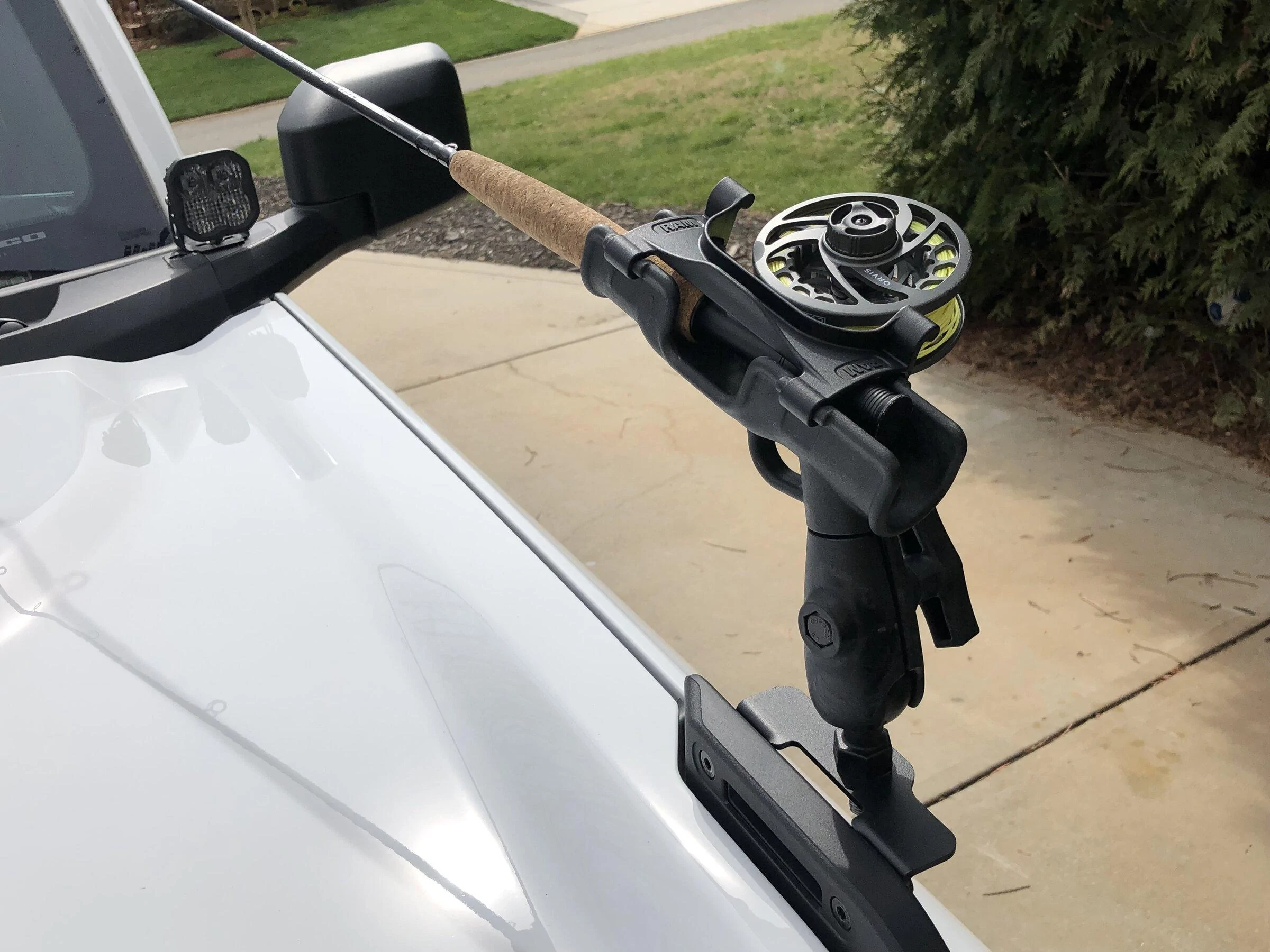

Shared with TrailRax via email but wanted to share here also. Used TrailRax Bronco Trail sight mount with a 10mm X 1.25 threaded “C” sized Ram mount ball with stainless locking nut. Then simply added a RAM 2007 Ram Rod fly rod mount to the ball. I intend to use this as a rod holder between access locations so I don’t have to break my rod down each time I move from spot to spot. It’s not lockable so it’s not really a solution if you plan to leave your car unattended.
