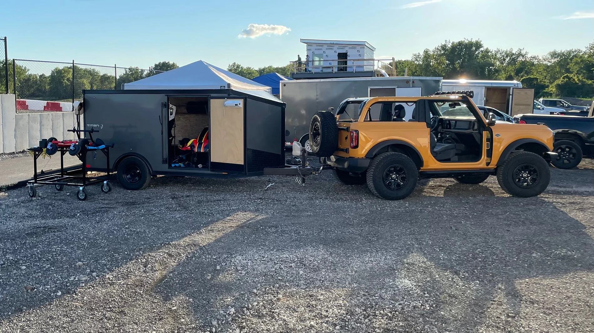

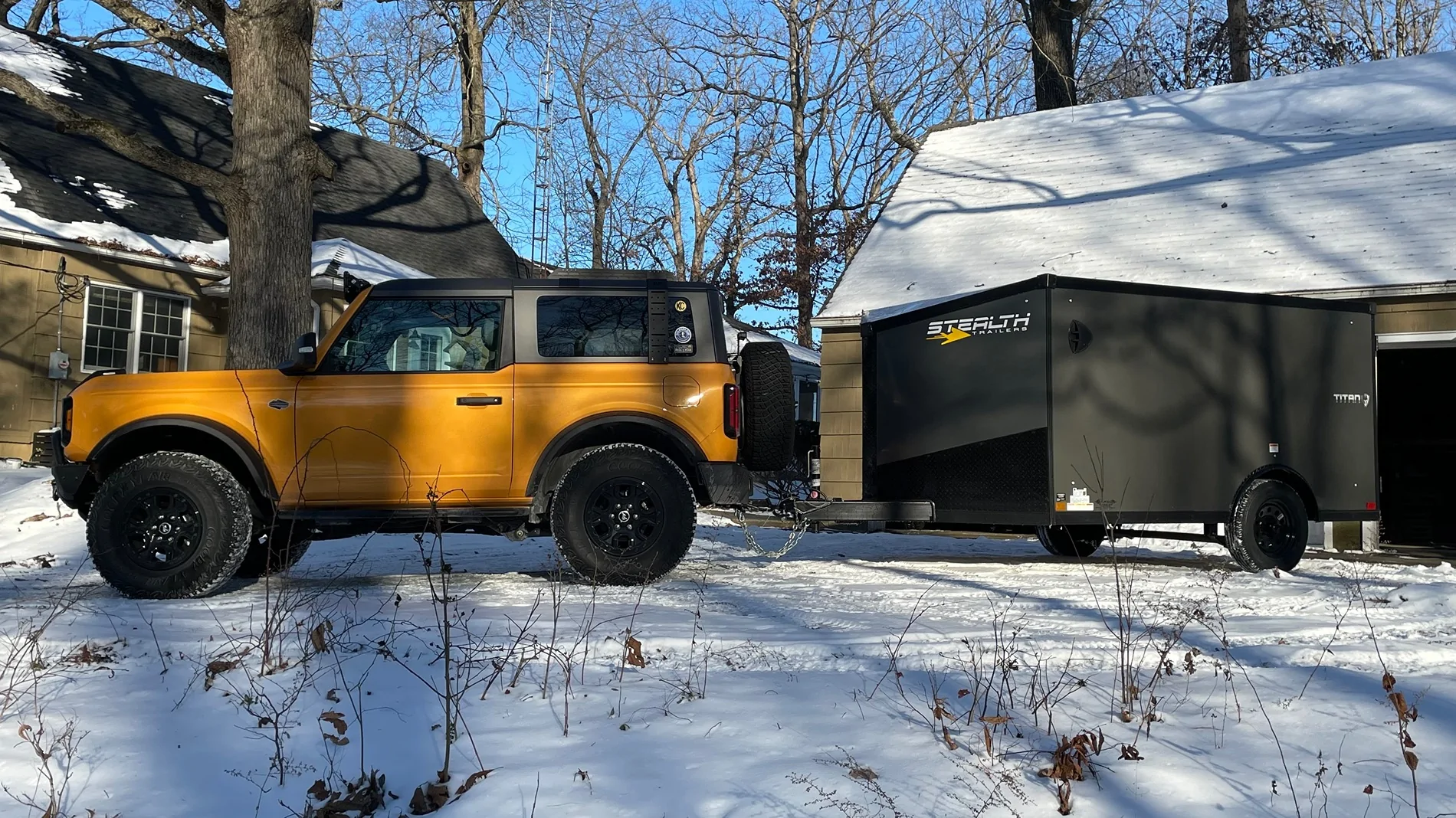

I have a 2022 Wildtrak 2 door with factory tow pkg. I have front and rear spacers for a slight lift. My custom trailer is very tongue heavy due to the placement of the axle with door option. I need a towing solution that doesn’t include selling the Bronco in lieu of a Ranger of F series. From What I can find my only option is aftermarket struts with adjustable ride height or taller rear spacers than What I currently have. Back in the day we would toss some air shock on it call it good. (I understand that with this design that is not a possibility). I’ll include some pics of the current setup. I have been cheating a bit my towing without the top and doors.

It looks like it's probably okay as it sits. If the truck is terribly overloaded you'll know it from the squirrely handling.
Your trailer sits a bit nose down which adds to the tongue weight. Perhaps a straight hitch rather than a drop would help some? The Bronco, while squatted a little, doesn't look like it's terribly overloaded. Keep in mind, though, that too light a tongue weight will be more likely to cause dangerous trailer sway. Always aim for a tongue weight of roughly 10% of the total loaded trailer's weight.

I dont have any stability issues and I understand the 10% rule. Just trying to limit the rear wheel sag on a setup that is always greater than 10% due to its design. Optimally the trailer would be a 12 or 14’ length (for load distribution) rather than the 10’ length it is. That would make it easier to get the the 10% tongue weight.

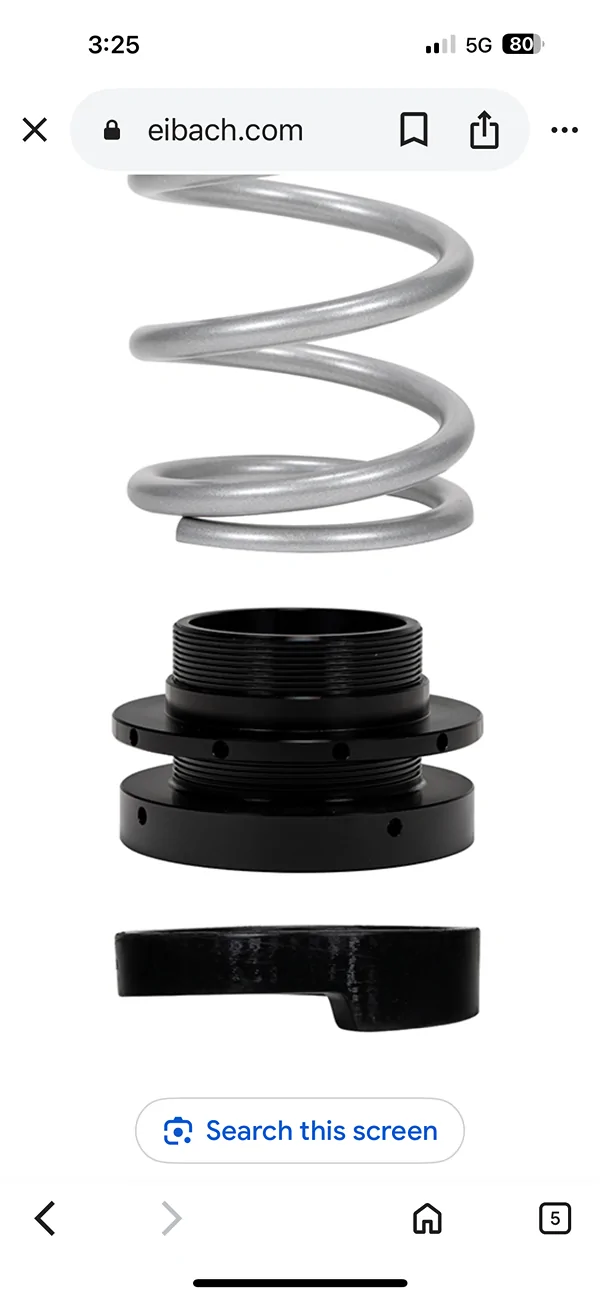

The second would be an adjustable coil over with a screw collar. You could tighten it when you tow to compensate, and put it back when done fairly easily. Does require jacking the corner up so you can relieve all the pressure on the spring to adjust the collar though.
Eibach has that for the 4Runner. At least they did 5 years ago now. Worked great
There are a lot of options for the Bronco
ProComp VSRTs and RC Vertexes are the least expensive I know of, but not the only option by far

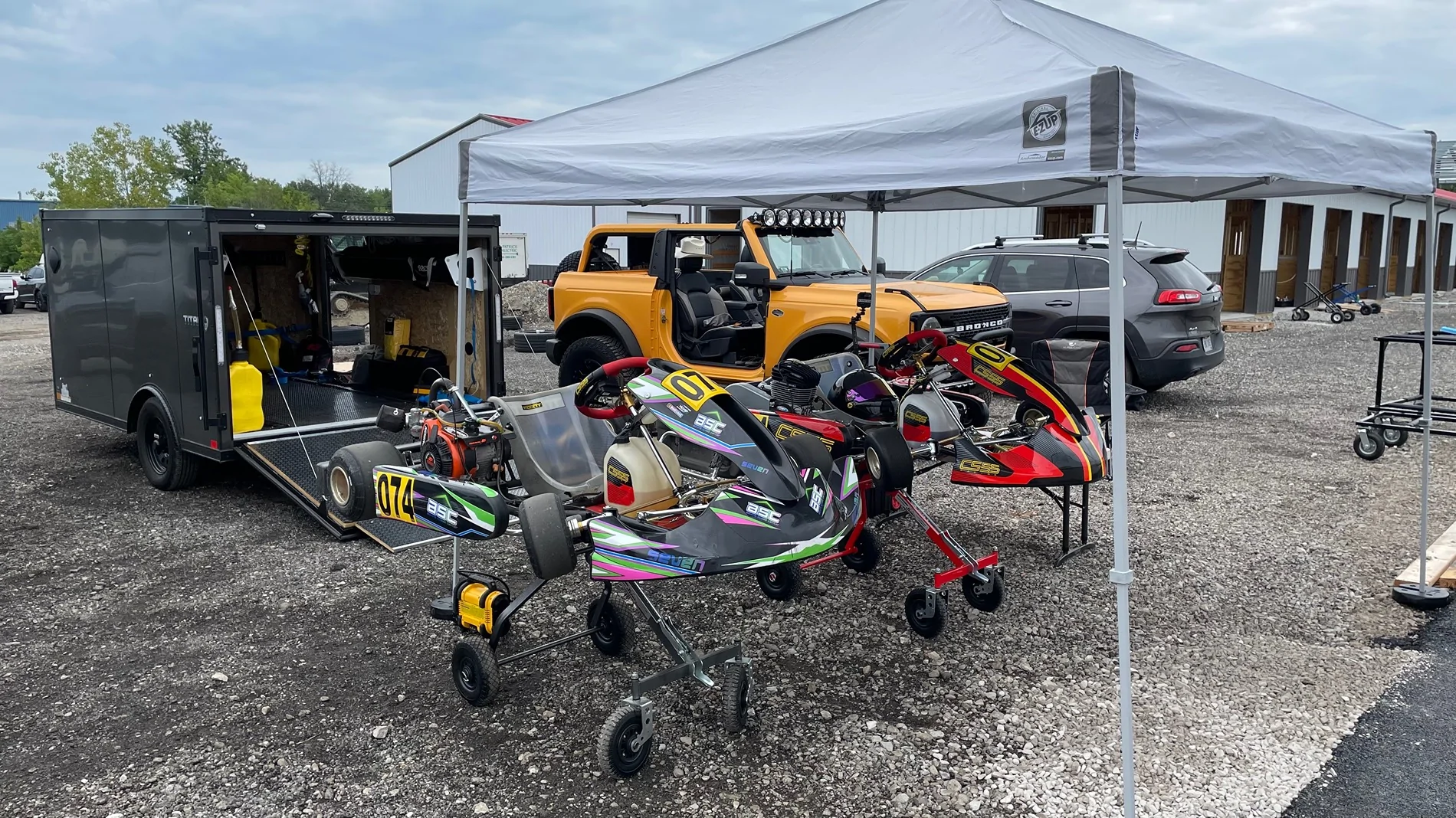

Yes the placement of the trailer axle is set at is not ideal…
Agree that a higher receiver would help, but I would look at how you load the trailer.
looks like the carts could be loaded side by side with engines up against rear door. Or add removable shelve at rear and stack carts at the rear door
more weight on or behind axle will lighten tongue ‘some’
Could add sandbags, lead, extra fuel, water, examples to offset weight.
It looks like the trailer is not heavily loaded… adding is an option.

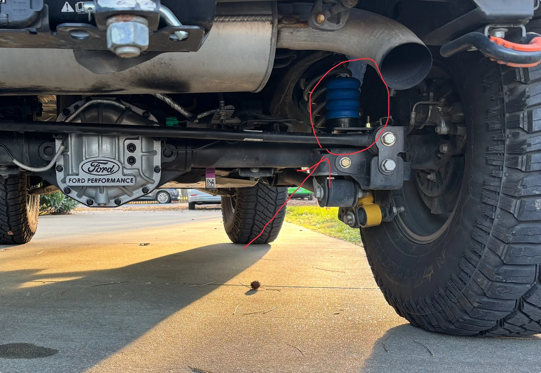

Air-Lift has a bag set for the bronco. I don't like the way it is mounted and if I get them I will make my own mounts.
They came out after I purchased a set of Eibach Pro 2.0 coilovers, They have adjustable perches. I wanted a little lift anyway but needed adjustability and they served both purposes. I may end up getting the air bags too which makes it much easier to control sag from weight. I have used air bags for 35 years on two Rangers and really liked them.
