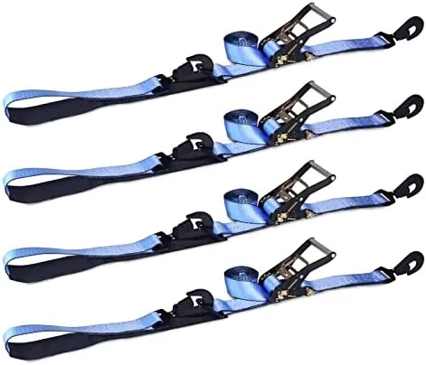

If you plan on towing it a lot on a flatbed I would suggest investing in some of these straps that have the axle wrap built into it. They are very simple and save lots of time. I used to use the long yellow straps you could get at home Depot, but they were so long it was a pain dealing with the extra length. They also have lots of different variations if you want the hooks twisted or a different connection point besides a hook.
Ford Bronco Towing on a flatbed 41TOTtz9lCL._AC_SY1000_
https://www.ebay.com/itm/1531285933...UUwV1OyTZ6&var=&widget_ver=artemis&media=COPY
