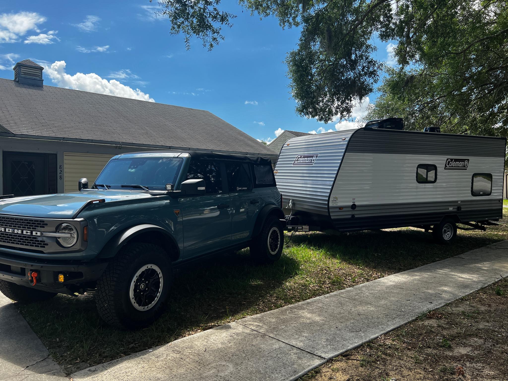

I have towed at the limit with a Coleman Lantern LT17B and the 2.7L had no issues pulling it. Also with the curt wireless brake controller, stopping was like normal. I didn't have any sway issues to note. I would tow this setup long distance if I needed to.

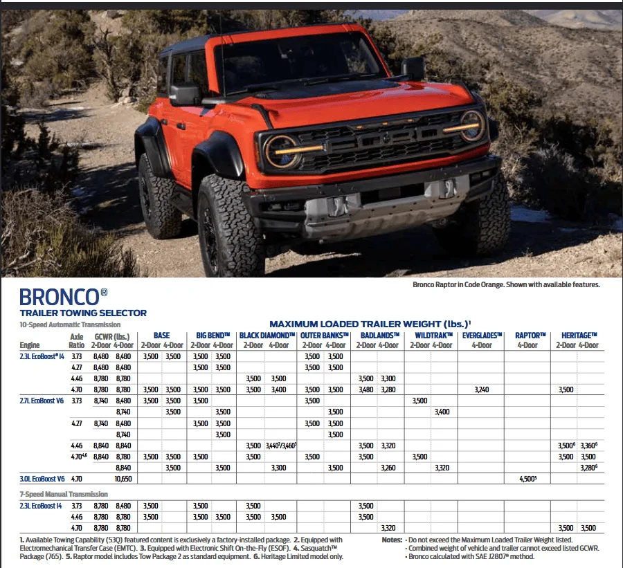

Here's some specific information on towing capacities for thought.
Ford Bronco Thoughts on towing Screenshot 2023-03-09 at 09-59-17 2023 Ford RV & Trailer Towing Guide - 2023_Ford_RVandTrailer
I see that chart is still missing 7MT/4.70 2drs except for Heritage.
The 2021 badlands 7MT /4.70 2dr was 3500 lbs in the 2021 towing guide.
The 2024.5 refresh needs to get towing capacity up to 4500-5000lbs with a real max tow package - at least for the 4 door.
