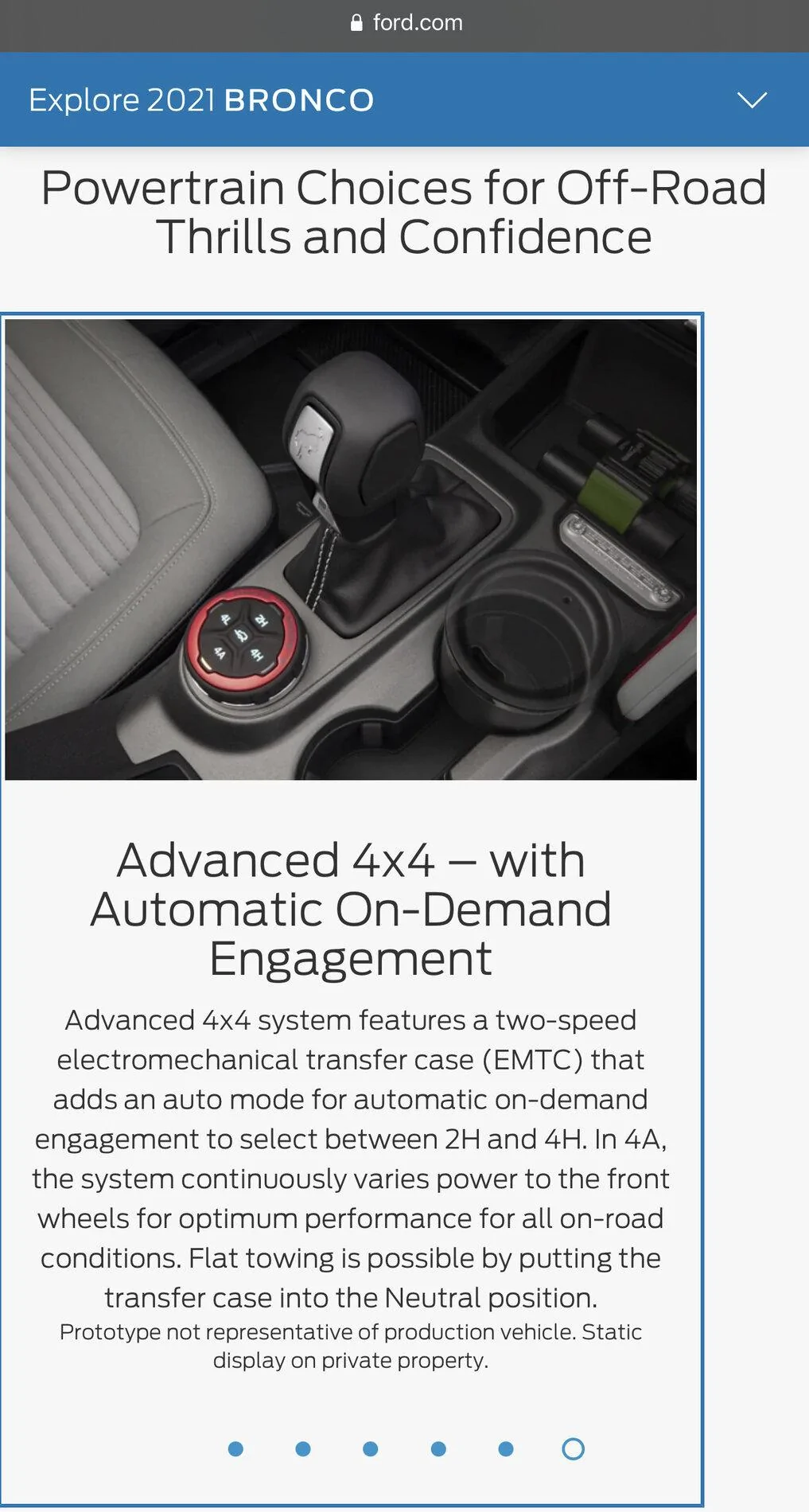

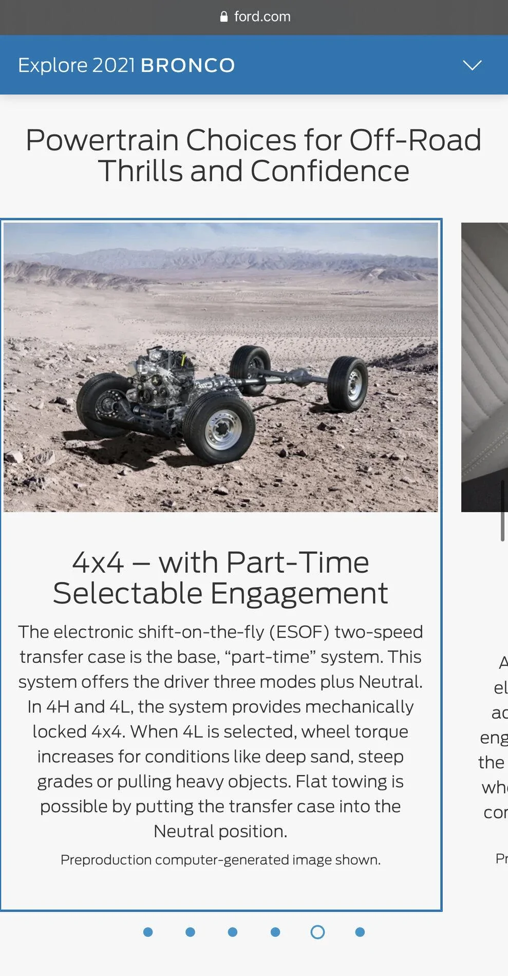

Ford has this on their page for the Bronco... have you seen what it looks like yet?
