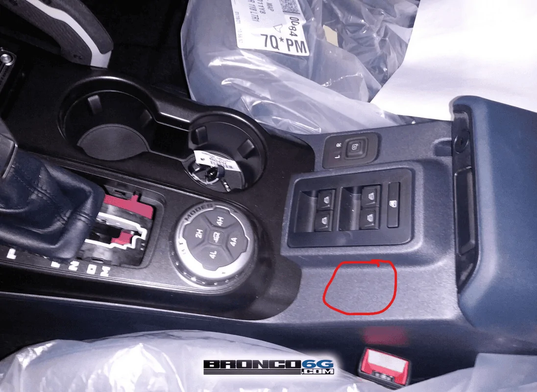

Why would you have to rip out the center console? There is a blank space next to my headlight switch. Or is the wiring in the console for some reason? I have not test any instructions yet but will be adding a controller sometime. I like the idea of the Curt one but I would have to tether it to the vehicle. Roads are rough and I see that bouncing down the road.
I was referring to the installation instructions for the Ford-approved brake controller. They have you tearing open the center console and drilling a hole to install the brake gain knob. The knob would be right next to the window/side mirror switches in the center console, and there is a wiring harness under the dash that you can access from the passenger side where the controller itself plugs into.
Obviously if you do the installation yourself (with either the Ford-approved controller or a 3rd party controller) you can do whatever the heck you want. But if you follow Ford's instructions or get the dealer to install it... that's where they'll put the gain knob.
EDIT-- Photo for reference. Red circle is roughly where the gain knob would go.
