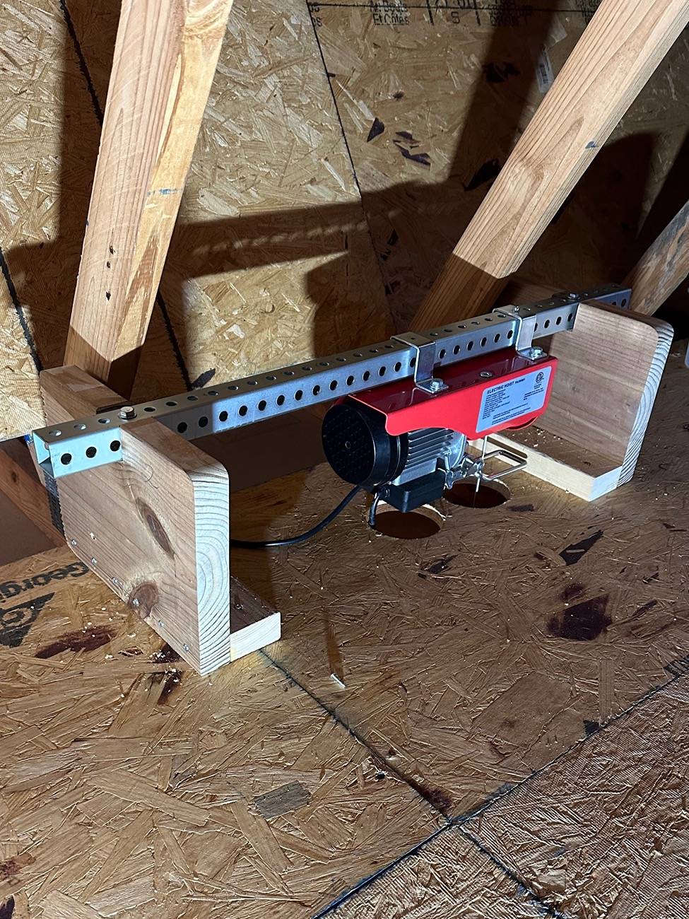

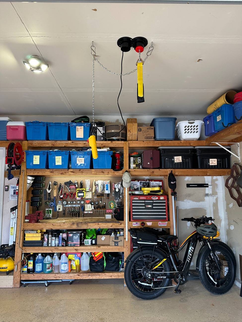

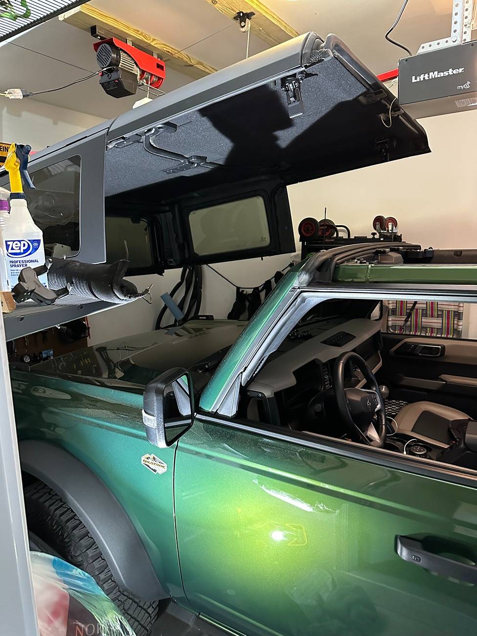

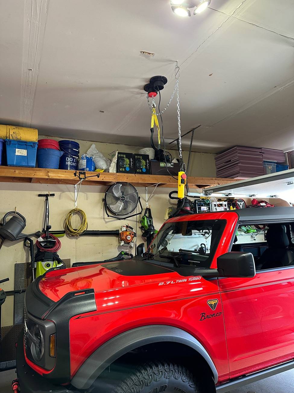

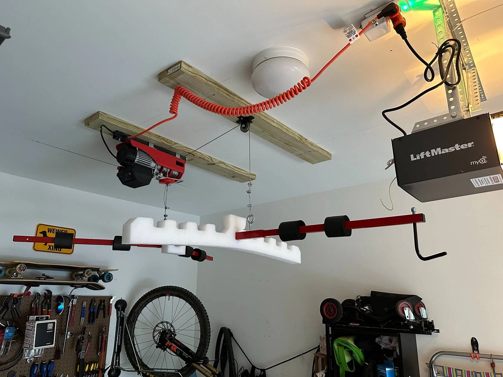

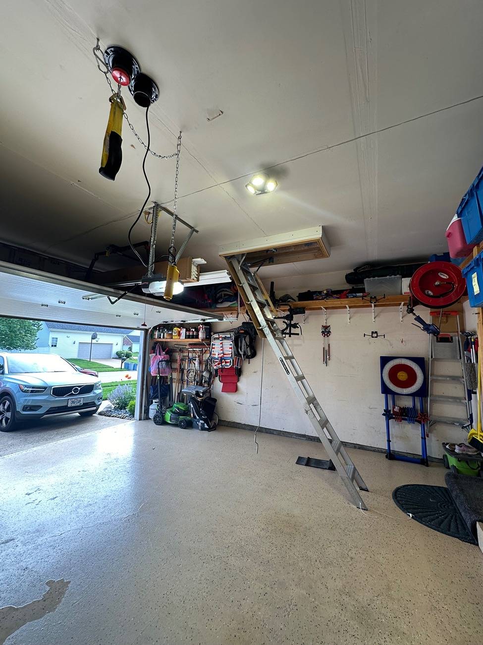

I got everything from Harbor freight...well except the boards and square channel to support the winch along with the 4 inch bathroom toilet flange I used for the ceiling guide.. Works Great with the remote and i can do everything by myself. I like that it doesn't take any room up in my garage...just a thought...Amos

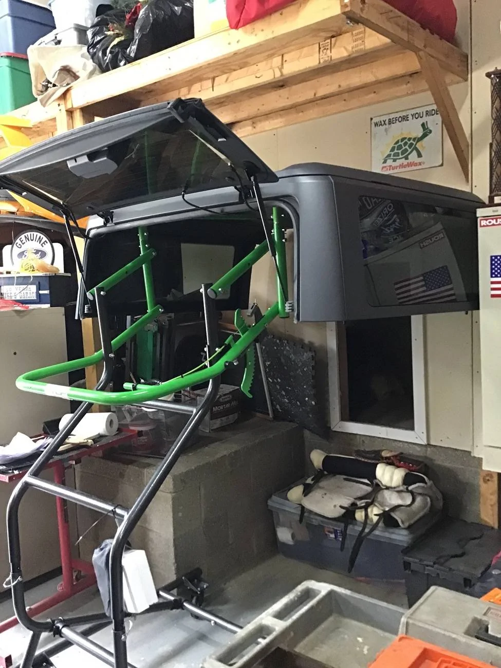

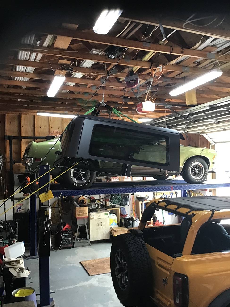

I have used both methods. The Top lift advantage is it can be removed and installed by my senior citizen self without issue. The ceiling hung electric hoist with straps advantage is less expensive and leaves garage space available..
