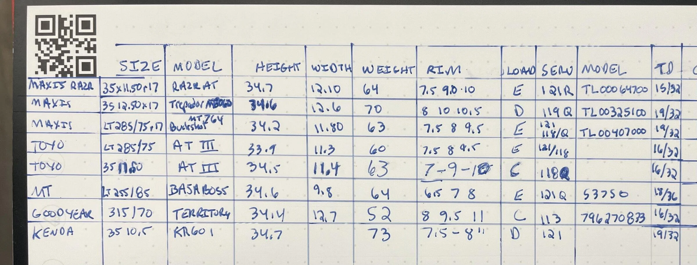

My old man handwritten list
I want a narrow tire
Yeah those Klevlar RT are a rare find at 35 x 10.5 and D rated but damed if they aren't real expensive.
You see Nitto makes a 35x11.5R17 Trail Grappler that's a load range C? If you like the more narrow.
