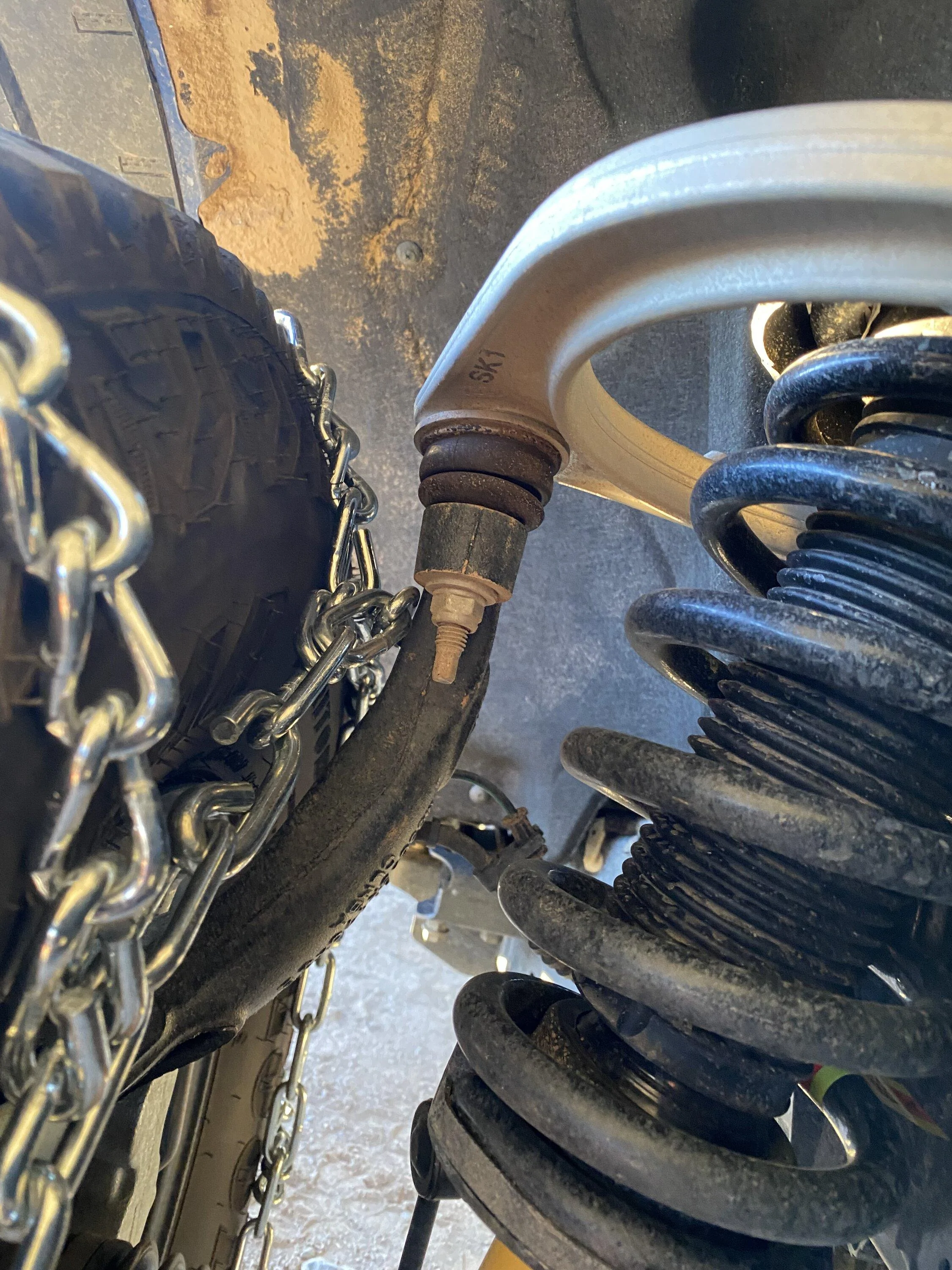

Curious why the owners manual says only install chain on the following size tires:
275/70 r 16 and 275/75 r 17?
If you saw the front clearance with stock offset, you would understand!

That picture says it all. Did you happen to check the back?
