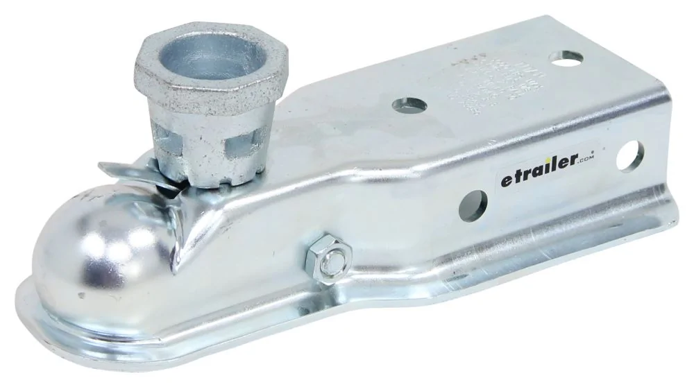

I like the Twist on trailer coupler's for many reasons, this is just another reason.
My bumper pull horse trailer has one.
