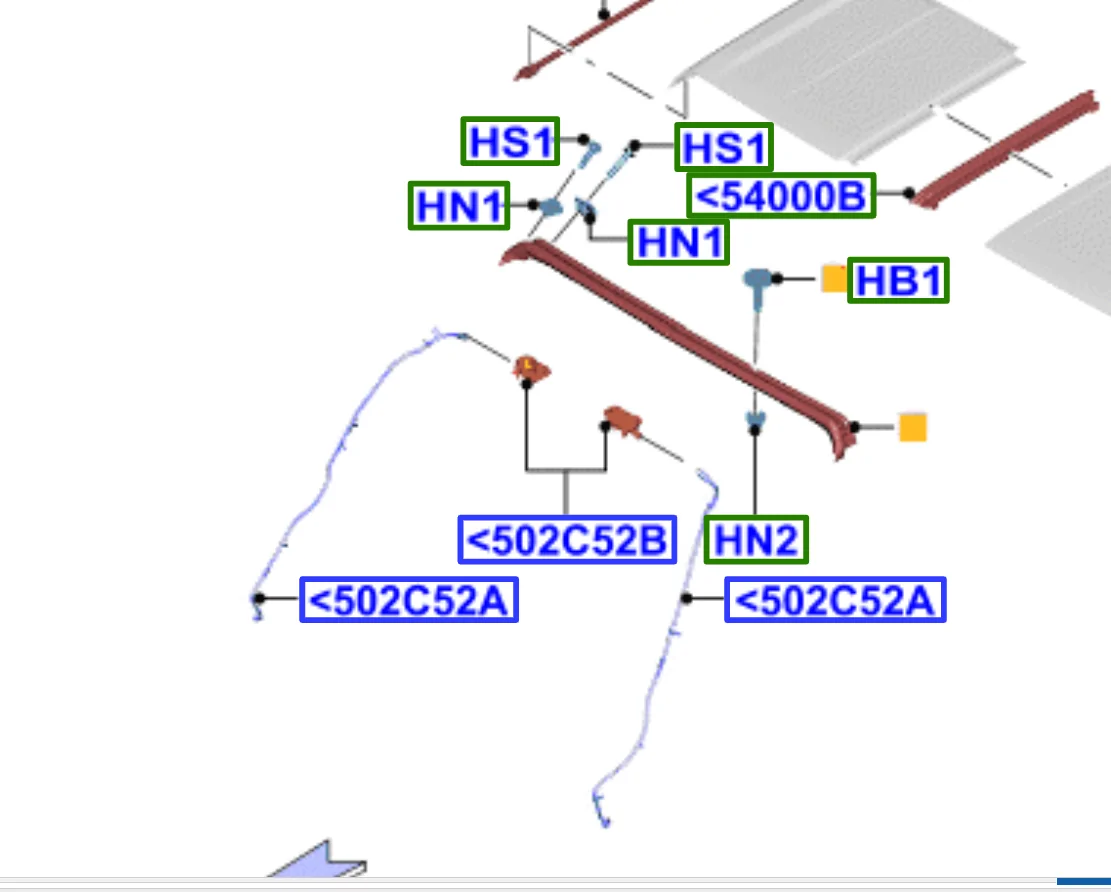

Did the warranty invoice say anything about checking the drains? There are circumstances depending on how the vehicle was parked (uphill, downhill, leaning, etc.) along with rain volume, that can cause water overload on the drains, fill the trough and well, you know the rest of the story.
Parked relatively level and run of the mill rain storm, the drains can usually keep up assuming they aren't pinched/disconnected/obstructed. Should be able to blow compressed air through them to verify integrity. You can also pull the front panels, take a bottle of water and pour in the trough and verify water draining.

Okay here is another possibility to check.... There is a drain pan, very small, would fit in your hand. There is one at either end of the front window frame. The are just above the visors (toward the outside).... Yes they are up inside the plastic trim panel. My thought being they collect all the water that gets inside the front channel (below the roof panels). If you remove the roof section above the driver you will see a small hole in the channel (just to the side of the accessory ready mount that is above the window), this hole drains to a small pan below and that pan is attached to a hose (about 1/8 inside diameter) that drains the water down the A pillar to the outside of the Bronco.... IF that hose is detached it would than just be pouring that water into the plastic trim panel the visor is attached to....
I do not know, but something to check....
OH I am slow... Flip is all over this....
And Flip's suggestion is awesome.... Take off the roof panel and find the hole to the drain and pur water down it.... Pour a bunch and see what happens....
Flip is the man!
Thanks a lot for taking the time to write all of that out. This is probably the best reply I’ve had so far, and that diagram is excellent. It really helps me understand how the drainage system is supposed to work.
I went back and read through all of my Ford repair invoices after seeing your comment. From what I can tell, I don’t see any mention of the drains being inspected, blown out with compressed air, tested with water, or verified for proper flow. The repair order says they performed several water leak tests, found water entering at the upper corner of the header/body area, removed the header assembly, installed a new header seal, applied seam sealer, and then retested until it passed. It doesn’t specifically mention the drain system.
What’s interesting is that after that repair, the leak came back immediately after the very first rain. The Bronco was parked on a fairly level driveway, and another time on a normal residential street, so it wasn’t on any extreme incline. That’s why your comment about the drains caught my attention.
At this point, I think it’s worth asking the Ford roof specialist specifically whether they’ve verified the drain tubes aren’t pinched, disconnected, or restricted. I really appreciate you bringing that up because it’s something I hadn’t seen documented anywhere in my paperwork. Thanks again for taking the time to explain it.
Flip is the man!
Thanks again for taking the time to explain all of that. I really appreciate it. This thread has honestly given me more useful technical information than I’ve gotten anywhere else.
That’s definitely another possibility I hadn’t considered. The symptoms do seem like they could match a disconnected or restricted drain hose if water is ending up inside the A-pillar area.
The frustrating part is that Ford has already had the Bronco for about six weeks, removed the header assembly, replaced the front header seal, water tested it, and returned it to me saying it was fixed. Then it leaked again during the very first rain while it was parked on a fairly level driveway.
I have a Ford roof specialist coming to inspect it, so I’m going to bring up everything you and Flip mentioned about verifying the drain pans, hoses, and actually pouring water directly into the drain channels to confirm they’re flowing correctly. If that’s all it ends up being, I’ll be thrilled. At this point I just want it fixed correctly.
Thanks again—you guys have given me several things to ask about that aren’t even mentioned anywhere on my repair order.

The leaks I've seen usually involve vehicle with the nose pointed down at a slight angle and very heavy rain. A lot more water will be running over the front seal and filling trough faster than the drains can keep up. Of those, two were early builds that fell under a service message and the header seal was replaced, neither of those or any other, have had restricted drains.
Not saying this is "normal", just trying to give some first hand info. Obviously OP still has an issue that needs to be investigated further.
Thanks again for the detailed explanation. You seem to have firsthand experience with these roofs, so I have one technical question if you don’t mind.
In my main video, it’s hard to tell from the camera angle, but I was watching it closely during the test. Within about 10–15 seconds of turning the hose on the roof, water was already flowing out of the drains on both sides of the front header seal.
Is that amount and speed of water entering the header cavity considered normal? My concern isn’t that the drains are clogged—it’s that I believe too much water is entering the header cavity too quickly where the two front roof panels meet the header seal, rather than being diverted away by the sealing surfaces.
Does that sound like expected behavior, or would that make you suspect an issue with the header seal or the fitment where the front panels meet it? I’d really appreciate your opinion since you seem to have firsthand experience with these systems.

On the explorer forum someone rec. using weedeater string and feeding it down the drain tubes to clear any debris. I do that every year on my wife's explorer with sun roof. This has inspired me to check the bronco.
