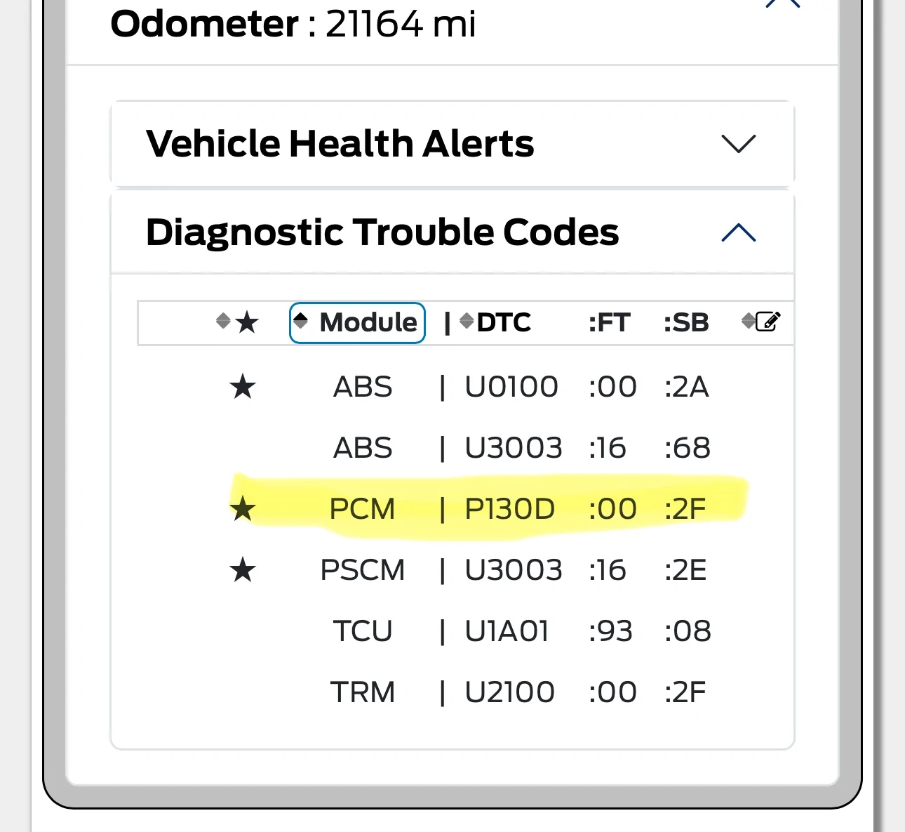

Send me your VIN and I’ll check the codes.
I’d be very surprised if it had anything to do with the battery considering it happened going 65 down the road.
Ducati1098
10,001
23,258
Midwest
P130D: Engine Knock/Combustion Performance - Forced Limited Power
Did you fill up with gas recently before this? Potentially bad gas although there are obviously a lot of other potential causes.
Basically your knock sensors detected excessive pre-ignition.
I filled up the night before and had driven very little until that morning. I was probably 25 miles into my drive to the trailhead when this happened.
Thank you for looking it up. I guess I’ll send it to the dealership and see what they have to say.
