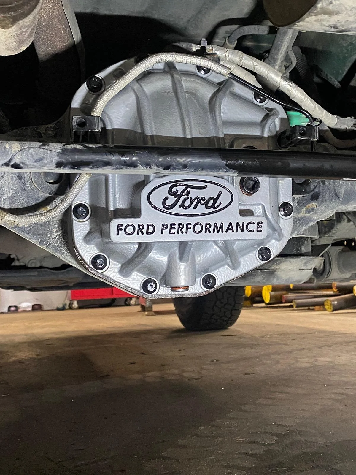

Ford Performance Diff Cover has been installed, using all supplied OEM hardware and gasket.

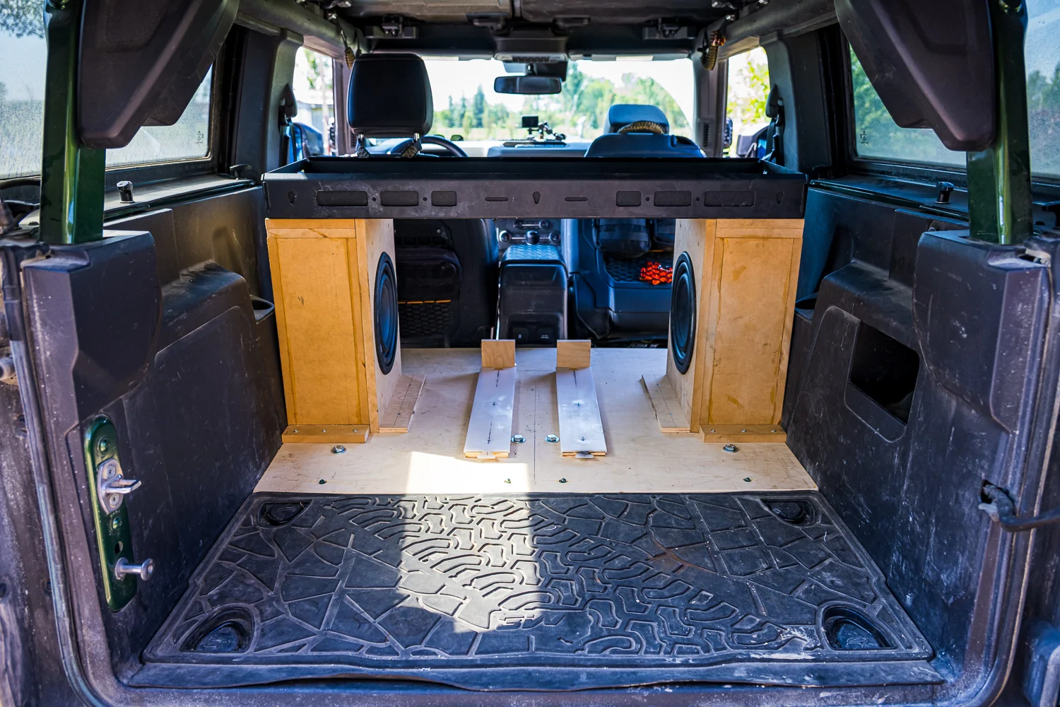

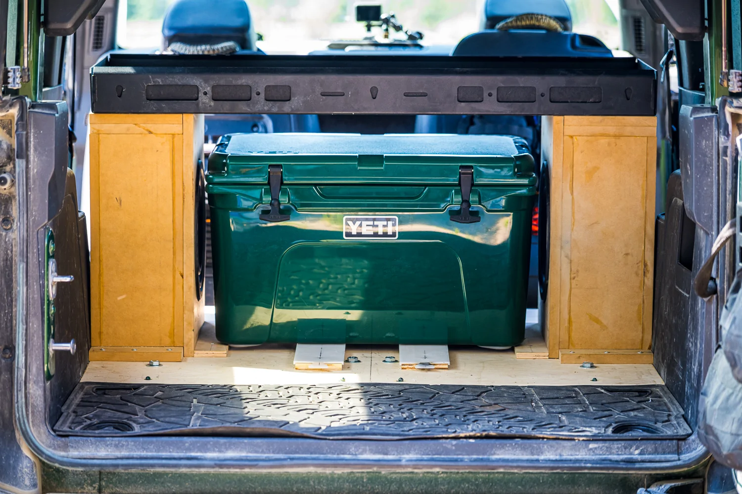

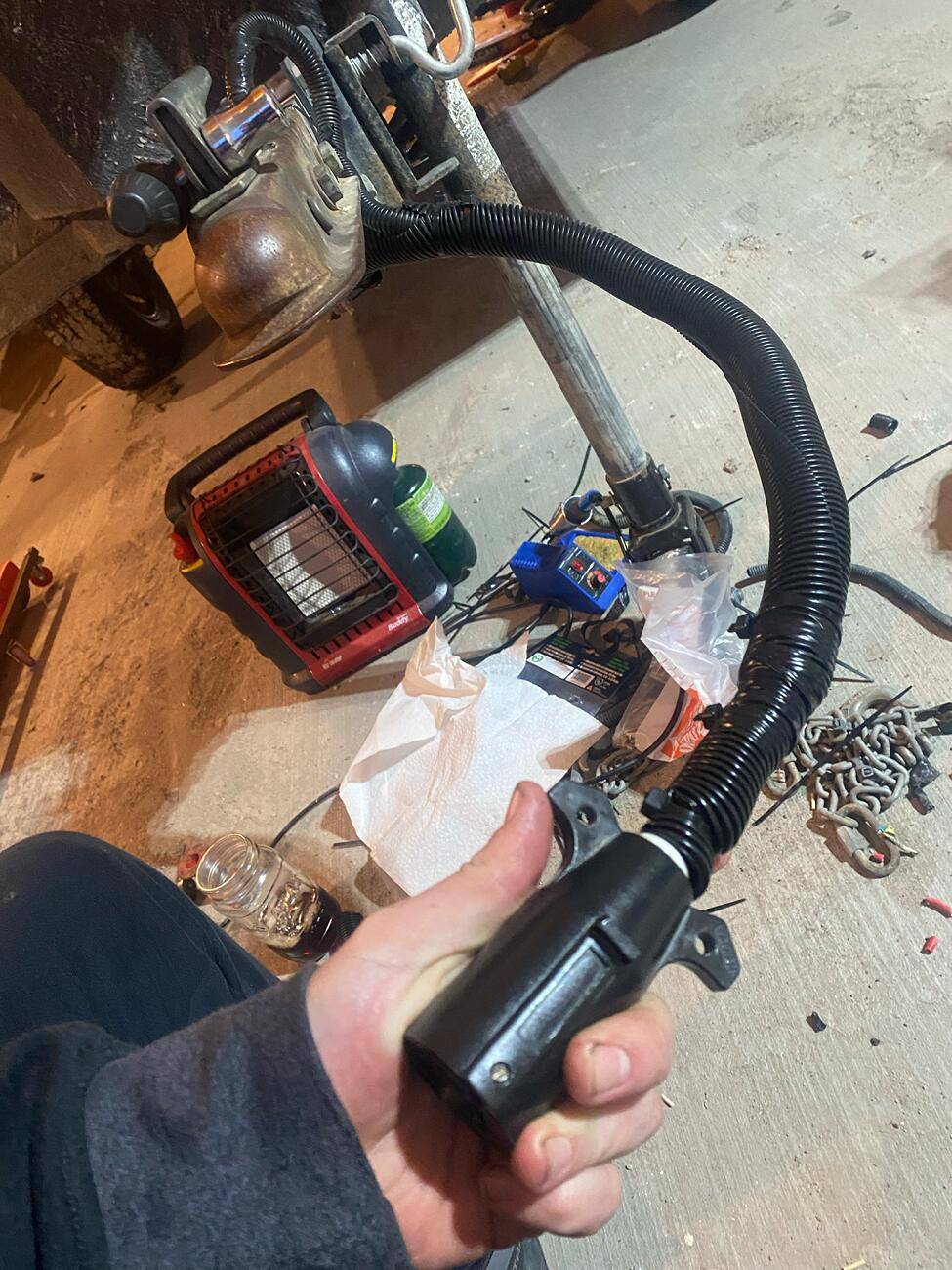

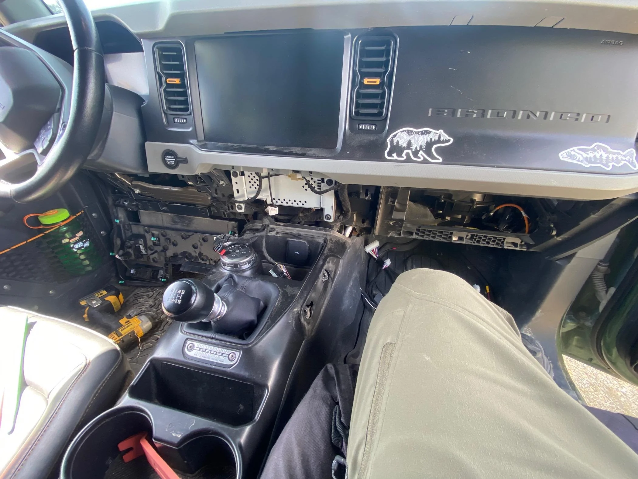

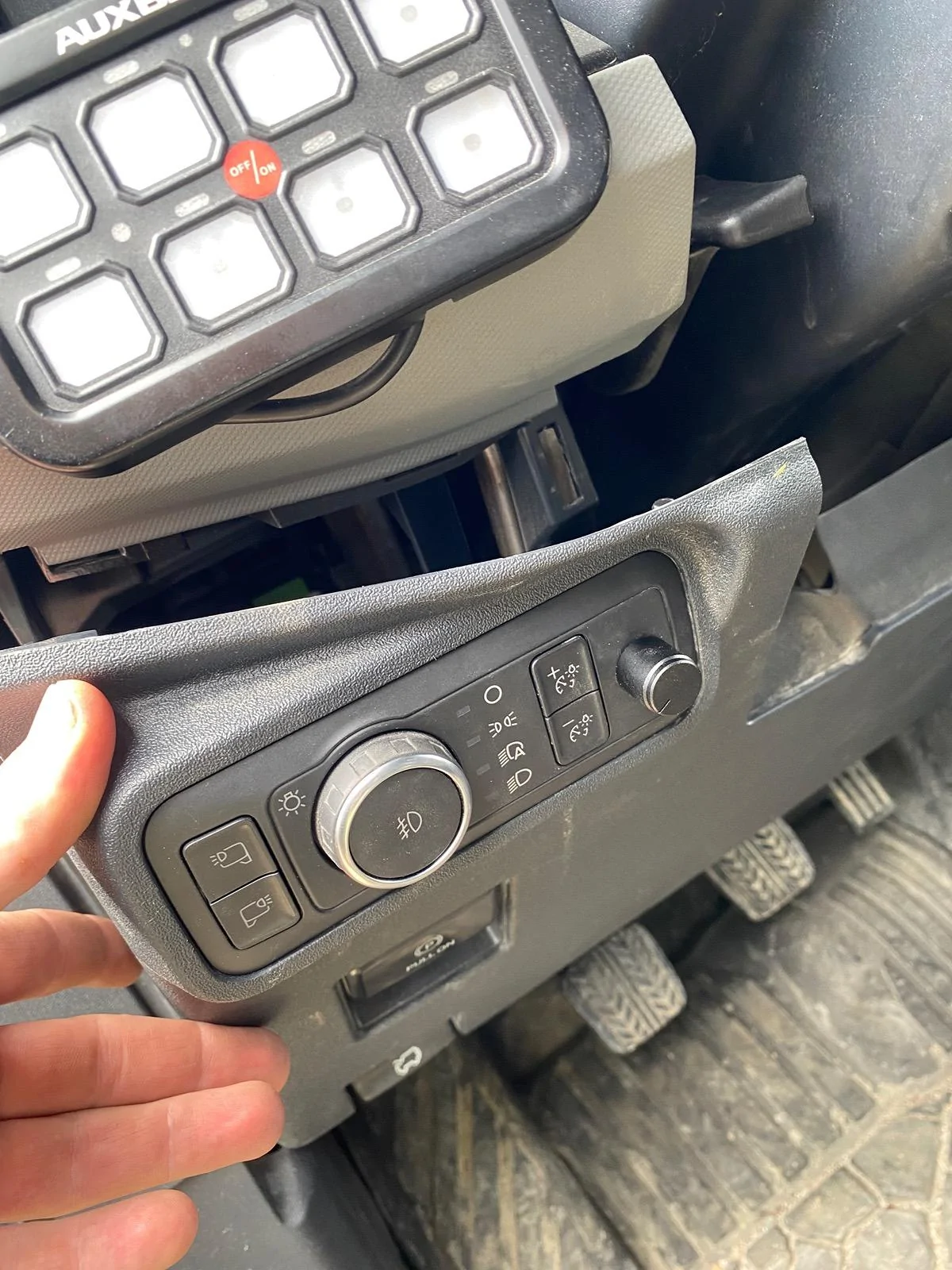

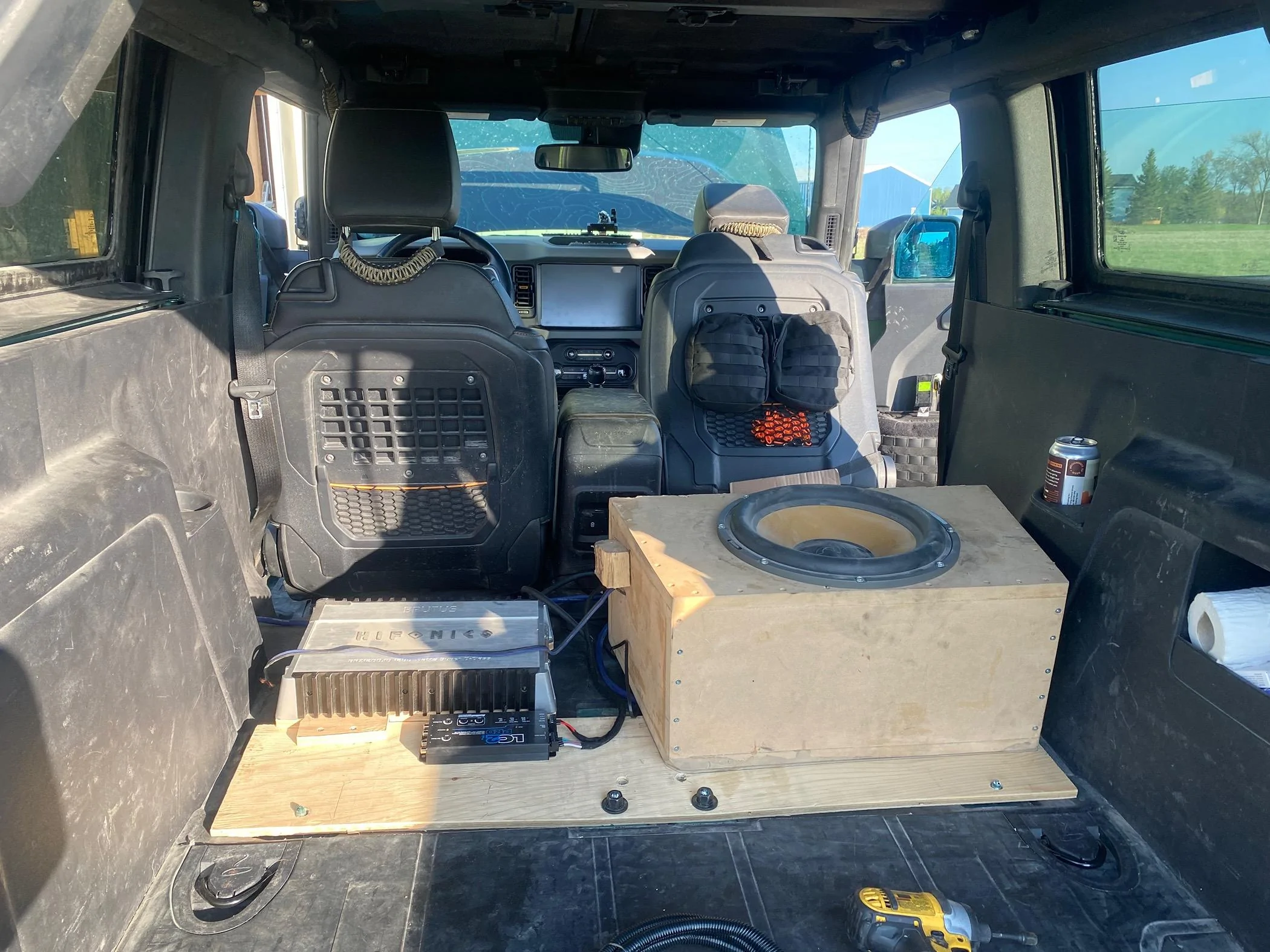

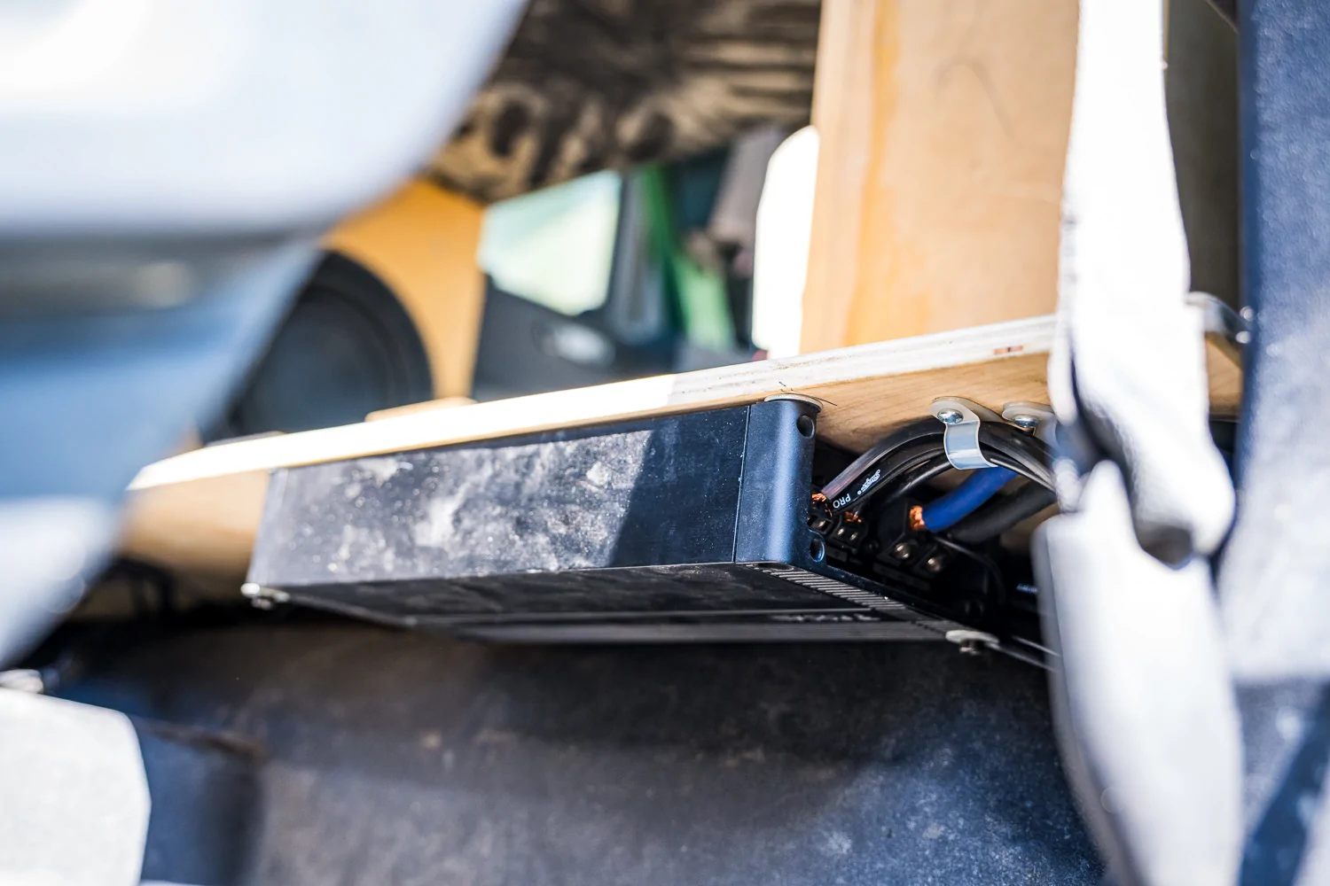

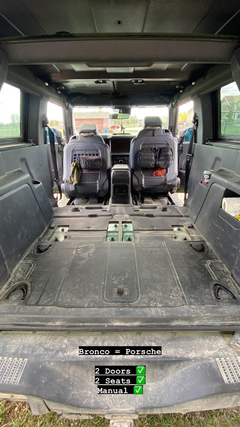

Next was the removal of the rear seats, tearing apart the front of the truck, running harnesses/wires, getting the audio system roughed in.

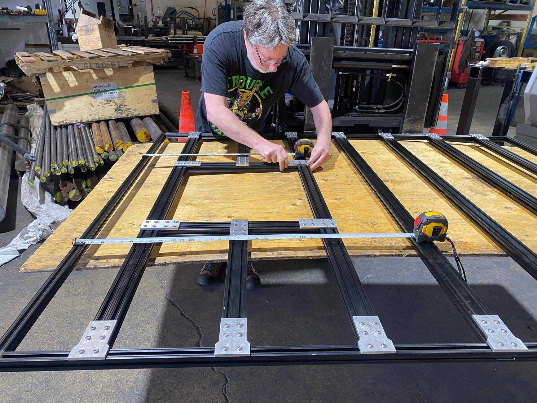

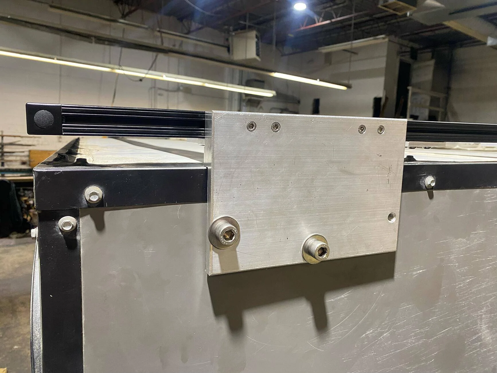

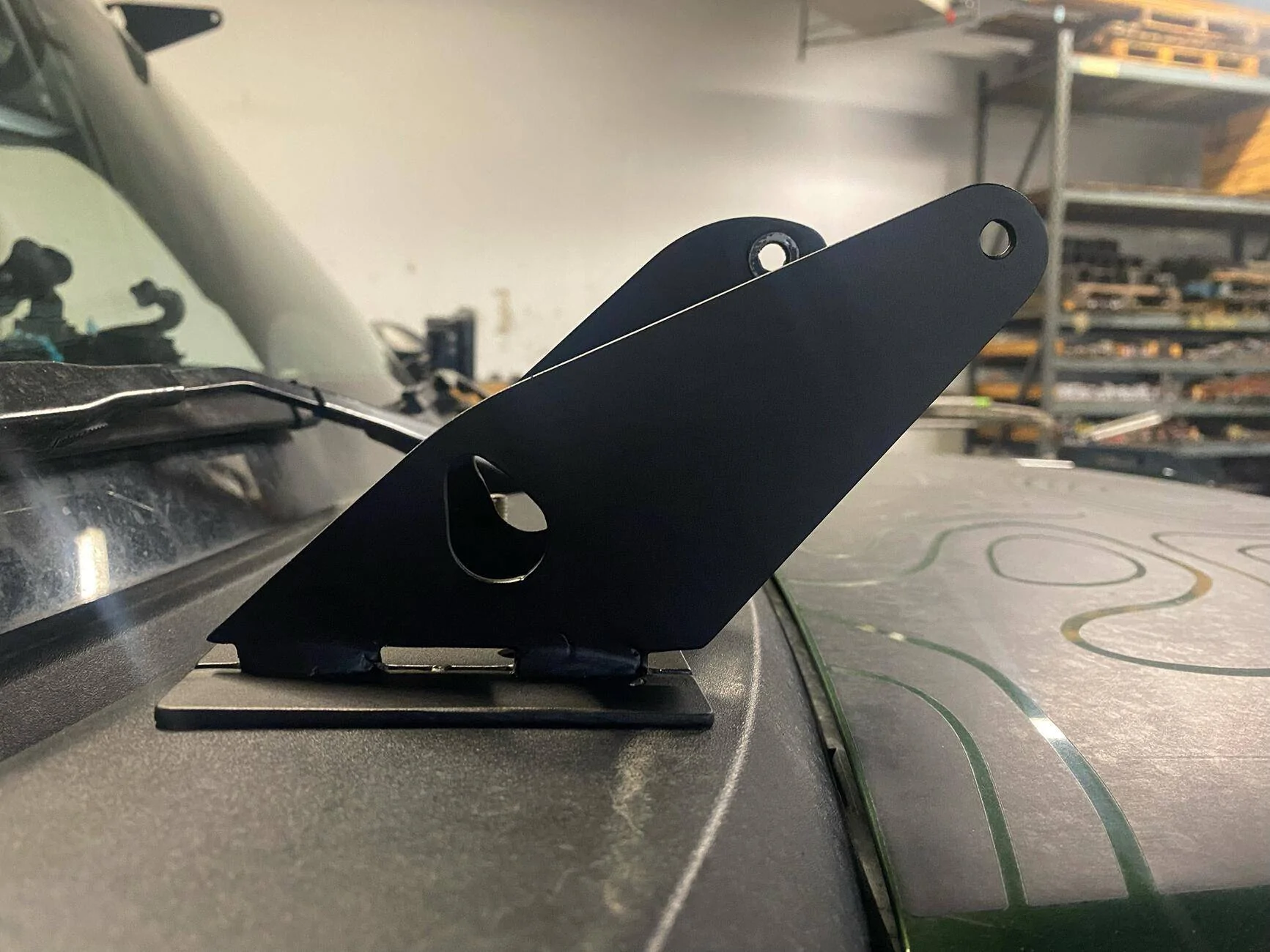

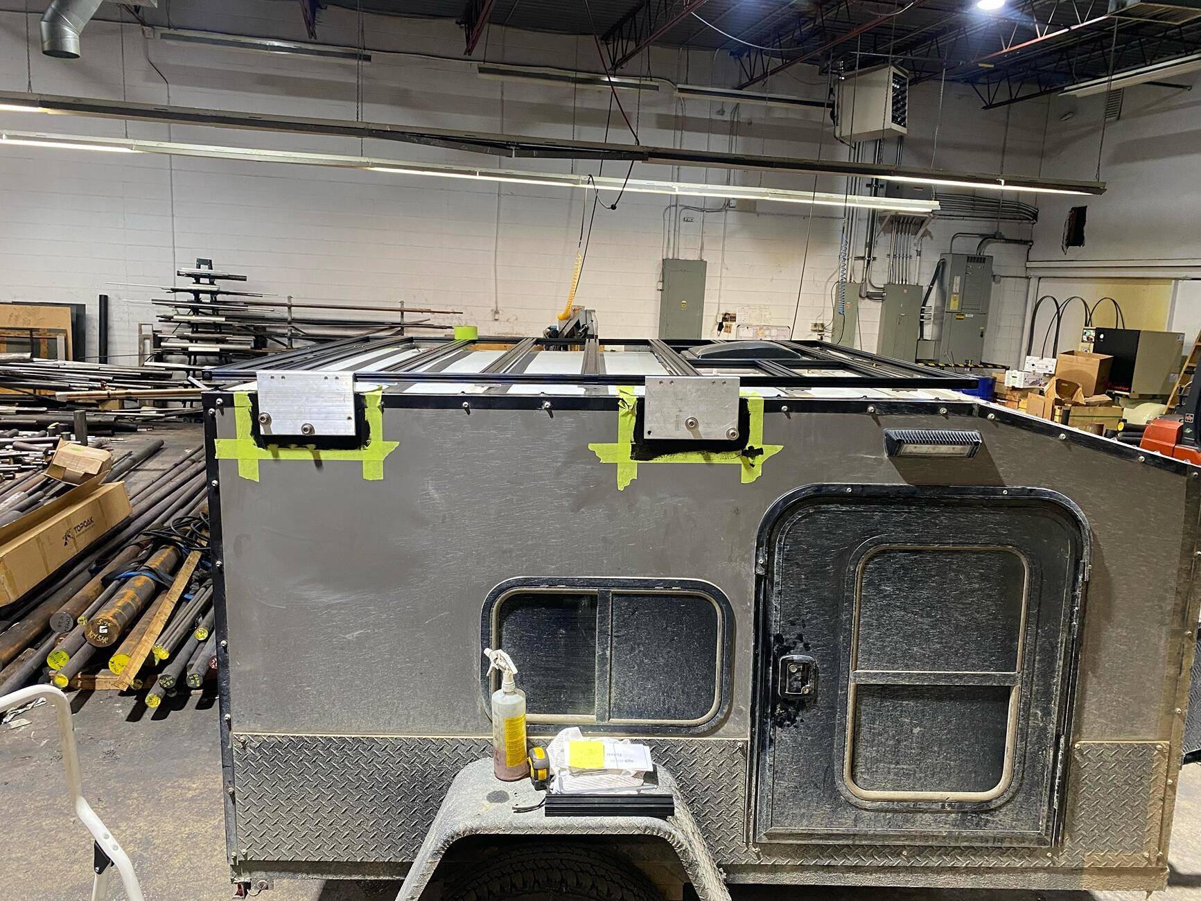

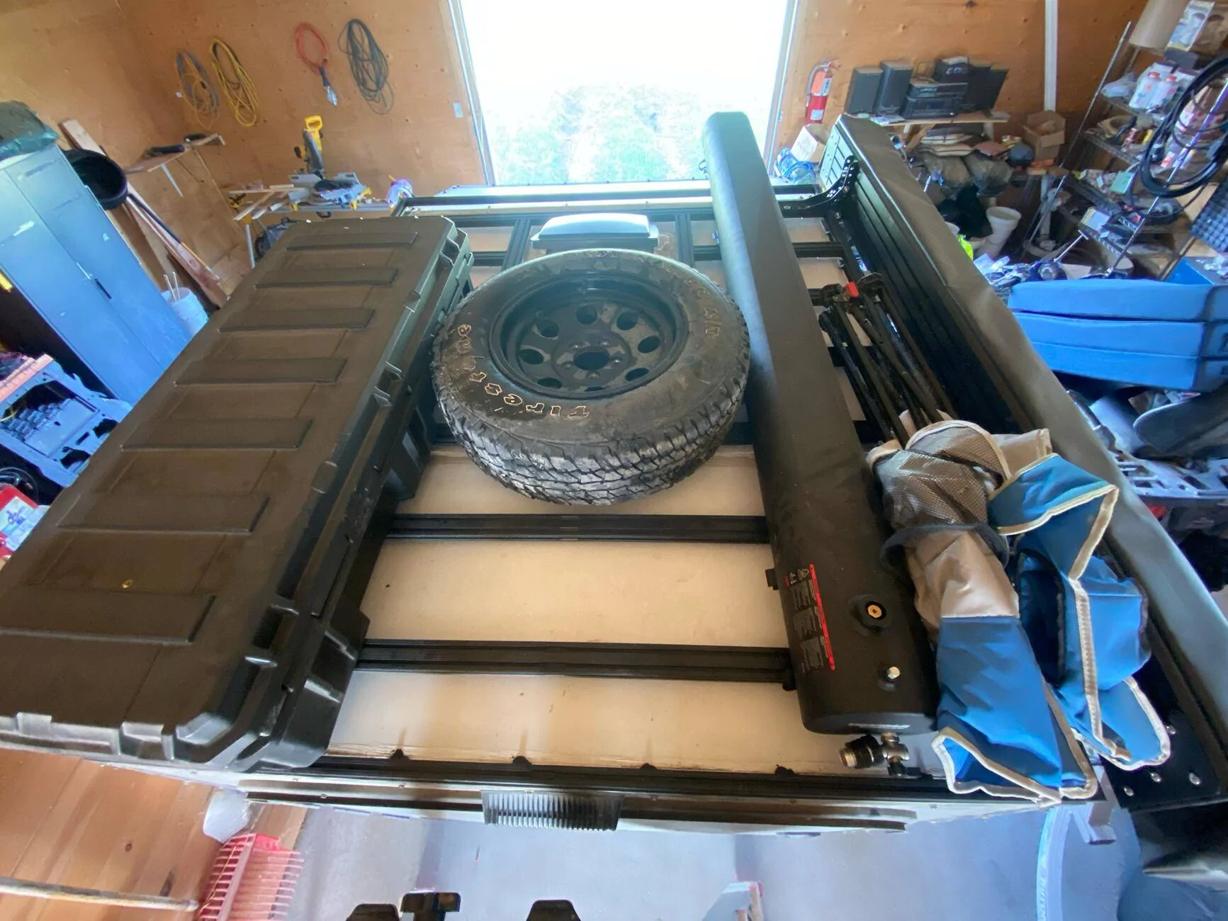

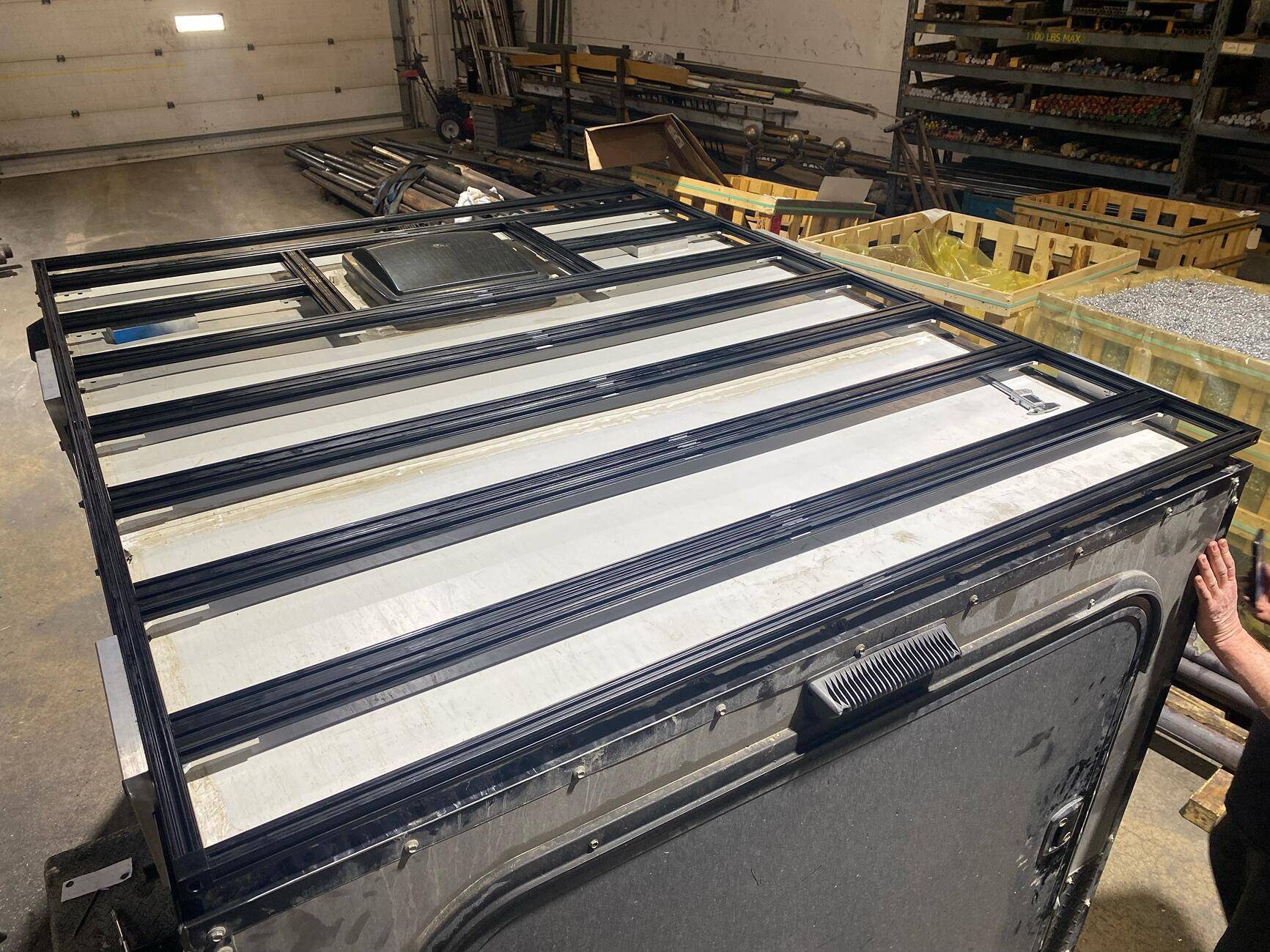

The JCR Utility Rack seized up - it was sold with a blend of Stainless and Steel hardware - not as initially advertised. A rockslide engineering mount was swapped in to retain the rotopax.
Ford Bronco The Boreal Badlands IMG_9603

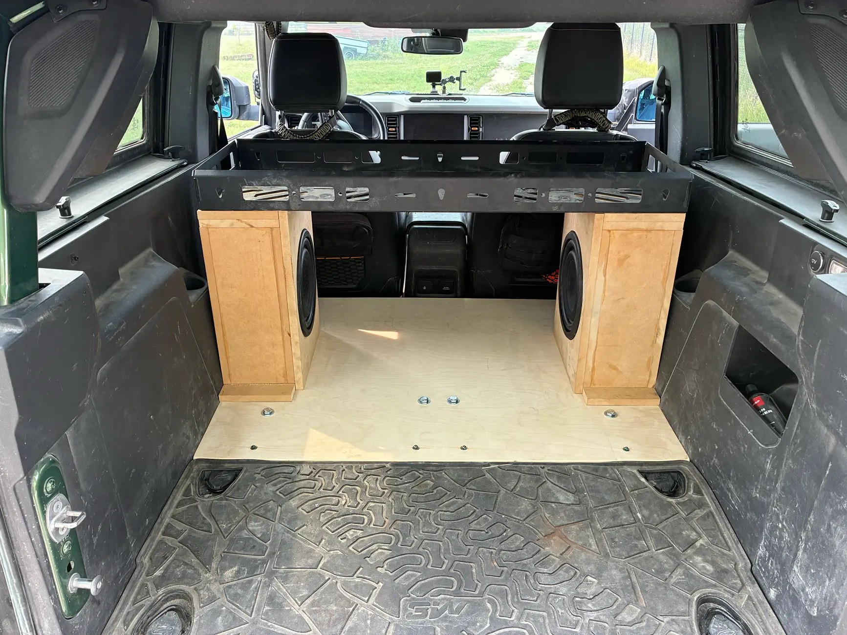

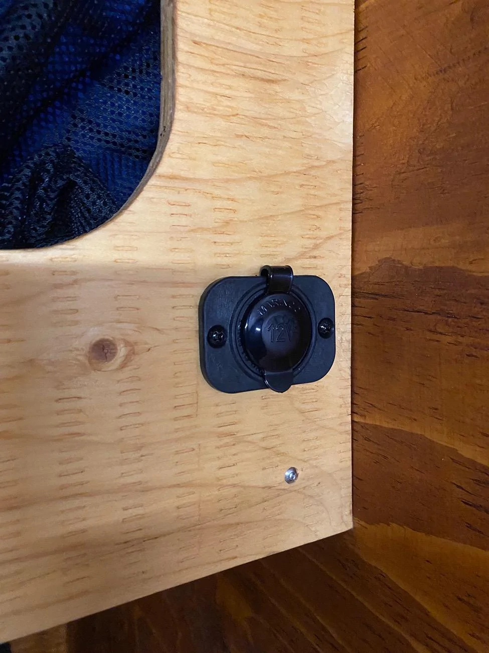

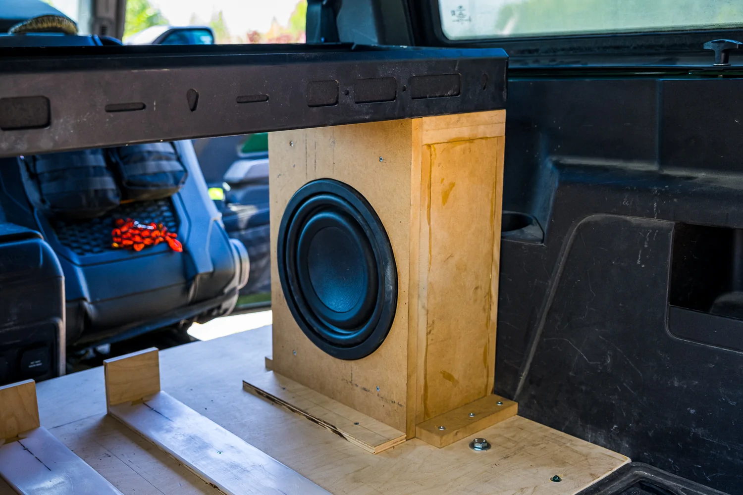

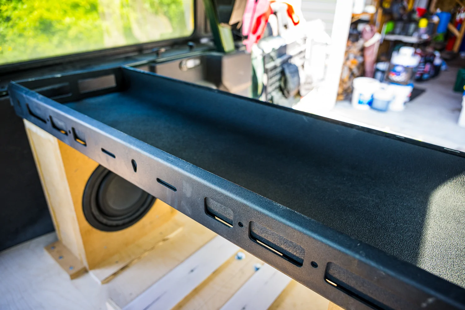

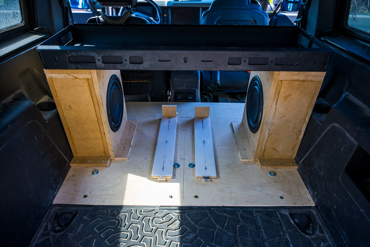

The best part about the rear seat removal is the access to the power ports in the rear; I can now charge/process media on the drives to and from!

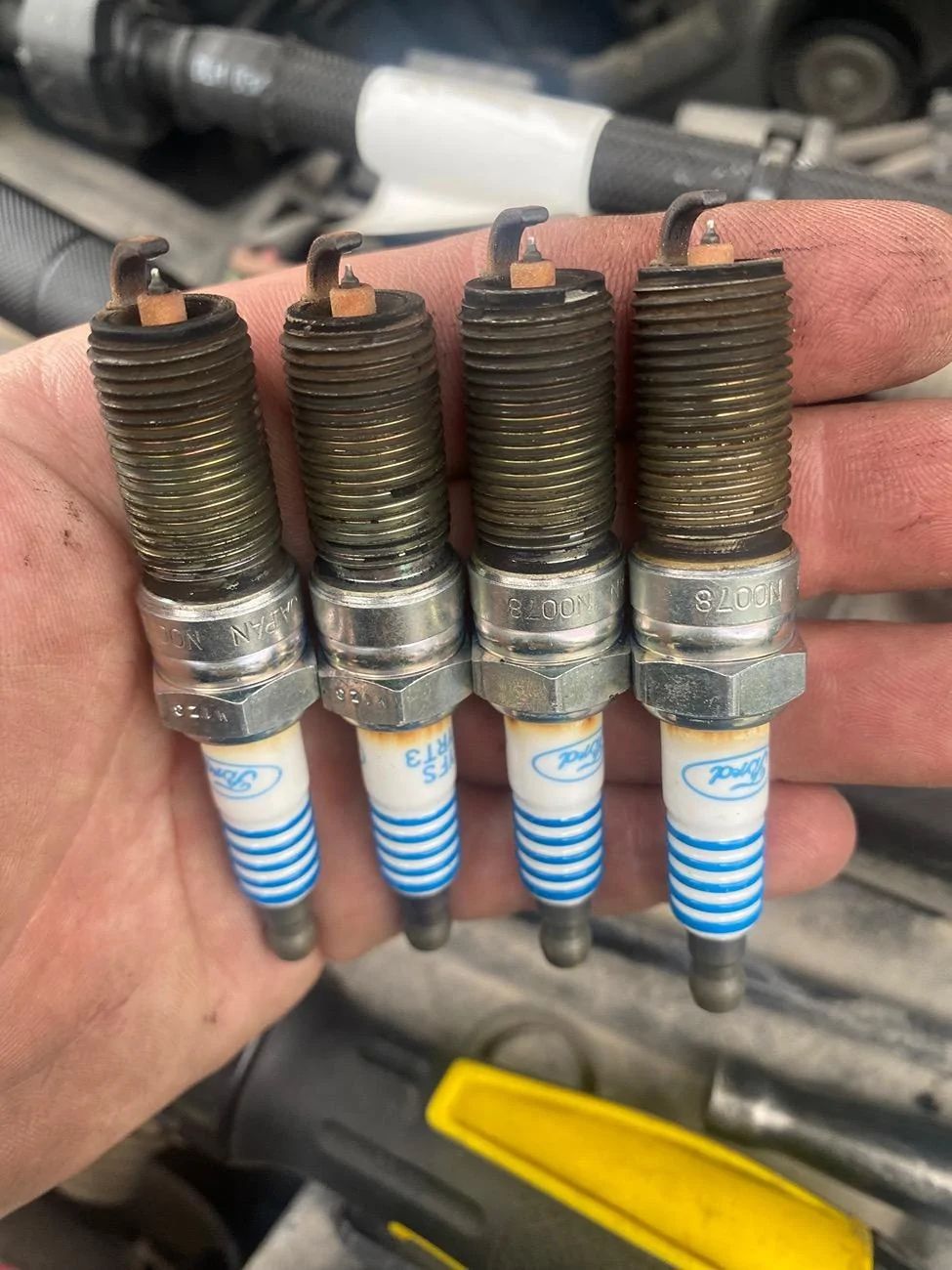

Wow, it’s been a minute. Where to begin?
I swapped out that Vacuum Line, a few green clippy vacuum connecters and one electrical connector. Easy peasy, No problems since. Some pre trip maintenance has been another tire Rotation and OCI, IAF, and Sparkplugs! Oh, and reaimed the headlamps for the extra weight with a full tank of fuel, gear and the camper

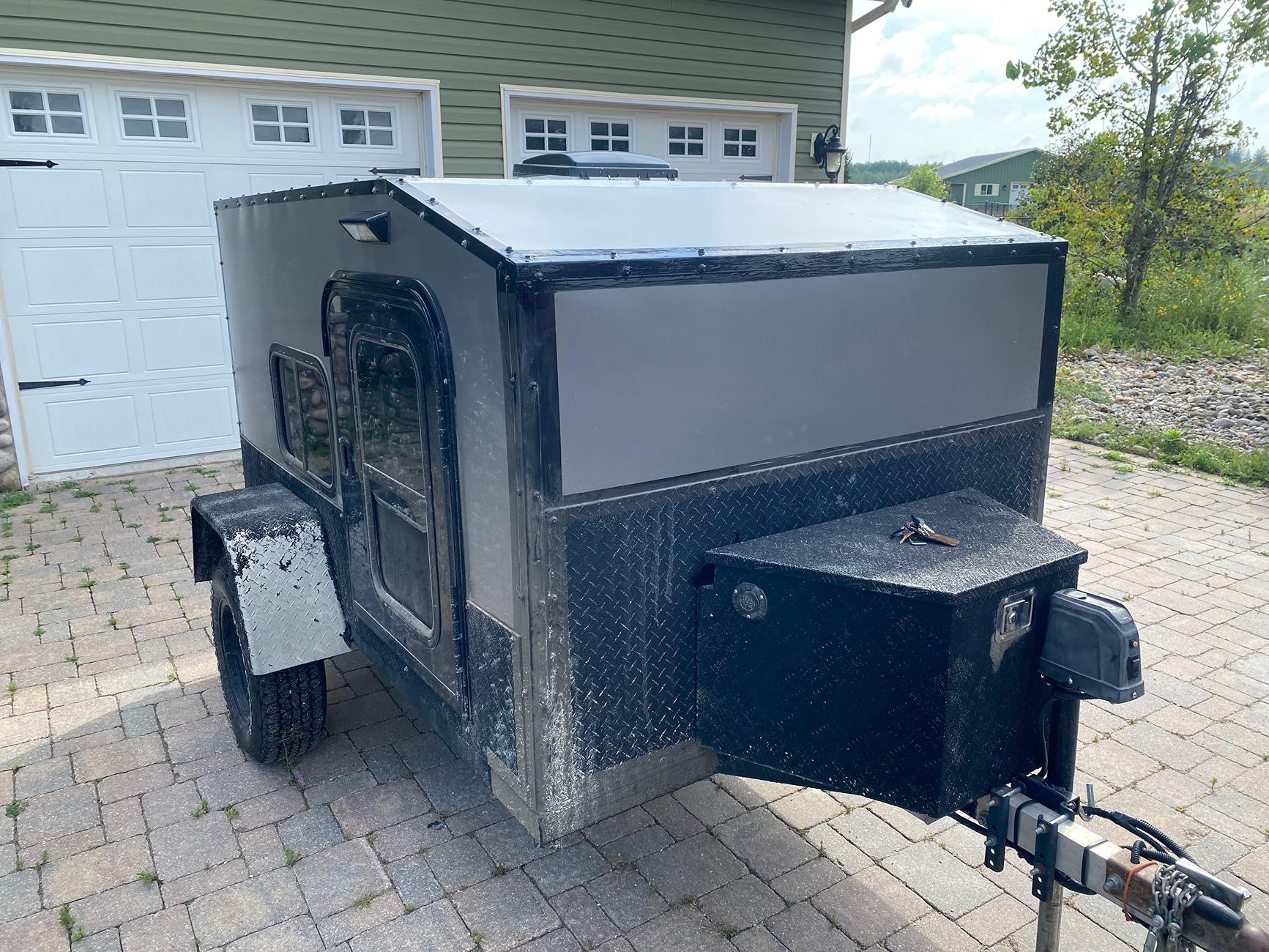

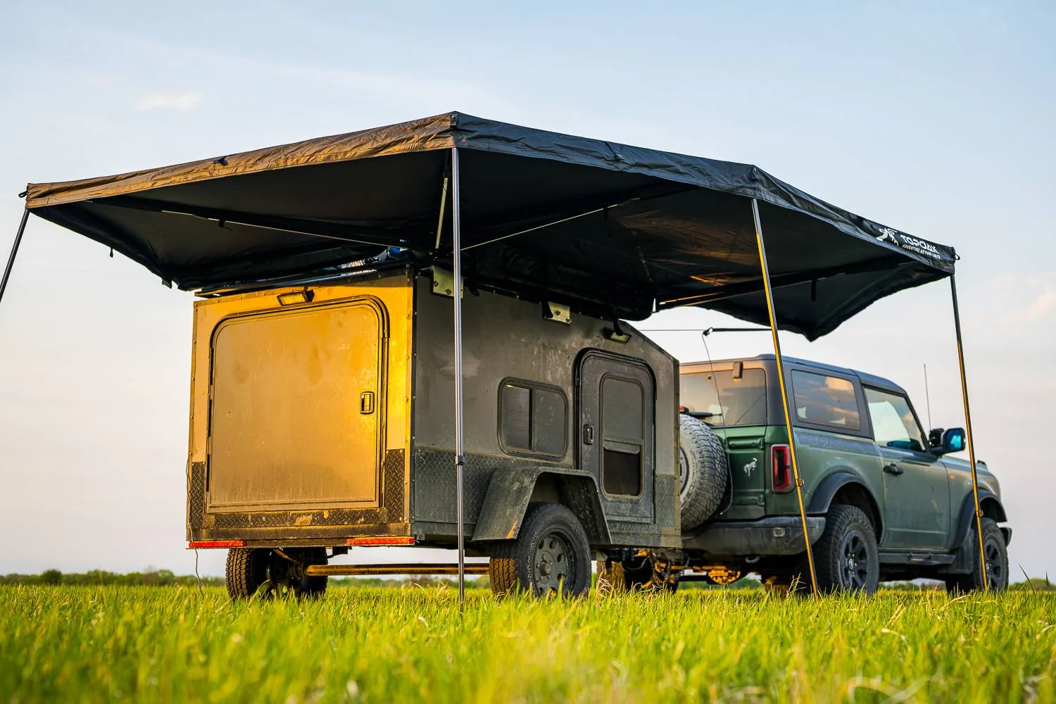

The majority of spare time has been allocated to the camper… which is somewhat of an extension of the bronco, so I’ll dive into it - we have just embarked on a five week journey to Alaska.

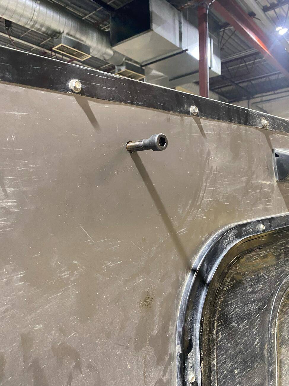

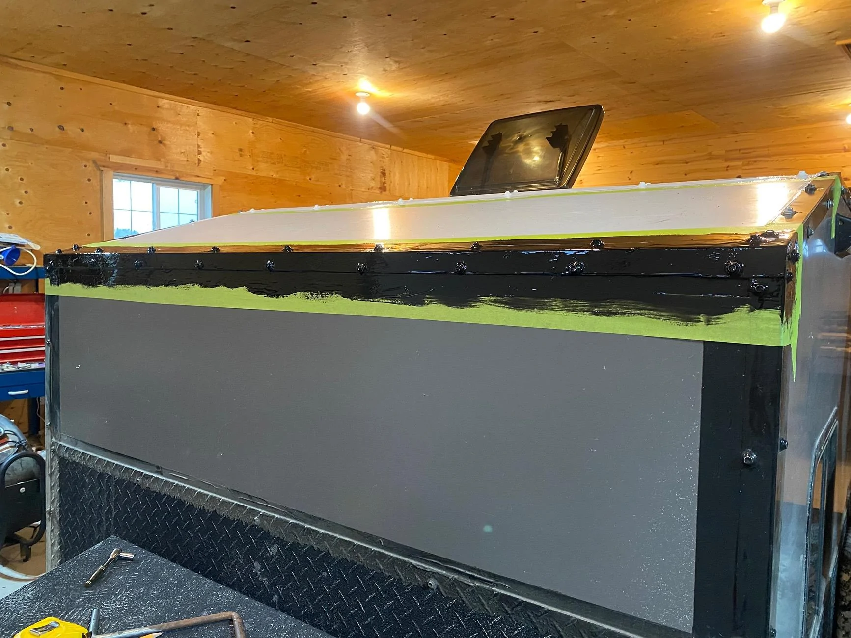

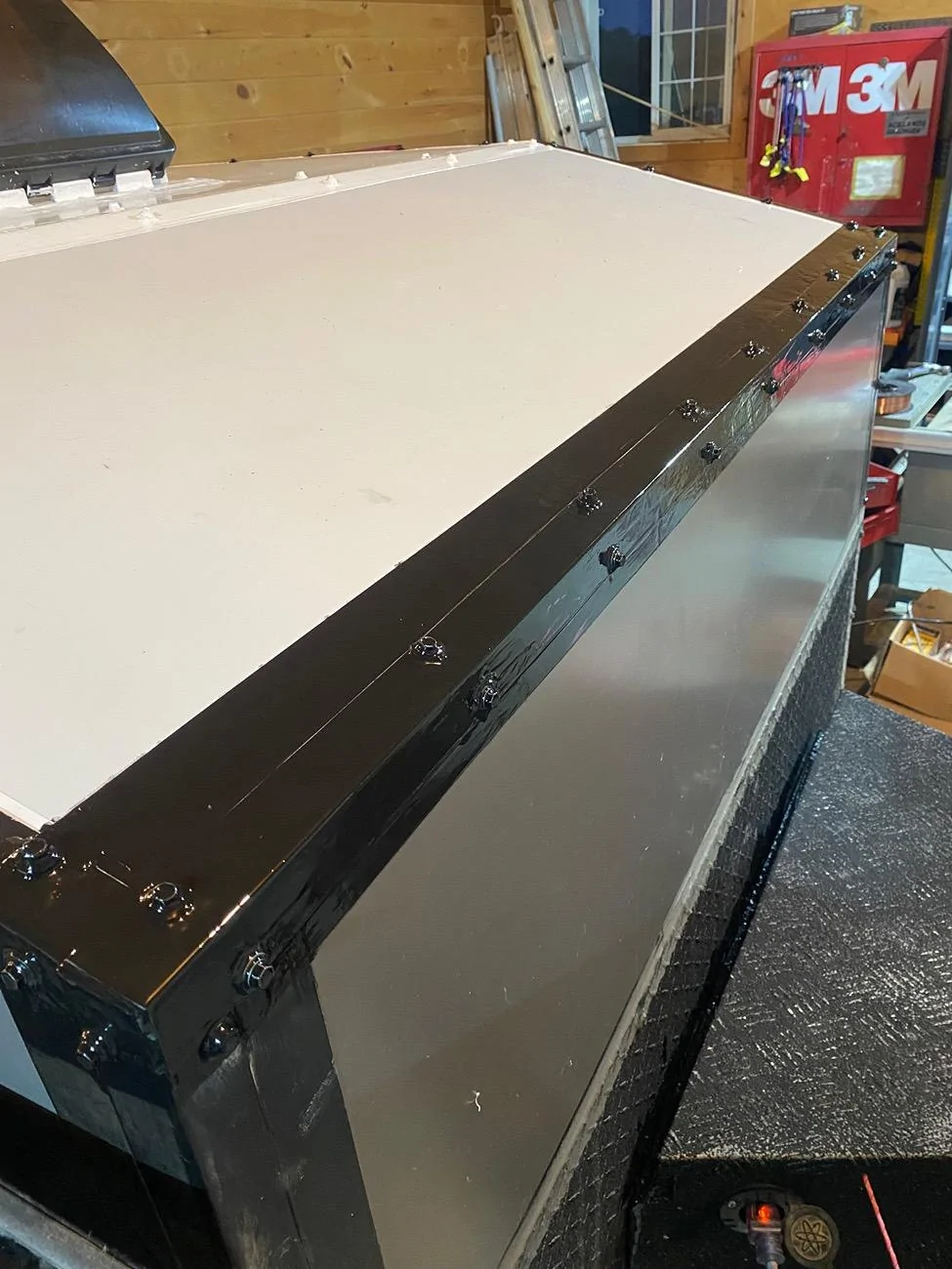

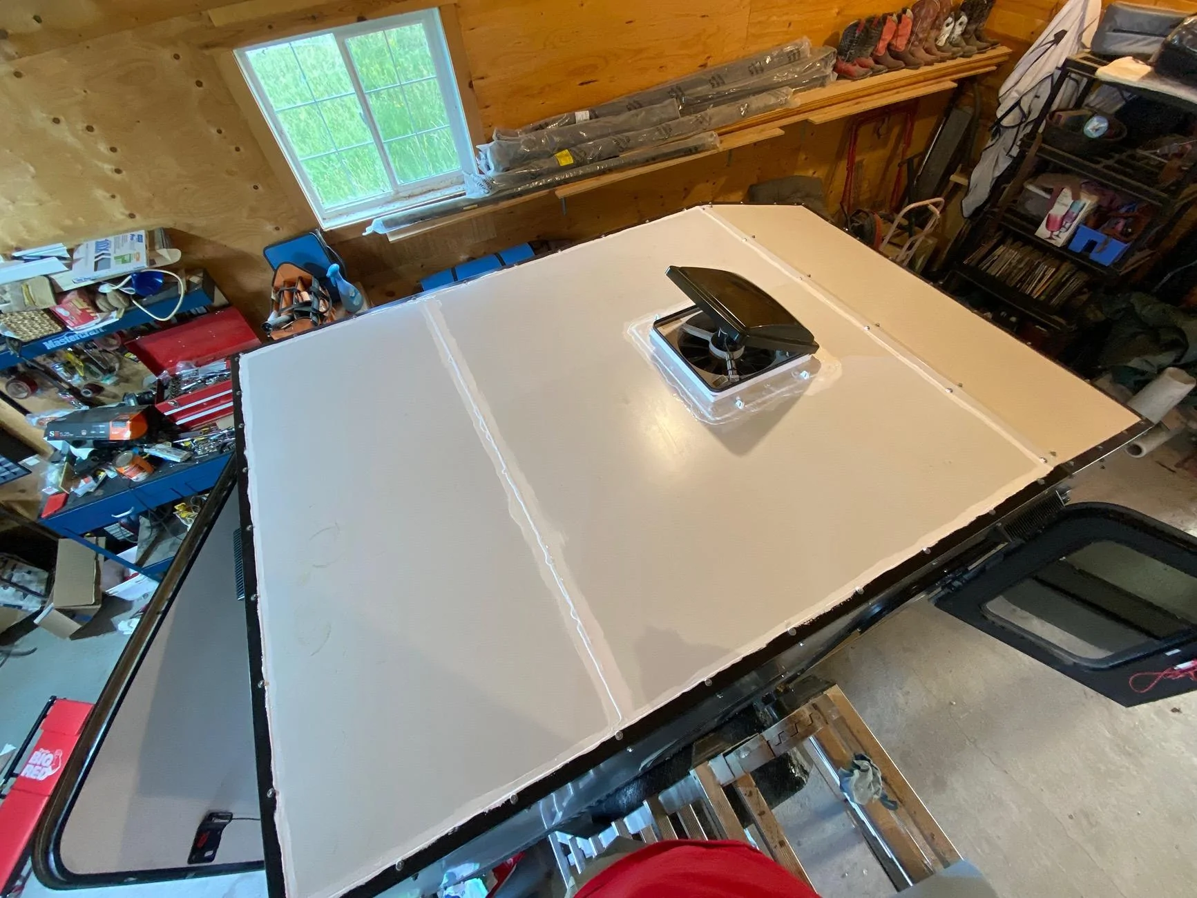

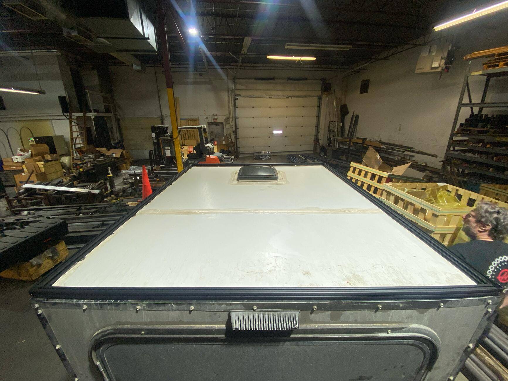

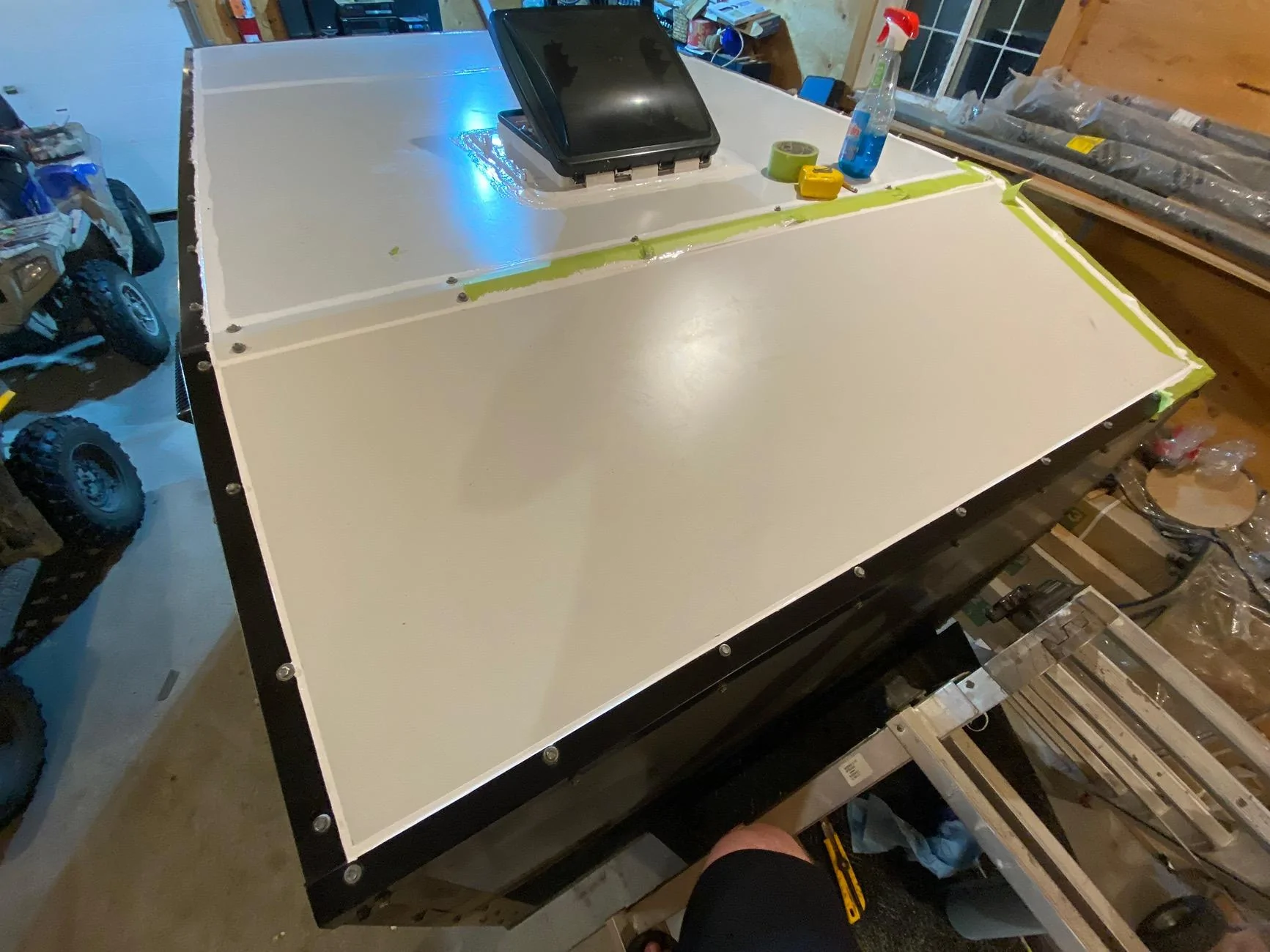

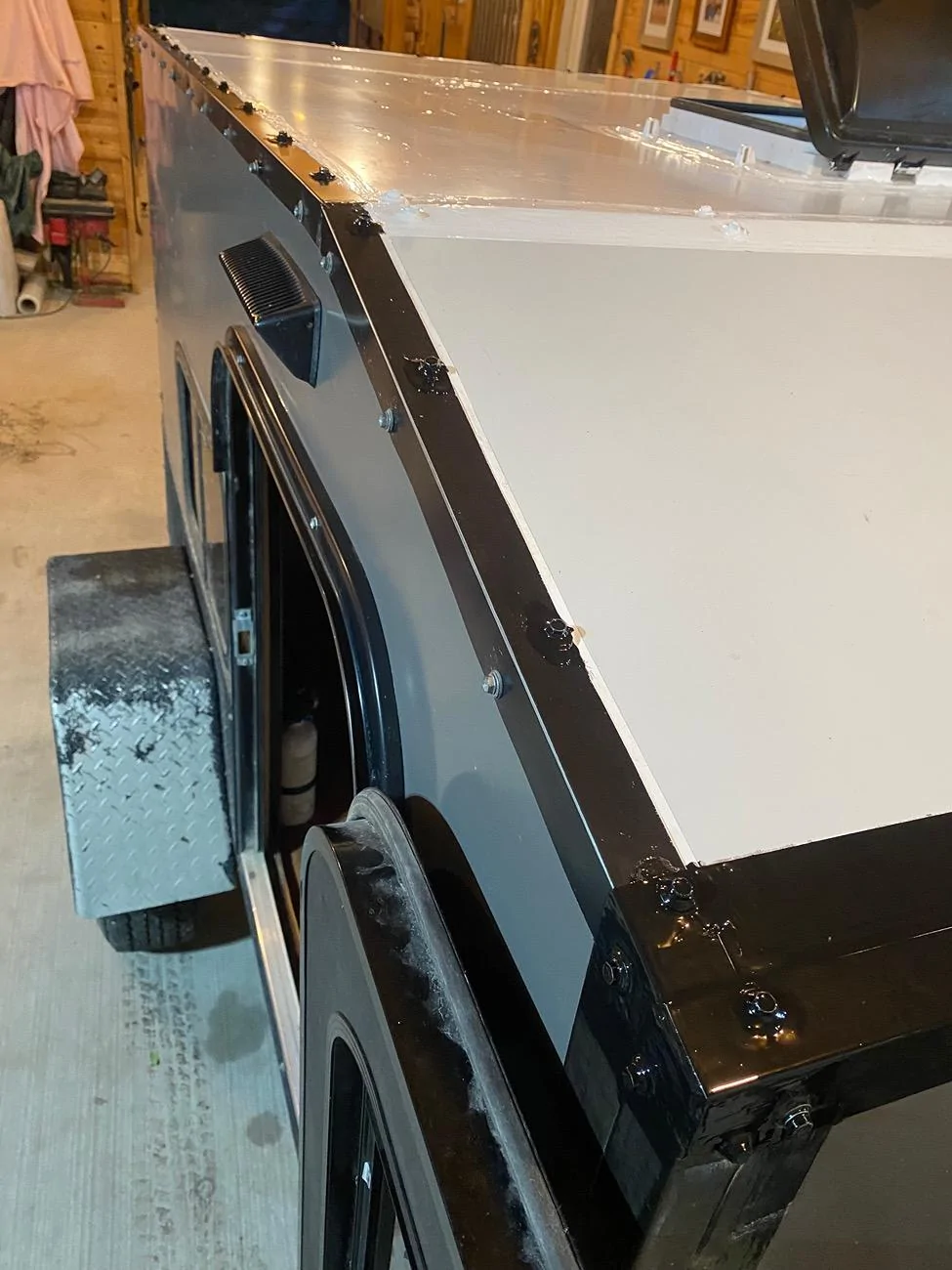

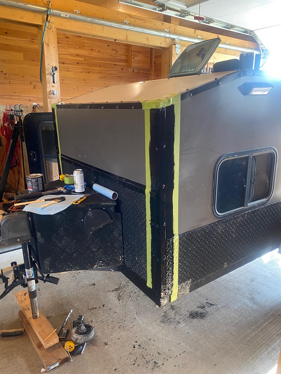

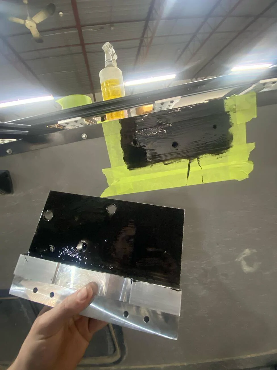

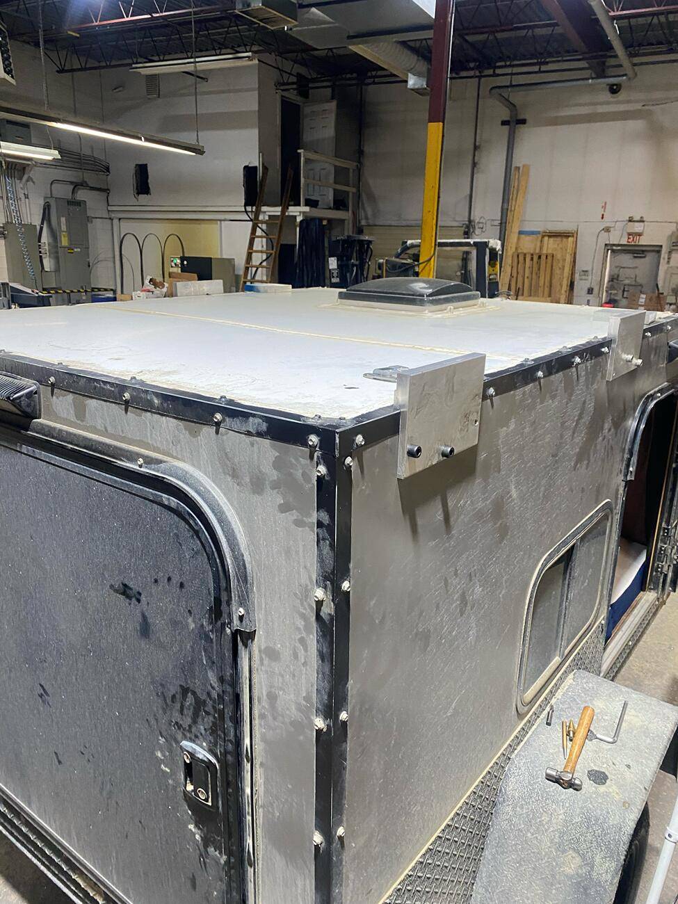

Let’s start with the sealant. Initially I thought the water was getting in via the leading edge - it’s right behind the bronco wheels and constantly getting bombarded with weather. That initial sealing job didn’t solve the problem, next up was all the roof seams. Unfortunately, also a no go. Finally I resorted to replacing every rooftop fastener with a SS edition, adding sealant within the holes as well as on top of.
Ford Bronco The Boreal Badlands IMG_1490
Ford Bronco The Boreal Badlands IMG_2606
Ford Bronco The Boreal Badlands IMG_2683
Ford Bronco The Boreal Badlands IMG_2733
Ford Bronco The Boreal Badlands IMG_2732
Ford Bronco The Boreal Badlands IMG_2734
Ford Bronco The Boreal Badlands IMG_2739
Ford Bronco The Boreal Badlands IMG_2740
I’ve yet to truly test the final version with fresh sealant and hardware.. but it’s more of a “ready or not, here I come” scenario. Soo, we will see.

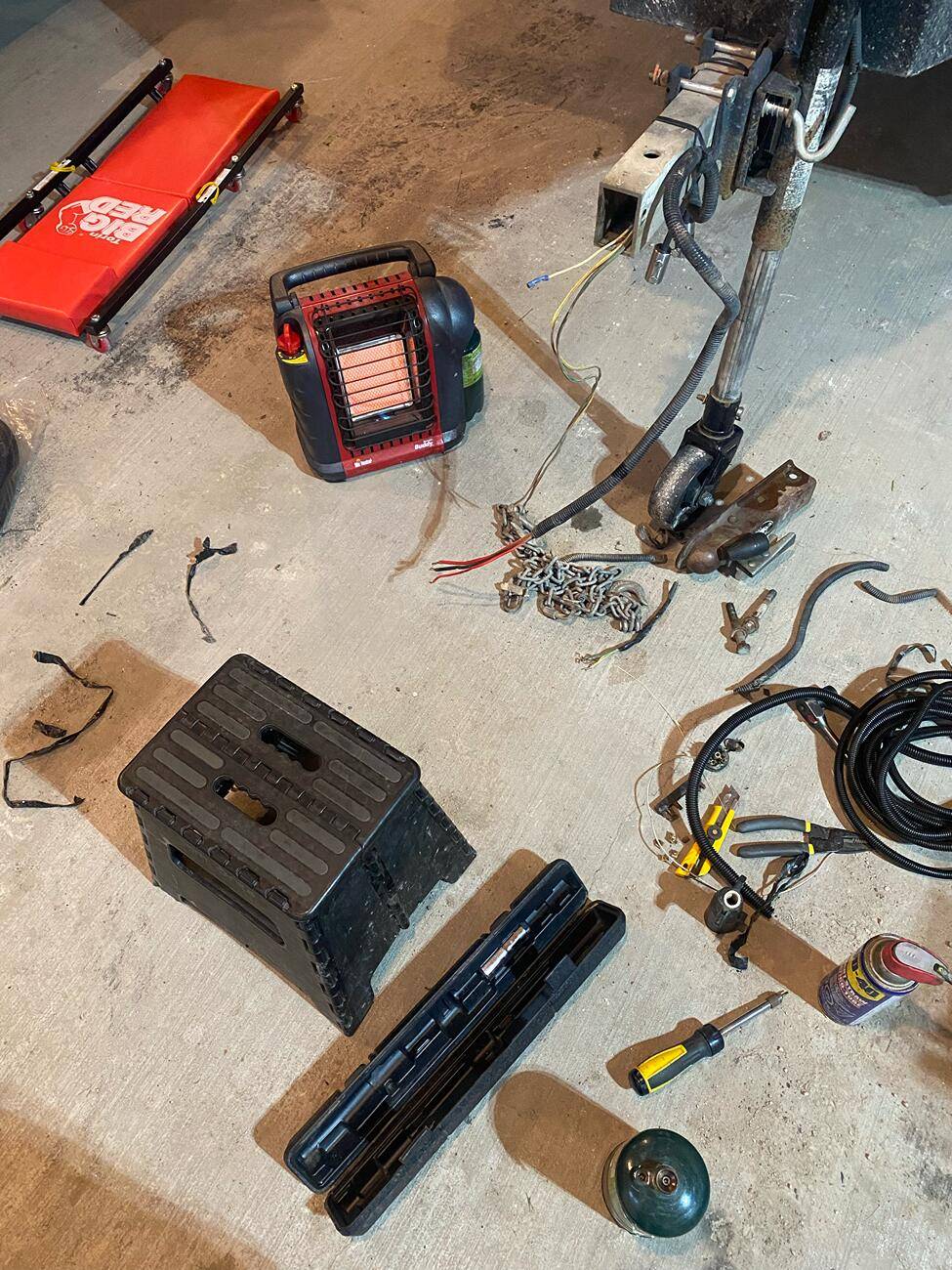

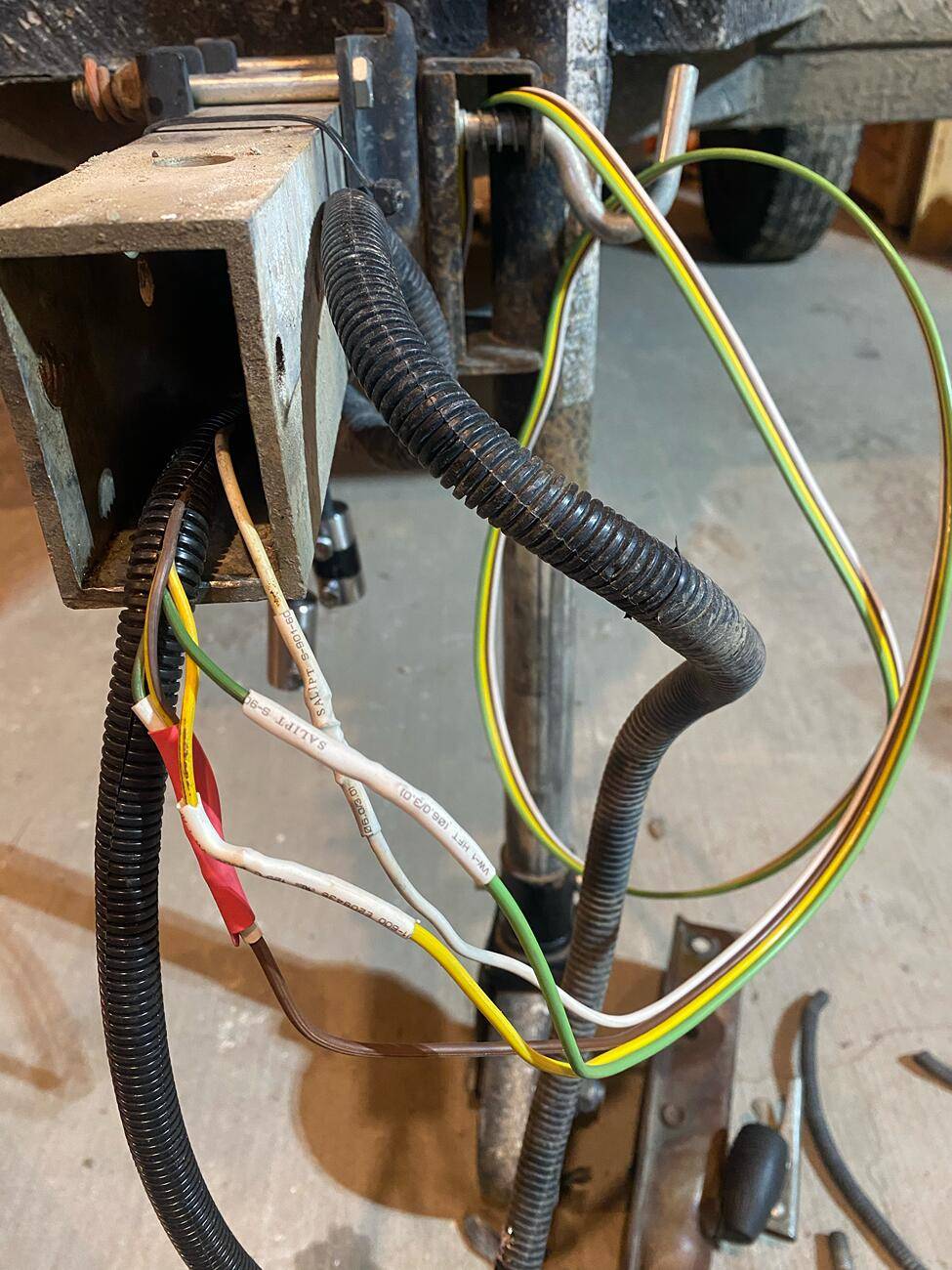

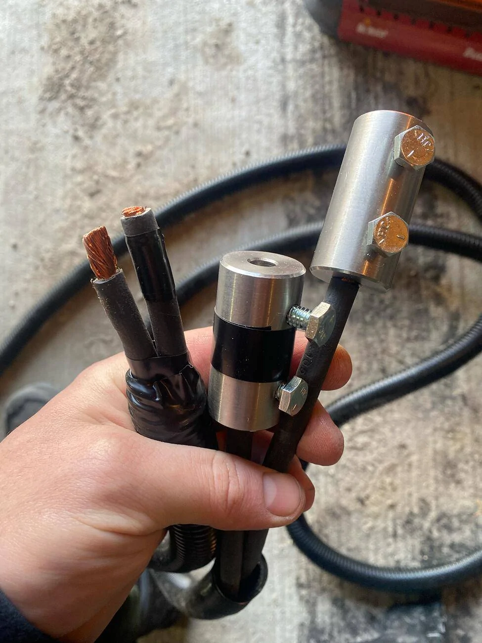

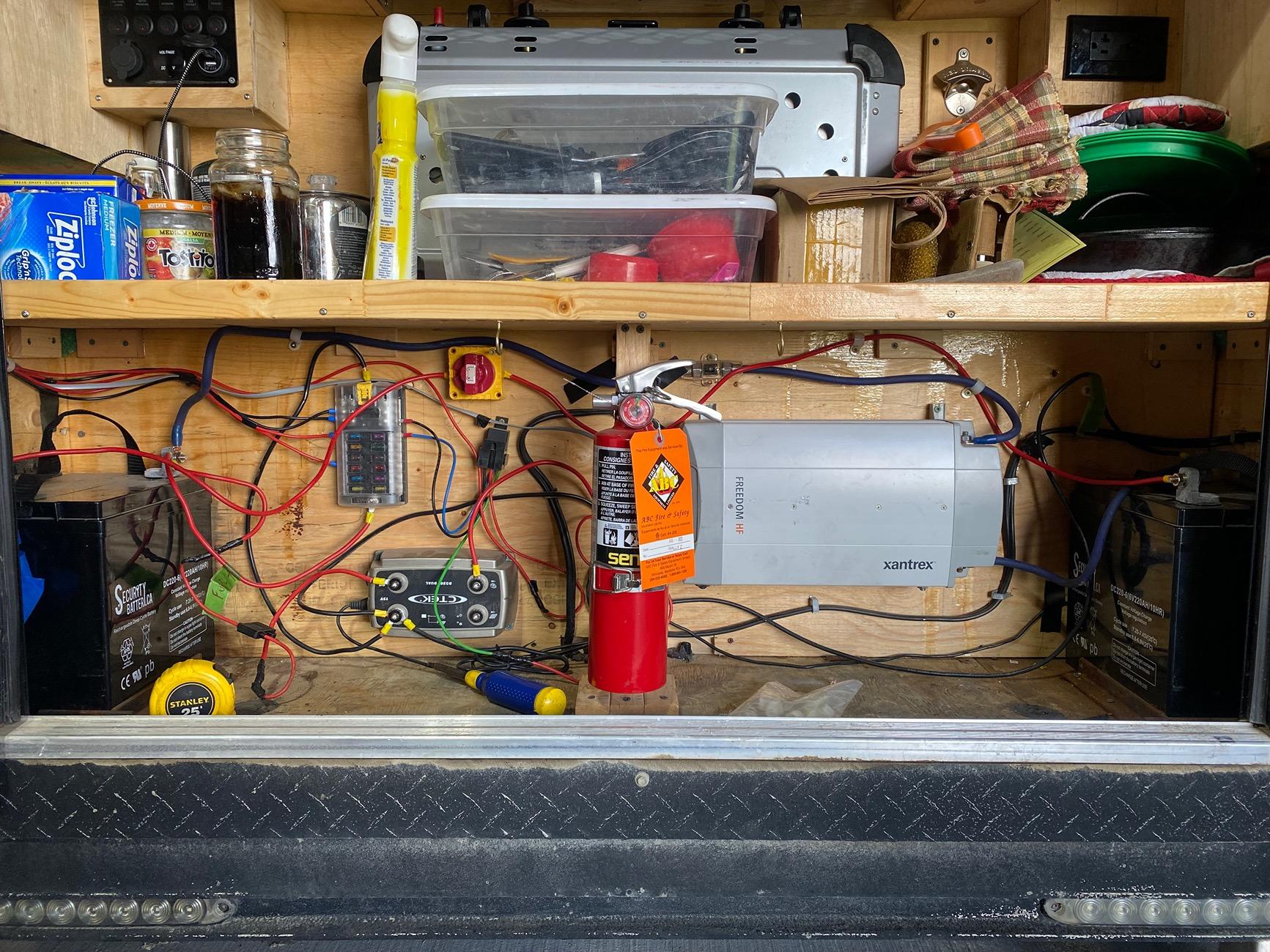

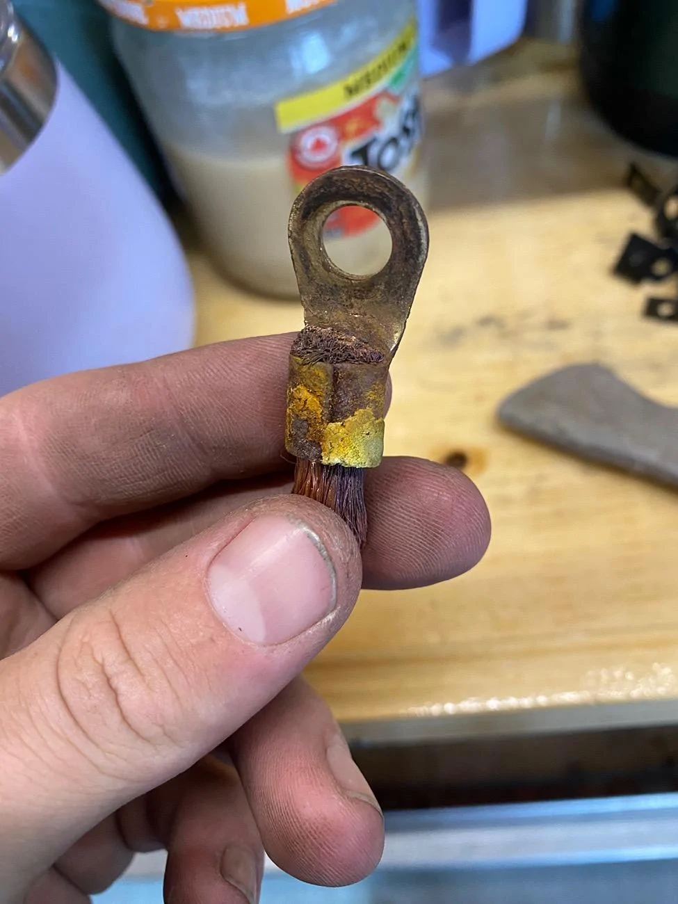

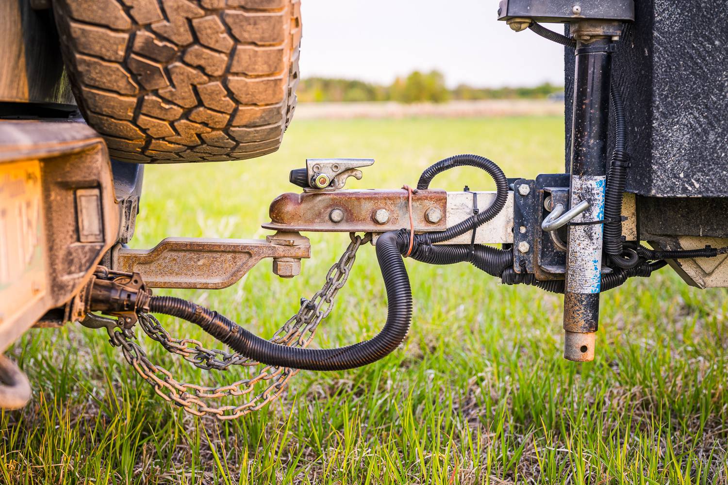

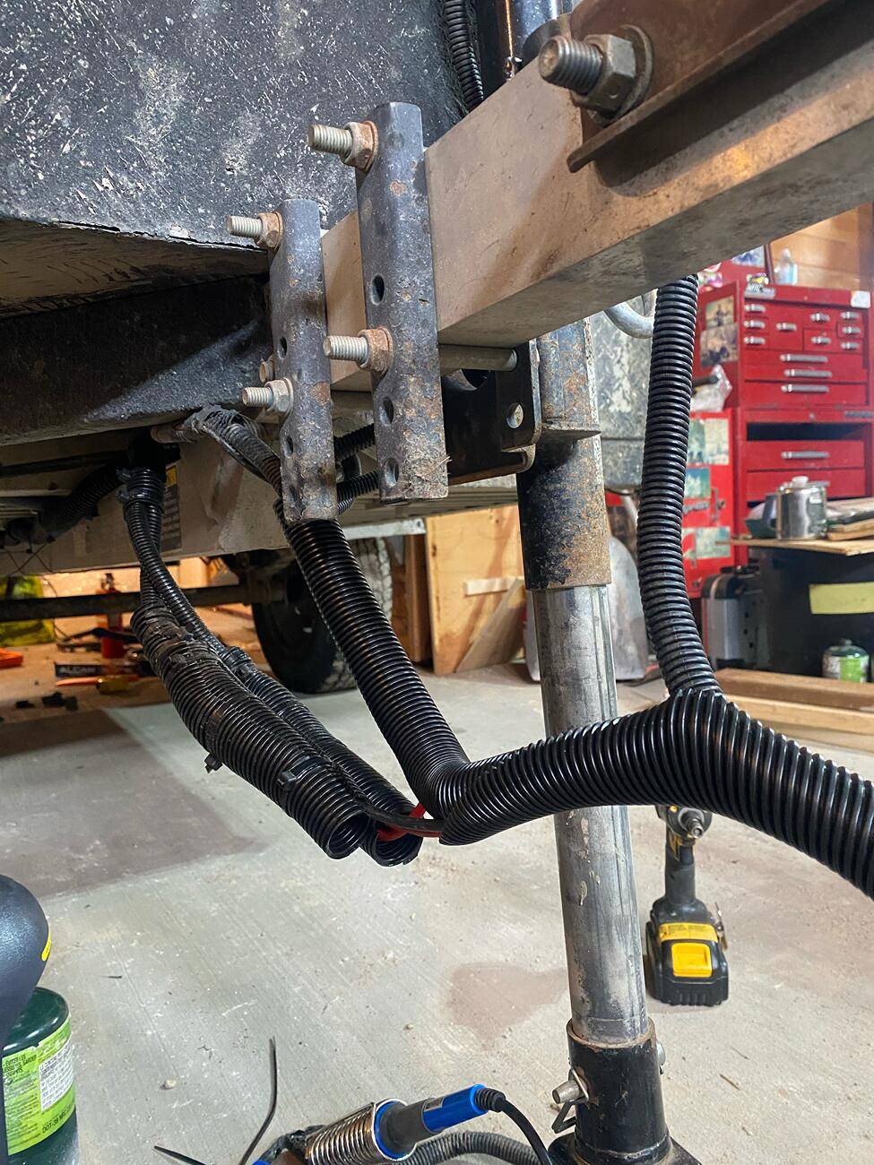

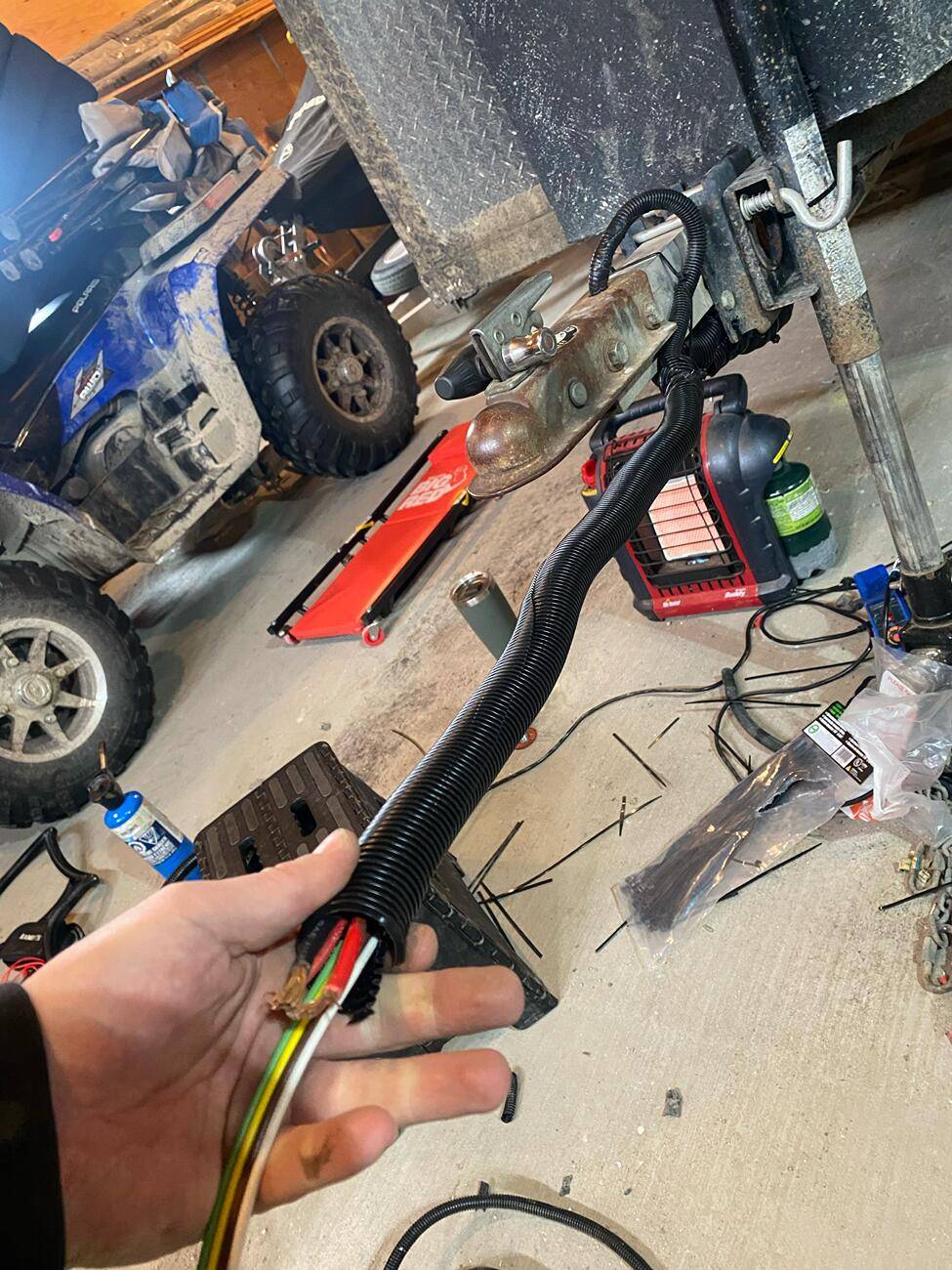

In addition to the sealant was a bunch of wiring work. All main battery lines were swapped from 8GA to 6GA. Everything was hydraulically crimped, shrink wrapped, and shortened up. Don’t judge me 😂, the initial build was very much “just get it going”
Ford Bronco The Boreal Badlands IMG_2620
Ford Bronco The Boreal Badlands IMG_2625

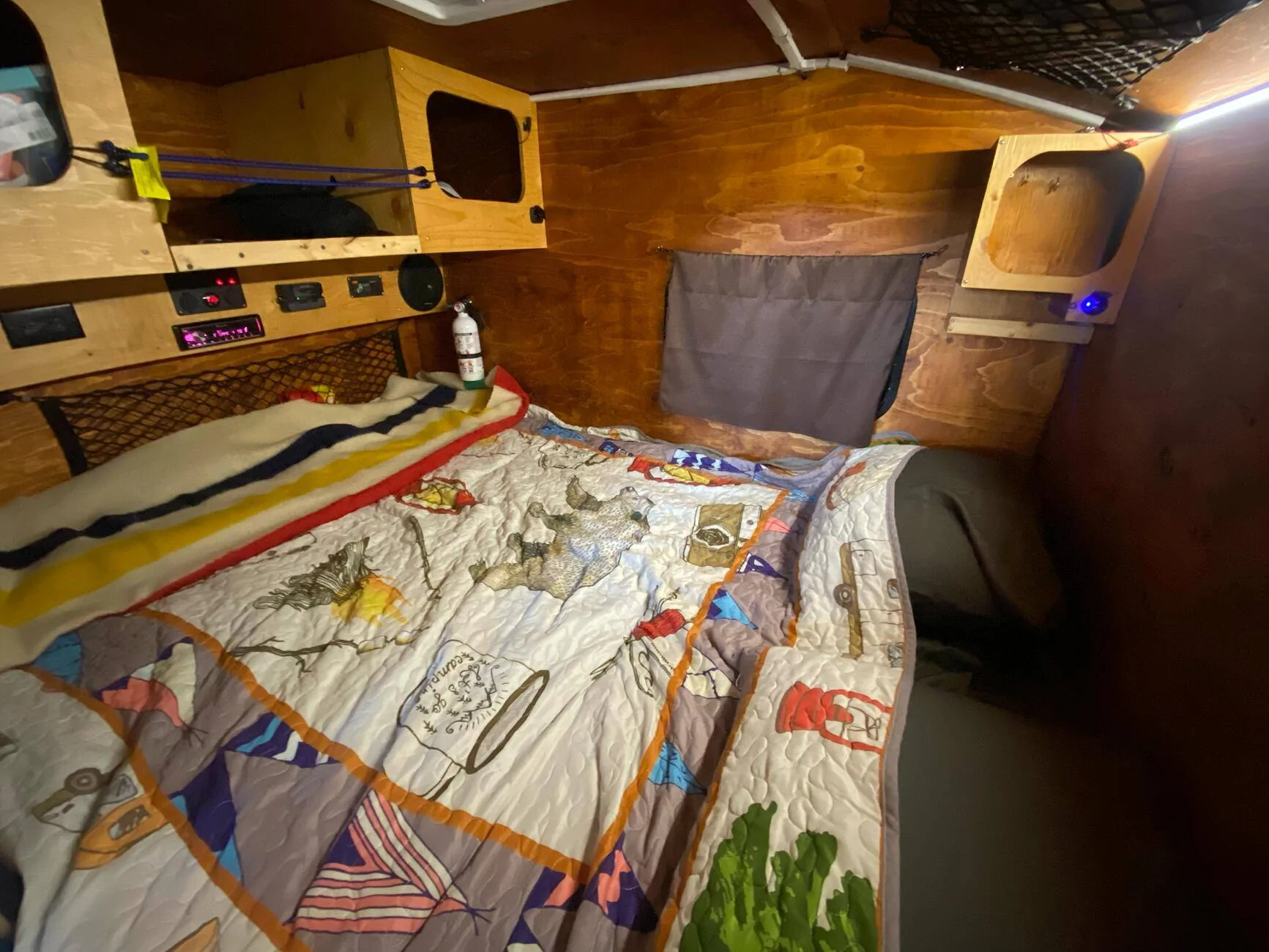

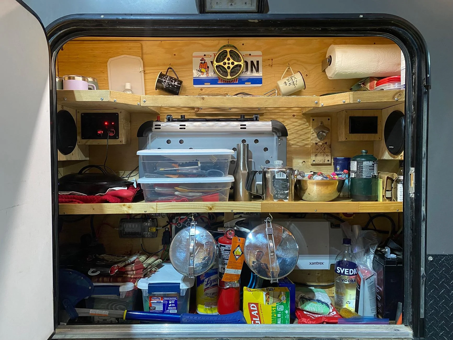

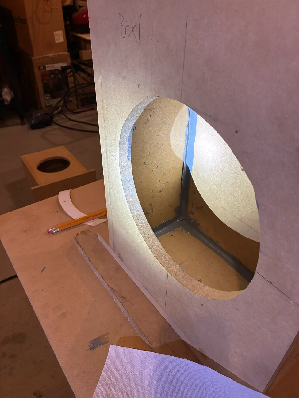

While this was being tackled, I added in the Camp Kitchen Speakers, and an 8GA circuit for a high wattage 12v charger. In an attempt to become more energy efficient, I I’ll be charging the laptop off of a 100W USBC setup instead of firing up the inverter for 120V, only to be stepped down anyways. (Our initial estimates are about a 4-5x reduction in energy consumption for the same charge). While rewiring and checking efficiencies we came across the culprit for the Inverter/Charger… the negative terminal had severe corrosion under its heat shrink that was causing a massive resistance.

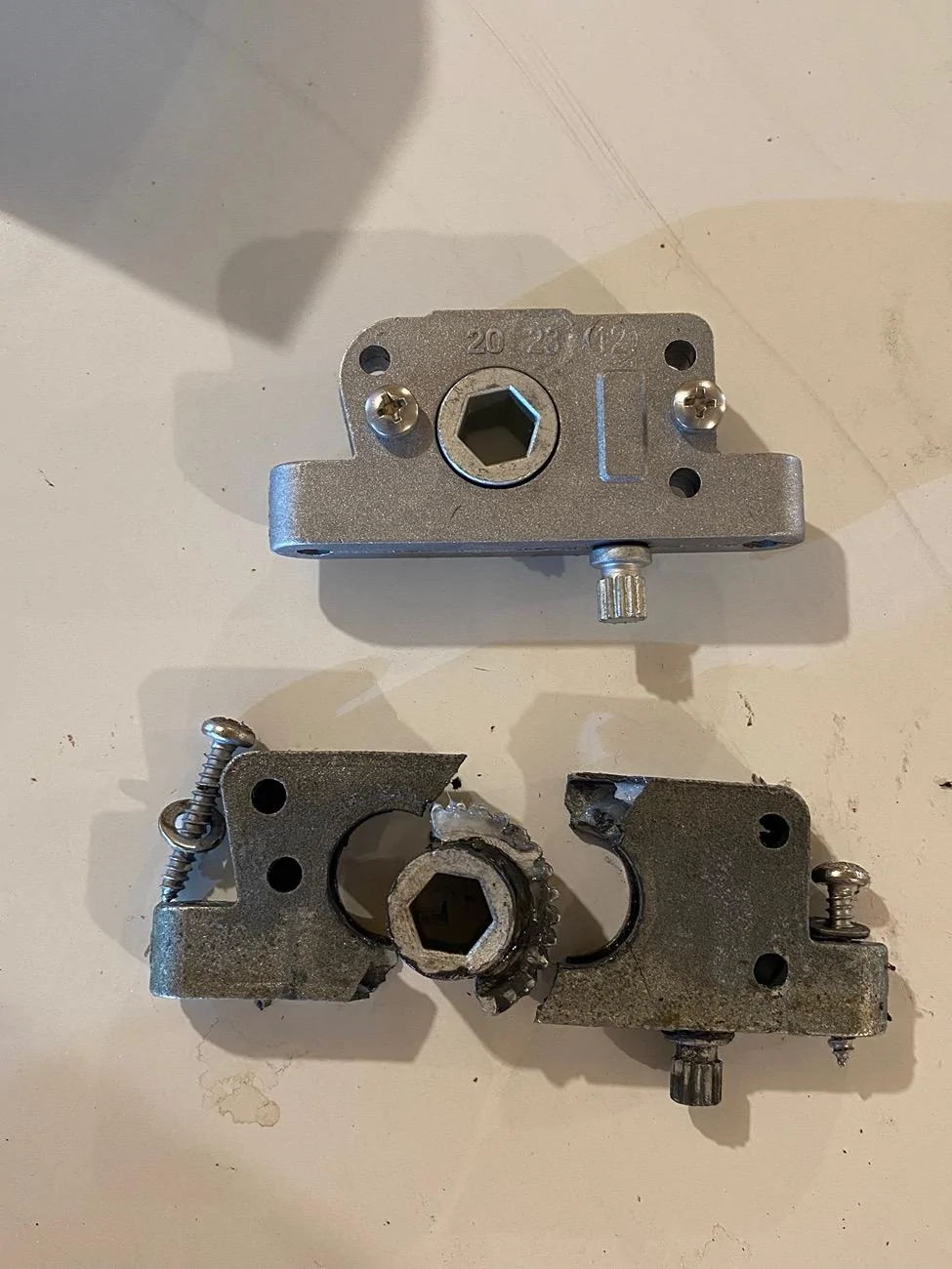

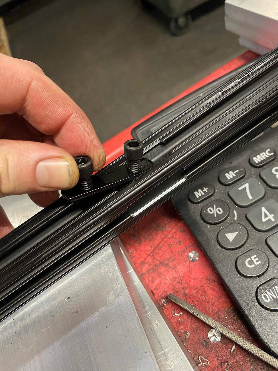

Finally on repairs, the MaxxAir Fans’ hinge assembly decided to give up on life during the second drift trip of the year… a replacement part took it’s sweet time to arrive, but it was a breeze to install and revived the fan for another few treks for sure.

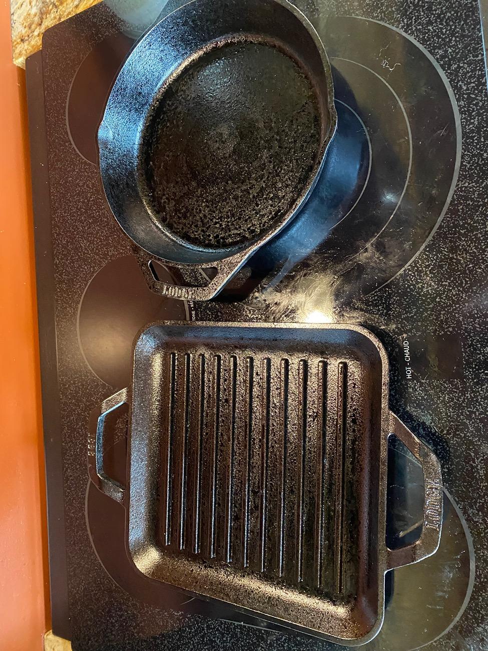

To conclude trip prep, all the cast iron cookware was cleaned, and given four coats of seasoning.

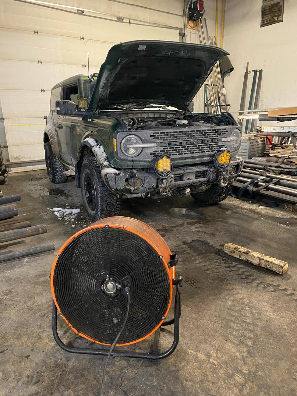

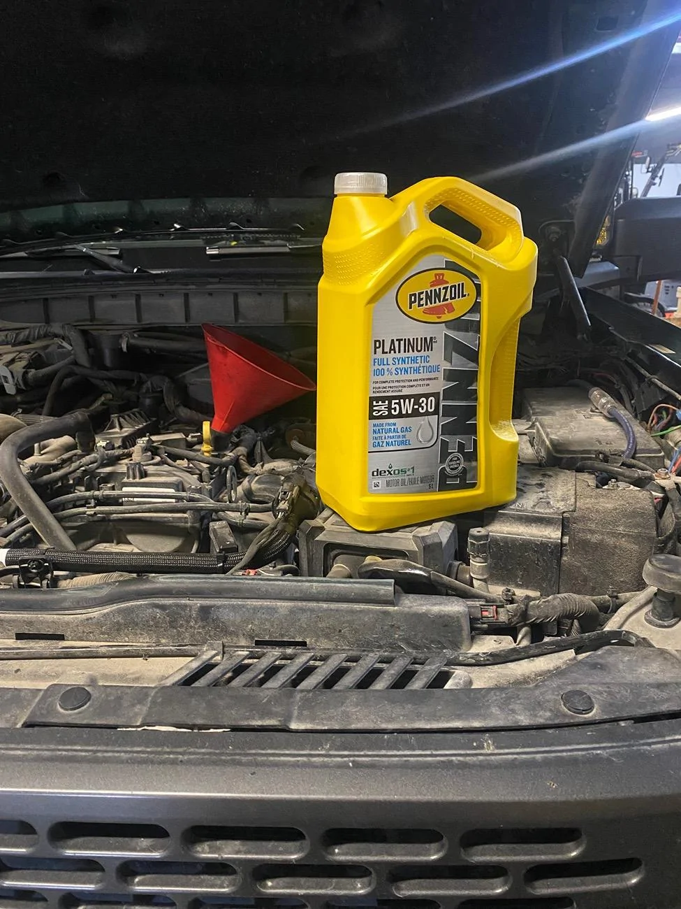

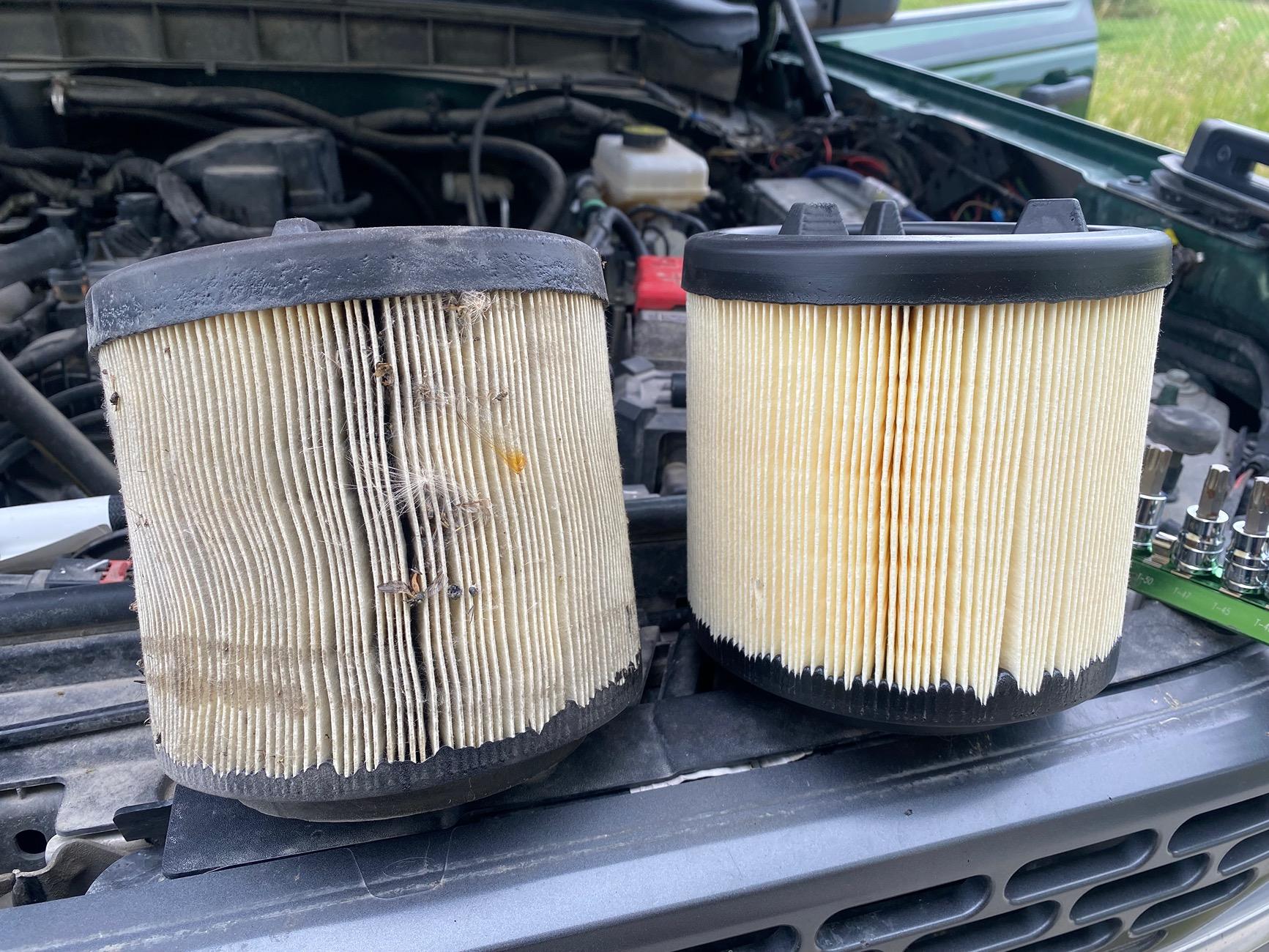

After I arrived back home, an oil change was first in order. But since then, the only fun mod has been a v2 of my light bar mount. It shifts the bar a bit forwards and down, some changes to its general profile too...
Ford Bronco The Boreal Badlands tempImageGdriEH
Ford Bronco The Boreal Badlands tempImageMvEx9f
Ford Bronco The Boreal Badlands tempImage9jnffA

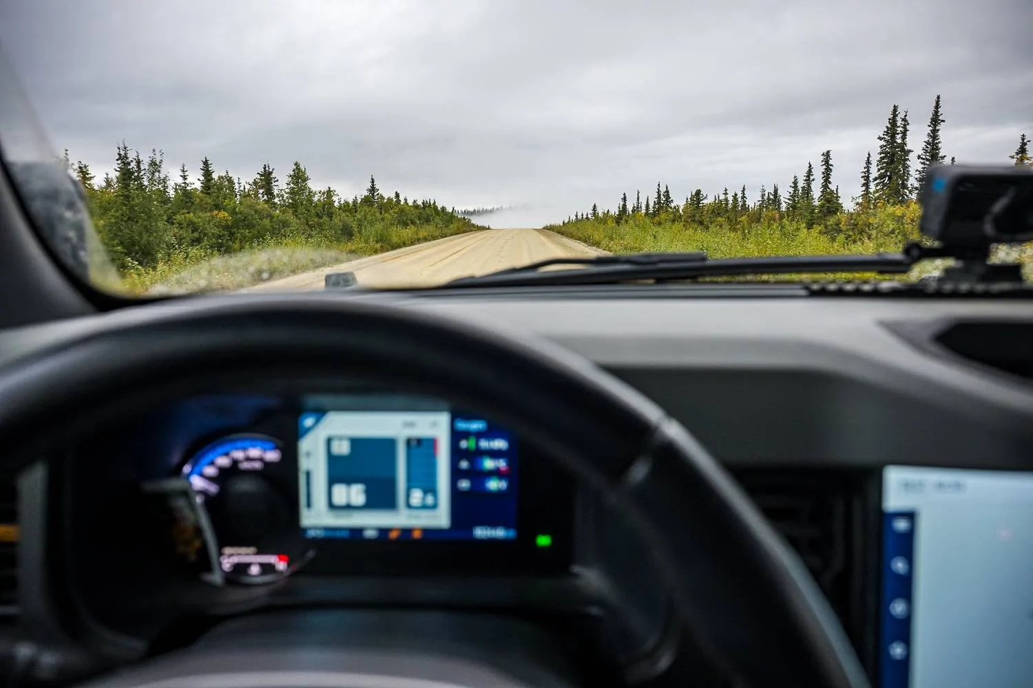

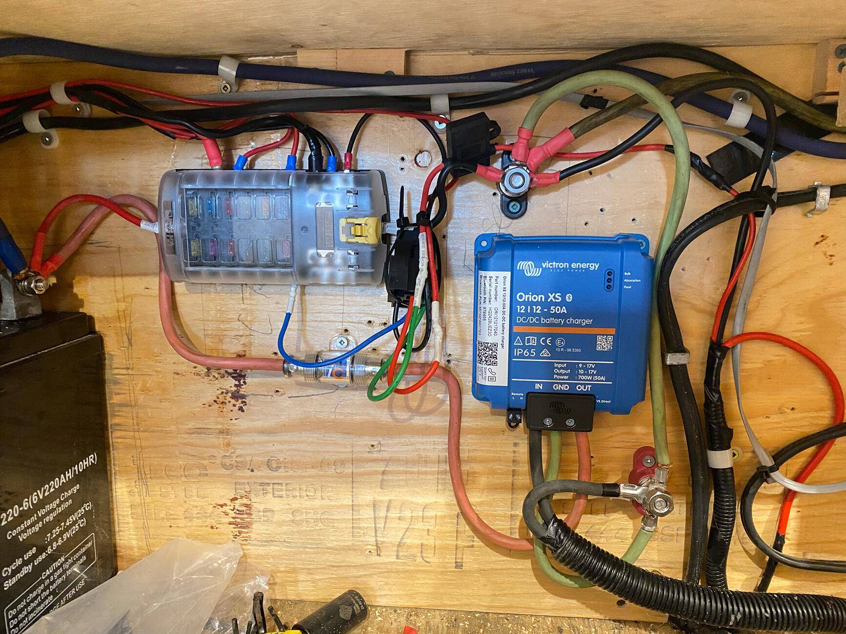

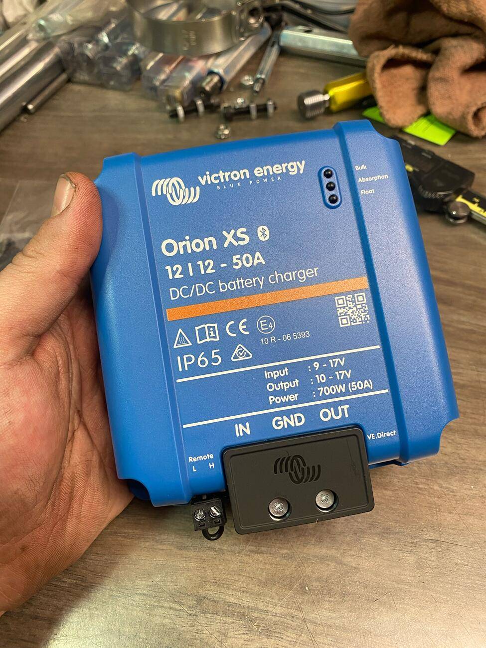

During the AK trek, I noticed that when the "Smart" alternator drops to a cruising/float stage, the voltage at the 7pin trailer receptacle reduces as well... 13.9v at times, fucking stupid. this means that the voltage at the charger in the rear of the camper is too low to effectively charge the AGMs...
Ford Bronco The Boreal Badlands tempImage6cJL36
Lots of positive reviews on this Smart Alternator Compatible Victron Orion XS charger... From initial reading, it should regulate the voltage at the expense of amperage, at this point, charging slower than ideal is better than nothing at all. This'll be installed into the camper and if there is still a need to get voltage to the back, I might twin the 8GA that I've got running to avoid all line loss... run my own charge line off the battery directly... we shall see...

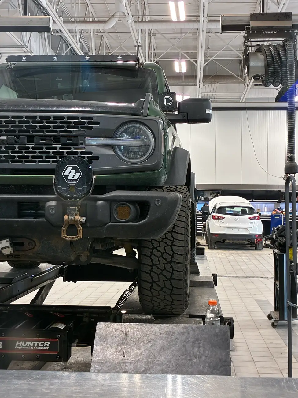

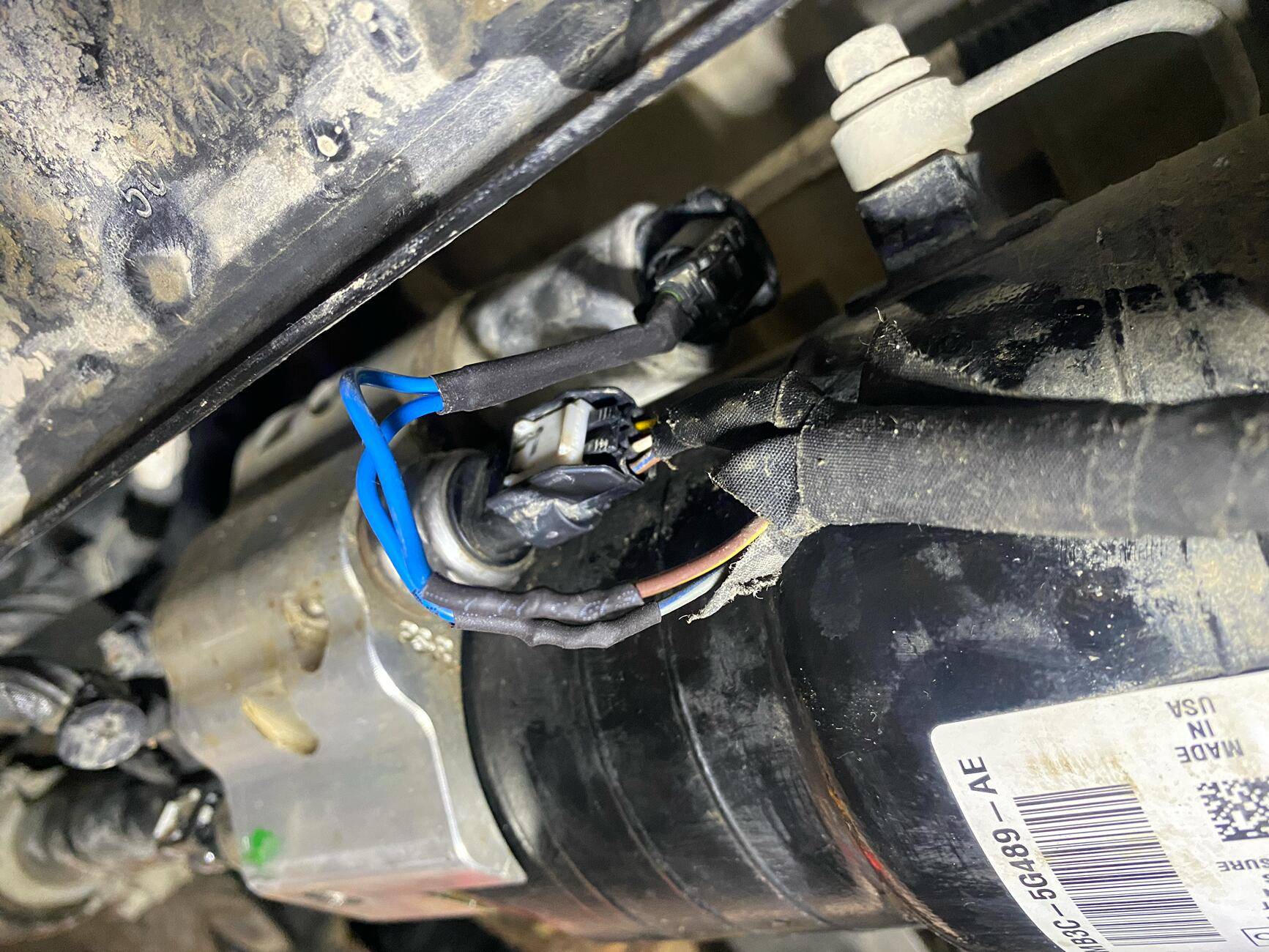

Onto the Bronco problems. Throughout the winter, there were two issues that presented out of the blue, both within 100kms of extended warranty expiring.

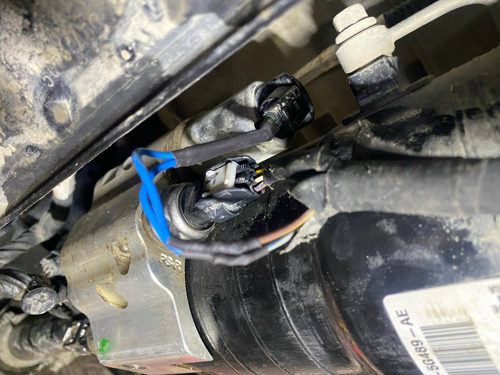

First was the FSD throwing a code for one of the valves. I took it in for a diag. appt at the dealer. They claimed that I needed a New FSD, and that the part is covered by warranty, however the updated TSB is NOT covered. three weeks later, I've cruised past warranty and I had no answer or direction from the dealer. I brought the bronco in for a thaw, took a peak under the skid plate and found one of the pressure switch pigtails had ripped from the connector.... the dealer never even cracked the bolts off and took a look. A quick solder job and the FSD is working once again.
Ford Bronco The Boreal Badlands tempImage658KGV
Ford Bronco The Boreal Badlands tempImageOyaN2k
Ford Bronco The Boreal Badlands tempImageWiSXdh

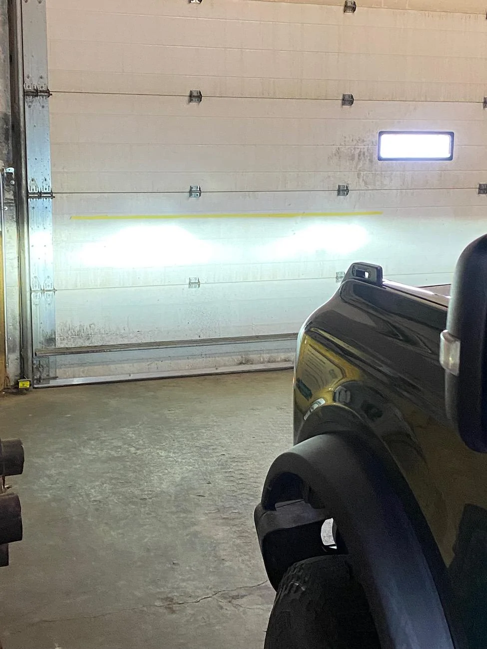

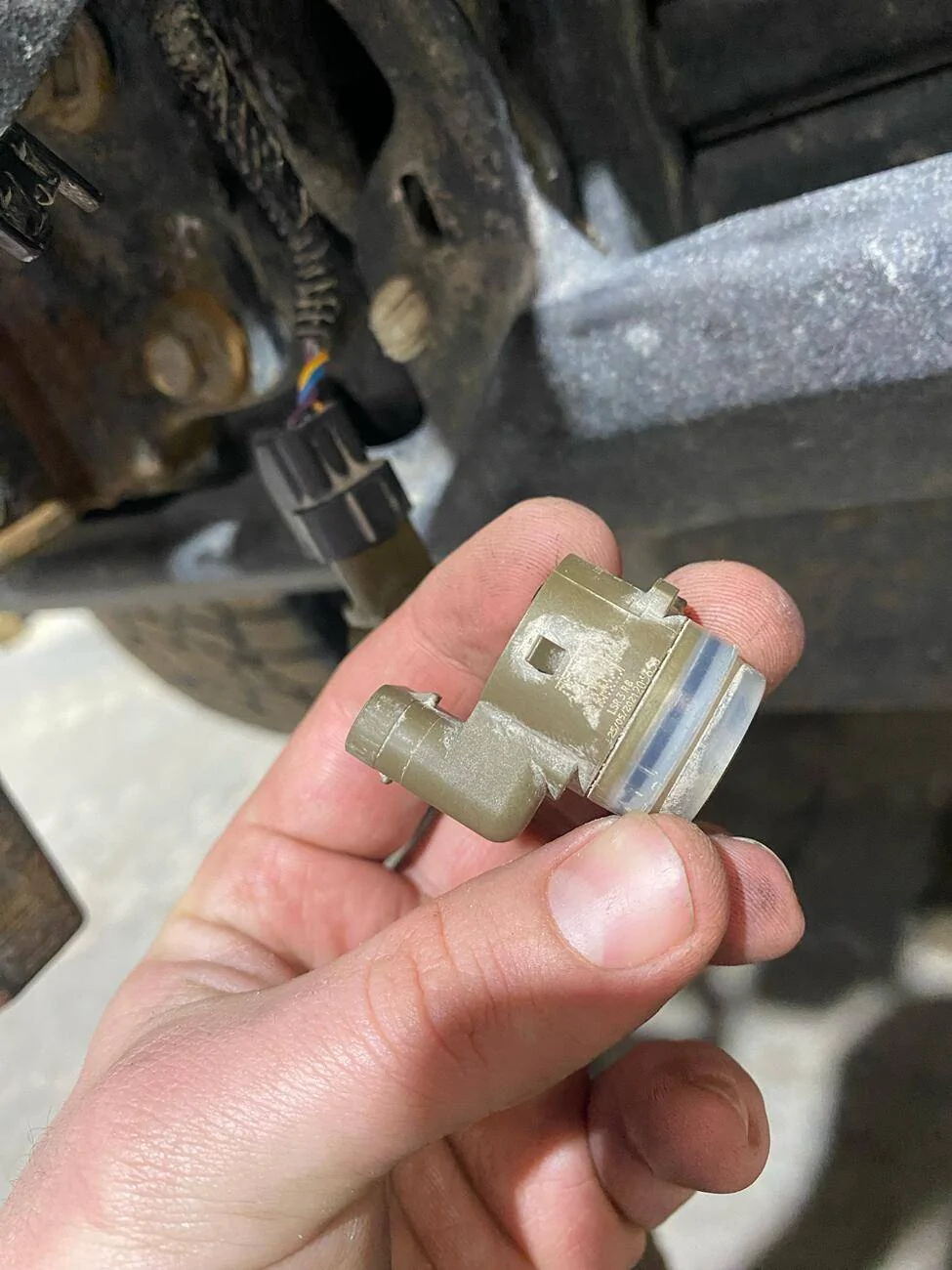

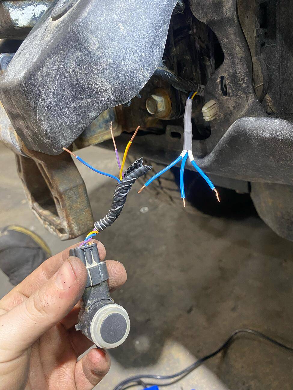

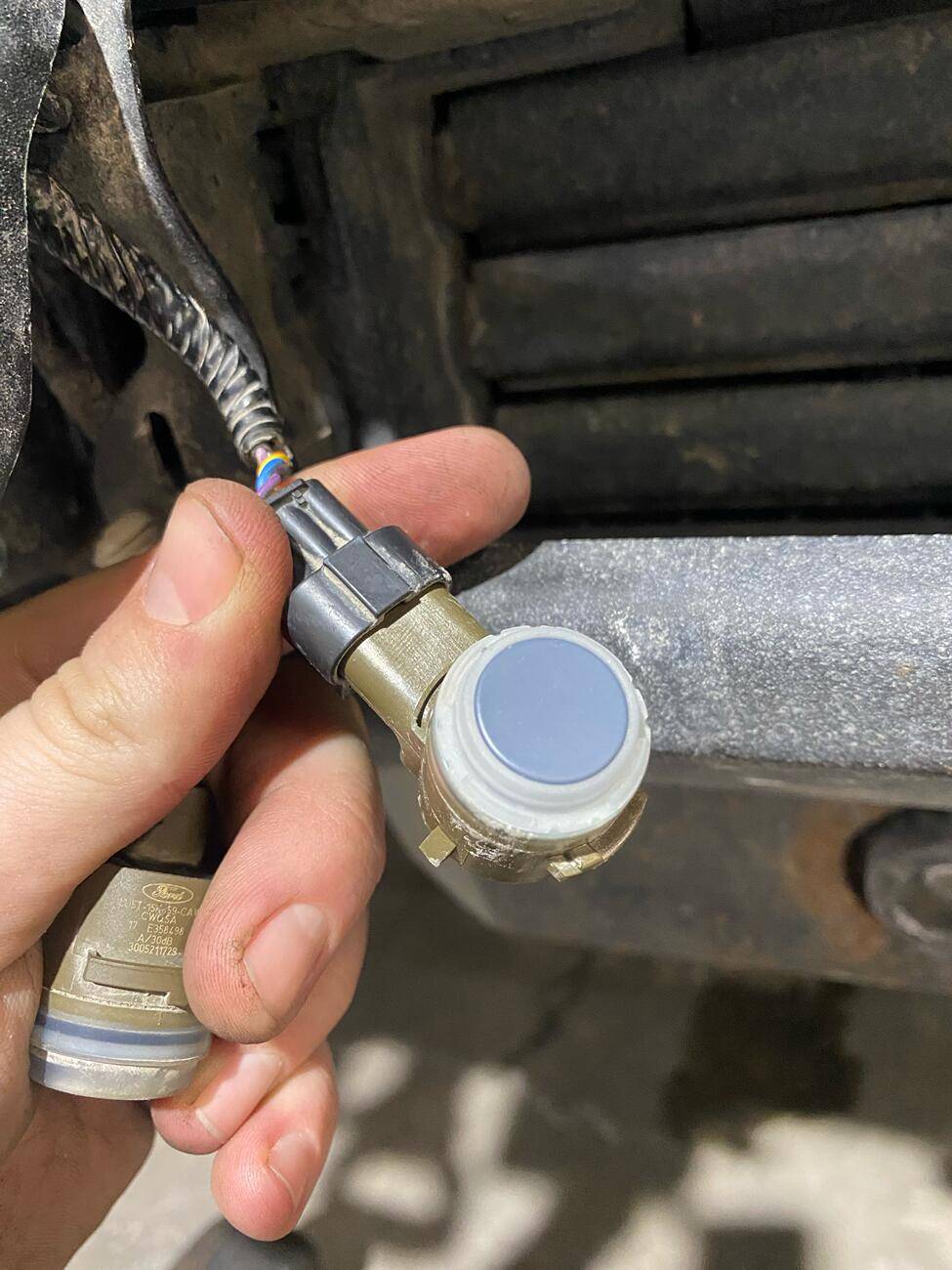

Second issue was the forward central parking sensor, passenger side. Using a mechanics stethoscope, I verified that every sensor was firing but that one... it had some pittings in the face from rocks and had assumed that the sensor itself was dead. I purchased a superseded version, installed it to no avail. Further inspection and pulling back of the wiring loom found that all three wires had broken insulation and corroded while in the sheathing.
Ford Bronco The Boreal Badlands tempImagePXnl
Ford Bronco The Boreal Badlands tempImagejYouP3
Ford Bronco The Boreal Badlands tempImageStETbM

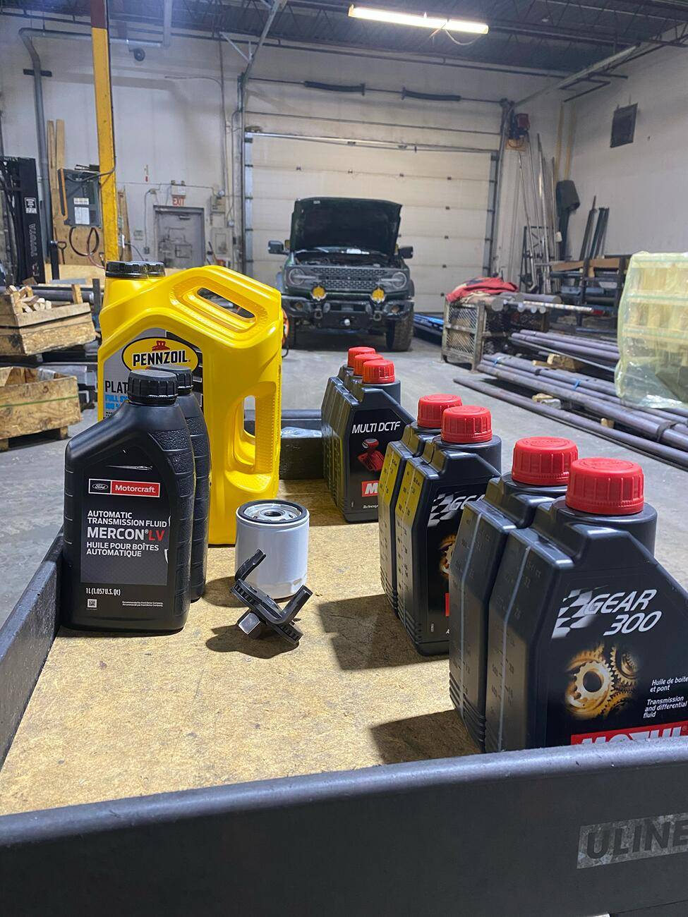

After a few wiring fixes, the dash is clear of errors. It is time for a little lube refresh. Being out of warranty, all fluids are now up for debate. A good friend runs a Subaru shop with a preference for Motul and a bunch of the fluids meet spec. Motul Gear 300 75w-90 for the Diffs and Motul DCTF for the Manual Trans. I opted to continue to use Ford Mercon LV for the TCase, wet clutches can be picky. And finally, I'm continuing with the Pennz Plat 5w-30 and Fords OEM Oil Filter for the engine.
Ford Bronco The Boreal Badlands tempImageVxGGa0
All fluids changed well, dark, but no obvious metallics. The FP Rear Diff Cover made the oil change 100x easier. With everything changed over, I'm looking forwards to the summer ahead with a few little roadies planned!

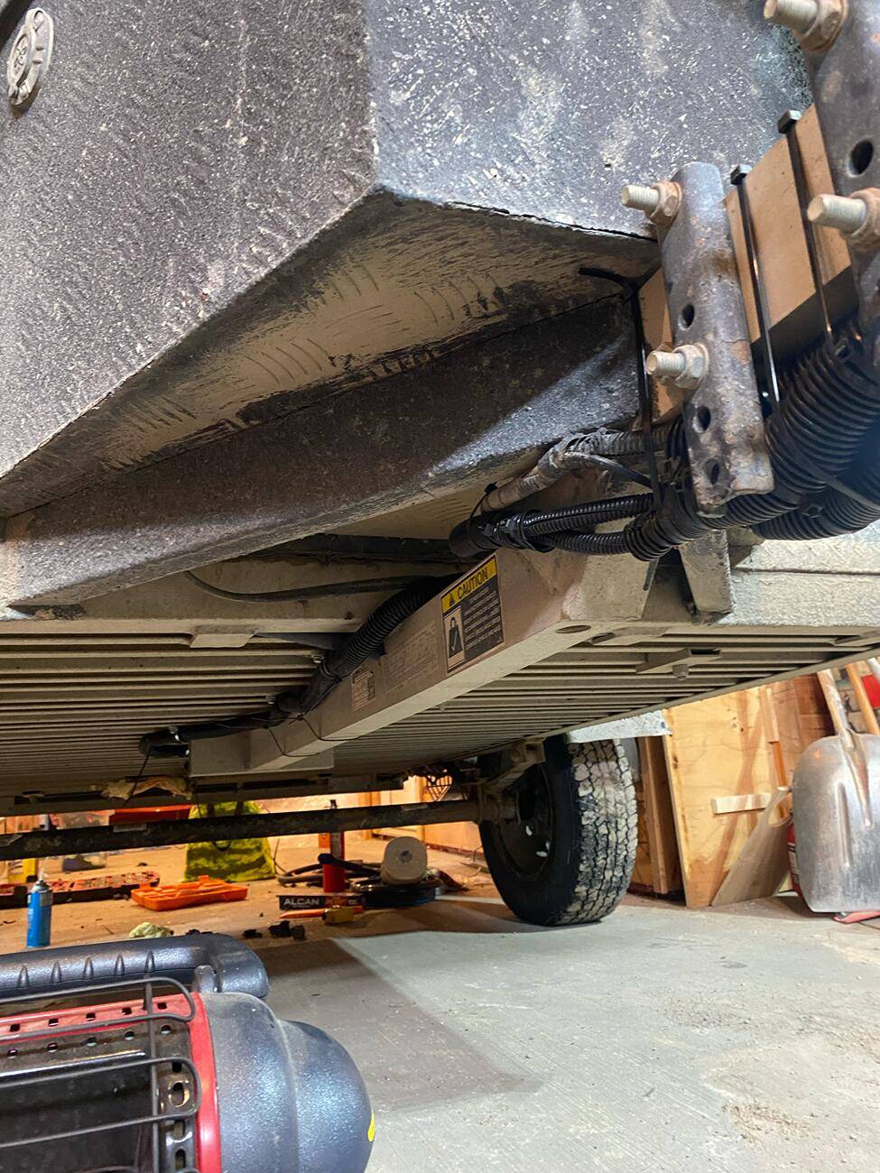

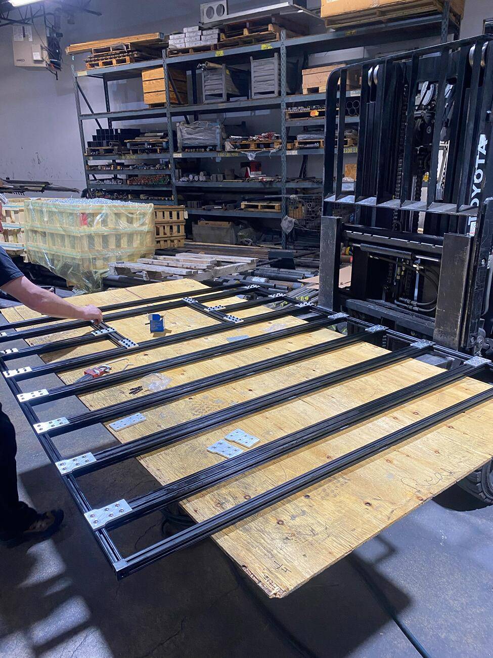

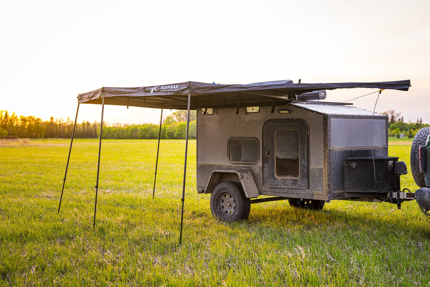

The Camper was due for another round of upgrades before the 2025 Summer Season. Lets Dive in.

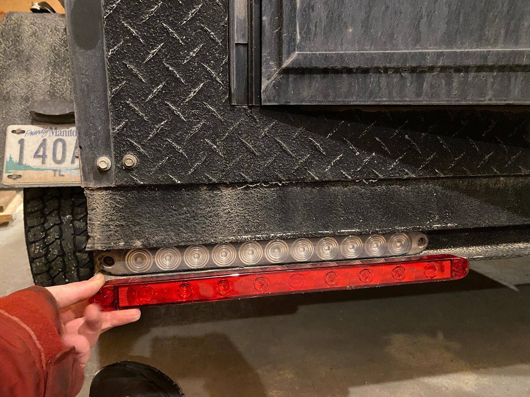

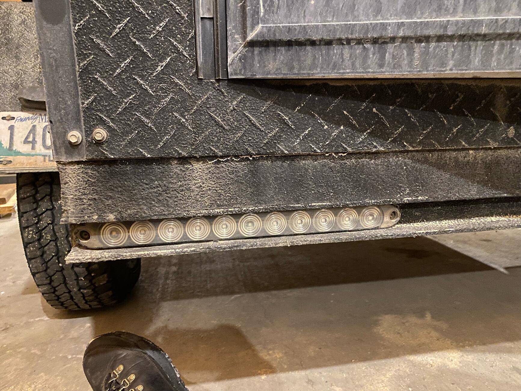

First up was new tail lights(Red lens)... the old ones (clear lens) died during AK 2024.
Ford Bronco The Boreal Badlands tempImageG2q4Jv
Ford Bronco The Boreal Badlands tempImage8HB8p8
Ford Bronco The Boreal Badlands tempImageStW7iy

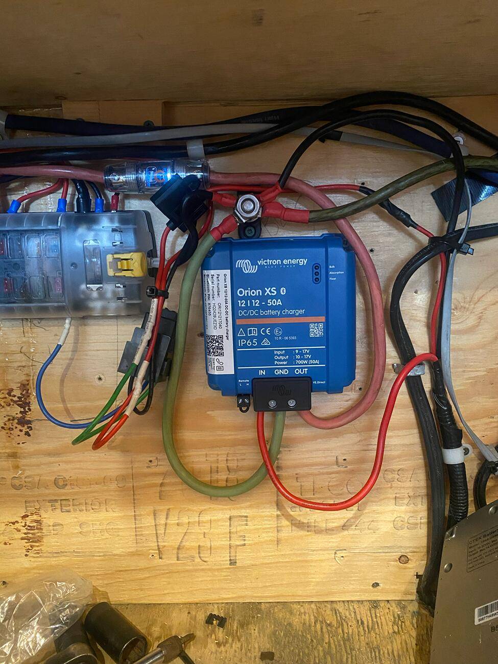

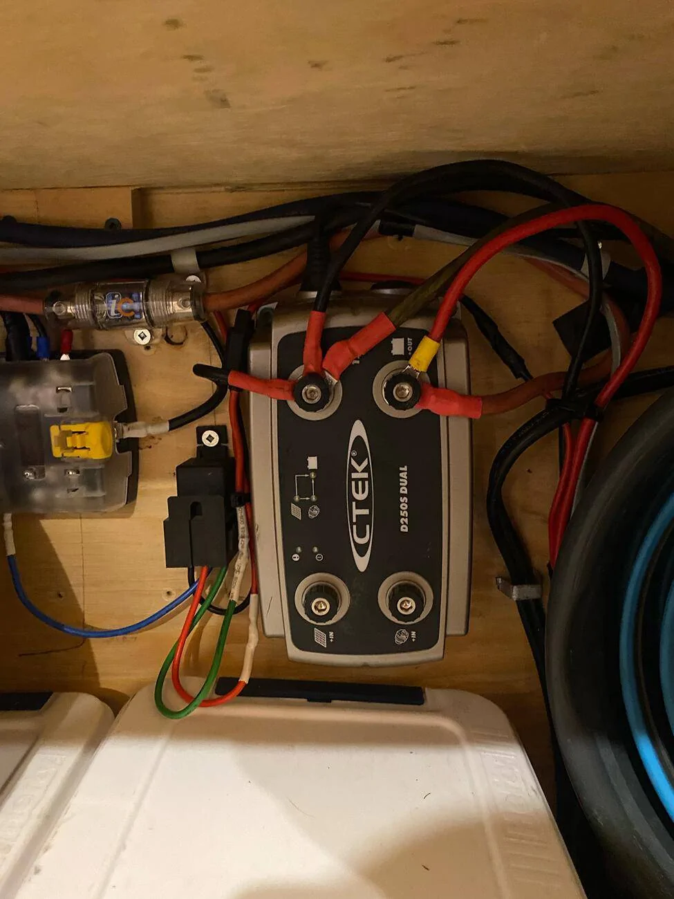

Second was a new DC-DC charger. Ditching the CTEK D250S ( I know the wiring is incorrect for how I had it hooked up, was testing) for the Victron Orion XS - Smart alternator compatible. In addition, I upsized the charge circuit to 4GA wiring. While I was cracking open the harness, I took the time to plumb new 4 Wire for the neck, re-route and re-sheath everything. A Reliability upgrade and If needed, an Anderson connector can be swapped in place of using the 7 PIN for charge power.
Ford Bronco The Boreal Badlands tempImage1lCAQM

This was all going pretty smooth, tackling a little portion of each step as I could find some time. The BIG change this year was the intention of roof rack. During the build process I welded some plates to the frame for eventual mods, it is time to use them. Using 1x1 and 2x1 extruded aluminum, T Nuts, custom machined mounting brackets and attachment plates, I built a flat rack.

The rack wasn't meant to just look pretty, it was assembled with a few particular uses in mind. Solar Shower, Cargo Box, and Awning. Anything extra is a bonus. After sizing up a bunch of configurations I settled on the Roam 95L Box, a 270º Awning (Was supposed to be Yakima but ended up being Top Oak) and the Yakima Road Shower 10Gal.
Ford Bronco The Boreal Badlands tempImageCZBant
Ford Bronco The Boreal Badlands tempImageiNwcX
Ford Bronco The Boreal Badlands tempImageYitV6
Once I got home and dug into the spacing, I found that the spare tire can perfectly squeeze into spot as well as a camp chair or two.

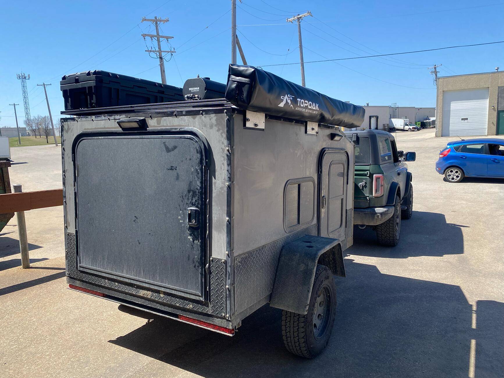

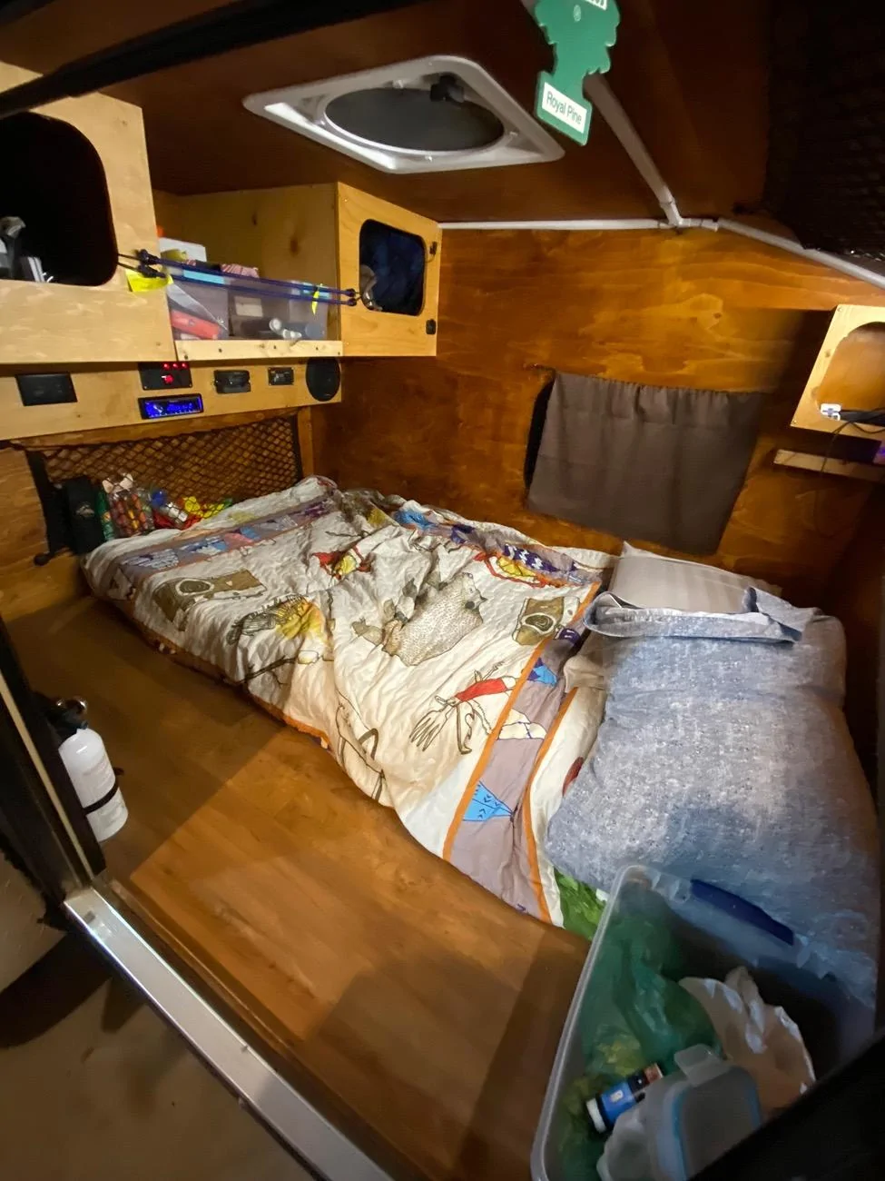

Previously in 2022, I journeyed up to the Yukon and Northern BC. It was wet, but the camper kept me dry. At this time I was uncertain if the batteries had gone bad, I wasn’t getting the life expectancy out of them that I had come to know during the initial years.there was also some variance in how well the Inverter/Charger was working… some days it had low voltage alarms, others it failed to even boot up or charge from shore power. I also bent the hub stubs of the undersized original axle…
In 2023 my pup and I adventured to the Icefields (Between Banff and Jasper), this trip was also quite wet and I started to notice moisture intrusion. The new batteries also did not solve my power woes… but the new 3500lb axle did provide a better bottom end.
The trek to Wisconsin for drifting left the camper with a literal puddle after 13 hours of rain on the way down, and return…

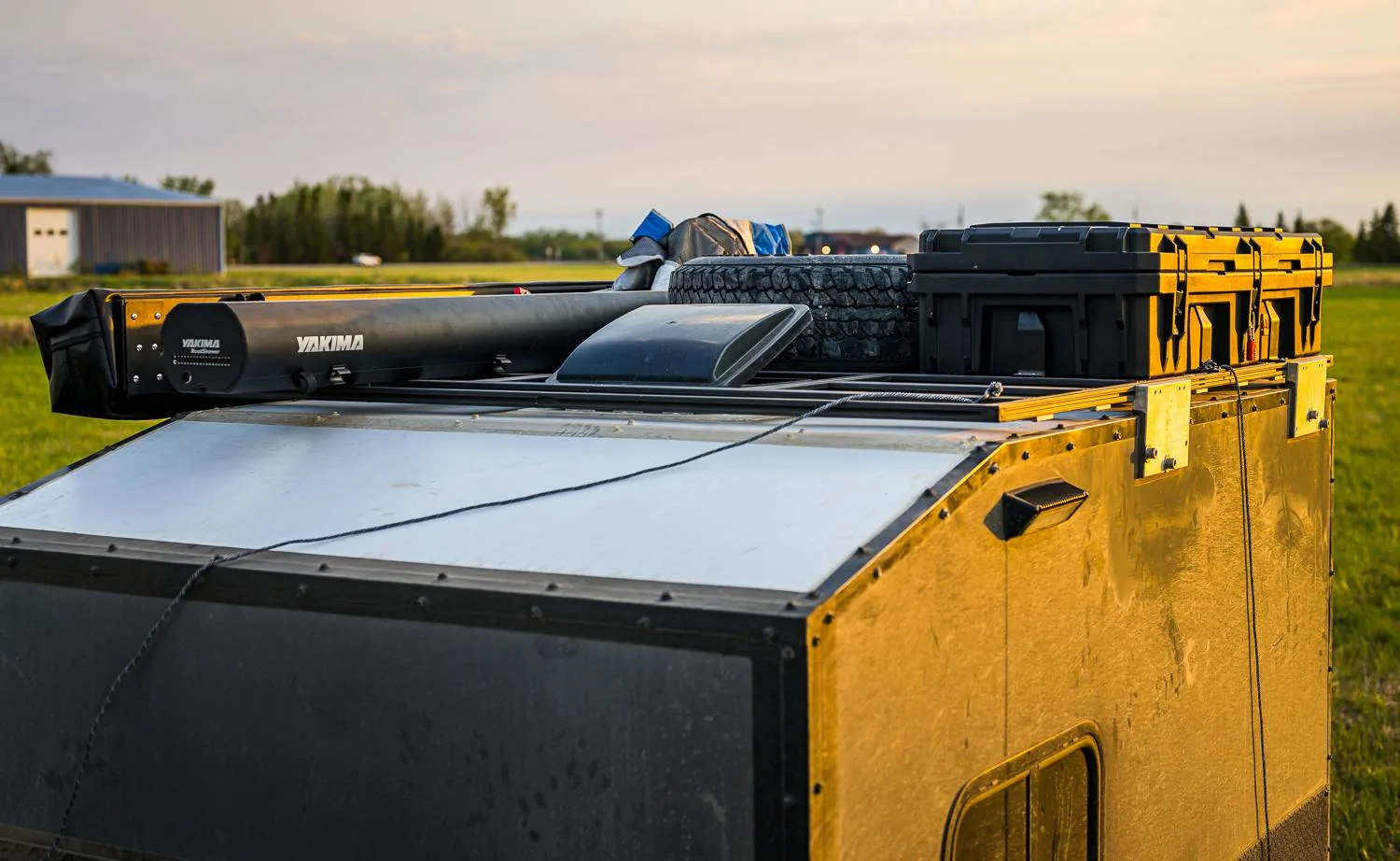

I knew I needed to fix some things before this Alaskan Adventure. So, this summer I have since done a regiment of sealant, fastener replacement, more sealant, a complete rewire of the power system, more sealant, and ran a dedicated High Amp 12v charging line for electronics in the cabin.

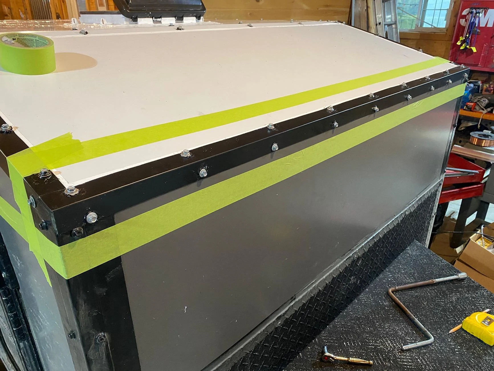

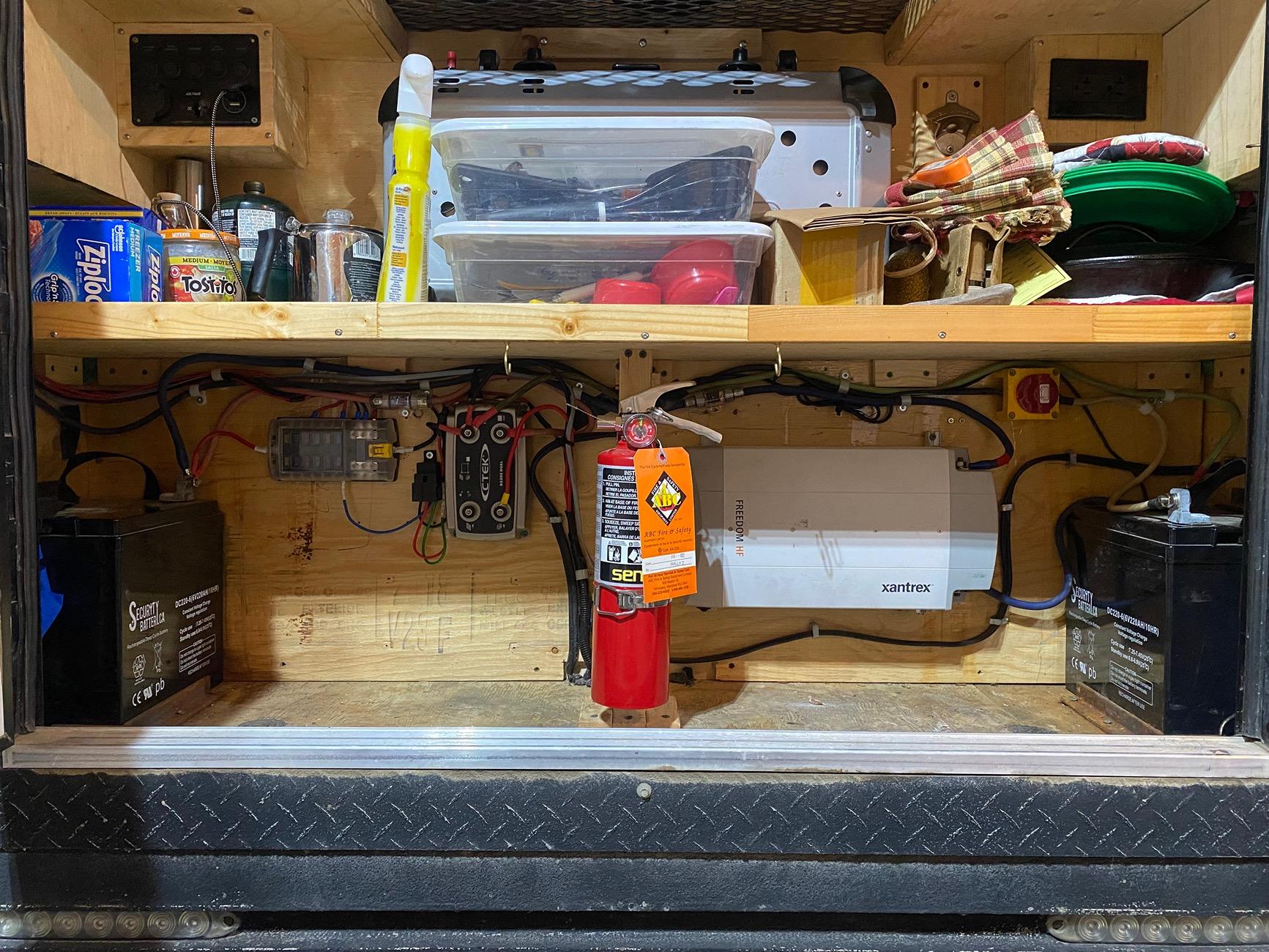

Throughout all of this build up have been a few journeys, photo assignments and obligations… it's been a countdown that ended up coming to conclusion within the final hours. Fortunately, the majority of the work on my to-do list got done and there’s nothin else left to do but drive north. Let’s see how she goes.
If you continue to get water in your camper, get some eternabond rv roof tape to seal up on top!
With any luck, the copious amounts of flex seal and replaced fasteners last year should hold me. Atleast it was successful during my 4 week Alaska stint where it rained all but two days.

I did the math and came to the conclusion that I don't have enough power for 2 weeks off the grid and plumbed in a solar charger/port and acquired a 300w foldout setup.

Got sideswiped, Passenger mirror assembly replaced.
Found a pinched wire in the rear backup sensor harness and repaired.

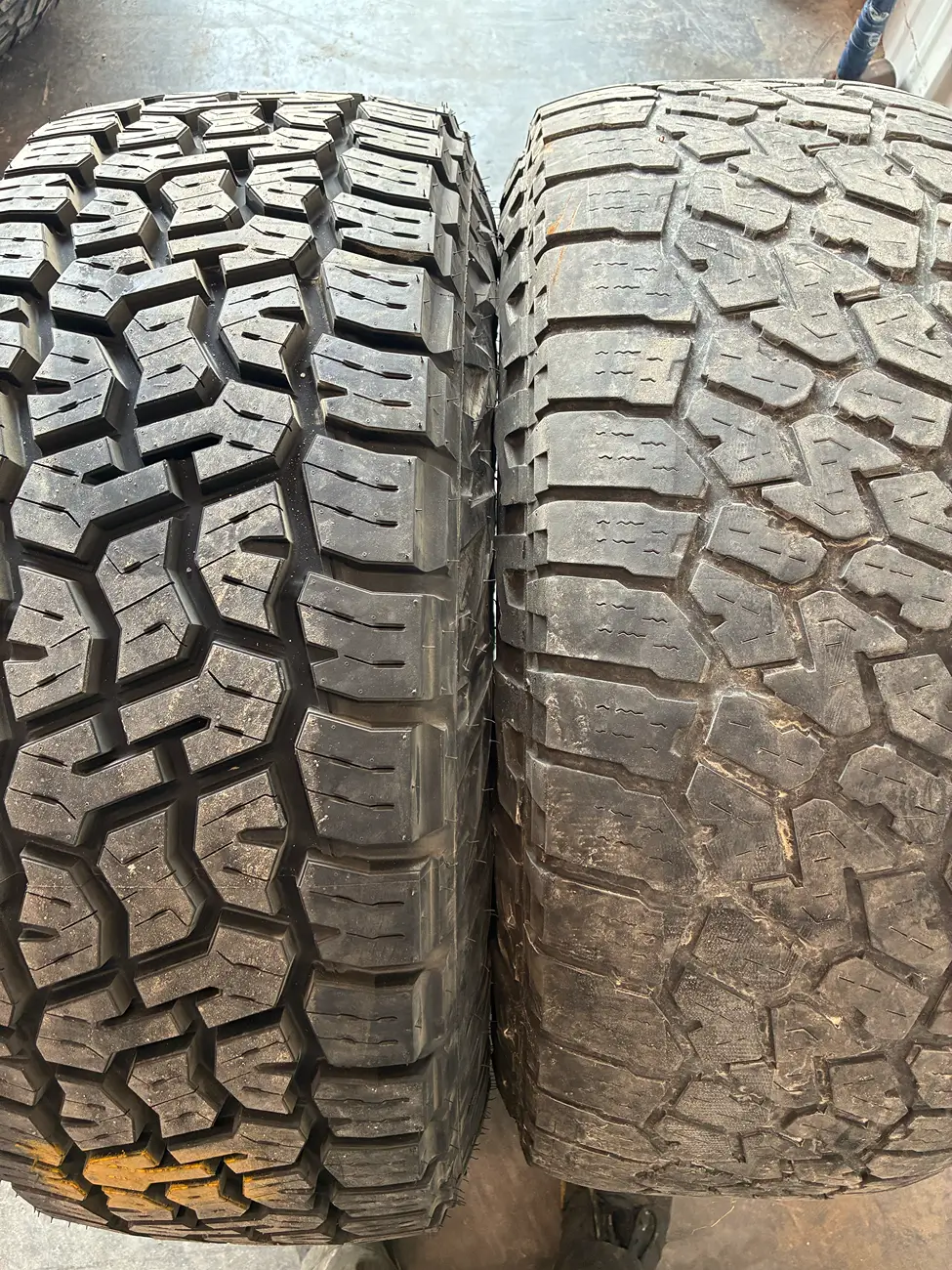

1: Fresh Rubber. The AT3W's were getting punctures in the main belts, simply from the sharp granite gravel en route to the cabin. They have been swapped out for some Nitto Terra Grappler G3's. Oh, and our lake was engulfed by forest fires for the first half of the year (Our cabin luckily survived where others did not), these trails feel like a different world driving through them now.

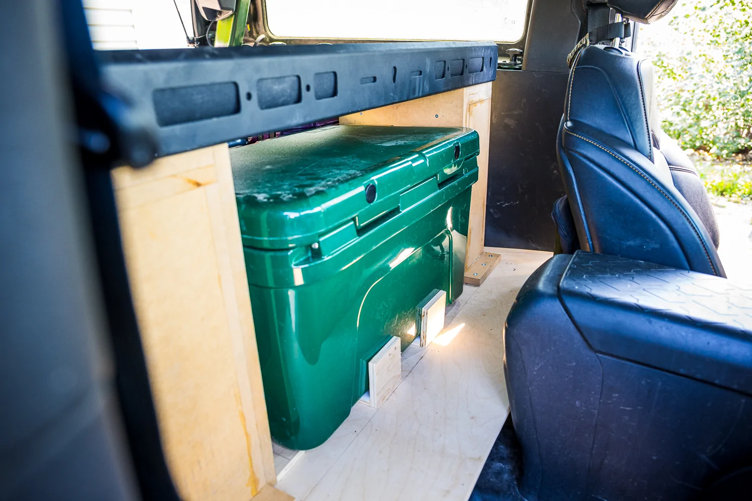

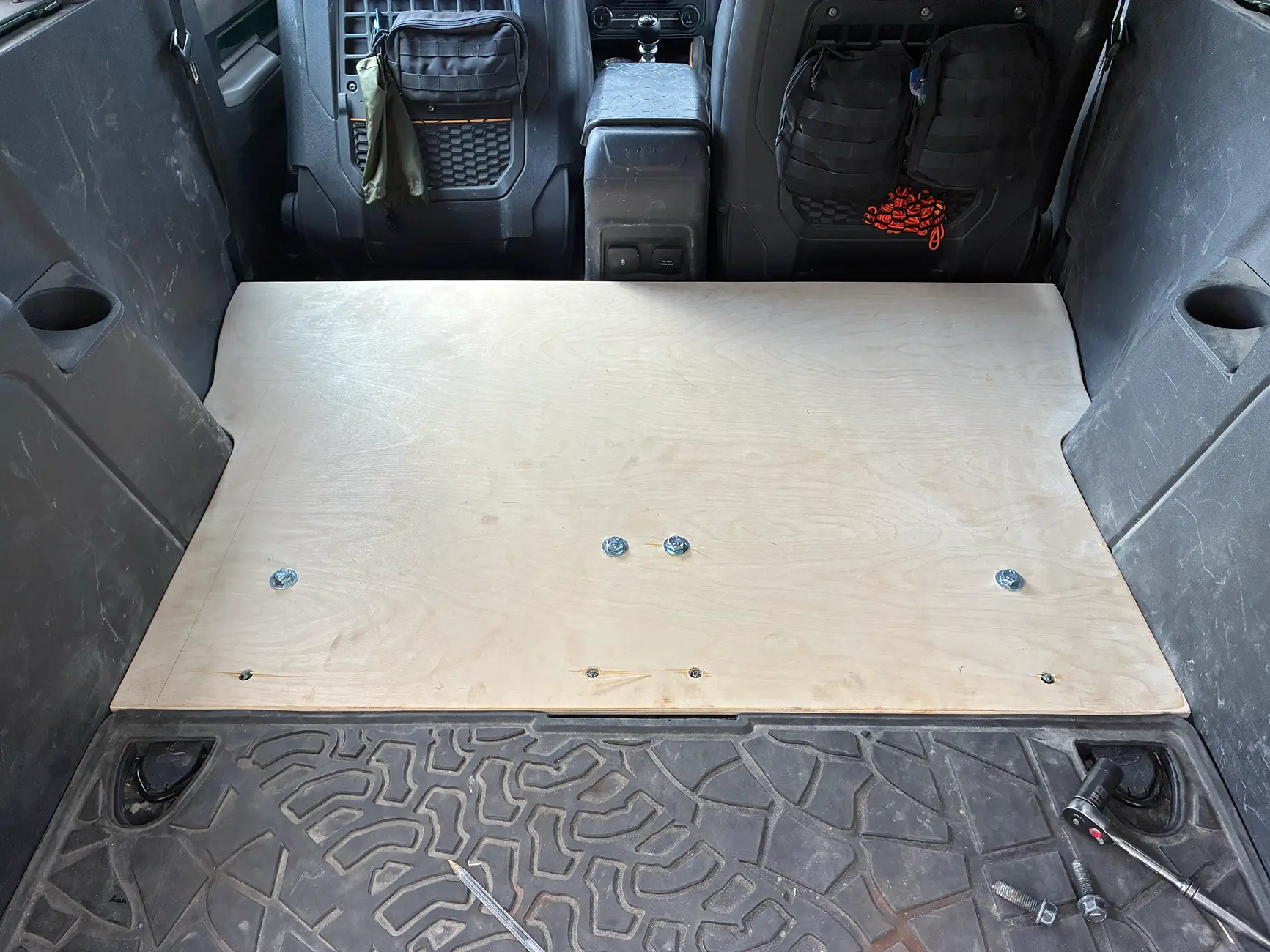

2: Huge Rear Cargo Upgrade. The old setup was very quickly installed for a trip and was starting to get in the way of the functional use of the Broncos space. Not to mention the 10 year old box was starting to fail and needed a re-seal. The GF and I are about to embark on a 2 week road trip and something had to be done for the rear.
First, rip out the old shit, template and build a flat floor. I opted to do a ½ floor setup for ease of build in the timing I had and access to underfloor storage.
What I had "temporarily" installed for reference:
Ford Bronco The Boreal Badlands IMG_1705
The floor:
Ford Bronco The Boreal Badlands tempImageJzdwk1

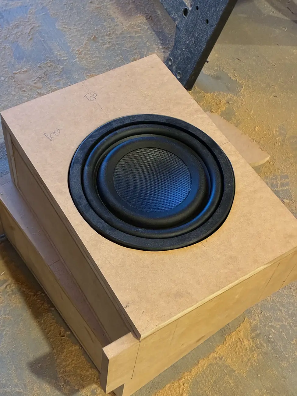

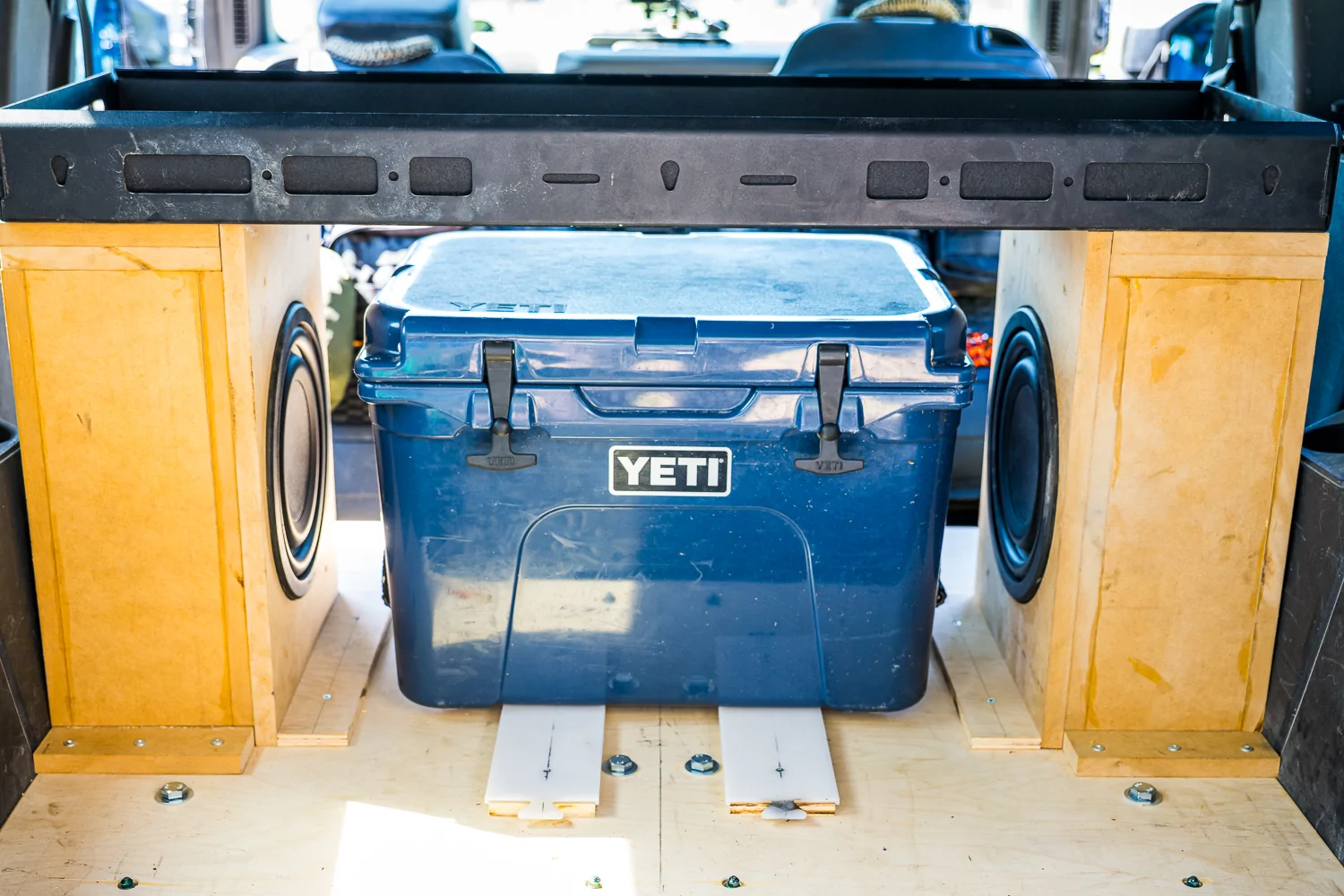

Previously I had done various mockups with the Focal E30KX K2 woofer to see how I could easily integrate it into this revised setup. There was nothing that I was overly thrilled about for the design vs function vs use of space. Going to a symmetrical setup would be the winner, and if I was going to go that route, two new subs would be in order. I stopped in at my local shop and they had just the thing in stock - Pioneer TS Z10LS2's. An oversized 10" woofer that has great fidelity, plays low, hits hard, and is a shallow mount.

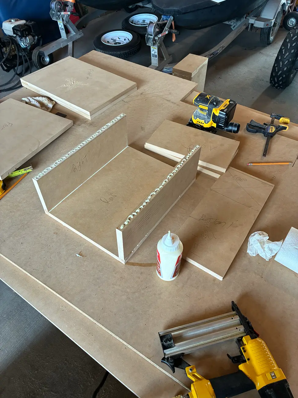

With the floor done, I spent about two days mulling over different subwoofer box configs. The final setup was built specifically around fitting in a Yeti Tundra 35 or 45 as well as my Nanuk 955.
Ford Bronco The Boreal Badlands tempImageA8ma5F
Ford Bronco The Boreal Badlands tempImagenJnWB6
Ford Bronco The Boreal Badlands tempImageAMLxo9
Ford Bronco The Boreal Badlands tempImageIs3xT7

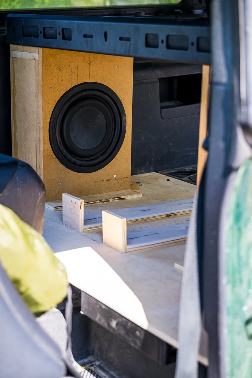

The boxes have a double front and a double top. The front to increase strength, sure; primarily to counter sink the woofers for protection. The top, well, I wanted to repurpose the JCR off-road rack that I had on the spare tire... it can now double as a gear rack while fixed to the top of the boxes. and yes, I added a bunch of polyfill/poly batting to the boxes - they sound better than any sealed box should!

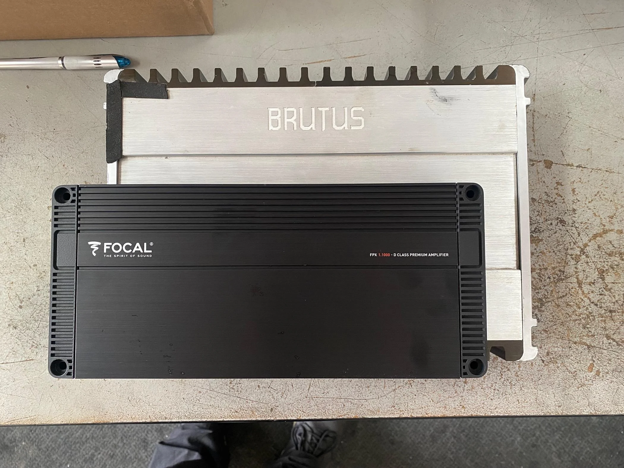

The LOC and Amp are tucked under the front of the floor, at a challenging, but protected and accessible location.

And finally, after some thought and testing, a few more mods were required.

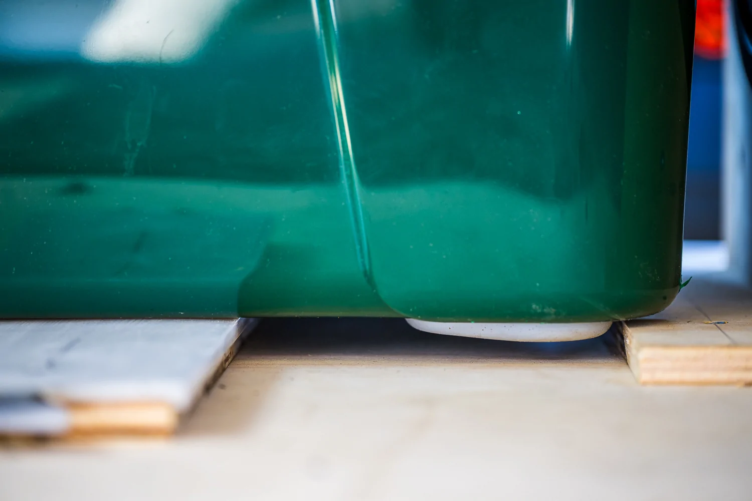

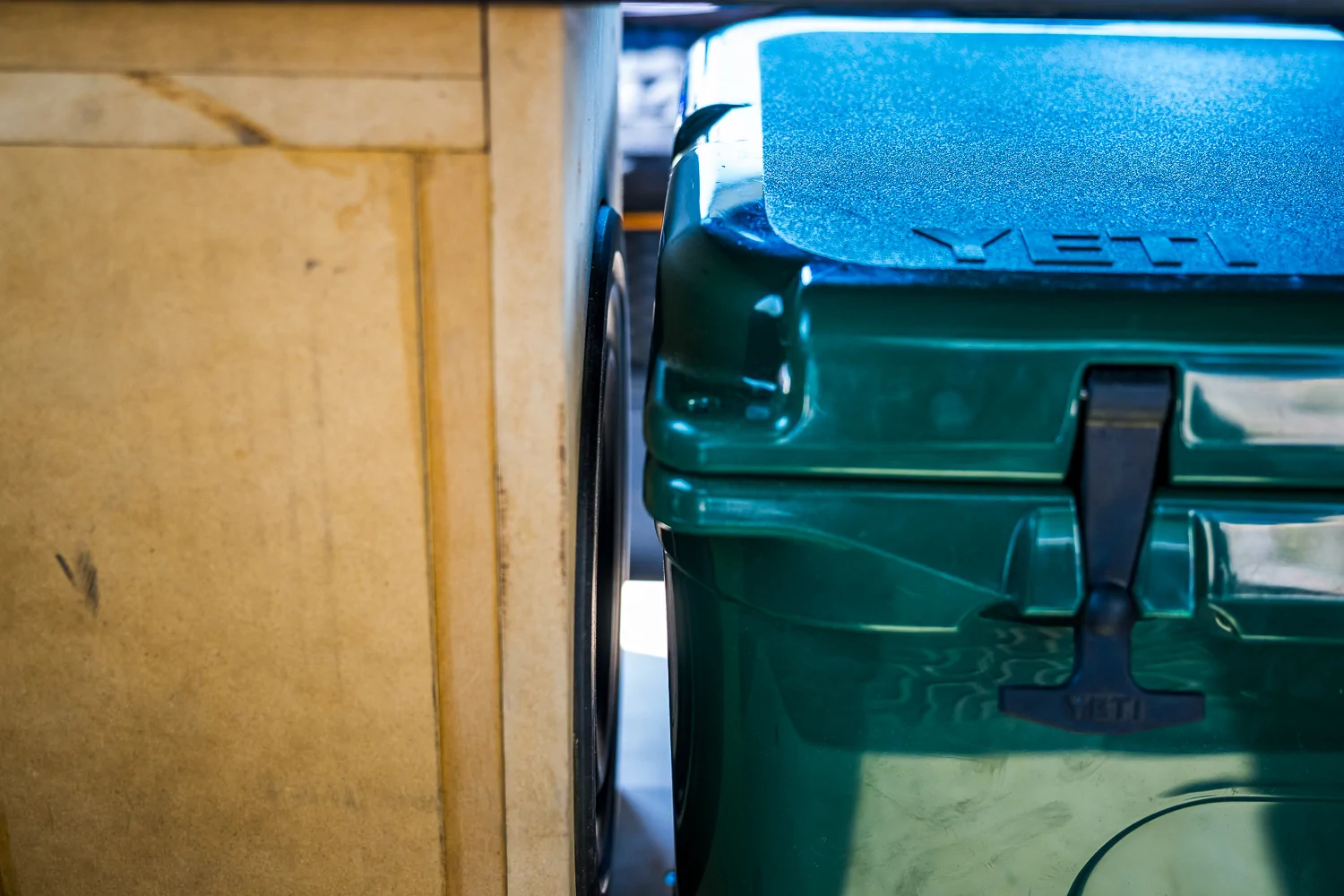

Sliders for the heavy once loaded coolers. Blocks to stop them from sliding into the woofers. Rubber matting inside the gear tray to protect stuff from scratches, rattles and sliding about.

The setup will be removed following this first roadtrip, and entirely coated in Bedliner for water and wear protection. I think it might need a chance to be proved out for any tweaks that could be needed moving forwards.
A little benefit with the positioning of everything is that there is a bunch of room behind the seats too. Not to mention access to the power ports on the back of the centre console.
Ford Bronco The Boreal Badlands August 14, 2025_7781
The hatch can fit so much stuff now, insert room for activities meme here. The Tundra 35 (day to day food) and 45 (deep freeze) and Nanuk 955 (digital goods) and a Roadie (drinks) AND water jug all fit In the back.

I’m amused your design priority was fitting two enclosed subwoofers. But it certainly makes a nice stand for the repurposed JCR!
Boreal
Boreal
Colby
Oct 4, 2021
935
3,123
MB
www.cspencephoto.com
2022 Badlands 2DR
Mans gotta have his priorities!
Multifunction seems to be a trait of the bronco!
