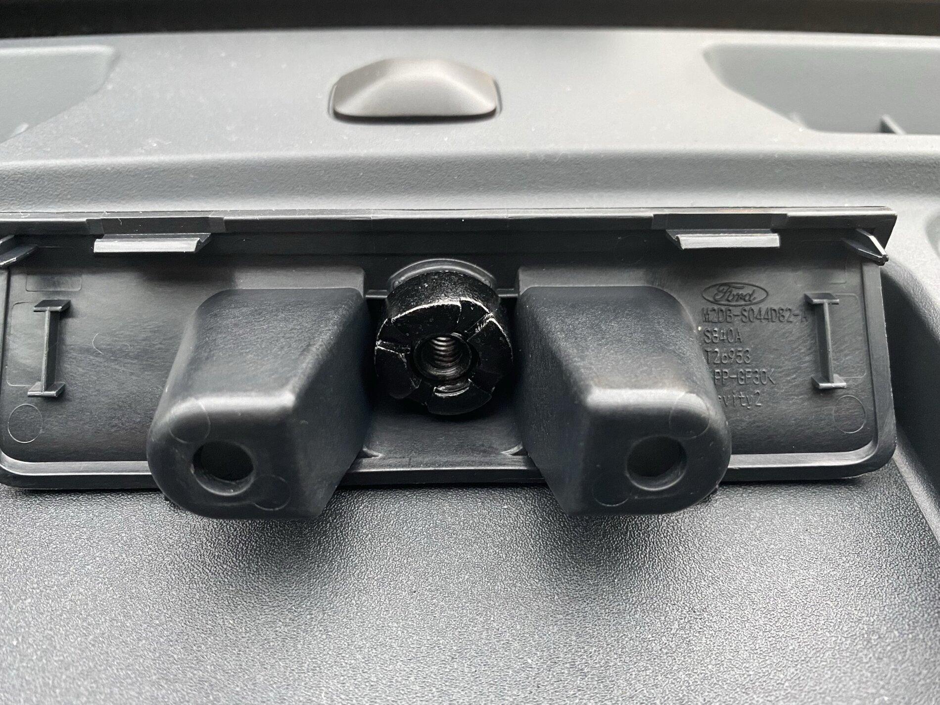

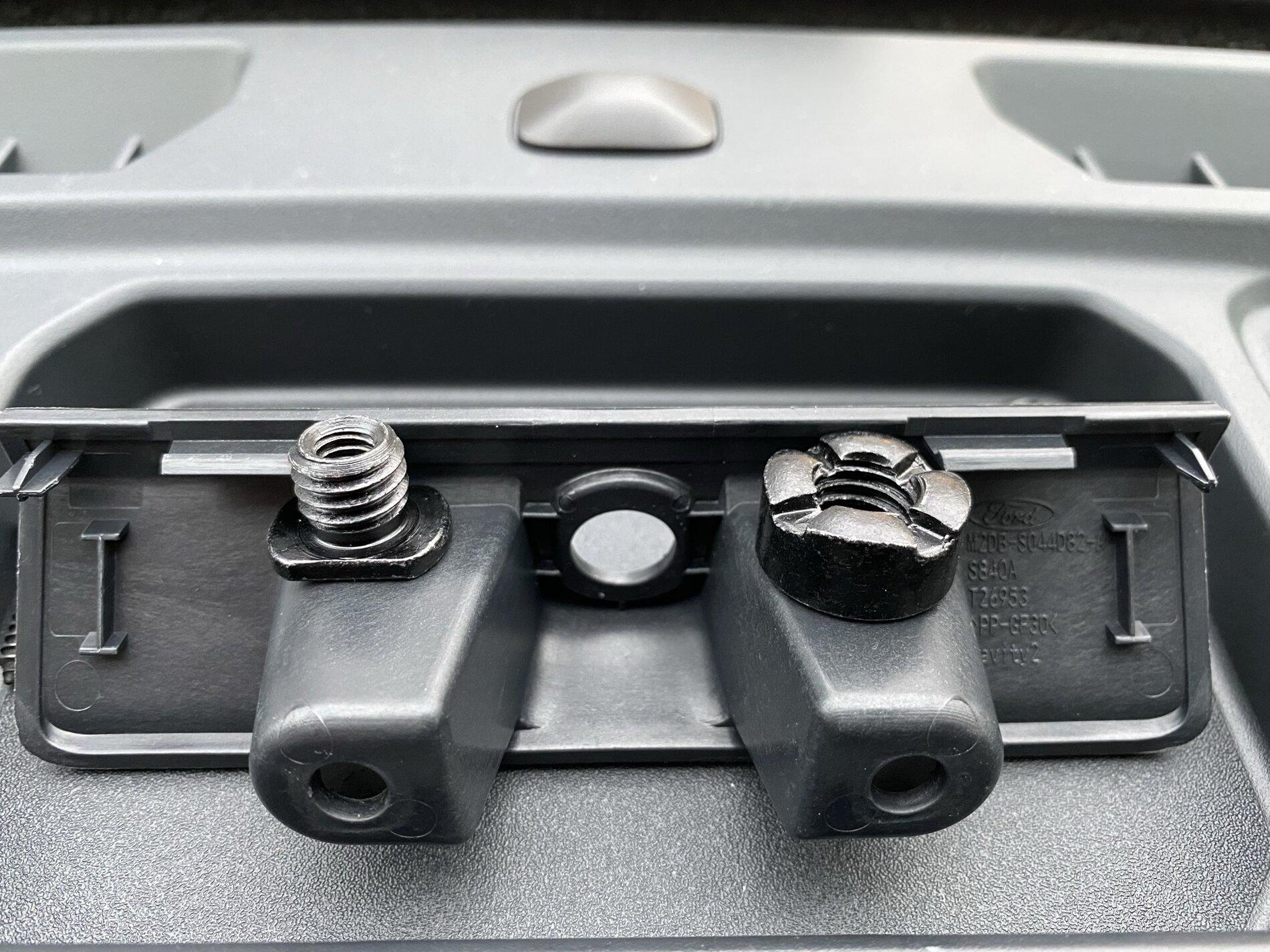

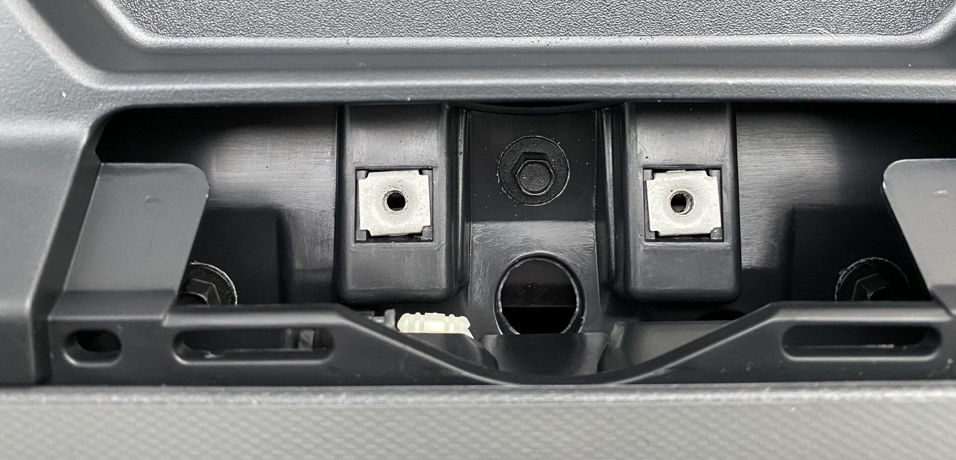

I gave these numbers to the parts guy at my Ford dealership:
The part # for the assembly seems to be one of these numbers:
M2DB-S044D82-A
S840A
T256953
PP-GF30<
It came with the dash mount trim, the crown nut, and the center speaker grille. Paid with FP points so not sure how much it was, but it had what I needed.
