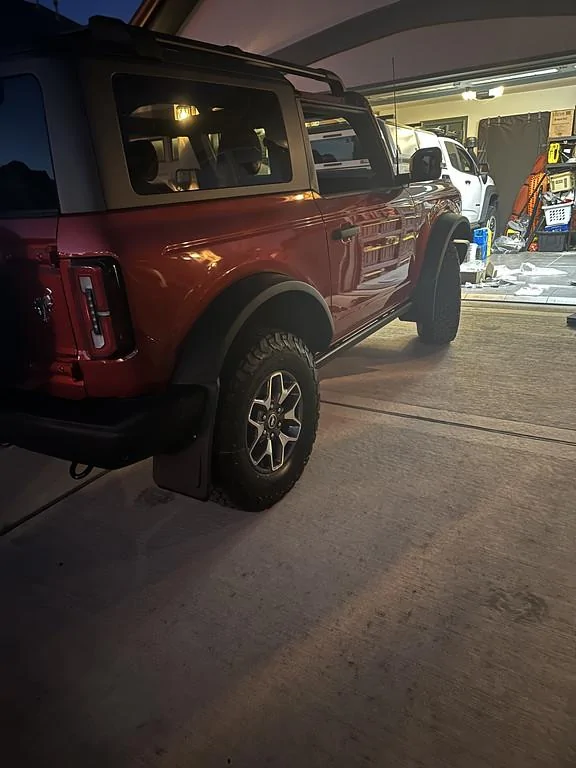

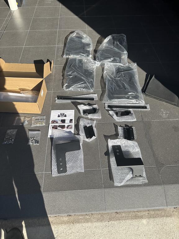

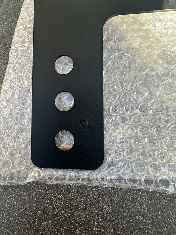

Mabett Mudflaps installed today. I really wanted to the Rockblokz but I have a habit of ripping off mudflaps when 4x4ing, so I like that you can easily remove them, but a $420.00 (XL/Long) I couldn't justify that price, especially when it leaves a gap in the rear. Enter Mabett, I picked up the set of 4 for $129.00, I can see the engineering that went into them and the pieces (and there are many) are well made, nicely marked, the cover the area decently and they do make the Sasquatch fenders over 33's look better. The biggest dislike is the flaps themselves aren't that nice, they aren't bad, they are just a bit cheap looking. I've have Rockblokz for my Bison, but they were half the price then what they are charging for the Bronco.
The bad is the instructions are limited and wrong. I knew this right off as I read the directions last night and they said to remove the trailer hitch for the rears. Why the hell would I have to remove my trailer hitch to install mudflaps? Luckily there are plenty of YouTube videos that folks have done for their Broncos. It still took about 3 hours to get all four installed. I think Ford forgot about mudflaps when designing the Bronco.
Ford Bronco TGO - The Overlander Build IMG_0835-XL
Ford Bronco TGO - The Overlander Build IMG_0836-XL
Ford Bronco TGO - The Overlander Build IMG_0844-XL
And here is my helper, he's a pandemic puppy, now 2 years old and full of energy, his name is Jackson and he's supposedly a mix between a Silver Lab and Blue Leopard Catahoula:
Ford Bronco TGO - The Overlander Build IMG_0842-XL
I'll take better pictures tomorrow, I finished up right when it got fully dark.
I do think the Mabetts would be a good deal around $80/90 dollars.

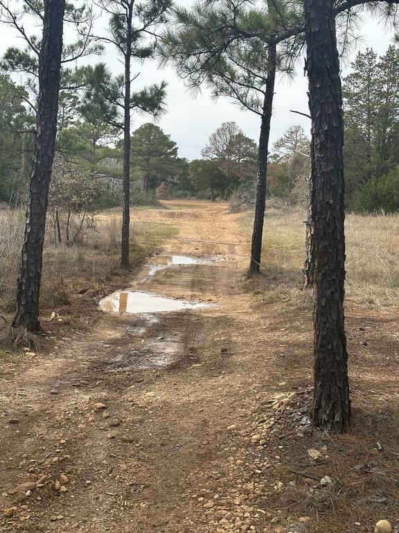

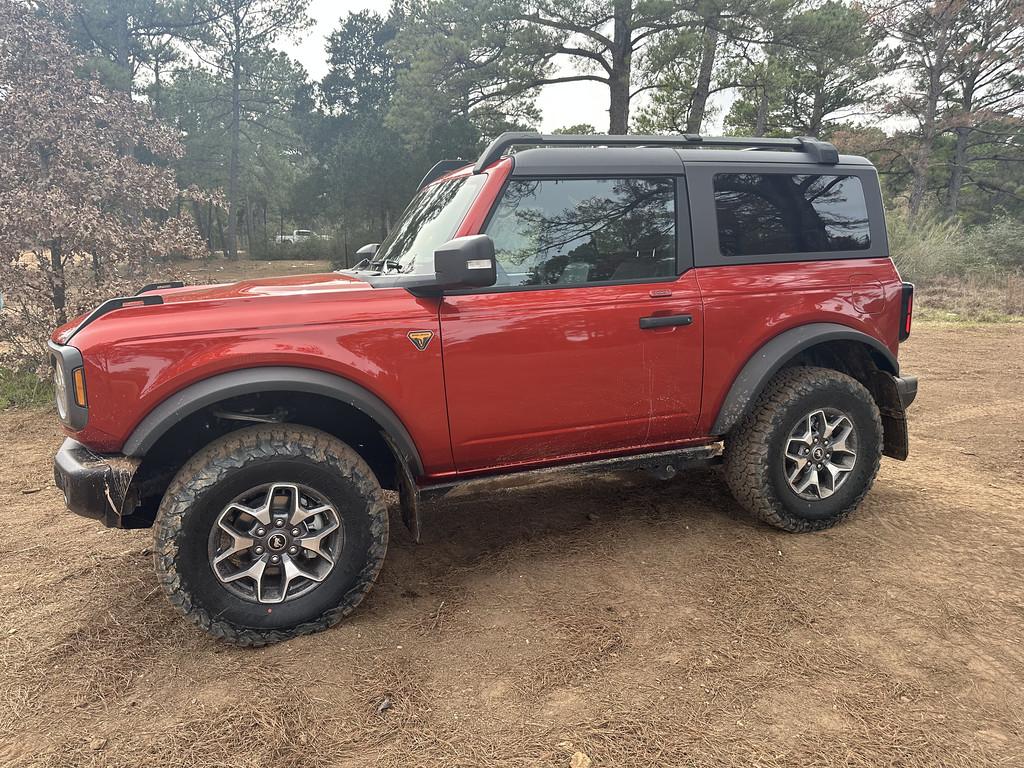

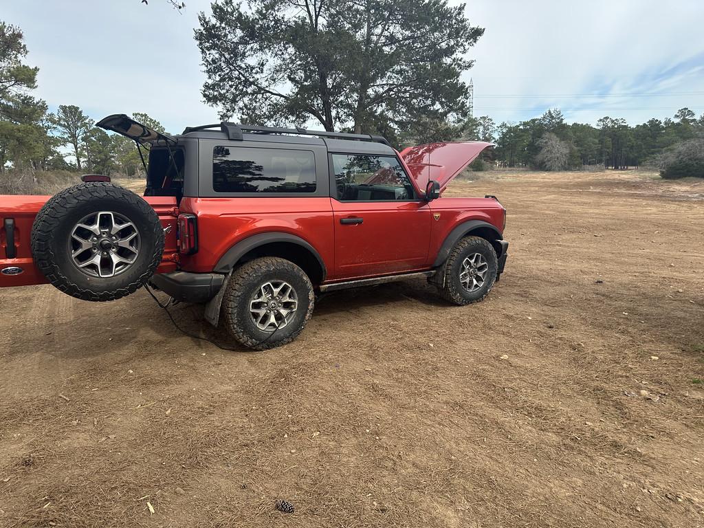

Finally First Off-road.
In the Austin Metro area Bastrop has a cool "unofficial" off-road area that is basically a pine forest with dirt roads through it with decent elevation changes always a ton of puddles and a just a good time and only 45 minutes drive from my home. If you're looking for it, just search for Tahitian Village and the "entrance" is a little east on the opposite side from Buc-ee's.
This isn't my first off-roader, but it is my first manual transmission off-roader so I knew this would be the perfect place to give it a shot. It being super bowl Sunday, I knew there would be less people, but I also couldn't find any friends that wanted to go with me. So I packed some recovery gear, tools and an air-compressor and headed off.
Ford Bronco TGO - The Overlander Build IMG_0848-XL
When I got there there were only a few folks, some side by sides, some motorcycles, and a few pickup trucks.

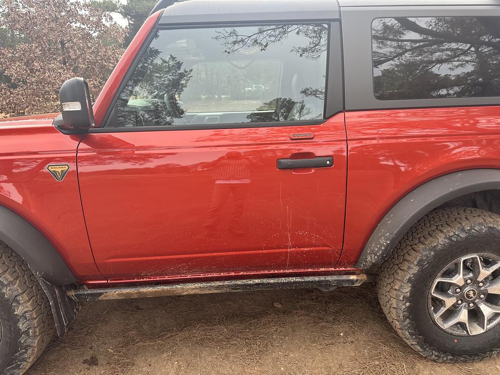

First off, I'm so impressed with the size of the 2-door Bronco, got through things, I don't think I would of tried with my truck, and turning and backing up are so easy. Going solo, that front and 360 camera help out immensely, especially when all you can see is the sky. What a game changer.
It doesn't look it in the pictures, but the last two trees are tight:
Ford Bronco TGO - The Overlander Build IMG_0849-XL
Ford Bronco TGO - The Overlander Build IMG_0850-XL

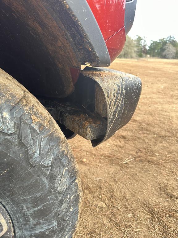

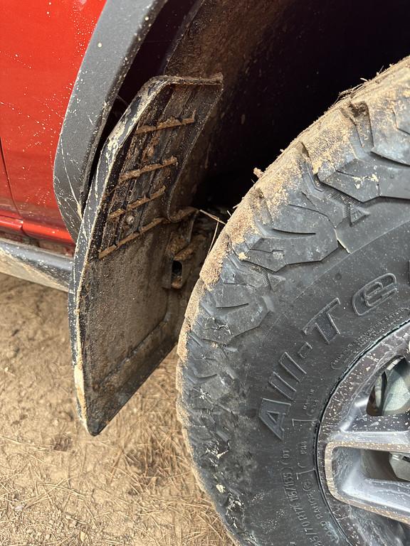

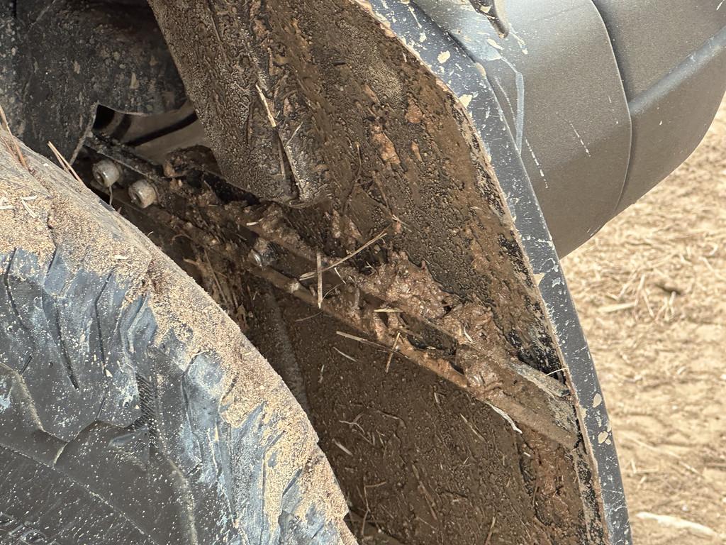

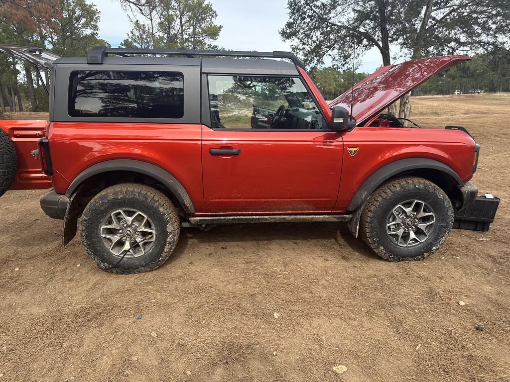

I would also say, the Sasquatch fenders and the mudflaps did the job I was just looking for, the little that is on the doors is splash back from going through big puddles.
Ford Bronco TGO - The Overlander Build IMG_0851-XL
Here's a good 3/4 pic of the fenders and mudflaps that was asked for:
Ford Bronco TGO - The Overlander Build IMG_0852-XL
I know this is a luxury, but this compressor (which can run air tools) and the Indeflate (2) makes airing up and airing down a breeze. I would like to the outside tailgate option I've seen, but I can't justify buying another one when I have this portable one.
Ford Bronco TGO - The Overlander Build IMG_0853-XL
Again, they really did their job well:

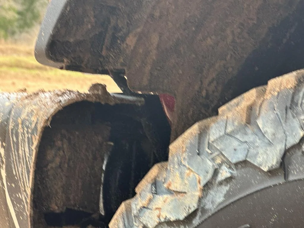

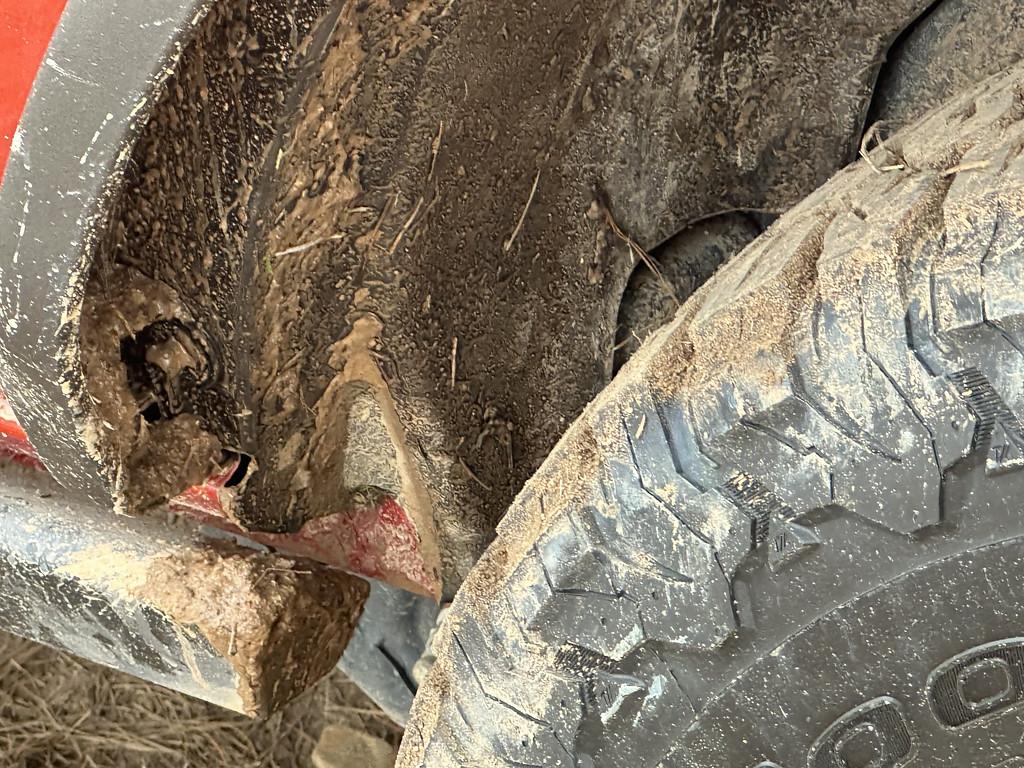

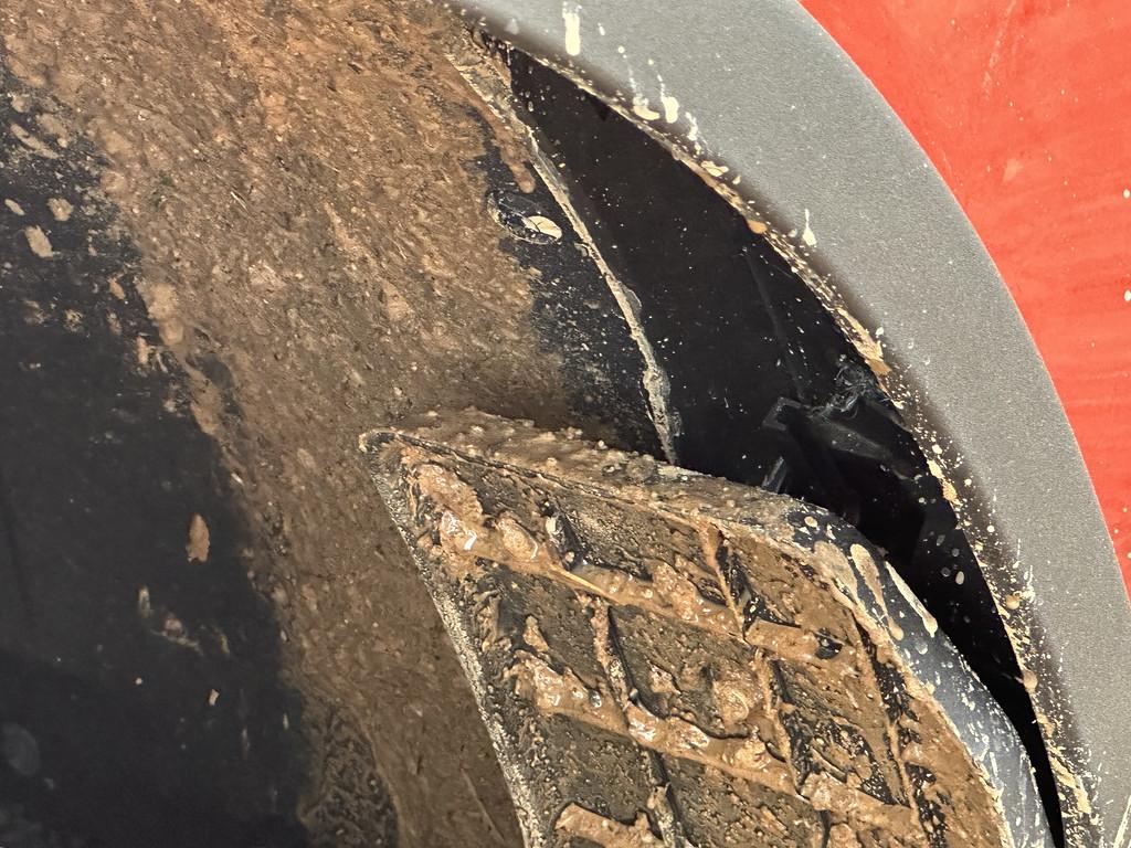

Also happy with the crashbar caps, definitely did there job.
With:
Ford Bronco TGO - The Overlander Build IMG_0862-XL
Without (You can see the mud up inside the crashbar) The mabett flaps wouldn't fit with the caps on:

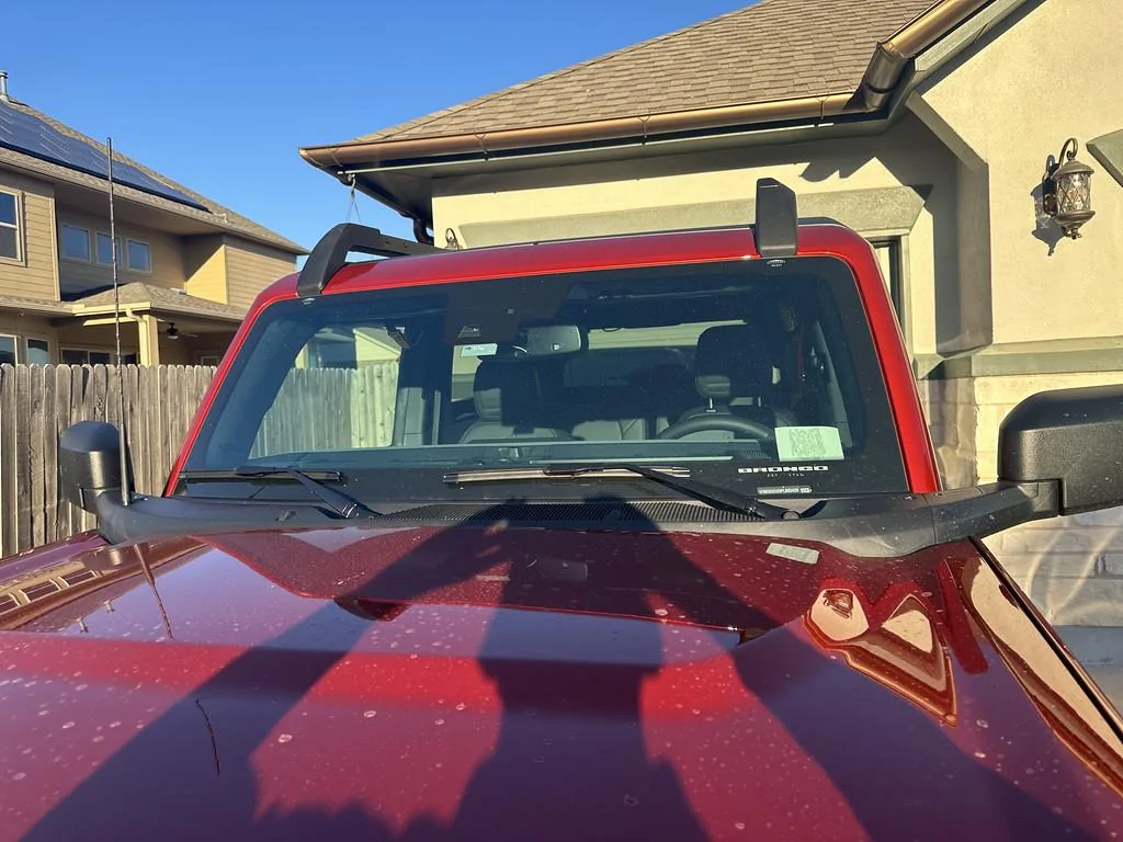

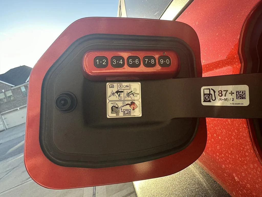

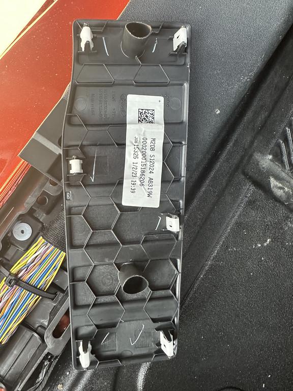

I got the windshield tinted this morning and finally moved the keyless entry pad to the gas door.
A few days ago I installed the front grab handles and a rear liner for the sunken area in the hatch floor.
I tried rinsing off the mud, but the crappy water here just left spots over everything.
Ford Bronco TGO - The Overlander Build IMG_0881-XL

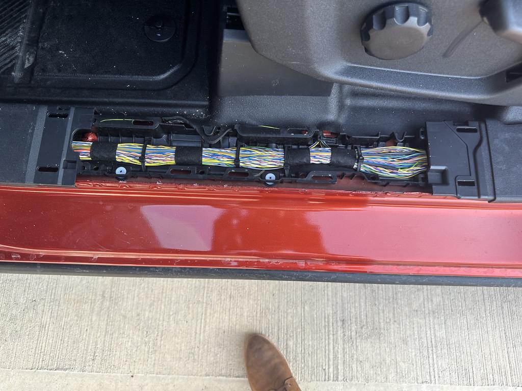

Interesting that they left the wires bare that plug into the rearview mirror. Guess I'll go buy some fabric tape and clean it up.
The reason for tinting the windshield is two fold, for one it's now legal in Texas to do so, so it helps cut out some of the heat, but I've had my windshield tinted on my Bison and I got a rock chip at the base over 4 years ago and it hasn't grown or cracked in all that time. It's decent insurance, especially since our windshields are pretty upright.
The keypad came off with a few tugs (it was sitting in the sun all day to help the tint cure) and mounted on to the gas door without any additional adhesive. There are only two rectangular blocks of double-sided adhesive tape. I suggest trying this method first before using fishing line. If you do the fishing line, you are going to cut the tape and have some adhesive to get off the door. The face cover comes off, do that first. On the inside of my face cover there was a sticker that said Hot Pepper Red and a date of 5/12/22. So obviously not painted with the vehicle.
Ford Bronco TGO - The Overlander Build IMG_0879-XL
Ford Bronco TGO - The Overlander Build IMG_0880-XL
I did get a quote to tint the front two windows, and it wasn't bad, but I'm going to postpone that to the summer, since so much cash is going out the door right now.

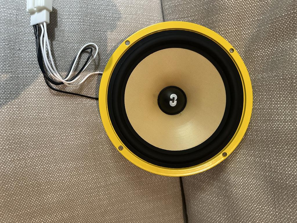

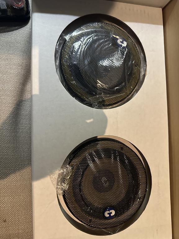

Ah, cleaning a bigger spot out in my garage last week to fit the Bronco in, I ran across a box of 3 way speakers that I've been holding since 2003 (when I was going to install them in my EVO 8). So I did a little research to see if they would somehow fit in the Bronco, and it looks like folks are starting to fabricate separate tweeter and mid mounts for the dash speakers with the B&O system in my Bronco.
I decided to wait and listen to the B&O system before I did anything, but after a week, the system is starting to hurt my ears. This has happened to me in a lot of vehicles. I was surprised in the Bison with the Bose system, while it doesn't sound great, it didn't hurt my ears, so I never bothered changing anything out.
Since the dashboard speakers are coaxials (meaning the tweeter and mid are in one speaker, rather than separates). I went ahead and ordered a relatively cheap pair of CDT Audio's ES-4EX speakers:
Ford Bronco TGO - The Overlander Build es4ex_lrg
ES-4EX
1 pr 4" mid-woofer 3/4” soft dome twtr
Technical specs and contents
  • Frequency response 65Hz-20,000Hz
  • Power handling:100watt @ HP 120Hz
  • Sensitivity: 86.6dB
  • Mounting depth: 2.25”
  • Cut out diameter: 3.75”
  • Frame: OD 4.62
  • Cone: Fiberglass mix
  • Magnet weight: 10 Oz
  • Cone surround: Butyl rubber
  • Impedance: 4 ohms
  • Voice coil: 1.0” (26mm)
  • Fs: 87Hz
  • ¾” smooth soft dome tweeter

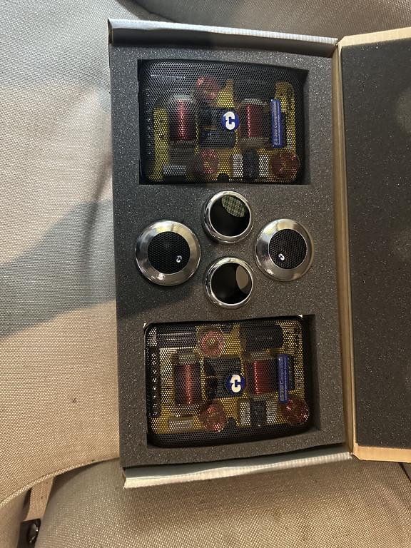

These are stop gap until I found the right mounts for the separates I have and have the money to change/add amps and get the proper processing equipment to do it right. But they won't be throw-away as I can use them as the rears.
But these puppies that I found in my garage are still being sold on Amazon for $1300.00 (and they are 20 years old). So I'm able to use the woofer now, in the stock location in the front kick panels. One problem the CDT woofers are 6.75 and the stock speakers in that location are 6.5. Metra makes an adapter plate for the kick panels that work with 6.5 & 6.75" speakers, part# 82-5605, they also make a harness to connect up to the factory wiring for the kick panel speakers, part# 72-5602. They also sell these together as a kit, part#82-FD1, but I couldn't find it anywhere.
  • Mid-woofer: Cast Alloy 6.75" Fiber Fabric Kevlar cone
  • Mounting depth: 2 3/4”
  • Midrange: Cast Alloy 4" Fiber Fabric Kevlar cone
  • Mounting depth: 2 1/4”
  • Crossover: ES-300CC “Transient Optimized”Elliptic 4th order 2-way
  • E.Q. 3-way xover. Read/download sep spec abt this xover
  • Tweeter: DRT-26 deluxe extended range modular 1” silk tweeter.
  • Power handling: 250 watt RMS @ 100Hz High Pass
  • Frequency response: 60-20kHz
  • Sensitivity: 92.6 dB.
  • Impedance: 4 Ohm
  • Tweeter surface mount both flat and angled &
  • flush mount both flat and angled.
Ford Bronco TGO - The Overlander Build IMG_0883-XL
Kevlar fabric cones:
Ford Bronco TGO - The Overlander Build IMG_0884-XL
Ford Bronco TGO - The Overlander Build IMG_0885-XL
Ford Bronco TGO - The Overlander Build IMG_0886-XL
Ford Bronco TGO - The Overlander Build IMG_0887-XL
There is something that digital crossovers can't seem to replicate and that's the smooth natural sound of a really good pair of analog crossovers. Helps to have silk tweeters too.
Ford Bronco TGO - The Overlander Build IMG_0889-XL
Ford Bronco TGO - The Overlander Build IMG_0890-XL
So hopefully I can install the kick panel speakers tomorrow. I'll have to wait on the dash speakers until I can find the proper wire harness for the B&O system.

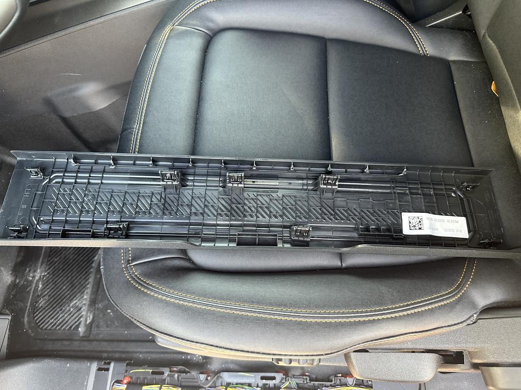

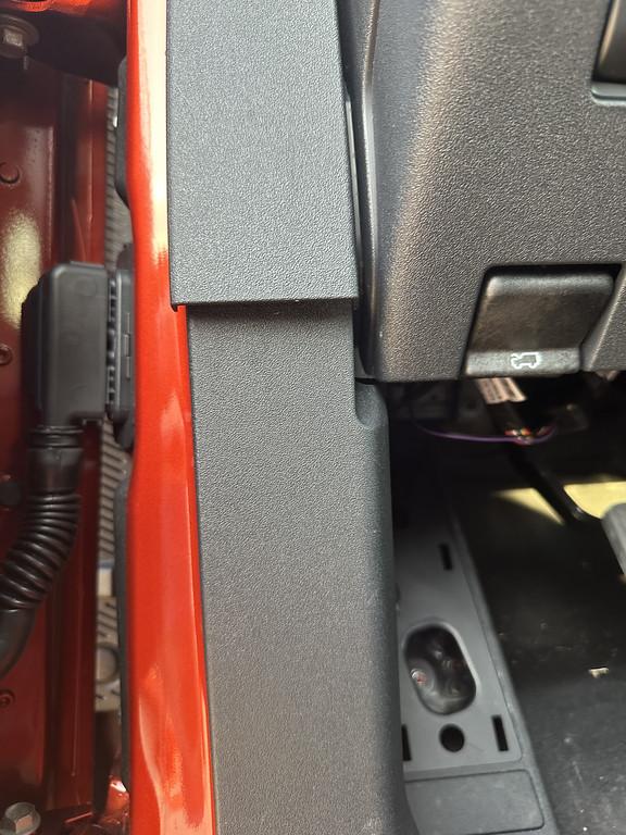

Replacing the Kick Panel Speakers was much easier and a lot quicker than I thought they would be:
Ford Bronco TGO - The Overlander Build IMG_0905-XL
Tools Used:
  • 10mm Long Socket with a small extension (for the dead pedal)
  • 7mm Socket to remove the stock speakers (3 bolts for each, save them you will reuse them)
  • Flat head screwdriver (used to get the harnesses apart)
  • Phillips head screwdriver (to secure the speakers to the adapter)
  • Thin metal trim removal tool (to get the cover off the dead pedal)
Steps taken:
  • Remove the trim panel in the bottom of the door frame in the middle. These have 5 tabs each, you need to pull up on this piece:
Ford Bronco TGO - The Overlander Build IMG_0895-XL
Ford Bronco TGO - The Overlander Build IMG_0896-XL
  • Next Loosen the the top of the trim plate, the one that overlaps the trim panel trim plate. You only need to pull out the bottom of it as two clips hold the kick panel trim plate:
Ford Bronco TGO - The Overlander Build IMG_0901-XL
  • On the passenger side, you can then pull forward on the kick panel (there is a Plastic Slot [not a tab] at the top rear of it, so you have to pull forward until it's out of the slot, then you slightly bent it to remove.

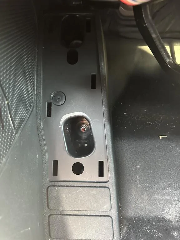

  • On the driver's side, you need to remove the cover from the dead pedal, in order to expose the two nuts, you need to remove. I used a very thin metal trim tool, to remove the embedded trim cover on the top 2/3 portion of the trim pedal.
Ford Bronco TGO - The Overlander Build IMG_0897-XL
Ford Bronco TGO - The Overlander Build IMG_0899-XL

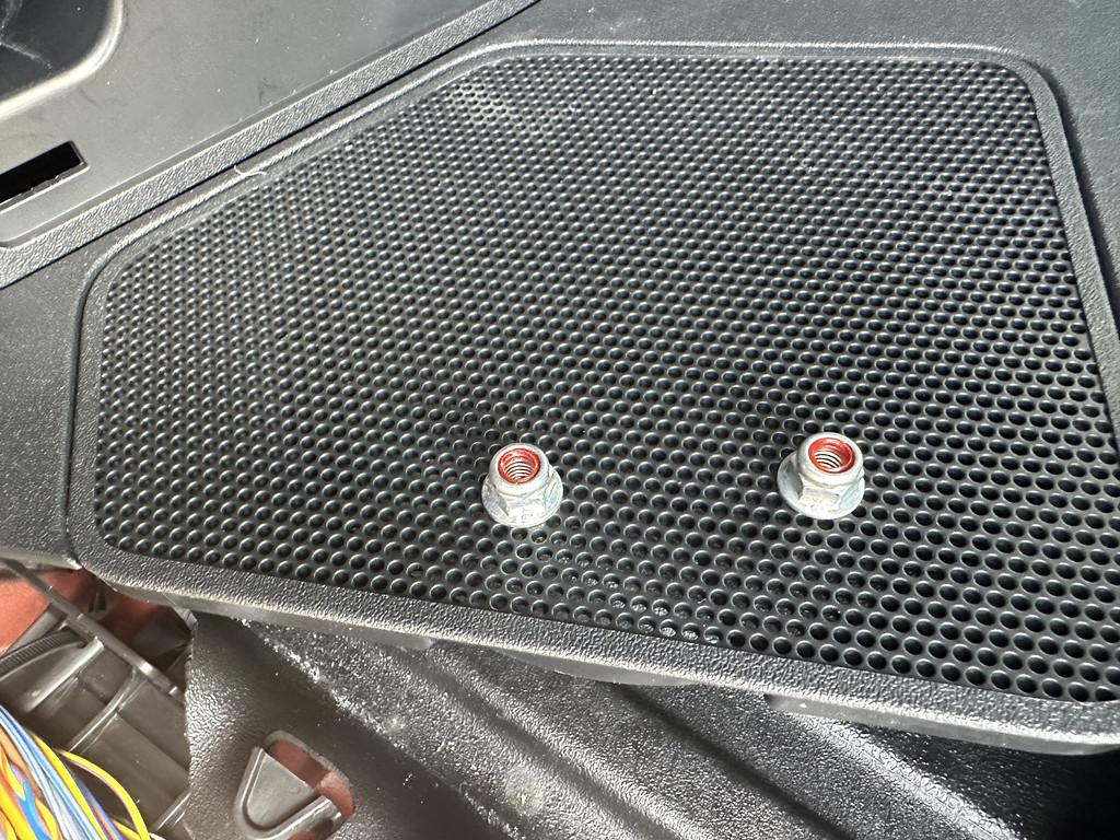

  • Inside the base of the dead pedals, are two 10mm nuts, they are deep in there so you will need more than just a deep socket, probably a small extension. They are threaded on a long bolt, so just be patient. You probably have to leave the nuts in there, because you can't really get in there to grab it, but they fall out once removed.
Ford Bronco TGO - The Overlander Build IMG_0898-XL
  • Remove the nuts, then you can pull the kick panel off, you will need to do some minor twisting to get it out. Save the nuts
Ford Bronco TGO - The Overlander Build IMG_0902-XL

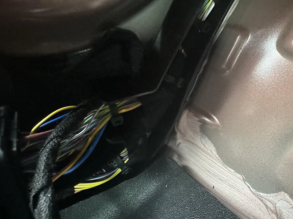

  • To remove the existing speaker, you will need to first remove the harness. You can push down on the exposed side and try to pull out, you'll see a slot, that has a raised portion on it, I used a flat head screw driver to press it down while pulling. Notice that the harness is on the outside of the speaker frame. You will need to reroute this so it goes inside the speaker frame in order to connect your speakers to it (I highly suggest the Metra Harness for these).
  • Once you remove the harness, there are 3 7mm hex head screws to remove the speaker. Save these screws.
  • Just remember speakers have big magnets in them, so careful where you set it down.

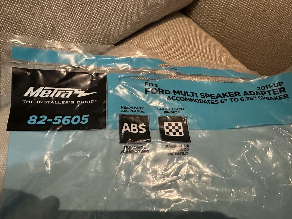

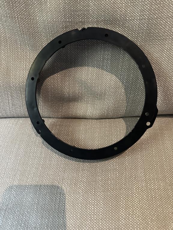

  • Since I was using the Metra Adapters for my 6.75" each speakers, I had to break off the internal tabs (those tabs are used for a 6.5" speaker) and then I used the retain hex head screws to mount the adapter to the existing holes.
  • Know you need to route the OEM harness to inside the speaker frame, at the bottom of each speaker frame, there is an opening at the bottom (covered by some soft cloth type material), move the material away and feed the OEM Harness to inside the speaker frame on the vehicle. I know this is a bad picture, but look above the colored wires and you can see the cloth that you need to move away to pass the OEM Harness through.
Ford Bronco TGO - The Overlander Build IMG_0904-XL
  • Before you mount your speaker, connect the speaker harness to the OEM harness. Then screw your speaker into the adapter.
  • Test your speaker before you put everything back together again. If everything is good, reverse steps:
    • Install the kick panel, on the passenger side, make sure that extended piece goes into the slot on the back of the firewall, in the door frame move the top of the kick panel underneath the trim piece you only took the bottom off of.
    • Install the kick panel on the driver's side, trying to get the nuts on the stem within the dead pedal is not fun, so just be patient, tighten these down, replace the dead pedal cover, and then make sure the top of the kick panel is underneath the trim piece you only the bottom off of.
  • Replace the bottom door frame trim and you are done.

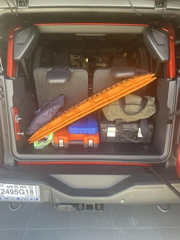

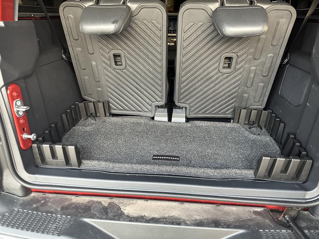

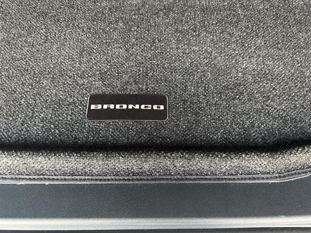

Also installed the cargo rug today. I chose this one for a few reasons, one it's soft, so my dog will prefer it, but the main reason, it's was the only cargo floor cover that left access to the tie down points.
It has the company name of Cargo Glide on the plastic pieces. These pieces can fit together to create corner pockets or you can use them all individually depending on how you want to support your cargo. I figure they will come in handy when getting groceries and the rug has some padding under it, so it should keep the cargo floor in good condition.
Ford Bronco TGO - The Overlander Build IMG_0906-XL
Ford Bronco TGO - The Overlander Build IMG_0907-XL

Overland Kitted Spare Tire Maxtrax and Rotopax Mounting System.
As mentioned, I'm taking a different way of modifying my Bronco vs. what I did with my Bison. Since this is going to be my daily driver, I don't want to drive around with unnecessary weight, and since the Bronco has a miserable payload, I'm trying to be very aware of how much weight I'm putting on. Since I also paid for the extended warranty, I'm trying to keep as much as stock as possible and/or use Ford Accessories when they meet my needs.
So if I had the money and didn't care about the warranty. The first thing I'd do is replace the stock roof rack with a TrailRax and the associate PaxRax. The second thing I looked at was the M.A.S.S. Spare Tire Platform Mini from American Adventure Lab, put configured to carry both maxtrax and rotopax you're looking $560.00 and you just ruined all of your real rear view vision. Then I found Overland Kitted Spare Tire Matrax system and I was intrigued, pricier than what it should be (but what isn't these days) and recommended by Maxtrax USA. I thought I could do it cheaper than the $340.00 system, because I had a Racksbrax Matrax mounting plate that I thought I could mount to their system, so I bought their accessory bracket with strap first. When that didn't work I ended up buy the Complete System so I'm into this for $440.00.
After I purchased this, I came across Rockslide Engineering EZ Rack for $110.00, that comes with two accessory plates and is intended for only Rotopax, not Maxtrax, and when I saw that they don't recommend anything bigger than a 2.5 gallon rotopax, it doesn't appear to be as strong as the Overland Kitted which says can hold up to a 3 gallon rotopax and 4 Maxtrax Extreme boards.
So I went with the Overland Kitted set:
Here's the accessory bracket strapped to the tire:
Ford Bronco TGO - The Overlander Build SpareTireBracket_1300x
And the Rotopax mount can mount directly to that. For the maxtrax mounting you'll need to attach the Universal Maxtrax Mounting Plate. The nice thing about this plate is you can mount it to roof bars, roof racks and platforms, so I can use this on my Bison too.
Ford Bronco TGO - The Overlander Build FSPlateTop_1300x
I can't say it's fun installing with one person, things kept sliding and moving, I definitely recommend getting someone to help you install it.
Ford Bronco TGO - The Overlander Build IMG_0918-XL
I had to mount the boards up higher, which is why they are at a slight angle, but they just clear the tailgate handle, which is still usable:
Ford Bronco TGO - The Overlander Build IMG_0919-XL
Ford Bronco TGO - The Overlander Build IMG_0922-XL
The strap, is a 2-inch MAC's Custom Tie Downs that is very beefy and smooth to use:
Ford Bronco TGO - The Overlander Build IMG_0925-XL
The Rotopax is close to the tailgate, but doesn't touch it (this is a 3 gallon Rotopax) and the tailgate still opens fully with this on there. I originally wanted the maxtrax on this side, but I wouldn't be able to open the tailgate fully.
Ford Bronco TGO - The Overlander Build IMG_0927-XL
Ford Bronco TGO - The Overlander Build IMG_0928-XL
It doesn't really block the rear view all that much. It might affect the 360 degree rear view, I'll have to check it when I'm not in my garage:
Ford Bronco TGO - The Overlander Build IMG_0929-XL
While I was hoping to be able to do this for under $300.00 dollars, spending $140 more got me what I wanted. Something that can be taken on and off relatively easily, can be used on another vehicle and not impeding my rear visibility.
I'll fill up the rotopax and drive around to see how it does, the maxtrax do wobble but they are definitely securely mounted.

Broaddict Single Cross bar for OEM Roof Rack
In Ford's not so bright wisdom offer's a Roof Rack from the factory as an option. However they only give you two crossbars. Normally on most roof racks, this is fine, you get one at the front and one at the rear. However with the Bronco roof rack one bar in 1/3 from the rear and one in the middle. There is no front bar and they want to charge you an additional $200.00 to put a crossbar at the front of the rack.
I found Broaddict on Amazon and saw they sold a copy of the oem bar, and on that particular day it was priced at $66.75 (Currently it's $89 on amazon with a 5% off coupon), so less than half what Ford is asking.
The Broaddict bar is a complete copy of the factory bar, the plastic piece doesn't form as nicely around the Broaddict bar, but seeing how tall most Bronco's are you'll never see it, the only other difference is the 4 bolts provided are silver, where the factory ones are black and branded Bronco. At least Broaddict did use the same T27 size, so you don't need to get a different tool for anything else on the rack.
Ford Bronco TGO - The Overlander Build IMG_0931-XL
The Broaddict Bar:
Ford Bronco TGO - The Overlander Build IMG_0932-XL
Ford Bronco TGO - The Overlander Build IMG_0933-XL
Ford Bronco TGO - The Overlander Build IMG_0935-XL
The Factory Bar:
Ford Bronco TGO - The Overlander Build IMG_0934-XL
Ford Bronco TGO - The Overlander Build IMG_0936-XL
Not bad for less than half the money of the real thing.

CDT ES-E4X coaxial speakers for the front dash (fail) and the rear pods (win).
So my wire harness adapters came in today from Fast Daddy on ebay. Nice quality for the price. I got the set with 300hz blockers (to block the bass) for the front 3 speakers and no blockers for the rear. I was able to test the new speaker in the dash and wasn't as big as an improvement that I would like, but didn't have a choice, these are old school spears where there is metal mounting ring around the whole speakers, where it seems newer 4" speakers don't have this ring and just have small mounting tabs that come out from the speaker. There is also a wire harness that is at the bottom where the speakers mount, which I would need to remove if I could actually mount these speakers, but I can even get them all the way in the dash.
So I move onto the rear pods in my 2-door. I was surprised how much room there is back there for 2 people, when I checked the specs, the 2-door only looses one inch of leg r. oom and obviously the supposed middle sit, but that makes for a more airy feeling in the rear because you're not slammed up against the side plastic. Being high up it's not really ergonomic to get in out of the rear seats on a 2-door, but it's not a penalty box like I thought it would be.
The rear pods grills come off easy enough, and I was surprised that they included an extra harness so you can detach the pod from the roll bar without having to disconnect the speaker first. I was worried that the extended tweeter on these speakers would stick out to far for the grill to go back on, but that turned out not to be a problem. I did have to drill 3 new holes to mount the speaker, I just drilled into the plastic, it was simple as could be. I did test the Fast Daddy ebay harness with the bass blocker and with out. I definitely preferred the sound with the bass blockers, than without, both sitting in the front and hearing them as fill as well as sitting in the back seats with all the sound going to back as well as centered in the default fade position, so I left them attached. Guess I'll have to get two new harnesses for the front speakers if I can get the coaxials in there.
What surprised me is using the surround mode how much fuller everything sounds, so with the 6.5 kick panel speakers replaced and the rear speakers replaced, the front stage does sound much better, but now I really want to complete the three way setup in the front.
Ford Bronco TGO - The Overlander Build IMG_0940-XL
Ford Bronco TGO - The Overlander Build IMG_0941-XL
Even the 4" separate wouldn't fit in the dash.
