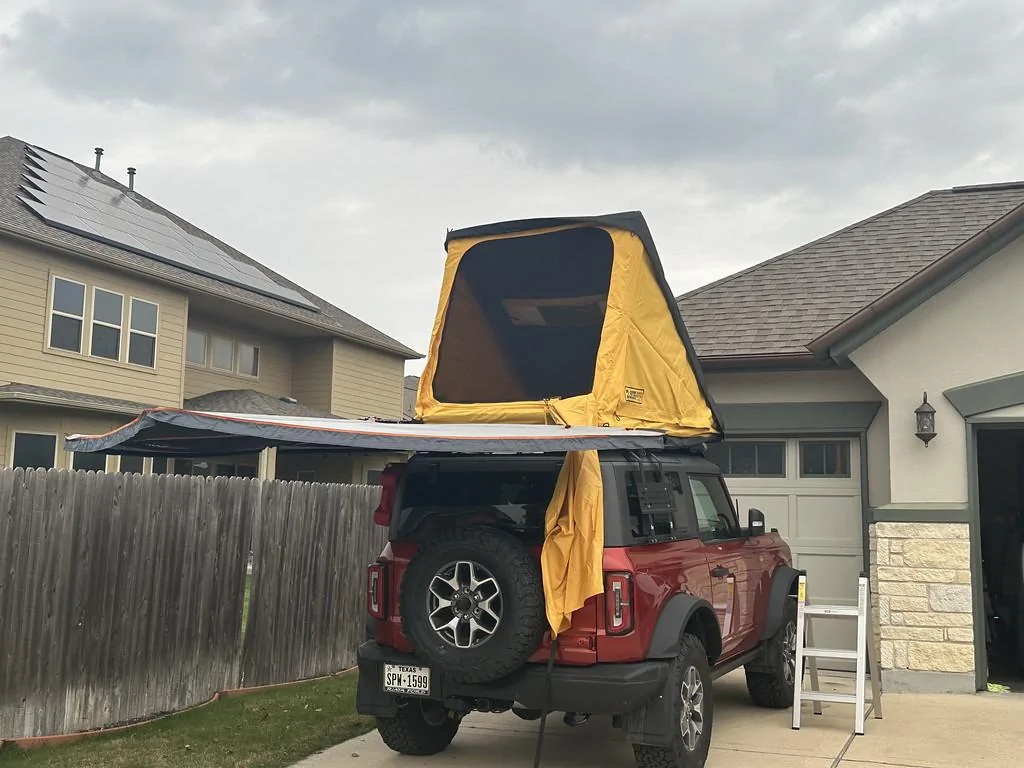

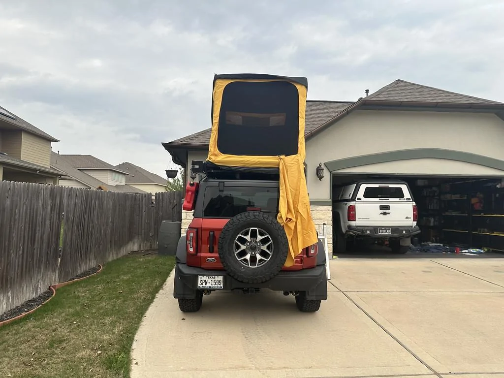

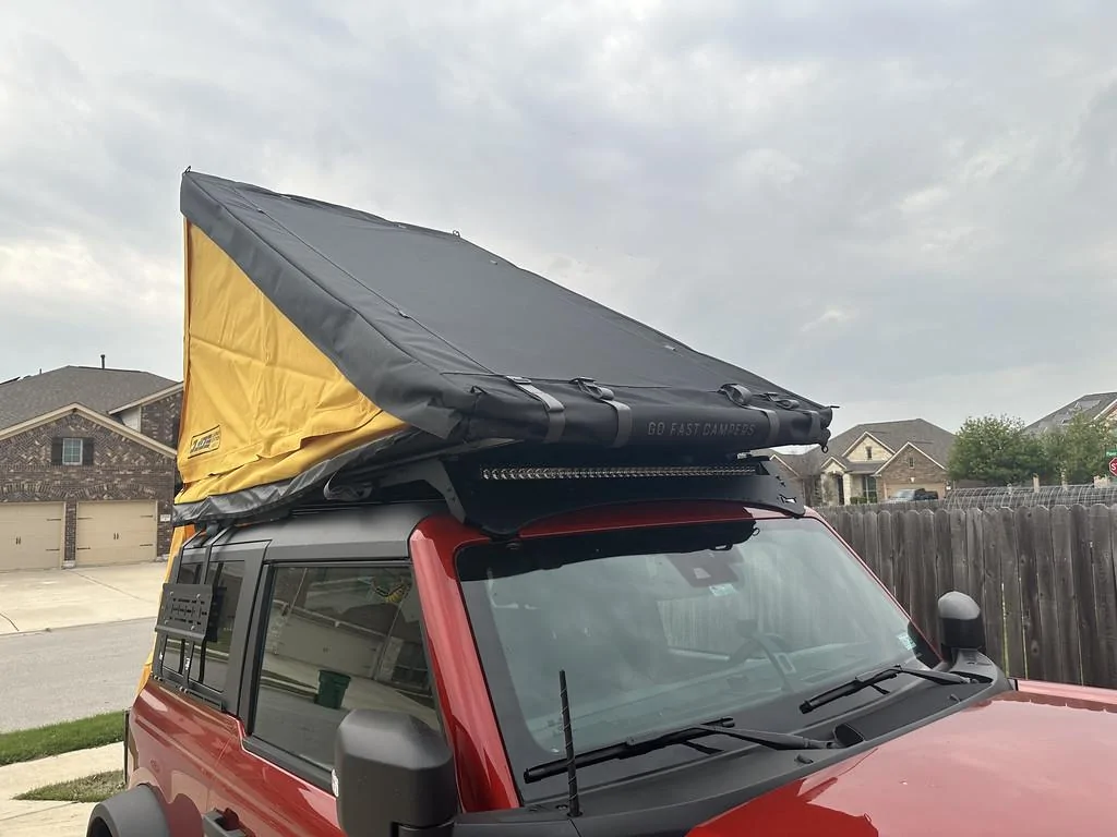

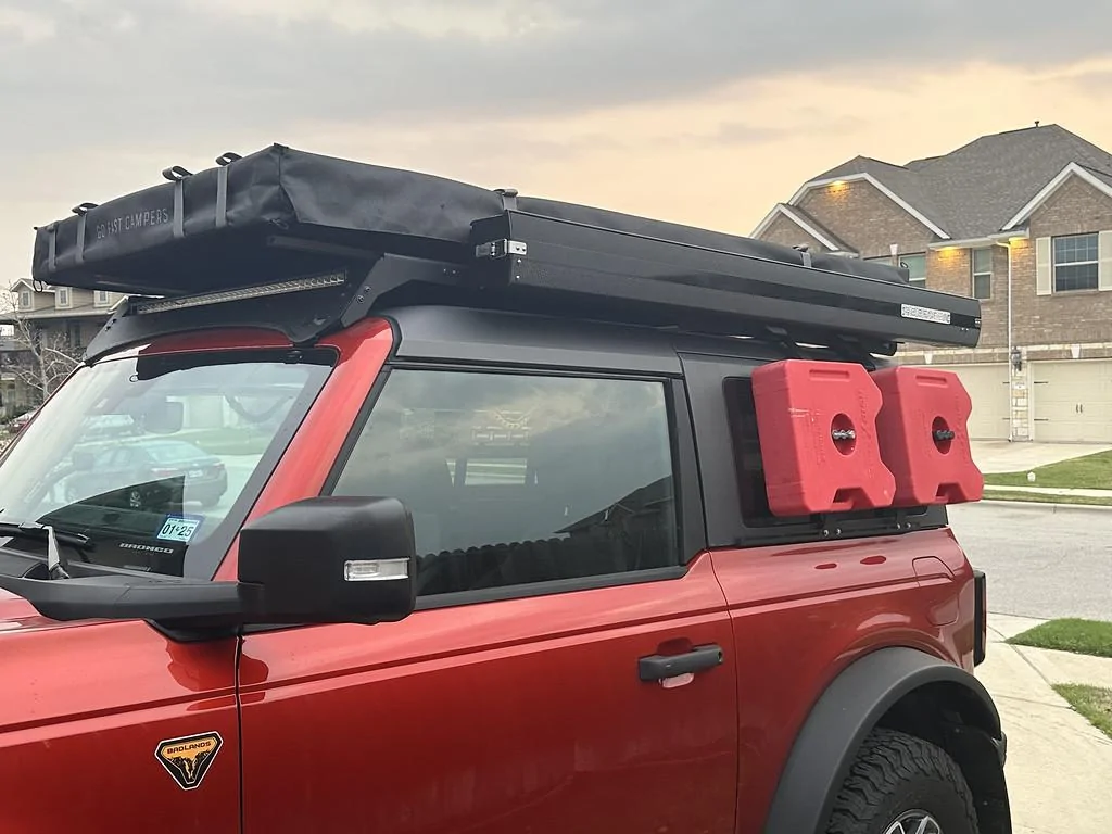

GFC Superlite finally got on the rack today. I do love that I can get it on the vehicle by myself, it's only 80lbs, so easy to lift up and push on.
Ford Bronco TGO - The Overlander Build IMG_1006-XL
Ford Bronco TGO - The Overlander Build IMG_1004-XL
Ford Bronco TGO - The Overlander Build IMG_0998-XL
Ford Bronco TGO - The Overlander Build IMG_0995-XL
Ford Bronco TGO - The Overlander Build IMG_0991-XL

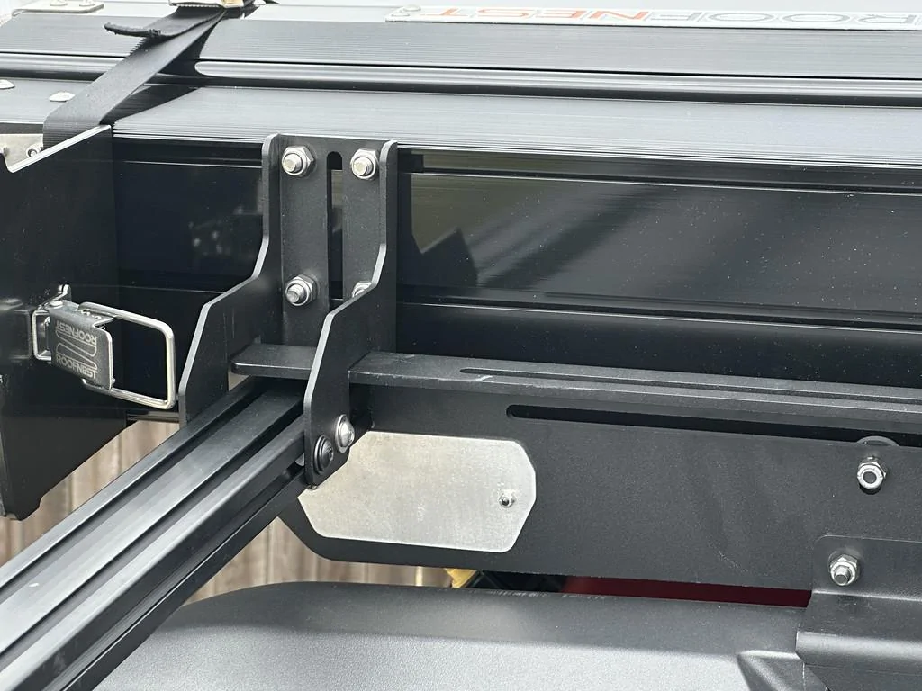

Installed them with GFC's Quick Release Mounts, what's great about these is there is just a lever you move 1/4 turn and it locks it in. There are separate locks, that I just ordered 2 of them. But what is great, is you can easily move the tent back and forth and get it just the way you want. If you notice in the pics, the tent is over the windshield, that will be the position I put it in when stopped/sleeping, and can just slide it back for driving. I didn't think that I'd like that it raises the tent up, but with the TrailRax brackets that are holding the awning, it brings it a mm above those so I can somewhat center it. I have to leave some room against the back of the awning, so that I can unzip that side. If I use the traditional mounts, I'd have to have it hangover 3 more inches on the passenger side.
Ford Bronco TGO - The Overlander Build IMG_0988-XL

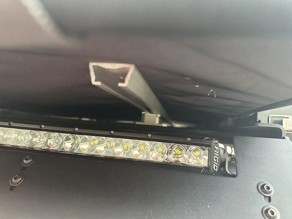

I've been playing with the placement of the tent moving back to have the front level with the fairing and light bar to see if that cuts down on some of the wind noise. Having it level with the fairing does cut the noise down, but the gap between the light bar and the tent just creates a vertex so I'm thinking of stuffing a pool noodle between them with a wire running through it to tie to the rack. I could feel the wind when I touched the roof panels from inside. The tent also hangs about 10" off the back. I'd be worried if it weighed more.
So a 28lb Awning and a 80lb Tent, if it wasn't for the 13lb Light Bar, I'd meet the 110lb dynamic weight for the OEM Roof Rack. TrailRax says the dynamic weight of their rack is 300lbs and 70lb for each side of the Pax Rax, so I'm well under those.
Alu-Cab just announced a 101lb Aluminum Tent, but their mattress weighs and additional 10lbs. It's tempting, but more than double than what I paid for the original Superlite.

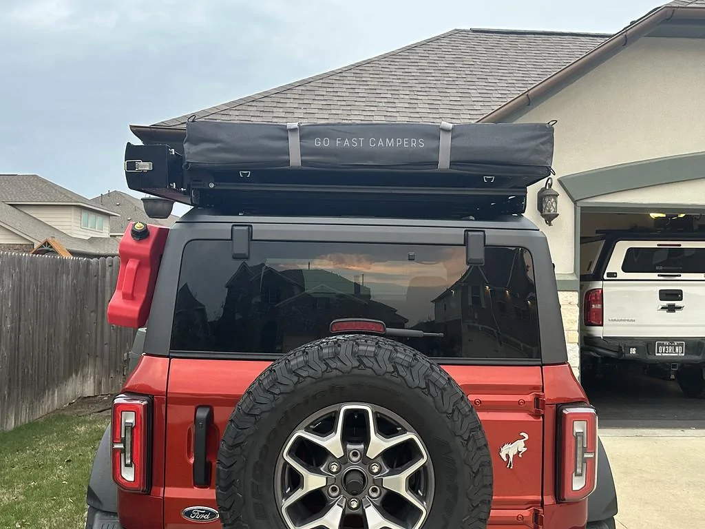

Thank you, I would say you would be looking at 20-30 minutes to take off the rack. You would need to take off four bolts at the header where the side rails attach, 8 bolts where the Pax Rax attaches to the fender brackets, 4 bolts and nuts ( possibly just loosen) where the rear roof brackets attach, then the four bolts attaching the header. You could stop there if you have a place to store it almost fully assembled. You could possibly skip in doing the side rails from the header and just unbolting the header, but those bolts are really hard to access.
The regular Litewing awning is six and a half feet long closed and provides 70 sq feet opened, the XL version is 8.2 feet long closed and provides 100 sq feet opened. I think the 70 sq feet is adequate coverage for two to three people and the sizing is perfect for the two door Bronco. If I had a 4 door I would go with the XL which would be perfect for 4 people.
One thing to note about mounting the Litewing is that the rear door on the hard cover rotates to open the awning so you have to have six inches of clearance to open it. Which is why mine is mounted further back.

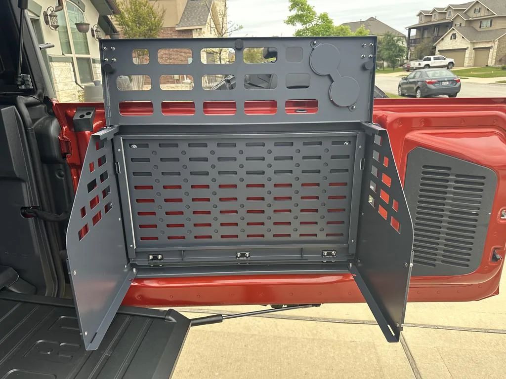

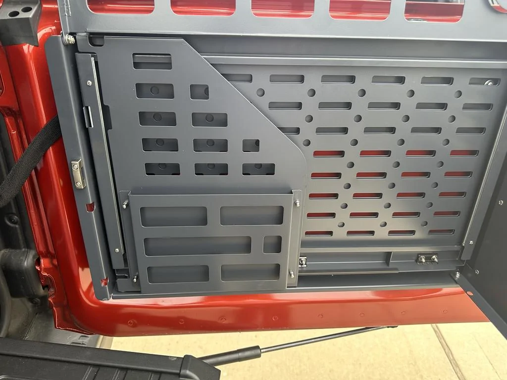

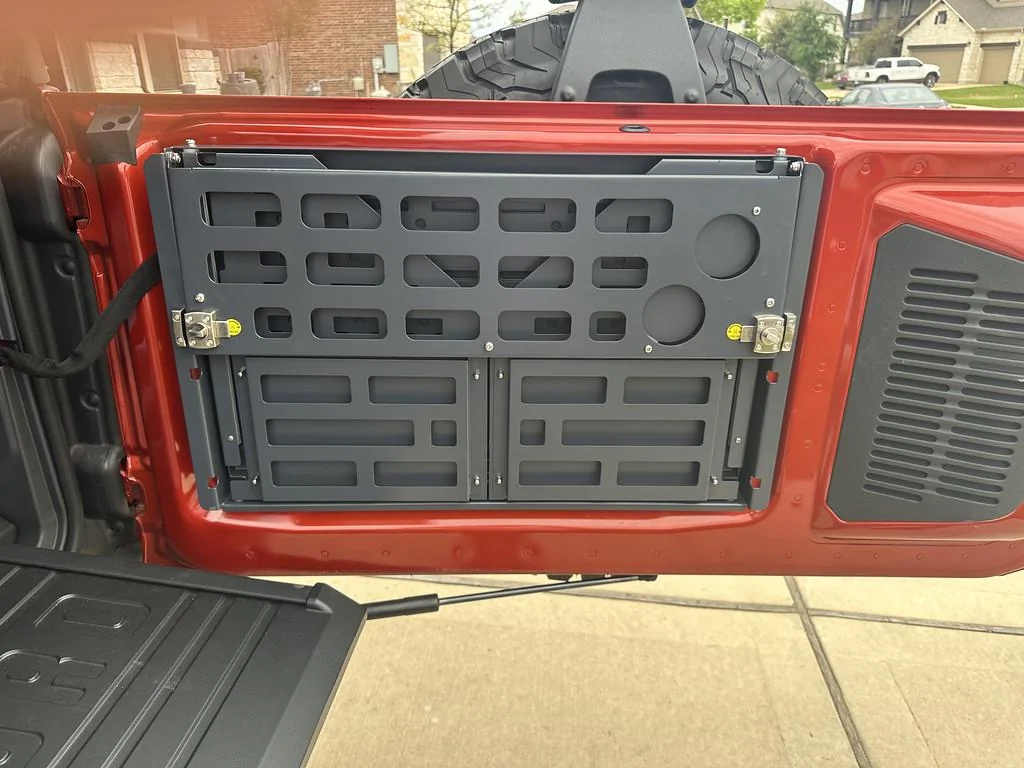

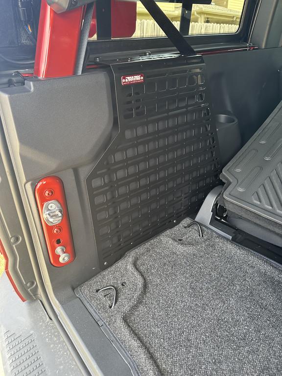

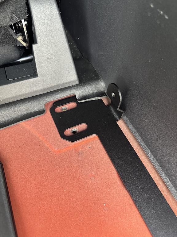

I ordered the BuiltRight Industries 2-door rear Molle Panels as a way to attach my fire extinguisher (ended up not working on the roll bar, or so I thought, but when I took the roof off to install the PaxRax, I ended up catching part of the Badass Moto in between the roof and the side mount and that's why it must of kept turning). Anyway the main point of the Molle Panels was to install a DC-DC converter so I could charge my EcoFlow Delta2 faster than just with the cigarette style plug.
They install with brackets that go under the OEM tie-down brackets:
Ford Bronco TGO - The Overlander Build IMG_1009-XL
Ford Bronco TGO - The Overlander Build IMG_1011-XL
Ford Bronco TGO - The Overlander Build IMG_1014-XL
Ford Bronco TGO - The Overlander Build IMG_1036-XL

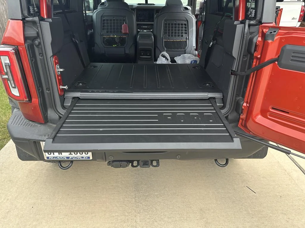

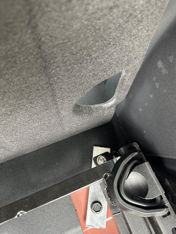

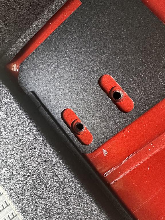

However, when I saw someone's post that they were able to get the slide-out tailgate installed in a 2-door, I had to order it as I knew that would make a huge difference on trips having a place to sit or to prepare something without having to remove anything from the trunk. I wasn't sure if the Molle panels would work with the slide-out tailgate and in the end they didn't but I do think I'll be able to fabricate something to get them to work. I tried just zip tying the bottoms to the slide out tailgate frame, but I couldn't get the cover to fit with the installed. In order to install the slide-out into a two door, you just need to create a place to attach the rear of it:
That's the bracket I made to use one of the rear seat bolts:
Ford Bronco TGO - The Overlander Build IMG_1039-XL
Ford Bronco TGO - The Overlander Build IMG_1038-XL
Ford Bronco TGO - The Overlander Build IMG_1037-XL

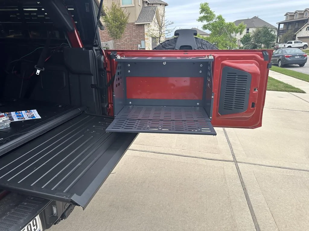

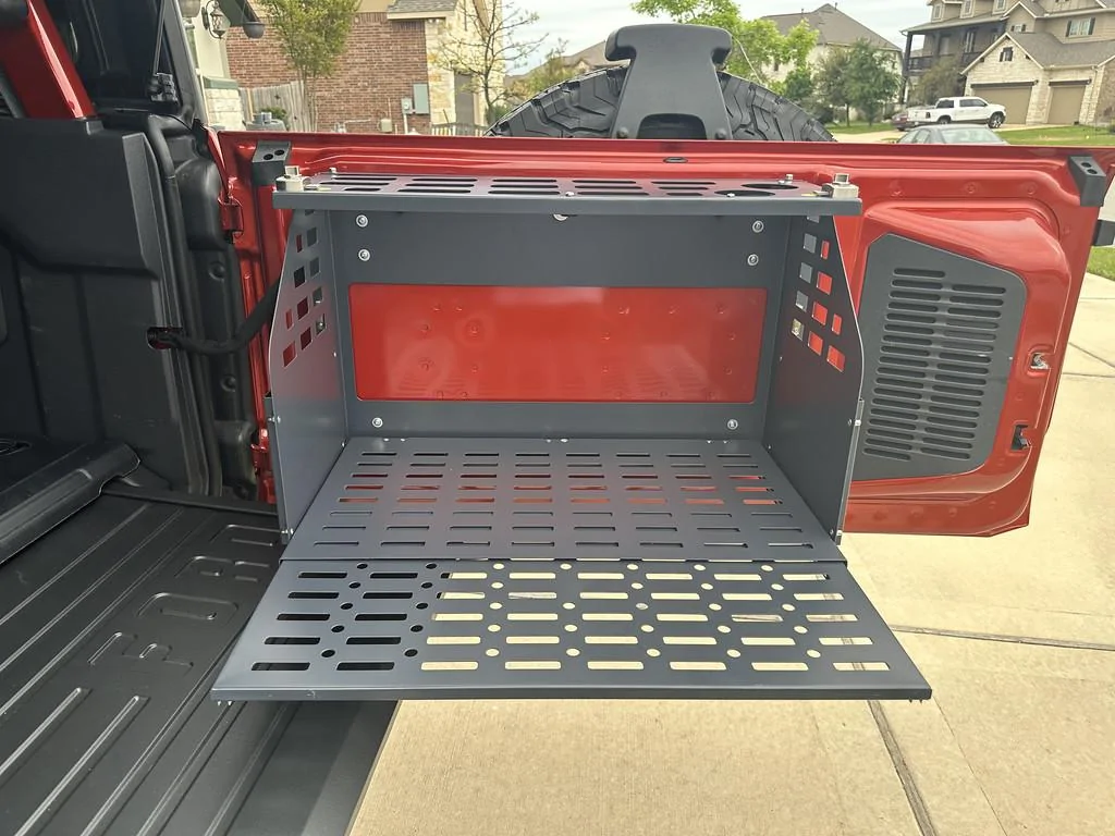

While I was installing the slide-out tailgate my Mabett v3 tailgate table came in:
Ford Bronco TGO - The Overlander Build IMG_1048-XL
Ford Bronco TGO - The Overlander Build IMG_1047-XL
Ford Bronco TGO - The Overlander Build IMG_1046-XL
Ford Bronco TGO - The Overlander Build IMG_1045-XL
Ford Bronco TGO - The Overlander Build IMG_1044-XL
Ford Bronco TGO - The Overlander Build IMG_1043-XL
Ford Bronco TGO - The Overlander Build IMG_1042-XL
Ford Bronco TGO - The Overlander Build IMG_1041-XL

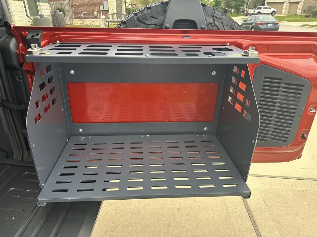

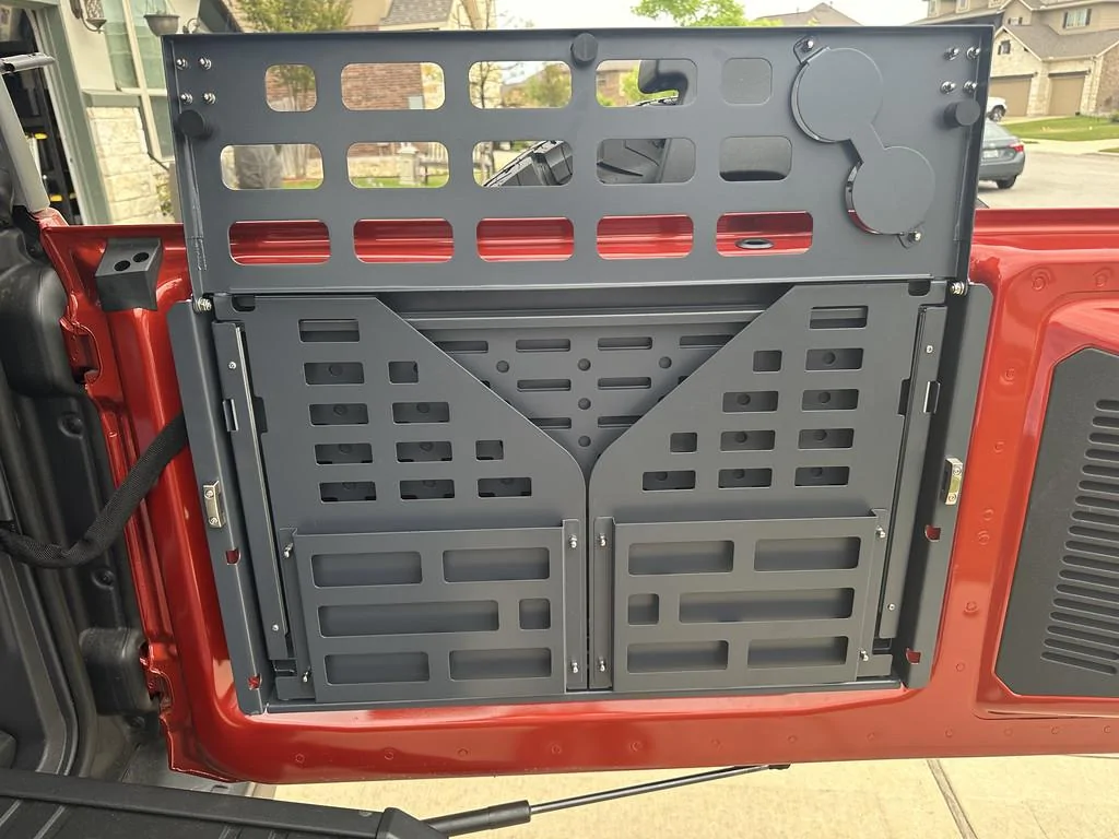

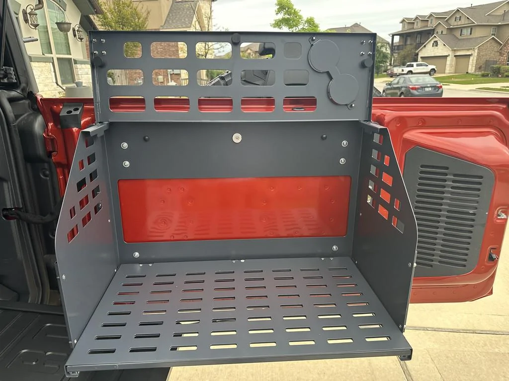

While I wanted something made out of stainless steel, the price ($239) and the functionality of this one called to me, so I thought I'd give it a try.
First, I watched the video and read through the instructions. There was no way to get the little bars through the opening on the right (when the door is open) side of the tailgate, luckily there is a rather large hole next to them, so I was able to carefully put the bar on the backside and screw into it from the front. The Left top side the little bars went in the way the instructions show. Also I ended up replacing the washers provided as they were to small and feel into the hole when tightening up. I just used 1/4 SAE washers that were wider. Otherwise the install was relatively easy and one person can do it on their own.
2nd observation is the unit itself is dark grey that doesn't match anything on the Bronco. I would of preferred it to be black.
Overall for the price it seems to be well made with an enamel type of paint. Would be awesome if it was made out of food grad stainless-steel, but I'm sure that would a couple hundred of dollars to the price. The slide out piece seems fairly stable (as long as you pull it out to the farthest it will go). I see why it's not possible, but wish the top piece could be deployed without the side pieces deployed. And for those of you with the slide out tailgate, you can deploy both at the same time.
One downside is the closing "locks" you need to push in hard to get them to close, which means you either have to hold the tailgate door or move it to the max position. Hopefully the will close easier with wear.

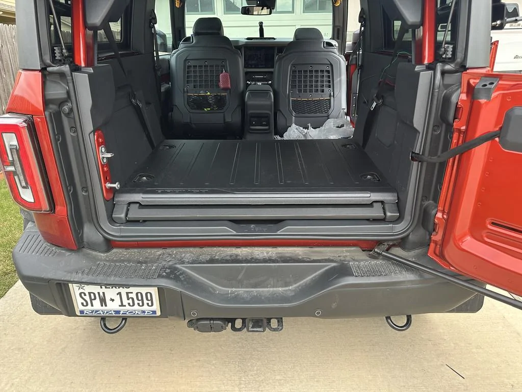

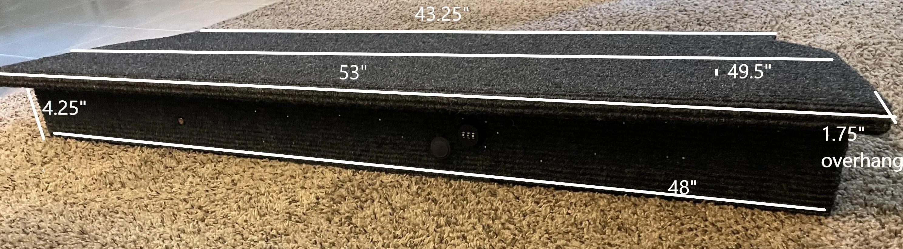

I had no idea the slide out tailgate fit on the 2 door. How much room is left behind the front seats? I'm looking into rear seat delete options and I may have to add this to the list. I guess it wouldn't be too hard to make something to level the rest out.
Check out this post, he made it level out:
https://www.bronco6g.com/forum/threads/2-door-slideout-tailgate.68378
Ford Bronco TGO - The Overlander Build untitled-jpg
There's about 1 foot 4 inches left to level out, where the floor goes down, then you'd have whatever room between the front seats. He also made extra boards for when the front seats are moved as far forward and tilted.
According to DeepSleep, which just made mattresses for the 2-door, there is 5 feet from the back of the front seats (slided forward), and about 6'3" if you lay diagonal.

Haven't been keeping up with my postings, but I have been busy working on the Bronco.
I last left you all at installing the TrailRax and the Superlite. When I got the Superlite on a few days later there was loud creaking and a lot of air noise. I tried moving the Superlite back so the front was even with the wind fairing and shoved a pool noodle between the tent and the fairing. I ran a wire through the middle of the pool noodle and tied it to the side rails of the TrailRax that worked for one day, so I'm going to need something stiffer to put through the middle of the pool noodle, also switched out the pool noodle for pipe insulation since the bright colors of the pool noodle weren't to my liking.
Well doing all of that the creaking and the air just didn't go away, so I researched and found TrailRax suggests moving the wind fairing up as high as it will go. Seems the opposite what one should do, but it brought down the wind noise to acceptable levels, but I still had loud creaking. To stop that my research showed putting something between the wind fairing where it meets the side rails, didn't think that would help my situation because I took the front roof panels off and I could hear that the cross bar the the tent mounted to was the one creaking. But I was willing to try anything so I loosened the wind fairing and put a zip tie in-between on both sides and tightened it down, Low and behold the creaking stopped. I have some wind noise still but it's 80% better, so I'm going to try the pipe insulation again.
The Mabett may be a good option for a Tailgate table?
