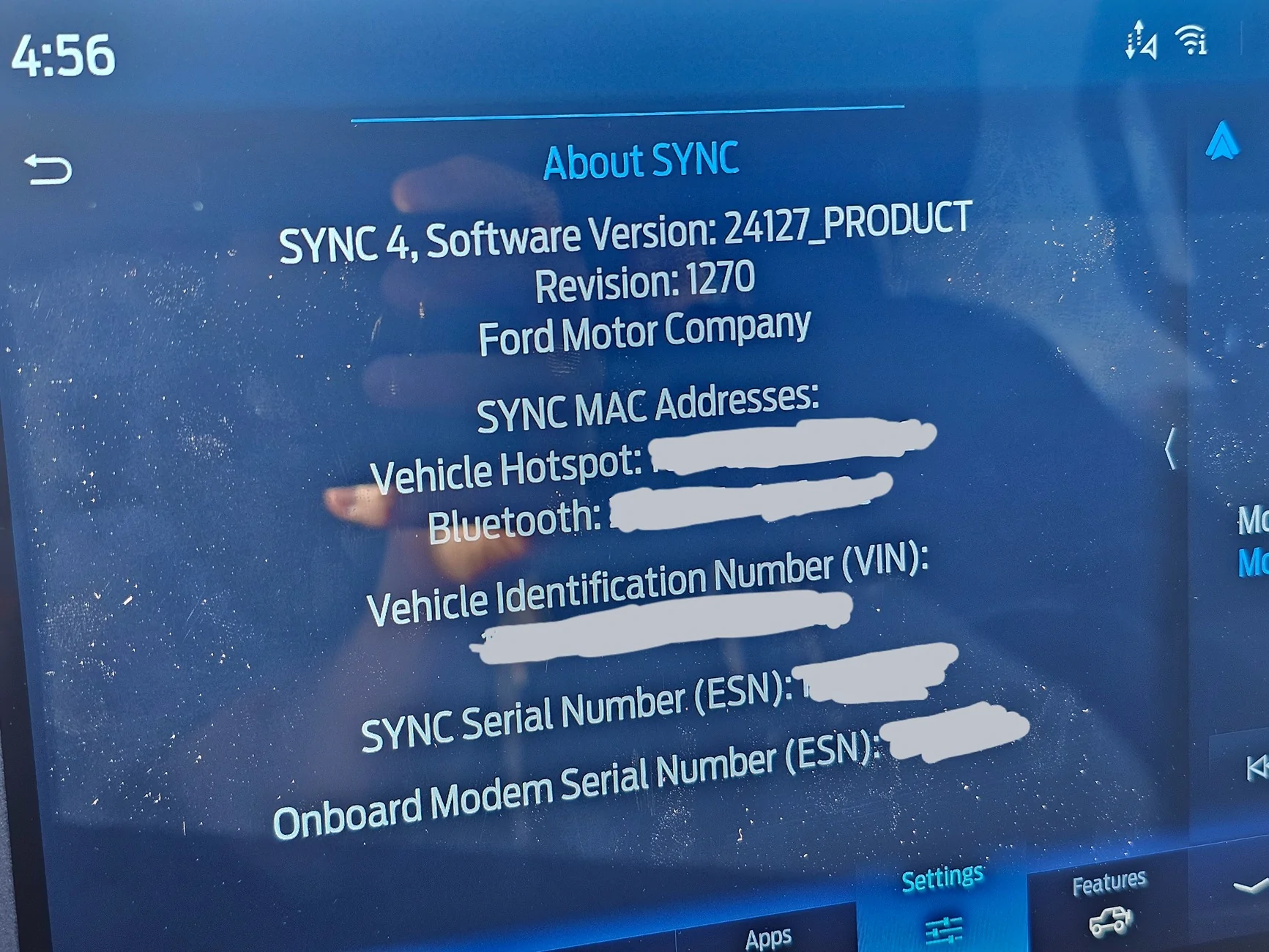

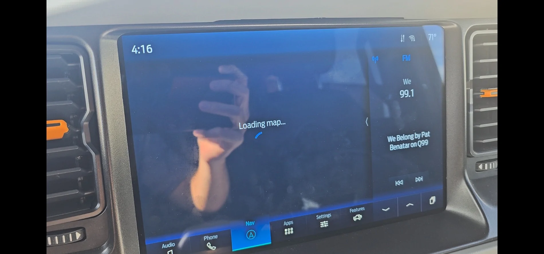

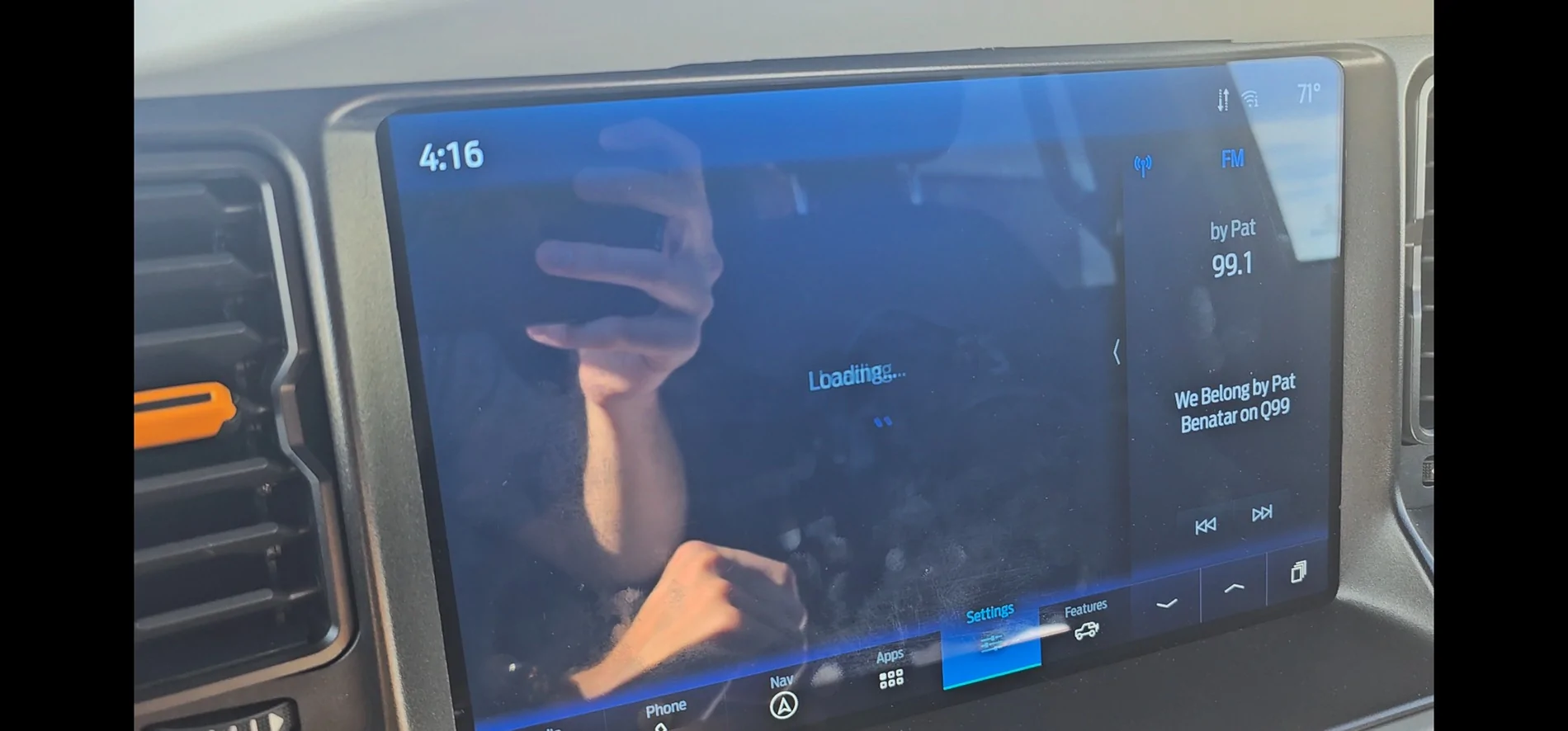

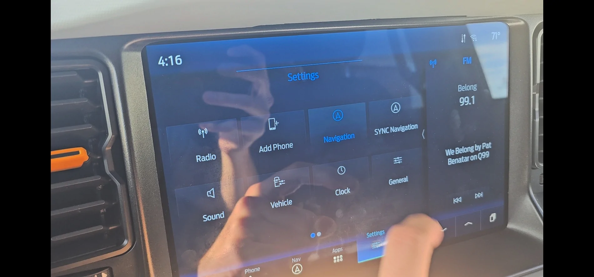

Wanting some advice on this issue. I've attached pictures but the navigation settings and navigation map page will not load. I have the gold certified used warranty on my 2021 badlands with the larger infotainment system and I have already paid my dealer for an hour of diagnostics for them to gaslight me all week until they admitted there was an issue after having my vehicle four days. Then they said they will need an additional 3 hours of diagnostics (scheduled for 2 weeks from now) and that I have to assume the additional $500 risk of them not "finding a part to replace" if that part is even covered...
From my understanding of the gold certified warranty all the infotainment systems are covered.
Wanted to post here to see if anyone has had similar issues or has found a fix before I risk $500 on something I don't actually need but just want to have as a backup

I've seen this several times on the F150 forum. Generally it was an incomplete update, where not all files got updated and then was in an inconsistent state. If I recall, the dealer had to replace the APIM in those cases as they can't reinstall the latest version.
Some of the F150 folks could go from the navigation loading screen to their radio screen and then back to navigation, and sometimes that worked.

Paid for the subscription and then using voice commands I got the map to load. But otherwise it's still broken (settings won't load) but interesting glitch.
