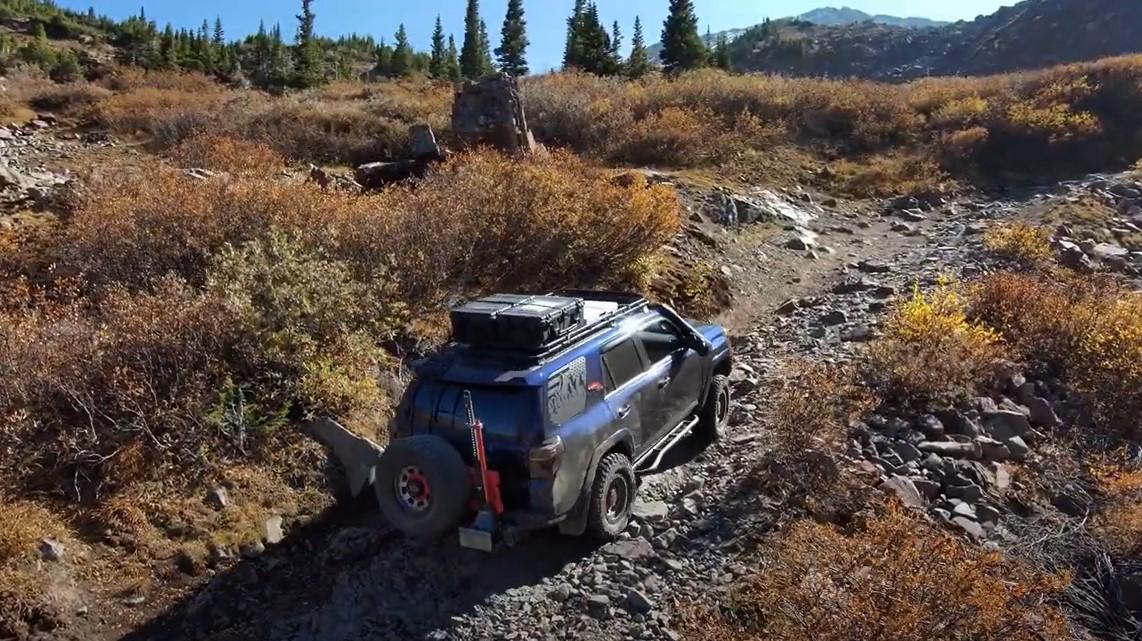

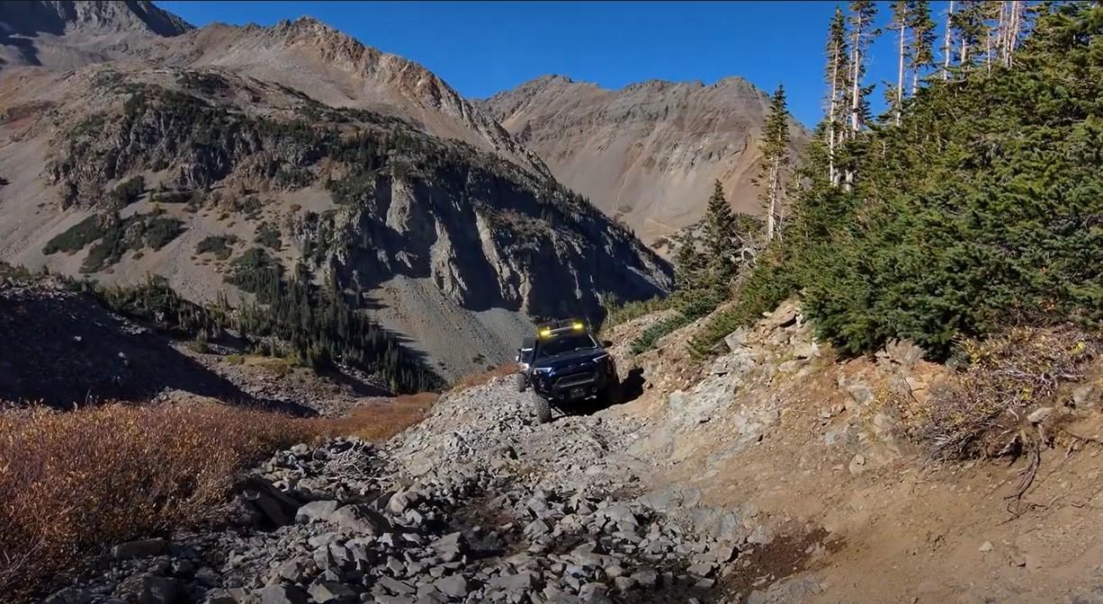

Is it possible we could get some input from those that actually disconnect sway bars in previously owned vehicles.
-> Does it really help?
-> How often do you disconnect?
-> What kind of off-roading do you do?
-> The little bit more articulation you get worth the assumed 'floaty' feeling that comes with the handling (Scarier feeling to tip over due to sway)
-> Does it make passengers more motion sick going over bumps or help?
I've been living in Colorado and off-roading for years. Had an FJ Cruiser for 10 years and now this 4Runner. First thing I always do is take the front sway bar off and leave it off. You get so much more articulation on the trails and it's barely noticeable on the road that it's missing.
The only time I notice that there is no sway bar is if I am getting off a sharp hairpin exit on the highway, and even then it's slight.
