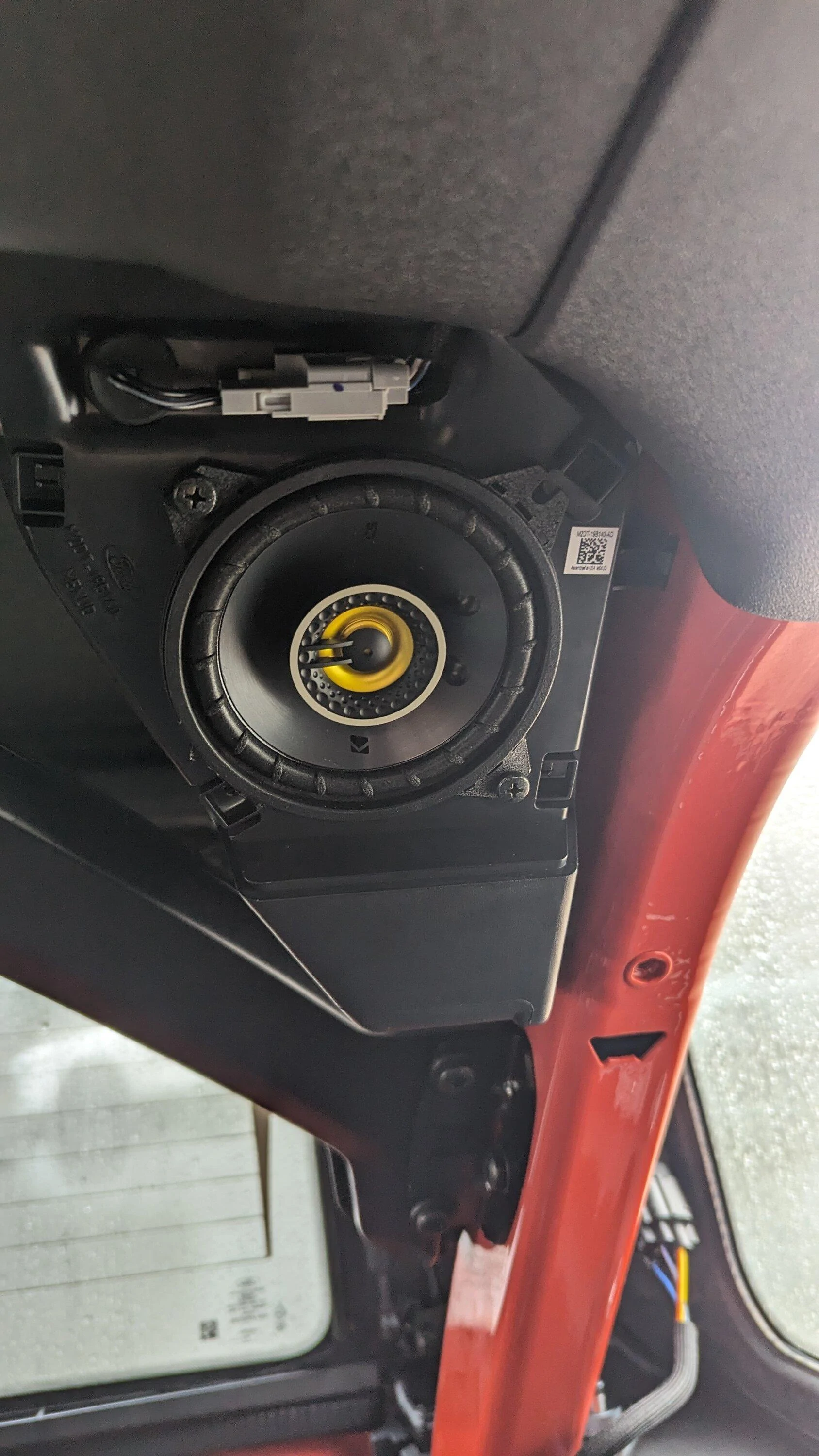

Kicker 46CSC44 Rear Pod Speakers:
Unfortunately, nowhere near the results I was expecting. After installing the new amp, the sound quality when fading to the rear was still pretty poor. This didn't make much improvement. I did (maybe) hear some benefit by fading to the rear combined with a large cut in the bass level and lots more volume. Unfortunately, I didn't do the exact same test prior to the swap.
Any tips: Bass blocker circuit, redo the Kicker amp EQ process, something else?

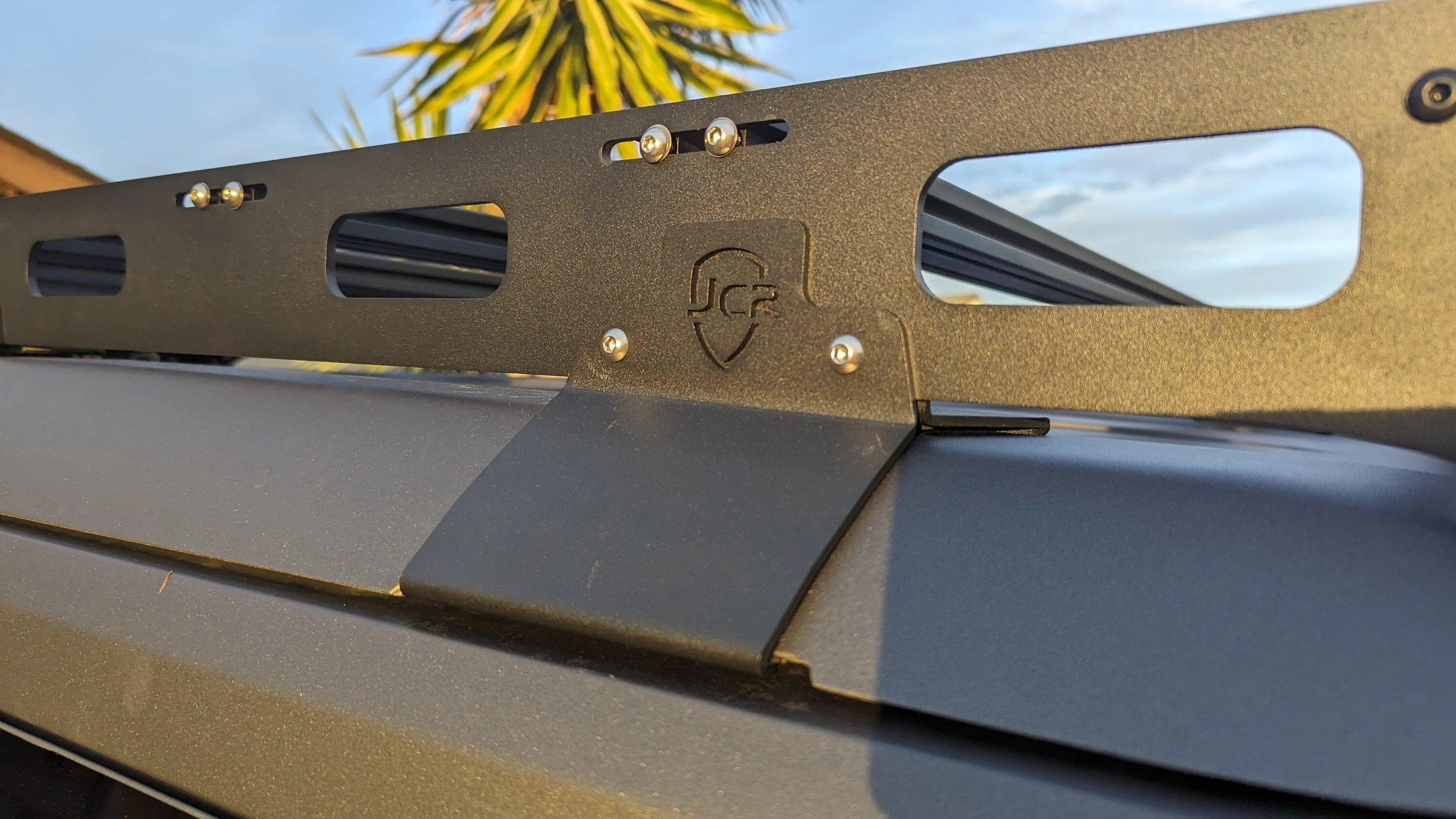

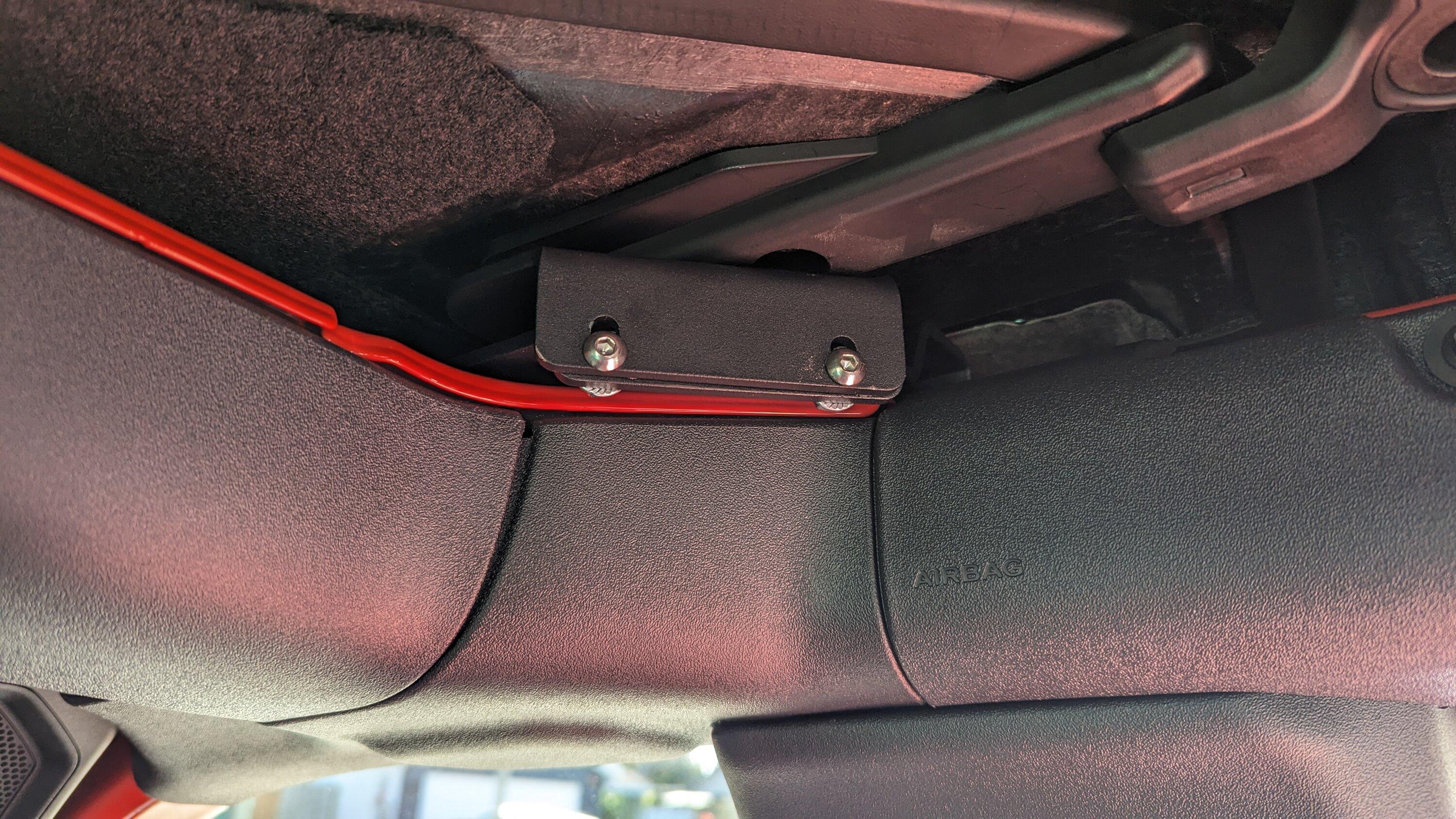

JCR Full Roof Rack and Reinforcement:
Their rack is great and AFAIK no one else offers their innovative reinforcement system that provides a significantly increased static and dynamic load rating by routing the rack loads into the roll bar bypassing the relatively flimsy roof itself.

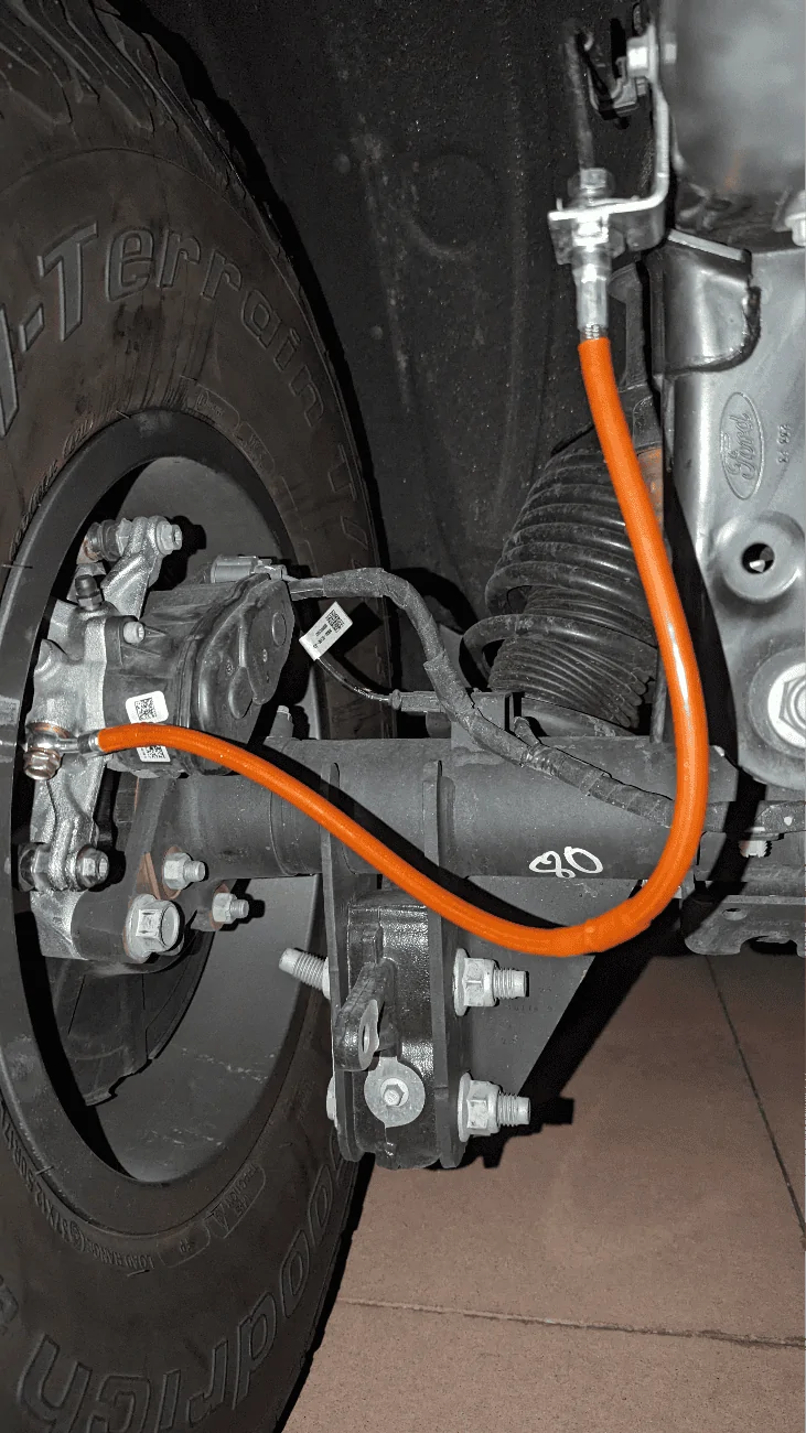

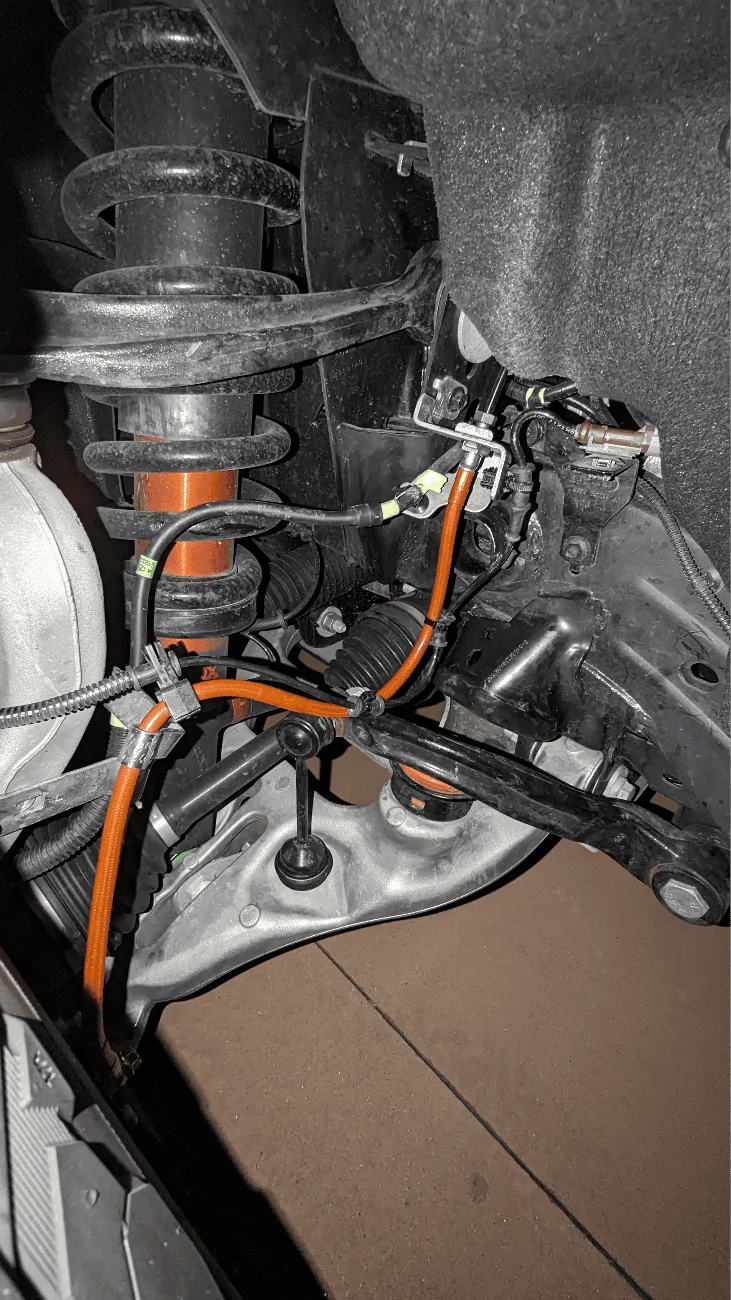

Braided Stainless Brake Lines - Crown Performance - Transparent Orange
Add durability and improve pedal feel (maybe not discernible...)
Ford Bronco Swamps Code Orange Bronco Raptor Build PXL_20240229_030351993
Ford Bronco Swamps Code Orange Bronco Raptor Build PXL_20240229_030448938
This is nearly a "drop in" but requires opening and re-closing the front metal guide plates and careful clocking of the banjo on the rear calipers as the rear caliper fitting is not the same as factory. A pretty easy job for anyone with basic wrenching skills. My mechanic also tested the rears under droop and tuck just to be certain.
No one has a drop in or otherwise kit yet for the Raptor, thus almost "drop in". Crown can sell this kit but won't advertise it since it's not 100% drop in. DM me if you want the info to pick up a set.

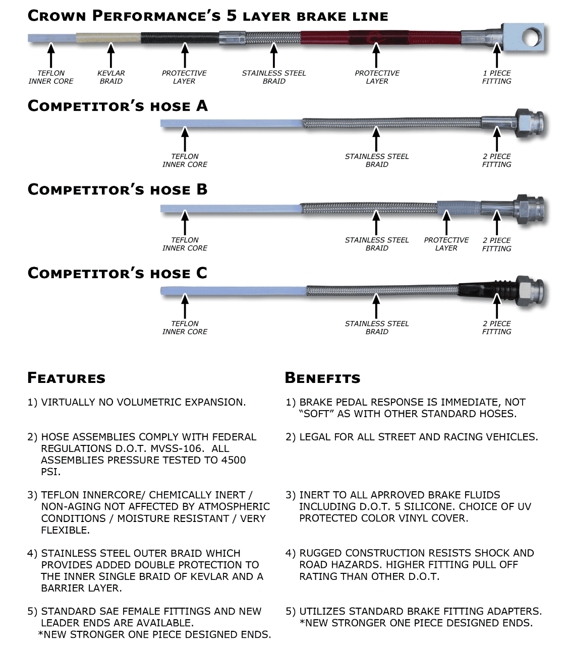

Here are the construction details and colors:

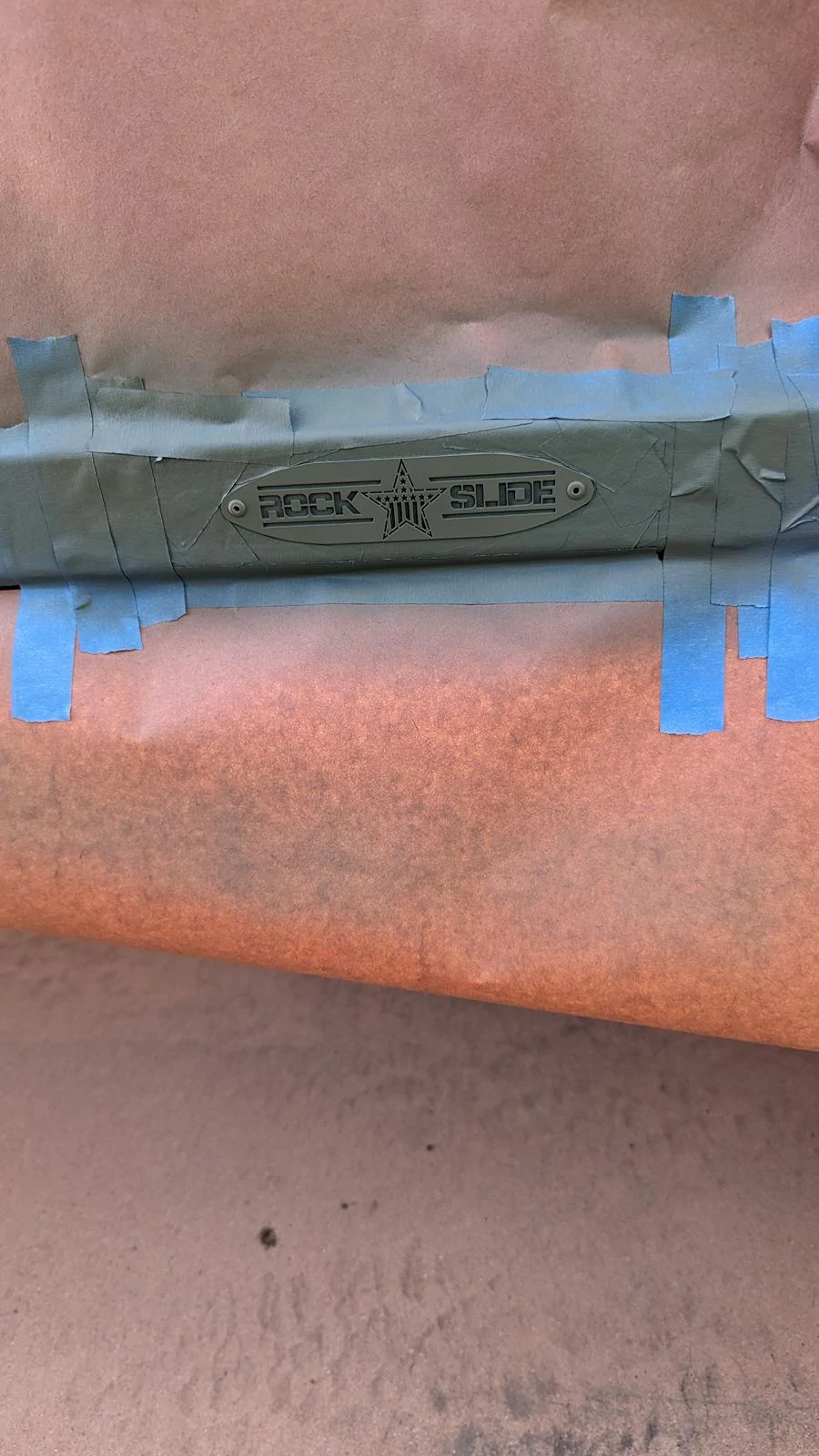

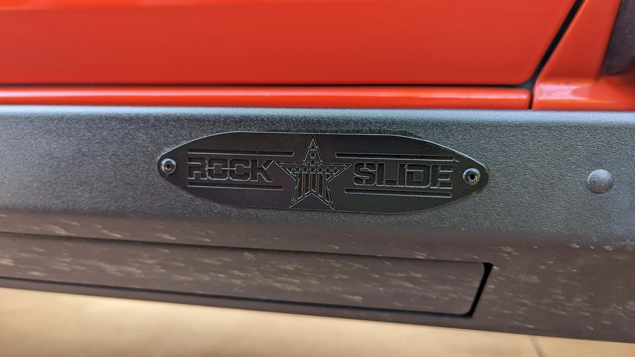

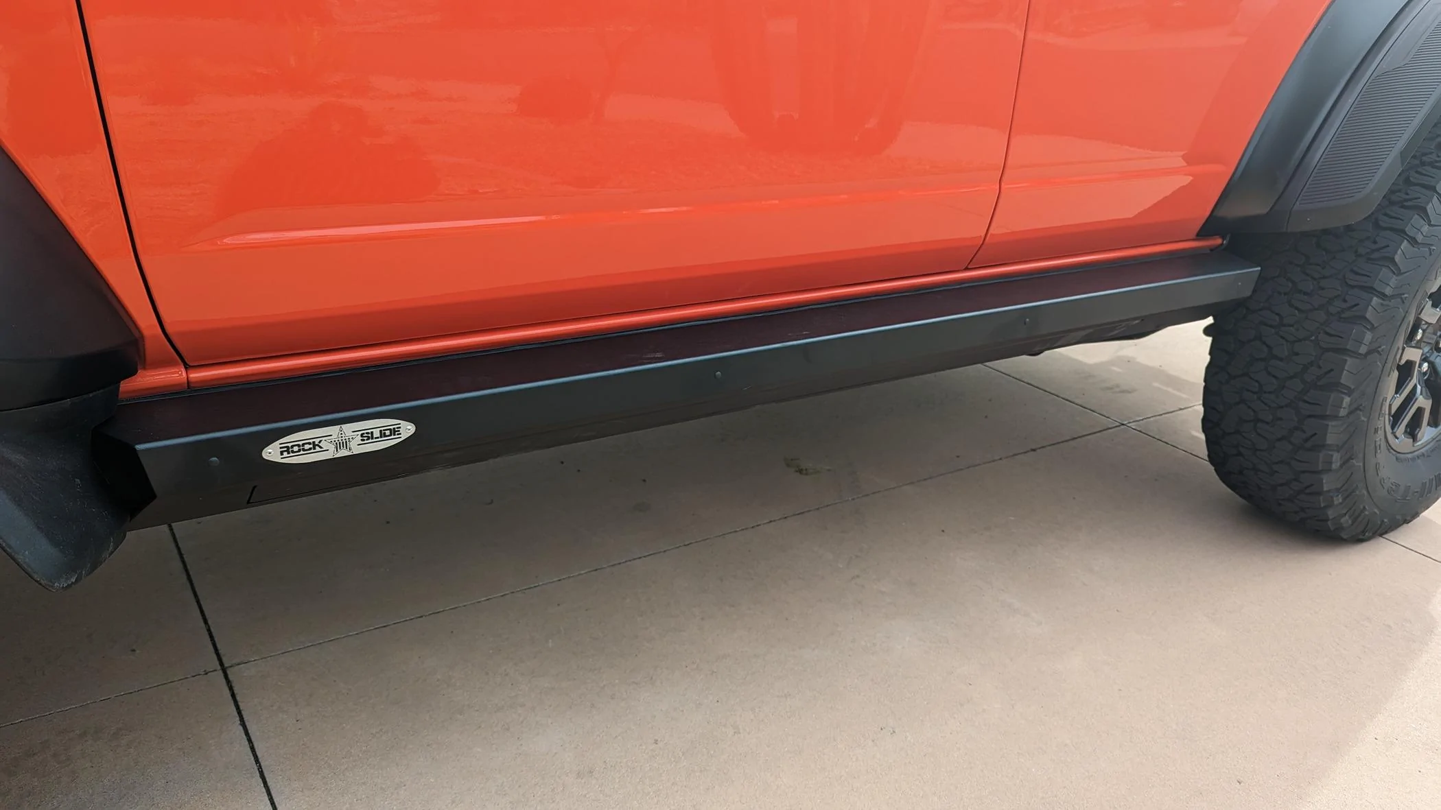

Painted RSE logos semi-gloss black. These logos are super nice, laser or water jet cut stainless steel, riveted on. That said they were just too bright/distracting so they got multiple coats of Duplicolor etching primer and Eastwood Aerospray 2k paint. They will match the slider body better with less gloss after fully curing.

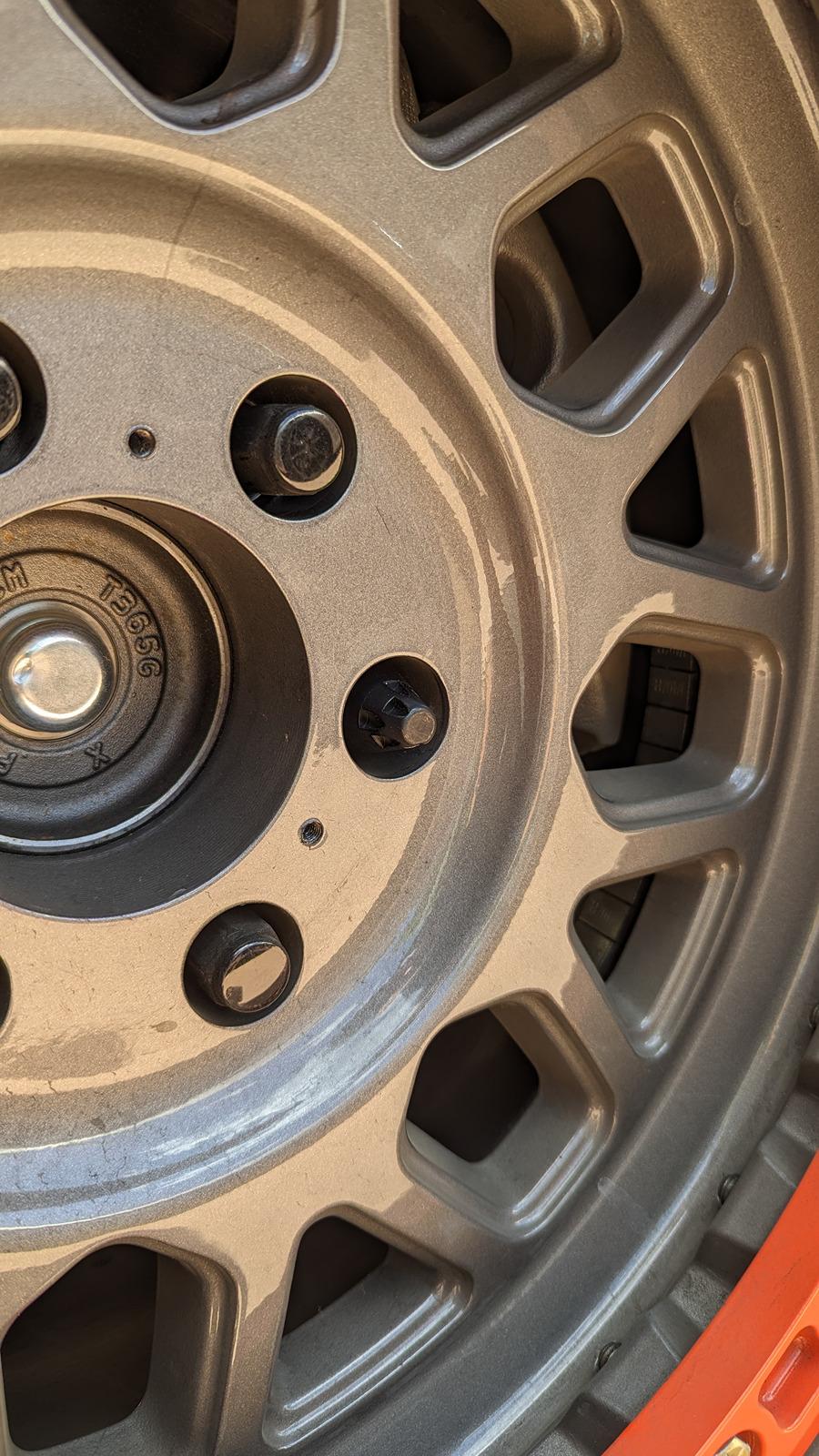

Advanced Wheel Locks:
Black, set of 5. These best pretty well all of the techniques to (often easily) defeat other designs. Check out the comprehensive comparison test here:

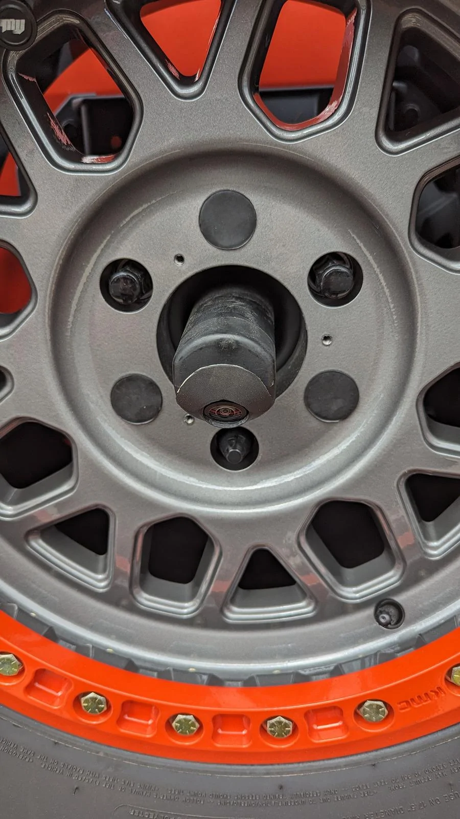

Spare tire dressing plugs. Actually found a UV/weather/chemical resistant size that fits the KMCs. Most standard rubber stoppers are very poor with UV.
I have 2 additional sets of 3 plugs for FREE. DM me.
