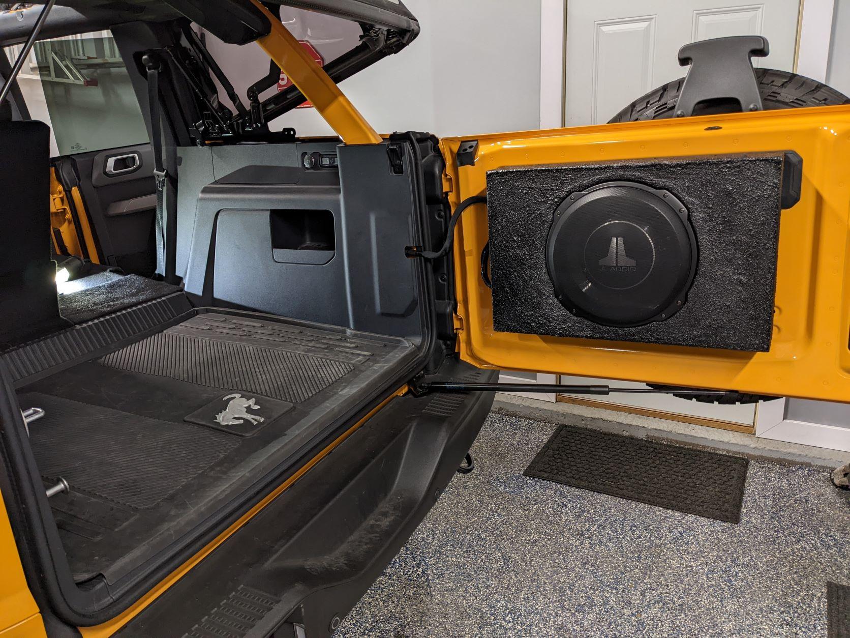

$1400 - that included amp, box, sub, control switch, and install.
I also spent about $500 replacing the interior speakers with higher quality ones.
I have the B&O system and upgraded all the speakers first...then just added this sub. Did the install myself and to your point fits like a glove in the rear door - with the B&O, I took out the sub along the side and thats where I put in a Kicker Key500.1 amp (inside the sub box) to drive the sub. Along with the speaker upgrades, it now sounds like a decent setup. I also dynamated the floor of the cargo area while I was at it...and you do have to make sure the sub is mounted with all the screws into the box and the box mounted tight on the rear door - or else you will get vibrations while playing your music!

What did you replace the stock speakers with?
Audison 4" in the front dash and rear bars, Audison 6 3/4" in the kick panels. That really helped with the clarity of the sound - but since the kick panels are basically at your feet it really limited the ability for good depth. Add in the rear speakers are just 4"... so yeah - quality upgrade, but no bass upgrade there at all. The sub fixed all of that, and then some.

I know MTI had mentioned they put dynamat between their tailgate box and the metal. Did you do that on this version?
I'd be much more inclined to take apart the tailgate and put it inside, in the case that you want to remove the sub box at some point, you don't want dynamat sitting there visible.

had it done professionally bc I would mess it up. Added a RF amp for power management (hid that under the front seat) and added a volume control knob on the dash.
Whoa… the sound is great. It just what’s needed to add good depth to the sound. I didn’t order the upgraded audio - this though far exceeded my expectations.
It also fits pretty well and with the shallow 12 it doesn’t take away from storage space in the back.
Here’s some photos, I’ll get a video of the sound and follow up.
I just watched the install for the MTI and didn't see on their install any dynamat between...but the one thing I did notice is the different ways they mount. On the Stinger you drill 4 holes (template provided) in the tail gate...the two bottom bolts attached an L bracket that holds up the box and you screw the bracket in the box (from the bottom) as well. Then there are 2 up top as well. For the MTI, the bottom looks like it slides into a slot and has just 2 bolts in the center to hold it in place. On the stinger you can pretty much get max bass for a 12" woofer and not get any vibrations from the box/tailgate. It appears that the stinger (though more holes to drill) mounts more securely....but thats just one person's opinion!
I put a piece of rubber sheeting between my box and the tailgate. This way there won't be any adhesive on the paint, and the box isn't touching the paint. Besides the plastic cover sticks out further than the painted panel below, so this helps to square up the box.
Most of the inside of the tailgate is full of bracing and honestly I could not see anywhere flat enough to put dynamat. Perhaps with a spray? The only rattle I get is immediately around the handle, and only with certain songs/frequencies. So eventually I may put a bit in that area.
I feel the weight of the spare tire, coupled with the weight of the sub and box (30 lbs for mine) gives the tailgate so much mass that it doesn't rattle or vibrate.
