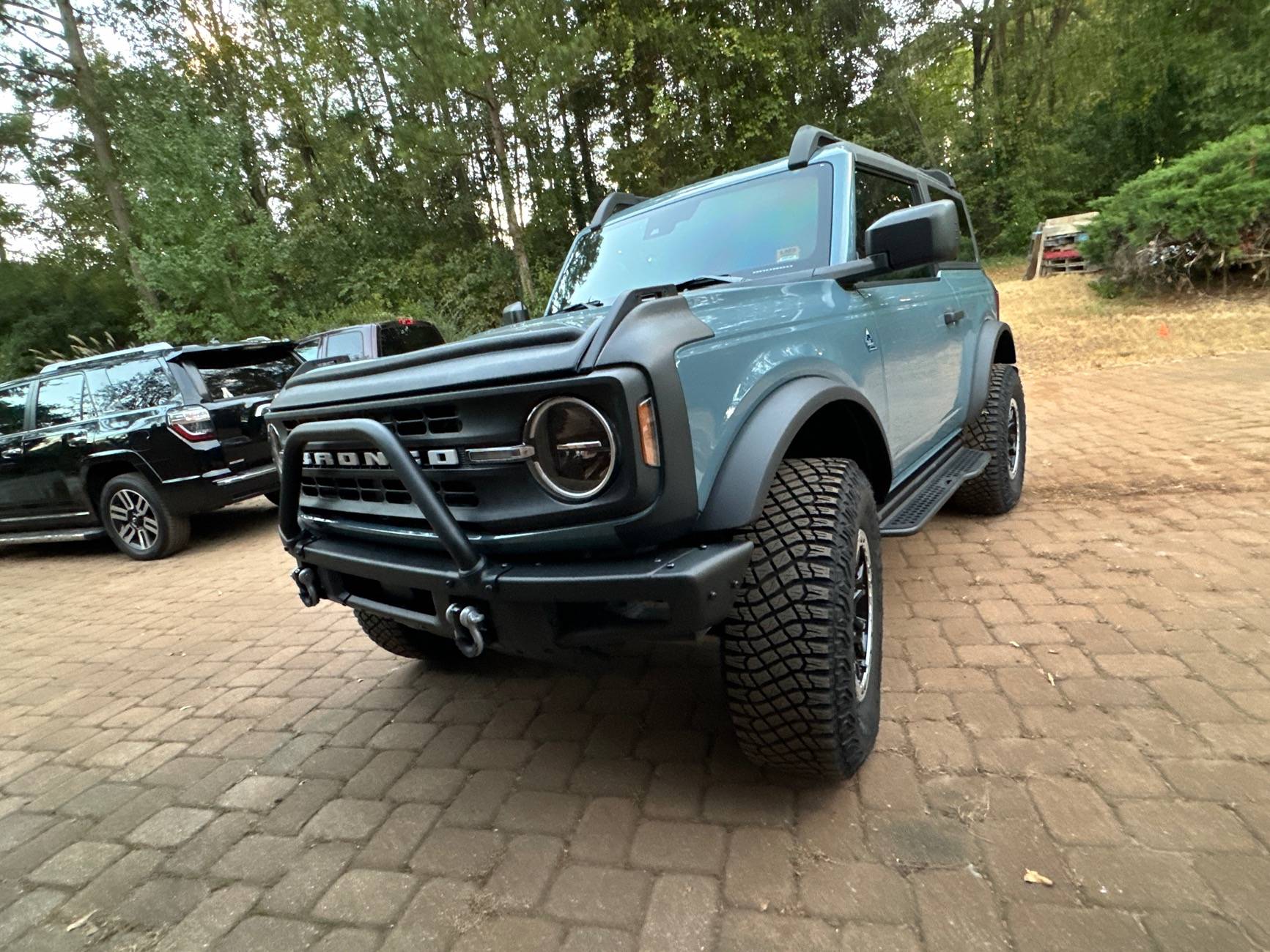

Two years in central New England, lots of salt applied if there's a hint of snow. No rust. Very convenient, I can remove or re-install them in ten minutes, fifteen tops. I went for the full-length, which help protect the lower body more. (4-door) (I have RokBlokz mudflaps, too.)
No rust so far.
Their customer service is excellent. I needed a few replacement fixtures (my fault); they sent them gratis.
IAG on my ‘22 2dr BD. Very pleased with them so far. Completely agree with you re customer service

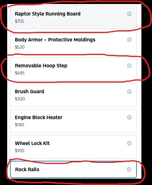

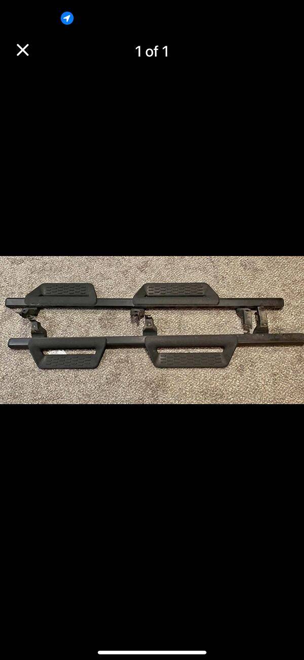

I don't know if that is true or not for pre 2024 Badlands but the 2024 Badlands does have an option for removable steps. When I bought mine I had the choice between two Badlands. One with steps and one without. They were not full length and I didn't like the look and opted to go without. I don't know if they are available from Ford as an accessory.
24 had 3 options. Rock rails, Raptor style running board and removeable hoop step. You are likely referring to the hoop step. Yes it is removeable, but requires unbolting the entire thing. It's not as practical to remove as other options.
