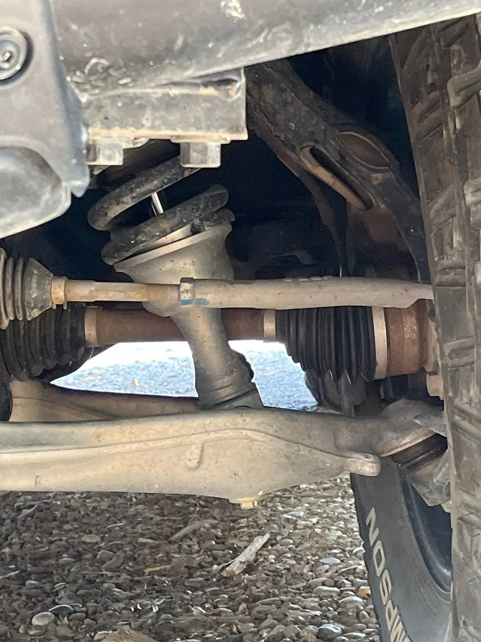

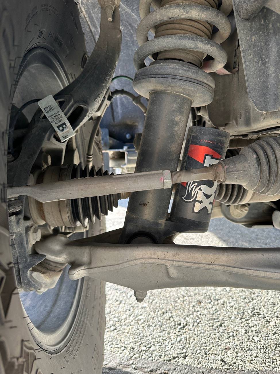

Tie rods: looks like just the driver side is bent?
Driver
Ford Bronco Steering wheel very sensitive after off-roading IMG_3305
passenger
Ford Bronco Steering wheel very sensitive after off-roading IMG_3306

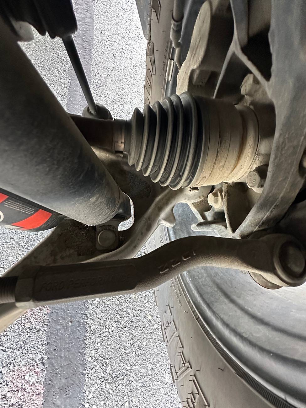

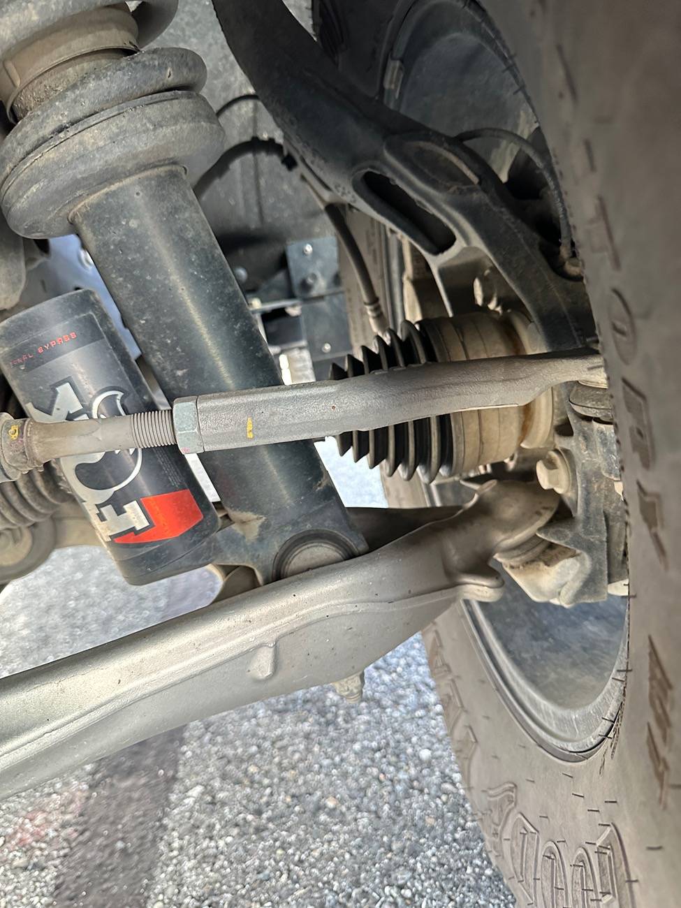

Driver
passenger
Those like exactly like mine - if there’s a bend I don’t see it, but it may just be the photo.
My driver:
Ford Bronco Steering wheel very sensitive after off-roading imag

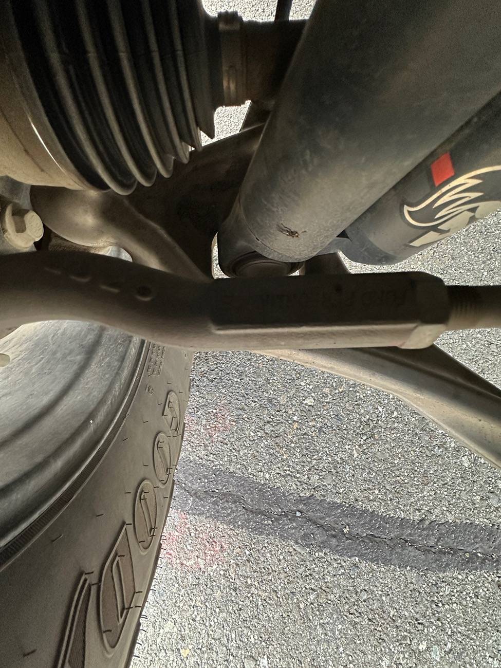

Is the bend on the other plane - visible from looking at it top down?

Not sure but this what they looked like from above. Look pretty close to the same?
Ford Bronco Steering wheel very sensitive after off-roading IMG_3312
Ford Bronco Steering wheel very sensitive after off-roading IMG_3314

I got the work done. Dealer replaced driver's side tie-rod end and performed a front-end alignment. The repair didn't really seem to make a difference in the steering though; Maaaaybe a 5% difference but it still feels a litle looser than before. Oh well, they said it was good to go and felt normal to them.
I didn’t see this until today after you had the work done but — yeah mine look identical from top too. Although your driver one did look a lil more bent than the passenger - mine are about the same - so maybe that’s what they saw.
But it’s done - hopefully they gave you the old parts so you have a spare to carry
