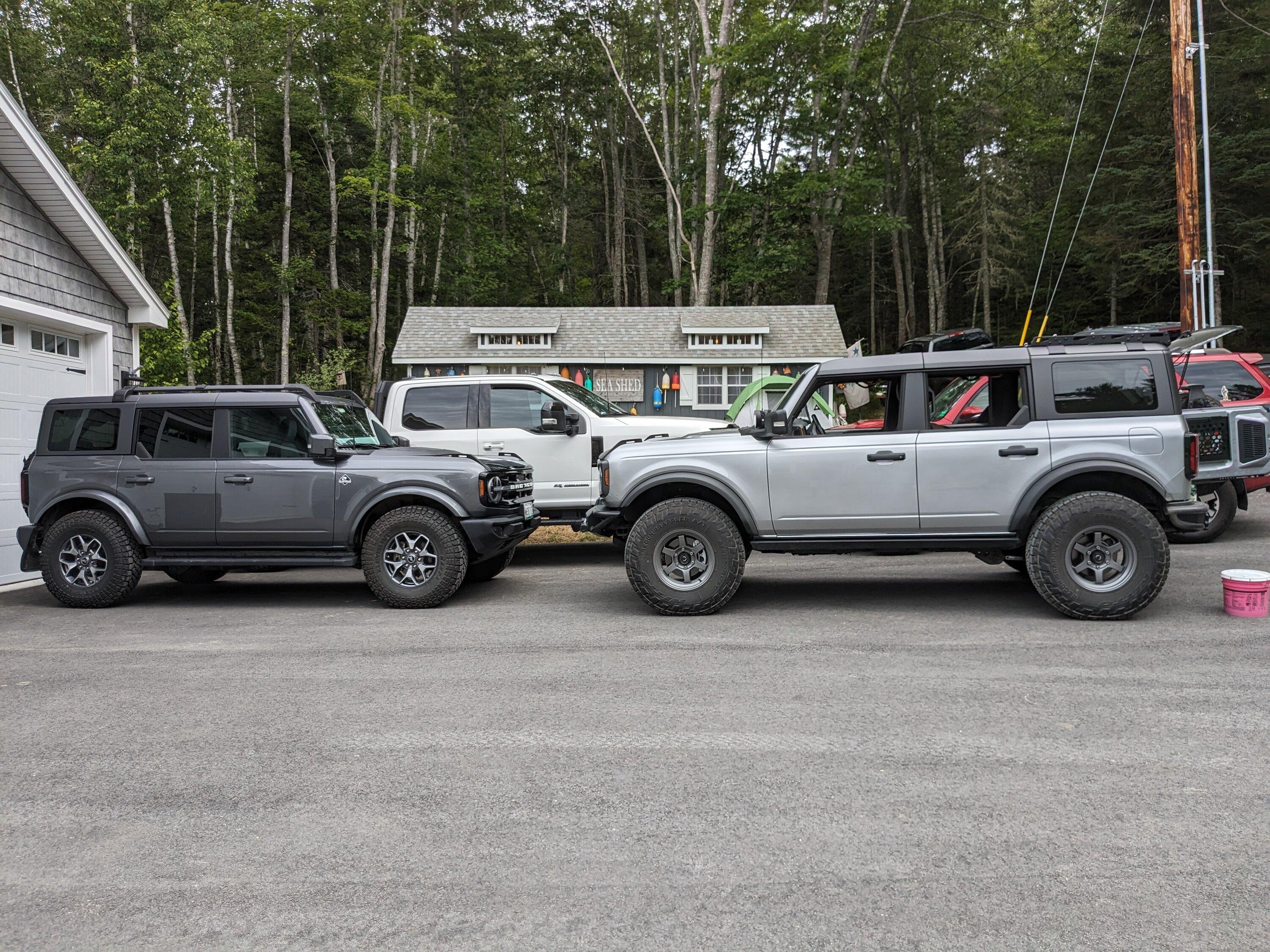

My friend just bought/installed my non-Sas Badlands wheels & tires (+55 offset wheels, same as Black Diamond wheel offset) wrapped in Kenda Klever 35" x 10.5" and they fit fine w/o rub, just had to remove the crash bars. Hers is an Outer Banks.
