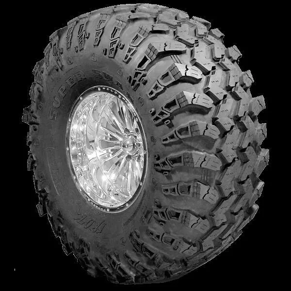

Just get some really aggressive M/T's, you won't hear anything!
Ford Bronco Squeaks in the back 1724179886806-7h
