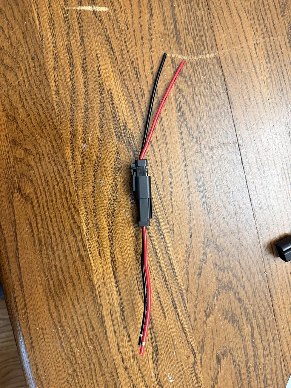

LPHFD31 - Ford T-Harness, plugs into the back of the factory radio (non-B&O systems only — if your Bronco has the factory B&O package this harness won't work, confirm what you have before ordering. Will post how to wire one of these yourself, when I get there)
MISC installation equipment - Ferrules, Tesa Tape, Zip ties
18/4 Speed wire - OFC 18 gauge 4 conductor wire - This is used to run to the LPHFD31 harness

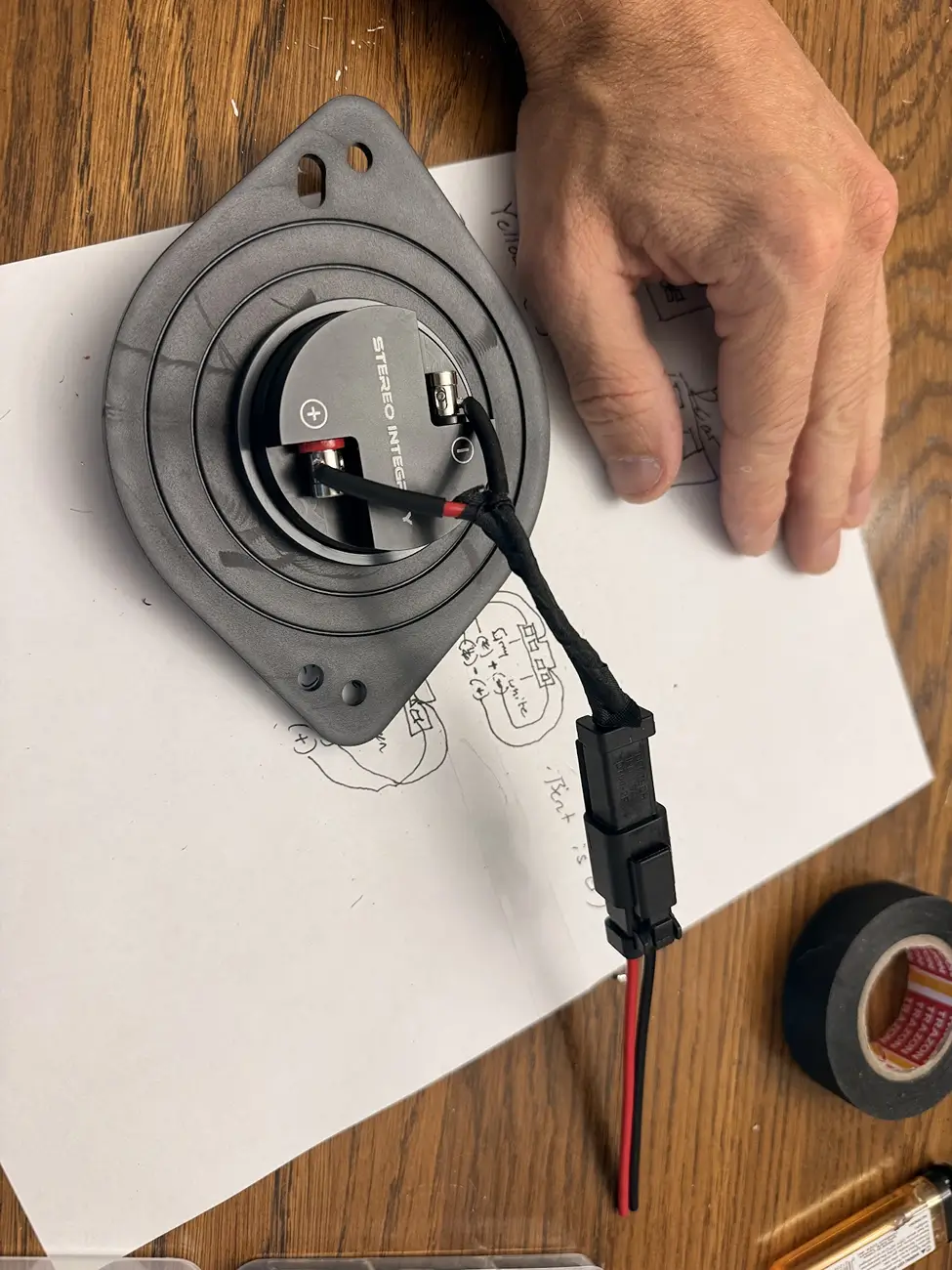

Bass Blocker- Parts-Express Dayton Audio DMPC-47 47uF 250V Polypropylene Capacitor (There are cheaper versions out there than this one, but it was in stock) — wired in series as a safety net on the tweeter line in case the DSP ever fails, not as the actual crossover
For channel mapping, the M28 tweeters get channels 1 and 2, the TM65 midbass gets channels 3 and 4, and 5/6 are staying reserved in case I ever go 3-way down the road. RCA out 1 feeds the sub signal to the CX800.1, RCA out 2 is spare. Signal comes in off the back of the factory radio through the LPHFD31 harness, runs through ADEP.3, and all four driver channels get amplified straight off the 206. I could run the rear pods off the extra 2 channels if I wanted to, but I don't. The Kicker Key200.4 is coming out entirely.
For crossover points, I'm starting with the tweeters high-passed at 24dB/octave around 2000Hz, the midbass low-passed at the same point and high-passed around 80Hz (same slope), and the sub low-passed around 56-60Hz, half an octave below the midbass high-pass to account for the phase shift. Left and right will be set identical on both crossover point and slope, any side-to-side differences in how it actually sounds in the car will get fixed with delay and level/EQ instead of moving the crossover points around. I'll dial all of this in for real once it's installed, running REW with a calibrated mic against a pink noise sweep, doing polarity first, then delay, then crossovers, then level/EQ, then confirming with the RTA.
