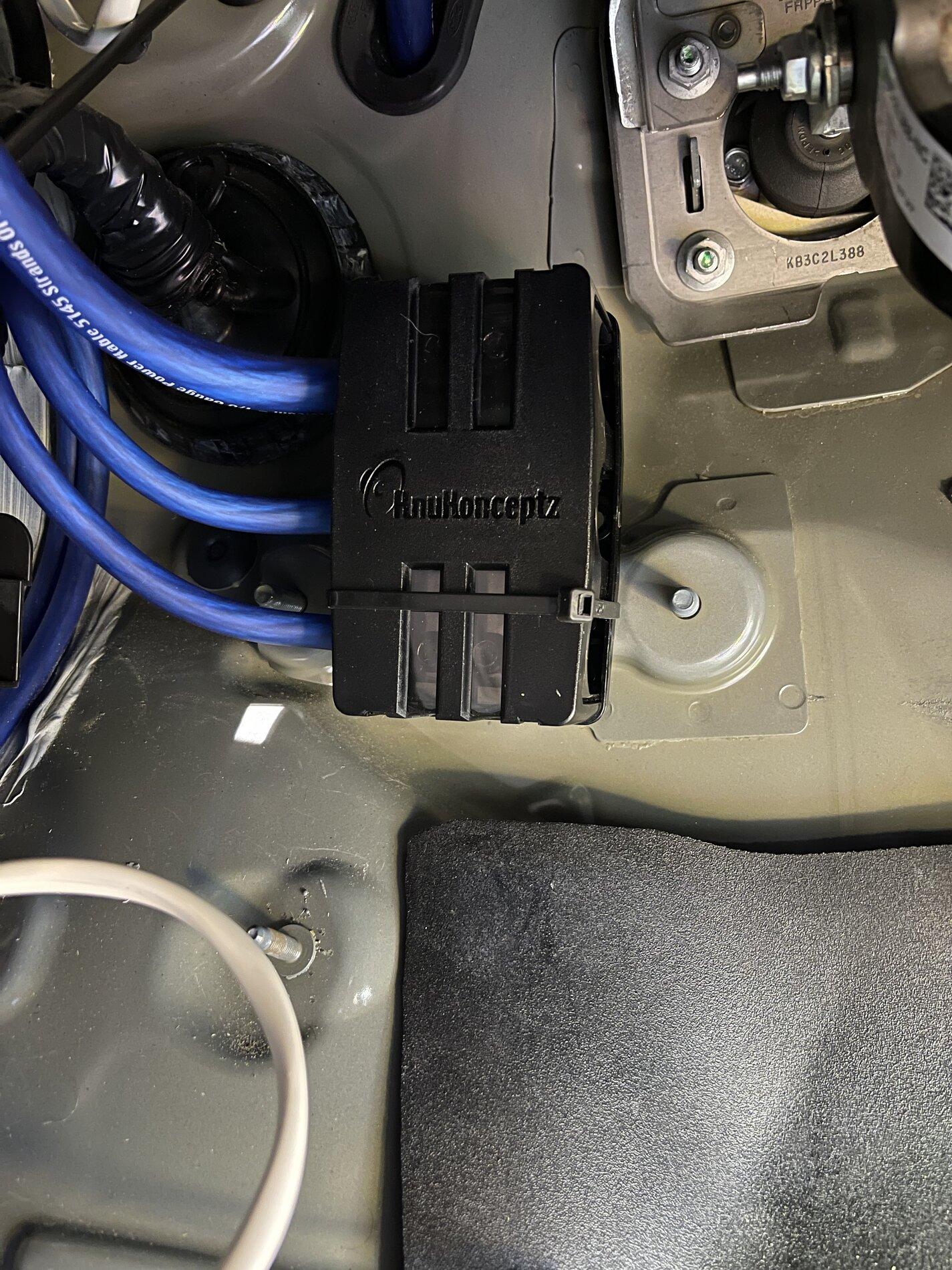

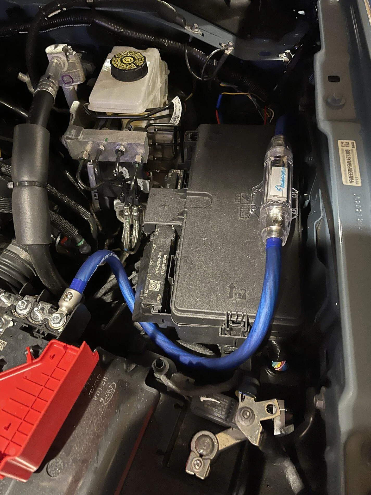

For Power I used Knu Koncepts Kolossus Fleks 1/0 from the battery through a 200A fuse to a power distribution block that is for now zip tied as shown. I will make a bracket out of starboard that uses the two studs shown to mount my distribution hub to. the bracket will also move it up a good 3-4" which I like.. from there i have 2 4ga power wires going down drivers side "cable tray to the rear of the truck. I did this because 1/0 would have been tough to fit and would have been more gear needed in the rear, which i do not want. i also have 2 4ga ground wires bolted to rear seat studs.

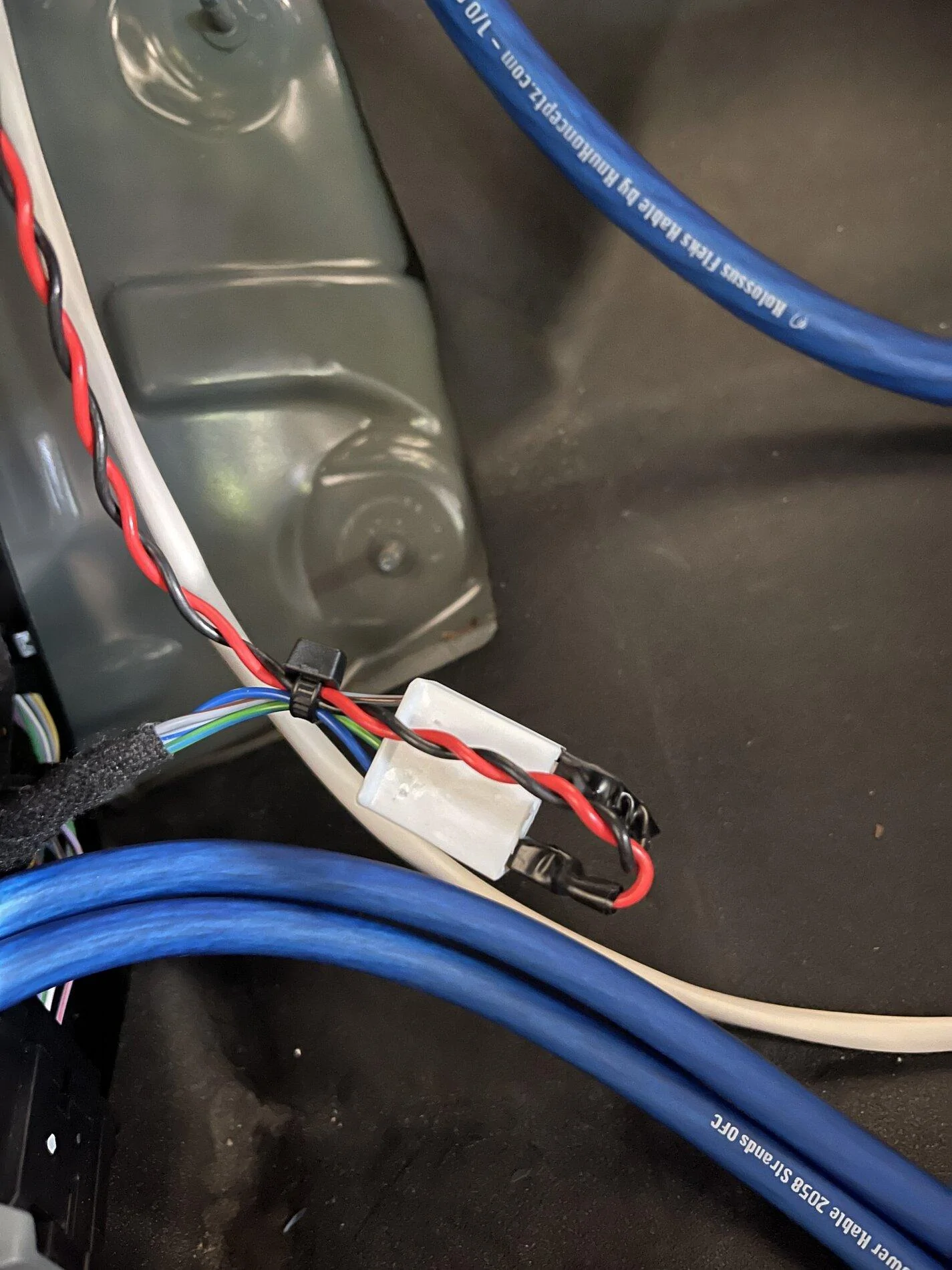

so i intercepted the signal at the kick panel speakers using some male quick connect crimp on connectors to insert into the factory harness. i will replace these with a plug in harness when available for a more secure connection, but right now they are zip tied as shown and should not wiggle loose. they travel to the back via twisted 18ga. wire.

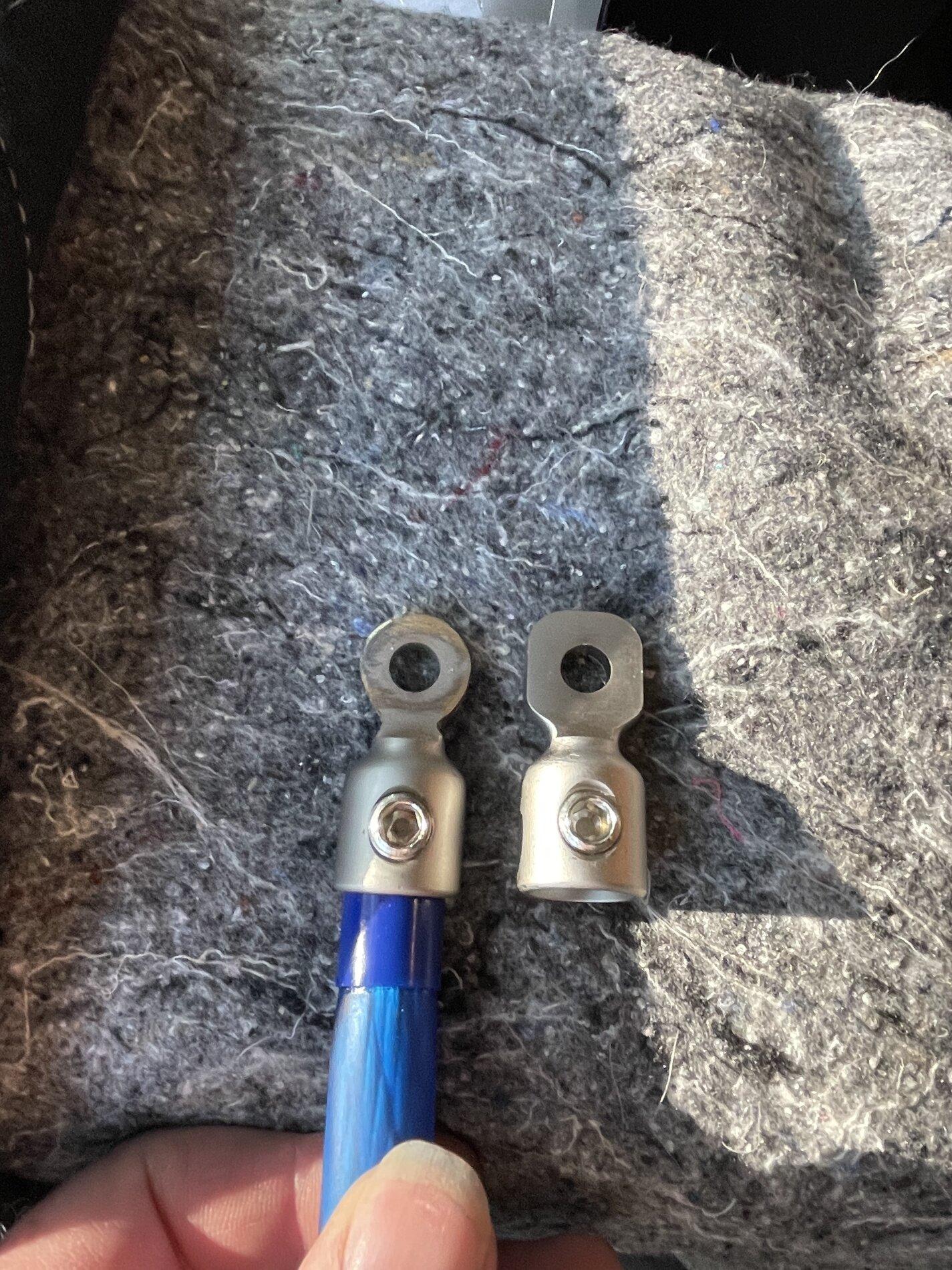

Also, I will definitely be getting a crimp ring terminal to satisfy the peanut gallery, but I will also be filling it with solder after crimping. I have seen many high end car audio dudes do this.
