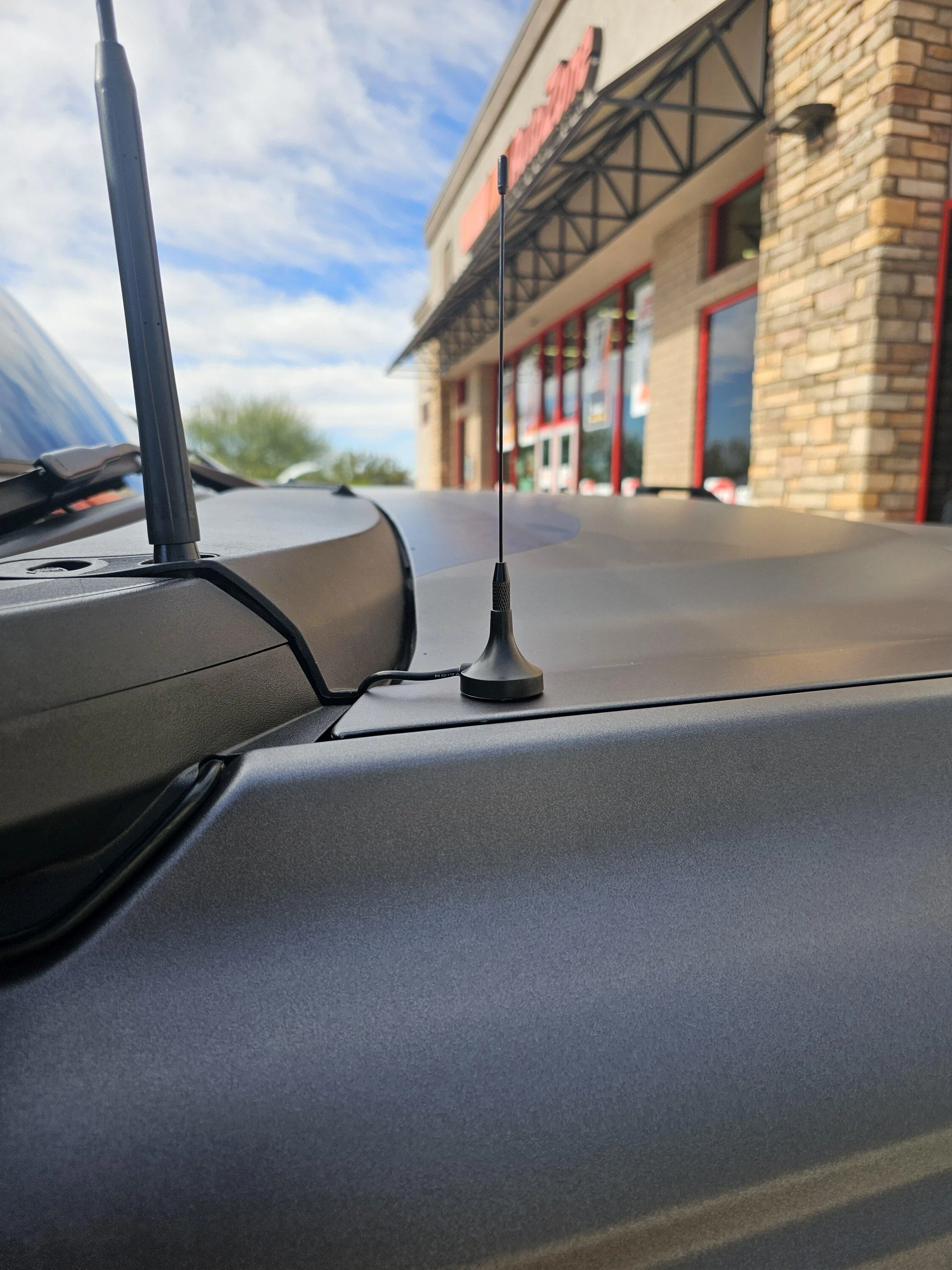

I got the unit installed yesterday, I put the main box in the cubby in the center console where the 12v cig adapter is. Then ran the antenna under the center console behind the glove box then installed the antenna on the top right corner of the hood.
I did not want the MIC visible when Iam not using it, I can easily extend it out of the center cubby while Iam using it. This will make it a little easier to remove if I ever trade it in as well.
In the past when I have had the doors and top of my Jeep off, I actually caught someone going through my glove box when I came out of a Circle K Store, so I don't like keeping valuables in vehicles when I have the hardtop off and especially with the doors off.
I did turn the speaker on for the MIC and it is plenty loud for trail use and even on the freeway with the windows up.
I am not sure on my range in the urban areas, Iam picking up local guys on HAM, but haven't tried to ask how Iam coming thru or range.
