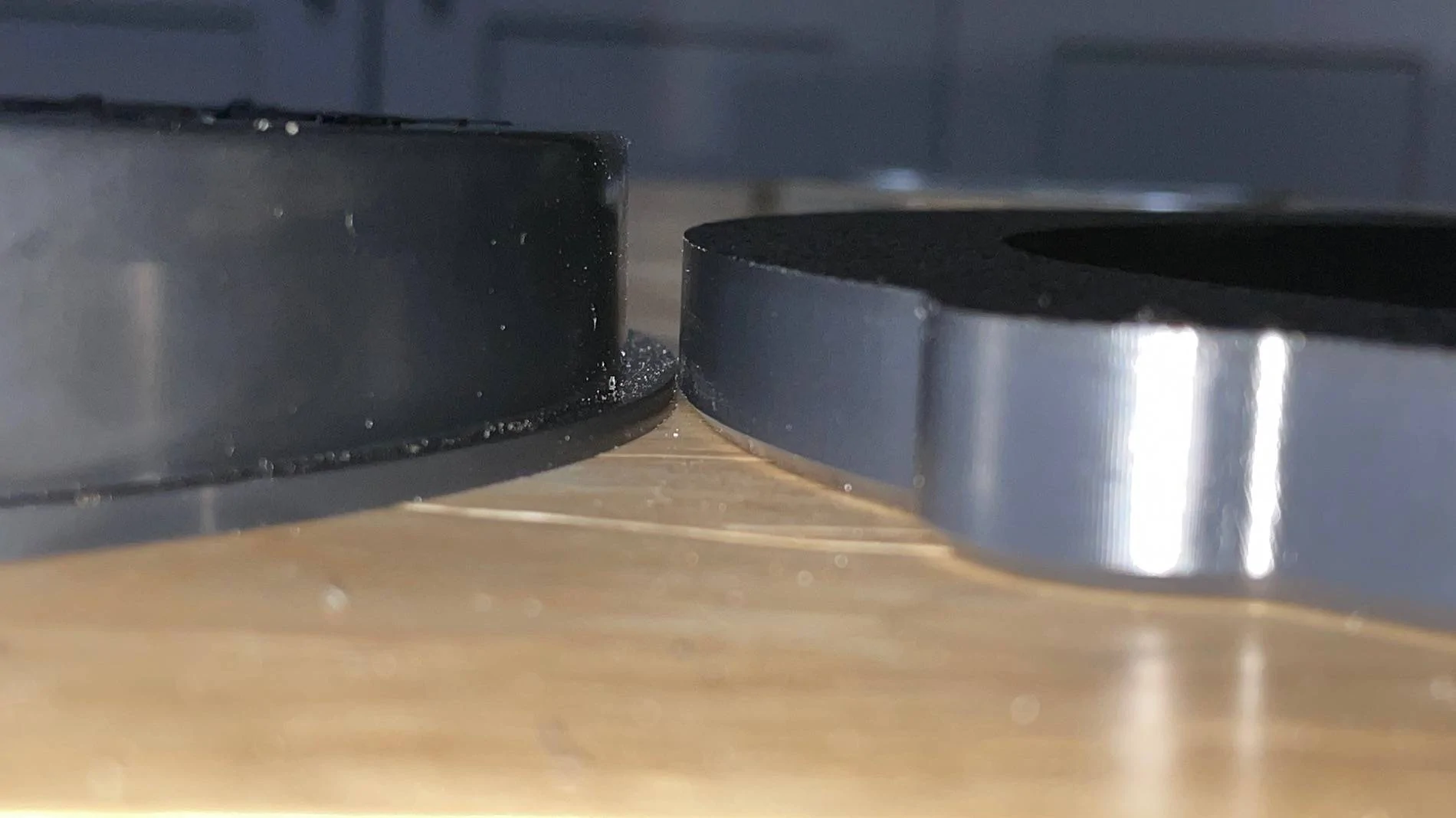

It will depend on what speakers you're using. Are they just woofers or are they coax? If they're coaxial, there's a good chance the Metra's aren't shallow enough to work with the kick panel covers.
For coax, I'd look at Sounds Good Stereo kick pane adapters.
Here's a shot showing the height difference between them. Sounds Good adapters are on the right (obviously). It's enough of a difference to get something like the Hertz Cento coaxes in there.

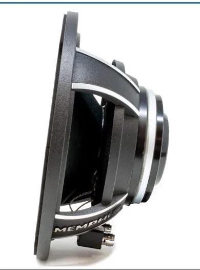

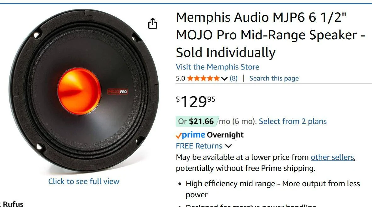

I am using these, so hopefully the Metra adapter will work:
Ford Bronco Speaker mounting bracket adapter for the kick panels? Screenshot 2025-07-17 102026
Ford Bronco Speaker mounting bracket adapter for the kick panels? Screenshot 2025-07-17 190827
Ape Factory
Michel
Nov 17, 2024
526
535
Audi RS5/Ford F150/Infiniti QX70S
It should work. Actually I have the Metra adapters just lying around and I've already shaved off the tabs too. If you want em, I'll send them to you for the price of shipping. If you need them "Amazon now!" I completely understand.

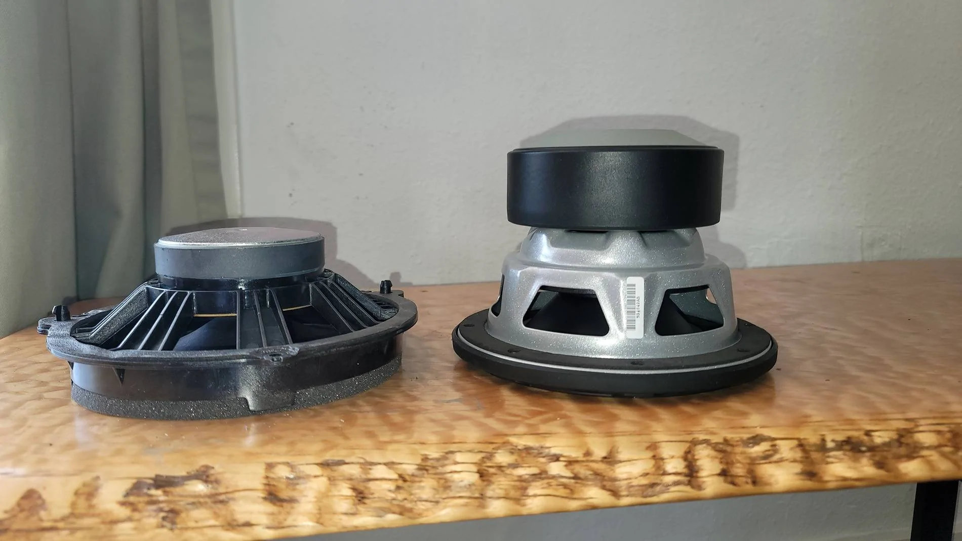

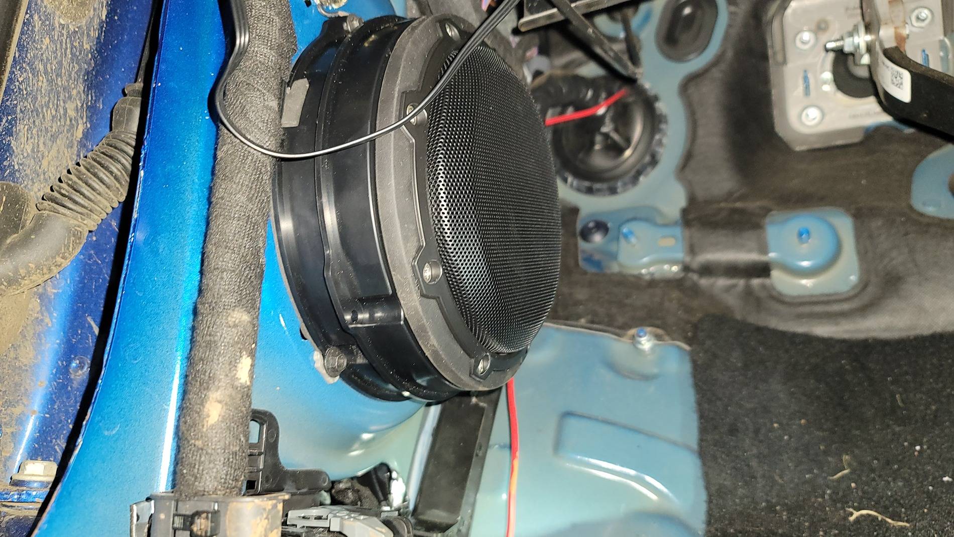

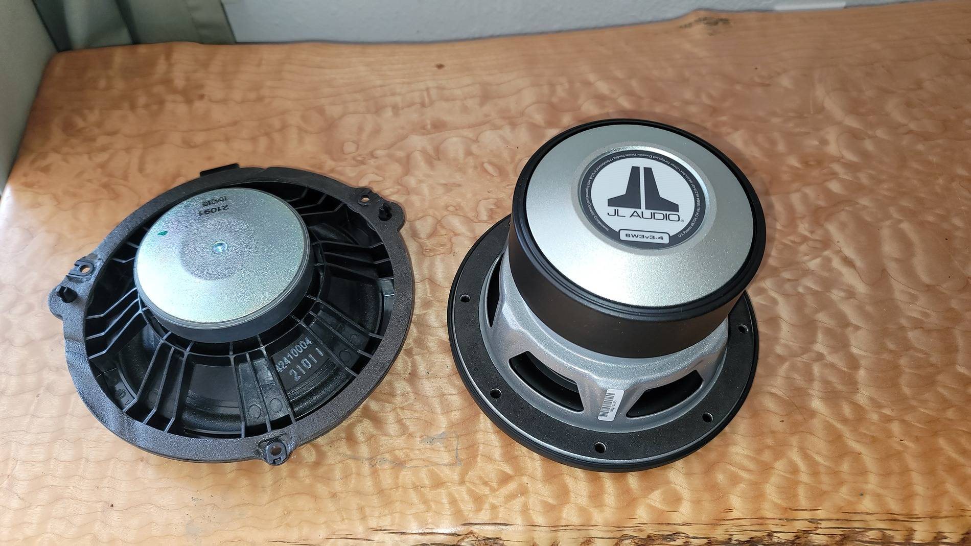

Those will fit with no problems !!!
the body has a huge pocket there behind the OEM speaker...I filled it with foam.
I'm running way bigger speakers' magnets than those and I put two stacked (crutchfield) spacers in there.
