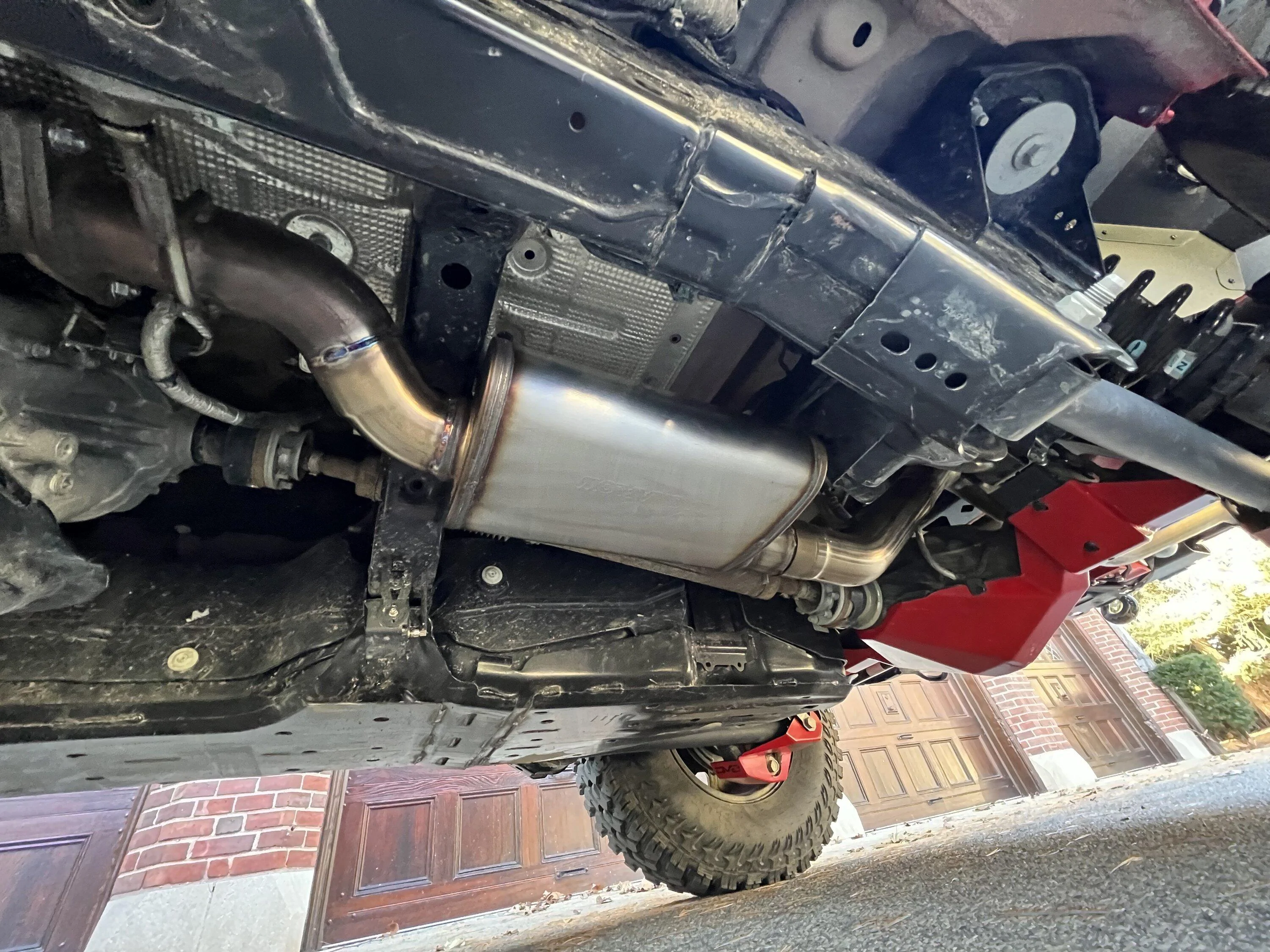

I had made a real nice install thread the admin deleted from here. Not sure if it was the cutting of the pipes or the warranty void. Either way your going to love them. They make a world of difference.
Mrt ran the numbers for flow and proper muffler for me. They recommended the bigger magna flow. Still has the deep sound. Just better flow, no metal ting in the top end now.
Mines mid mounted.

If you feel it’s sluggish in the low/mid power band you may want to look at a bigger muffler. My Afe was choking it out. Went up to a bigger magna flow and fixed that issue.
Mines mid mounted.

I hope to do my SPD install this week. I don't really want to cut the factory pipes out of there. Did you try to get them out intact first?
Ground_zero298
Apr 5, 2022
39
2,201
5,582
Scs michigan
I’ve heard it can be done. Have to drop the whole cross member. I was working off one jack stand so I cut the exhaust instead.
