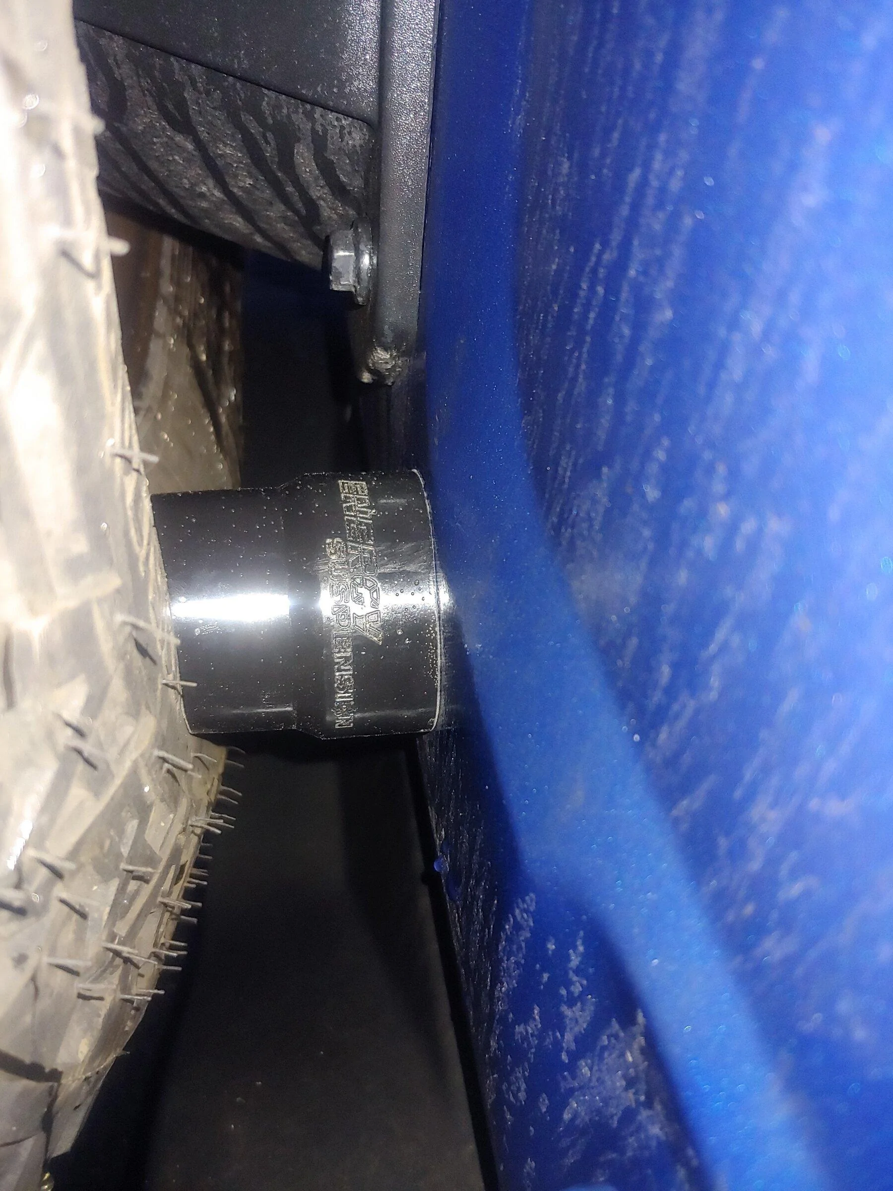

I have 37" KO2s. They fit on the spare tires 3rd brake light but, this light is close to the top of the tire. I added a bumper to resolve that. See earlier in my posts.

Oh I see. I'm talking about the bumpers at the bottom of the tire. I have good clearance around the light/bracket.

Get a PVC pipe cap that will shove in the end, paint it black

There was another post of installing a wheel spacer on the tire carrier to allow more room.

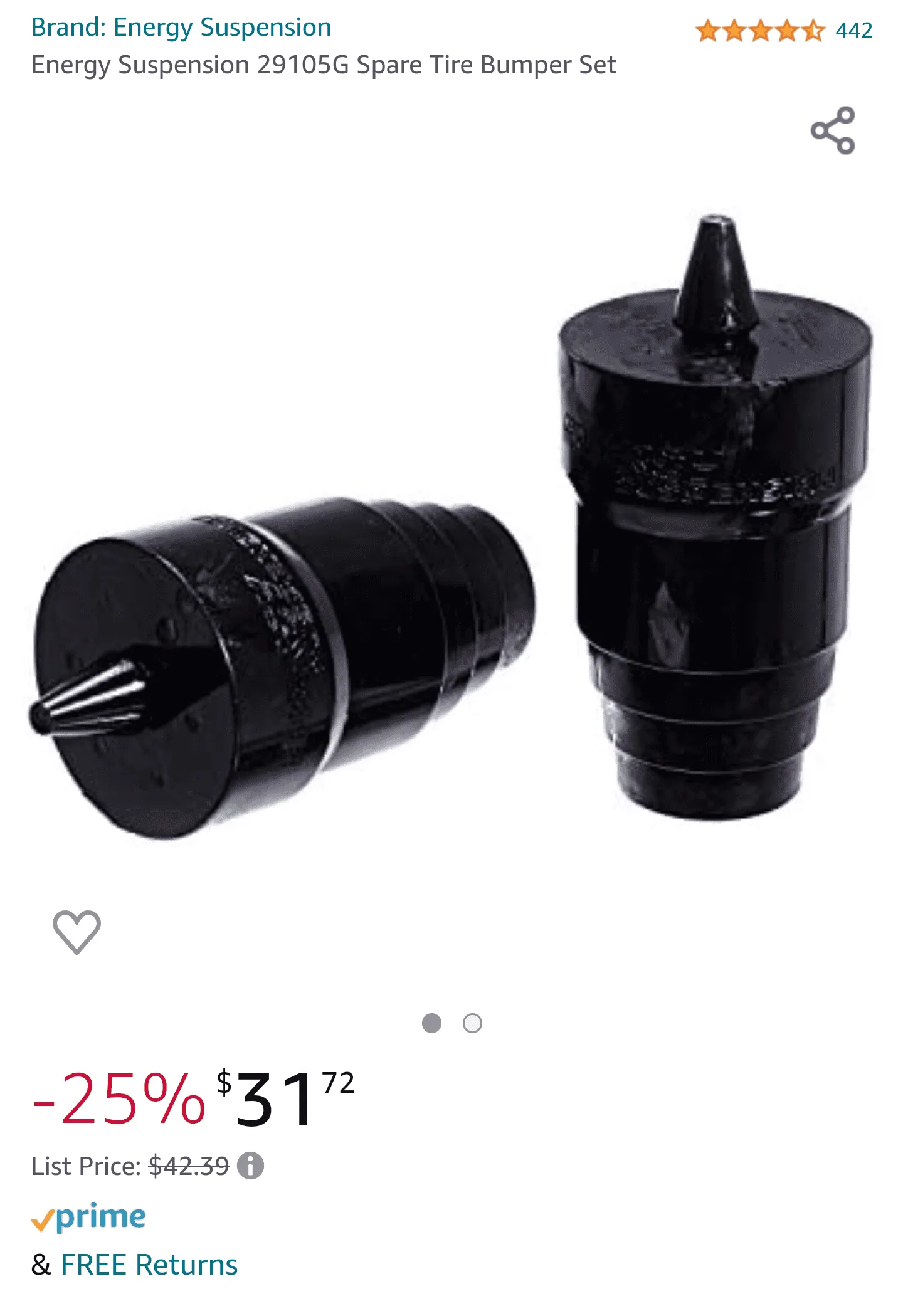

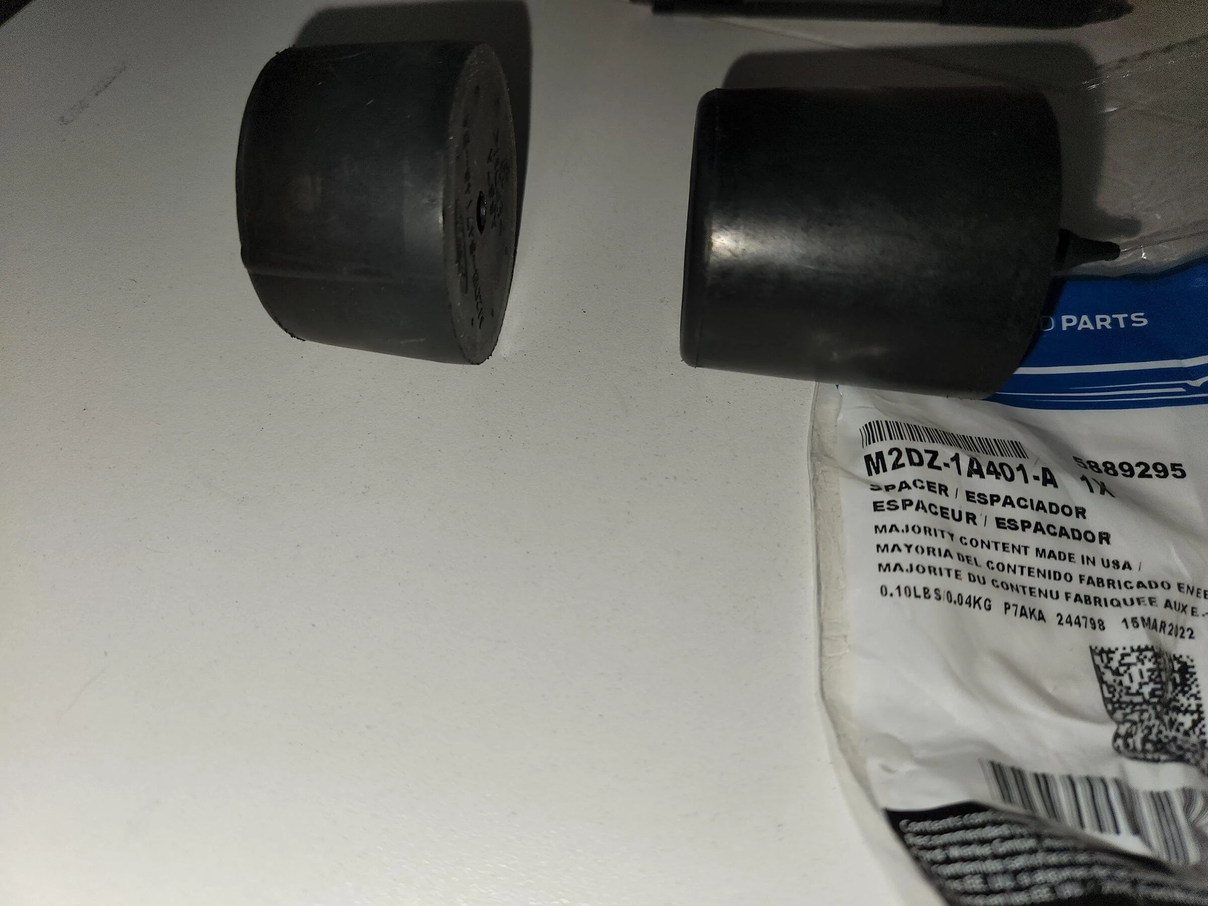

Finally got my spare on. These things are massive. Much thicker and longer, and harder too. *snicker*
Had to trim the nipple off and drill out to use the oem fasteners. Then trimmed the excess length off at an angle to fit the shape of the tire better.

Thank you for this. Followed your lead and did this today. Worked out perfectly.

These just plugged right into the tailgate just like the stock ones?
They have a nipple on them that's supposed to plug in but it's too big. I shaved it off, drilled a hole, and used the original fasteners.

That sounds about right, I went the other way. I went from an Outer Banks spare to a Badlands spare and calculated I needed the cut 7/16 off of those (Outer Banks) bumpers for the Badlands tire to fit.
Was that the right amount? I’m moving from the black steelies on my BD to 33” tires and want to make sure I trim the right amount.
