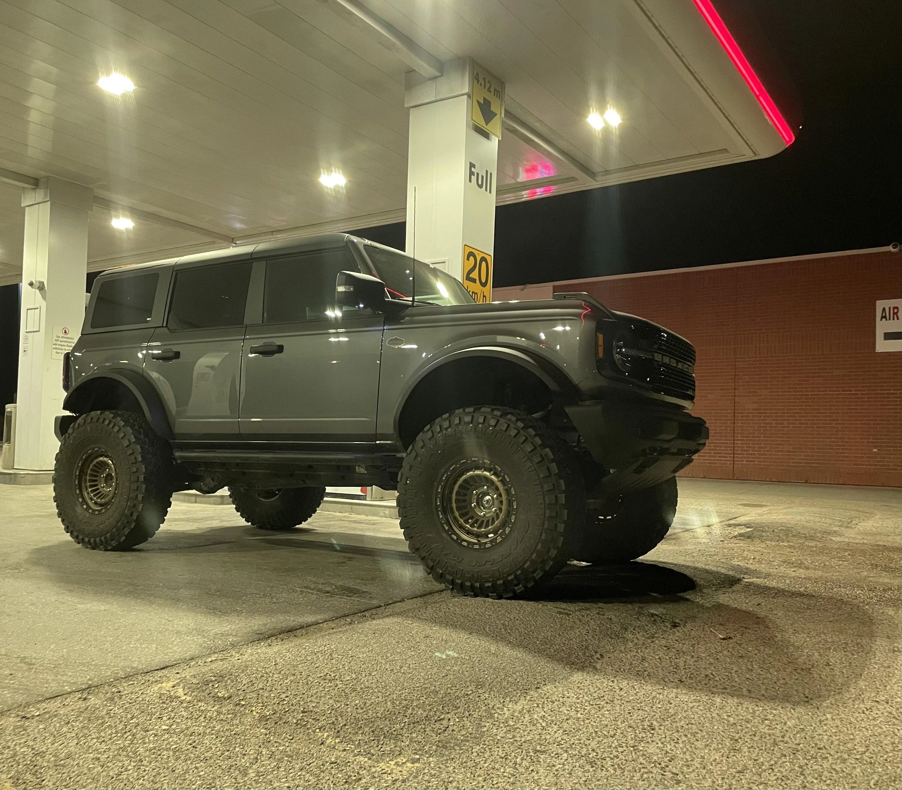

Let’s see this rig with 40s !! That’s a LOT of trimming to do with 40s
Cgybronc
Jan 23, 2023
87
Canada
'20 F350 9"-38s/'15 F350 8"-37s/'10 GT500"stock"
I had it posted before.
