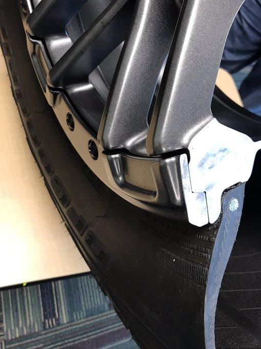

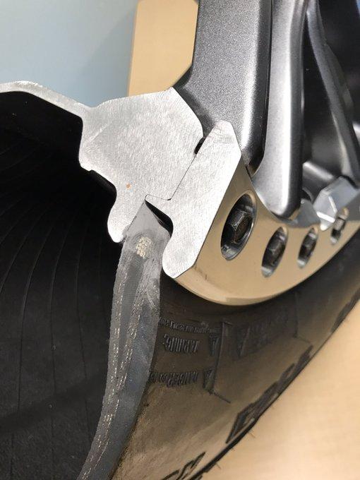

I found these pictures awhile back and seems to show the difference pretty well.
Ford Bronco Someone please explain how the wheels work? Sasquatch Rim cutaway
Ford Bronco Someone please explain how the wheels work? Bead lock rim cutaway
