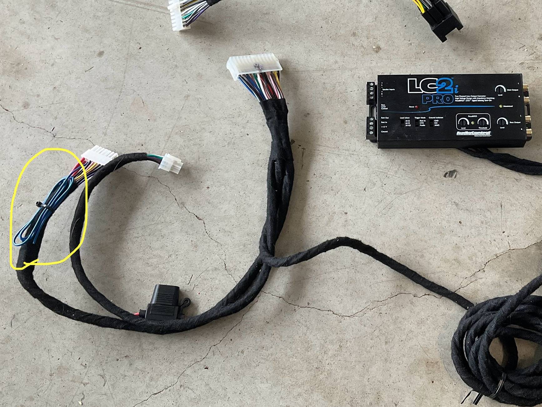

About #2… would that be this blue wire from the plug and play kit? Found it odd to be there when it wasn’t used by the 200.4.
Ford Bronco Some Audio Questions - Bronco New Owner IMG_7270
And the LC2i has Remote In and Remote Out connections. That blue wire would go into the LC2i and then out to a 500.1?
There is some flexibility, but yeah.
Most aftermarket audio equipment allow you to use one of two methods:
  1. Signal sensing. When the amplifier sees an audio signal it'll turn the amplifier on. If it doesn't see a signal for XX number of seconds, it'll turn the amplifier off.
  2. Remote turn-on. When the amplifier sees a voltage (typically 12 volts) on the remote line it'll turn that amplifier on. If it doesn't see a voltage, it'll turn the amplifier off.
(2) is always preferred over (1), but on modern car audio systems... (2) is not always possible. The plug-n-play kit includes that remote turn-on wire in case you can and want to use (2).
Personally, I use both in my setup. The 200.4 uses signal sensing, and then I use the remote line output on the 200.4 to feed my 500.1 in the back for the subwoofer. So effectively the 200.4 is using (1), and the 500.1 is using (2). Therefore whenever the 200.4 turns on the 500.1 will also turn on.
The 2023+ Bronco uses (1) for its own subwoofer amplifier, but the voltage is 5 volts rather than 12 volts.
