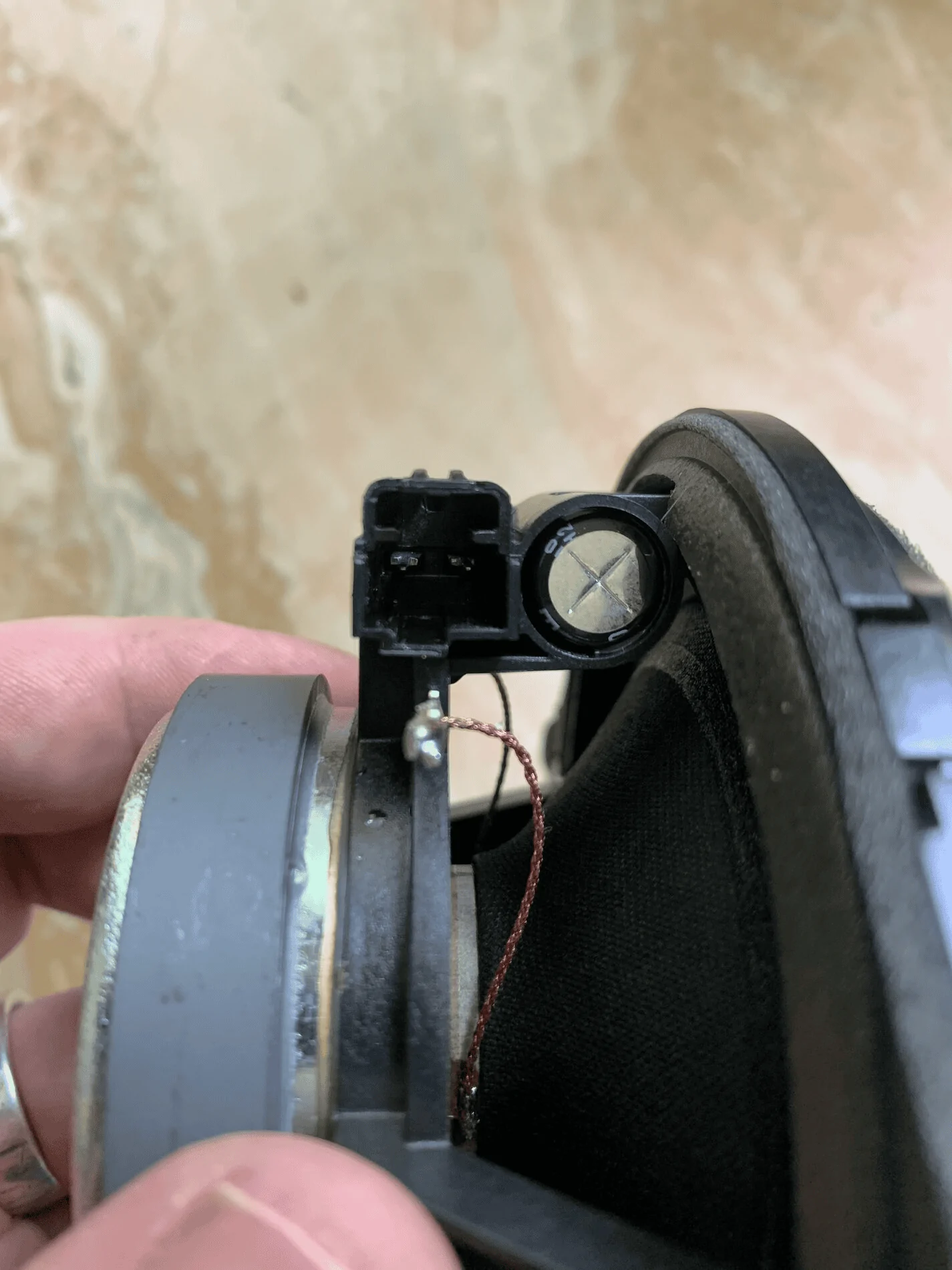

Riddle me this...As a former Audio engineer manager, doesn't Ford have a crossover with the dash panel speakers and kick panel speakers eliminating the need for bass blockers?
The 4" Ford speaker has bass blocker cap integrated into the speaker assembly. Same story with the rear 4" Ford speakers. If you upgrade the Ford dash speakers, you will need to buy separate bass blockers for them since aftermarket speakers do not include them. The 6 1/2 inch kickpanel Ford speakers do not need bass blockers installed, and Ford of course did not provide them. Does this help?

So thanks to those on this forum I think I fixed my problem. Went back to the drawing board and decided to put the stock 6.5s back in, and throw two bass blockers on the dash 4s (still Infinity Reference speakers). In combination with the swap back to stock on 6.5s it sounds substantially better and I'm very pleased.
For whatever reason the 6.5 Infinity Reference in the kick panel (in my installation, at least) just sounded too flat and for my style of music it just felt like a major disappointment. The 4s are wonderful and even better with the bass blockers up front (none on rear pods), so if you are looking to make an improvement it genuinely sounds fantastic. You have to realize it wont sound like a true premium system but for a convertible truck that can be hosed down inside it sounds pretty crisp and loud enough for my tastes.

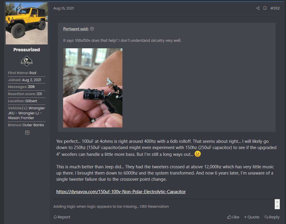

First order high pass filter...if you can do the math; you can improve SQ with higher grade capacitors.
Ok wait... I'll admit I haven't been able to totally follow (and understand) all the technical threads about the stereo.
However, I know a few of them have said that you can't tap into the rear speaker wires because there's no base being sent to them. So people are recommending you tap off the kick panel speakers. In addition, the JBL soundbar thread sounds like the head unit has to be reprogrammed to send the full frequencies to the bar.
My point being, if the base blockers are in the speakers, and you replace the speakers then shouldn't the base come back? (Talking about replacing the rear speakers with a better quality one like people have been doing with the dash)

Great question! Unfortunately due to how the packaging of the rear speakers have been done on the Bronco, there is not enough volume in the speaker enclosures to enable any speaker to deliver much bass at all. The rear speaker boxes are so small that significant low bass simply cannot be delivered. And if you deliver the full frequency range to any speaker in such a small enclosure, it will simply distort at even modest volume. That's why Ford programmed the Sync 4 head unit to cut off low frequencies to the rear speakers. And I found this out the hard way when I replaced the front 4 inch speakers without bass blockers. The speakers are also in a very small enclosure and the baffling will not allow much bass to be generated. Once I fixed this program with bass blockers the system sounded much more balanced and less distorted. I hope this helps.
