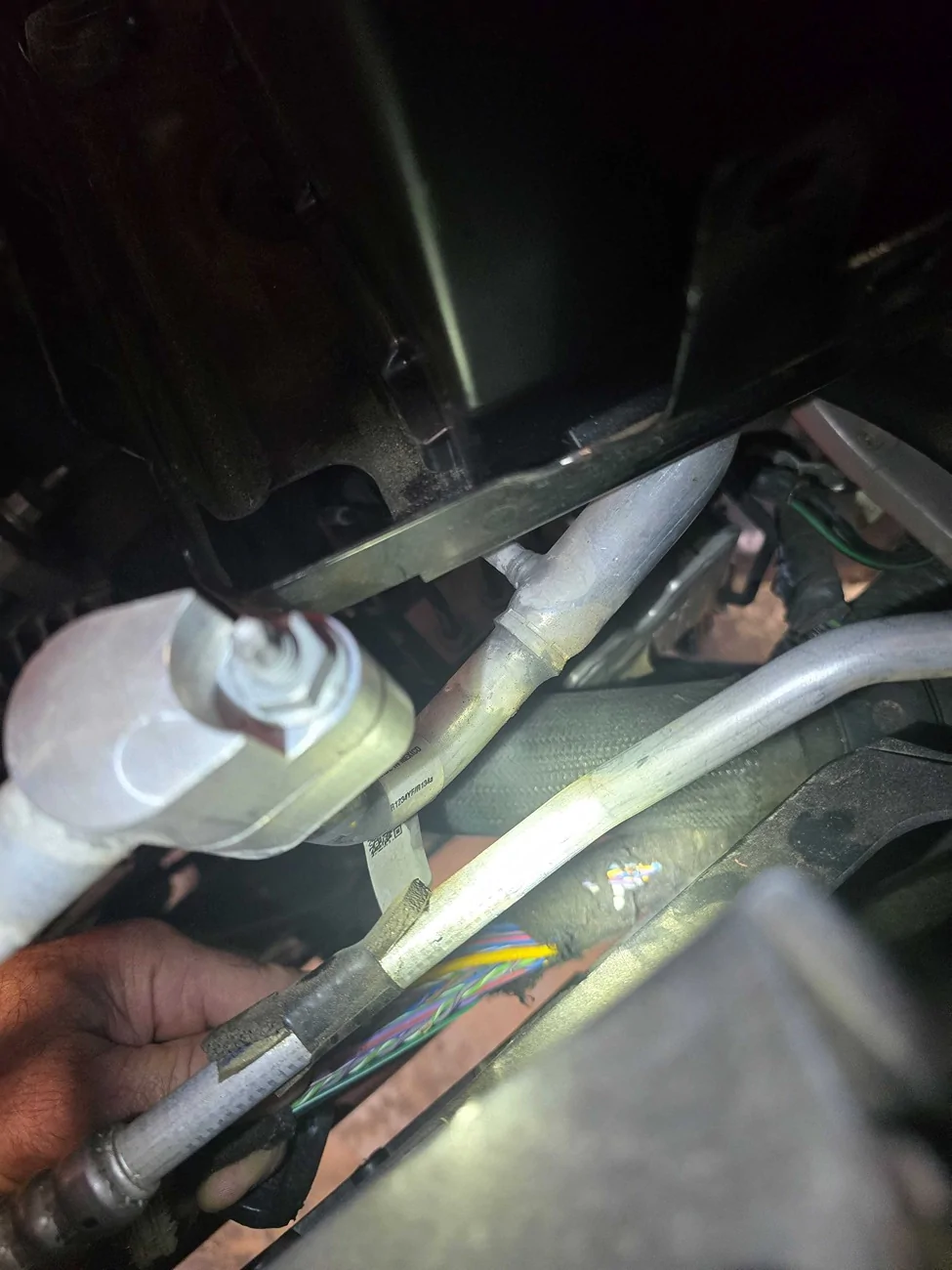

Beautiful sunny day, my 22 Sasquach was in the back yard with the top down. I was inside the house, and realized that it had started raining, pretty hard. Ran outside and pushed up the top, spilling some of the puddled water inside the car (it was already plenty wet in there). Tried to start it up to move it under cover, and it would not turn over.
Here are the messages I get:
Steering Assist Fault Service Required
Service Vehicle Soon
Full Accessory Power Active
Park Brake Fault Service Now
Pre-Collision Assist Not Available
Service Advance Track
I have pulled the battery and charged it to 100% and let it dry out for four days, but nothing is different today. Before I bite the bullet and have it towed into the dealership, I figured I would check with the group and see if there is any advice you might have.
UPDATE: So after a month, I finally have my Bronco back. It turns out that there was rodent damage on a couple of the wiring harnesses. Replacing them brought it back to life. I can't believe that it was coincidental with the water, so I would guess the water got to the damaged wiring and caused a short.
So happy that the wiring industry has gone to a soy based product for the wire coating.
I am glad the mystery is solved, and I can let the world know to watch out for this if you run into a similar situation yourselves.
