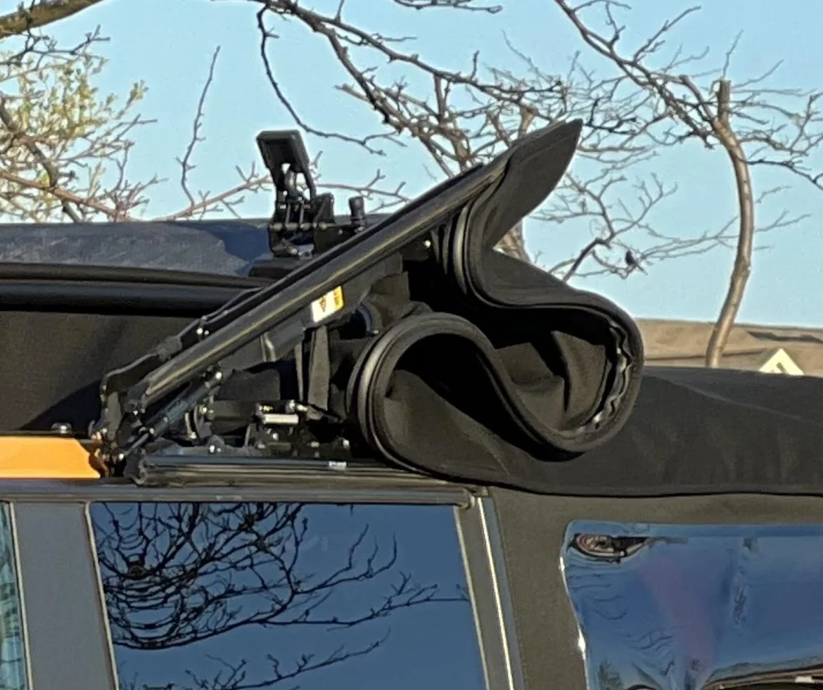

This is exactly what I do as well as someone had previously posted about the issue. A quick thing to look for is that in the half back position, the canvas should be creating an S shape
Yes! The “S” shape is the perfect way to explain how it should look.

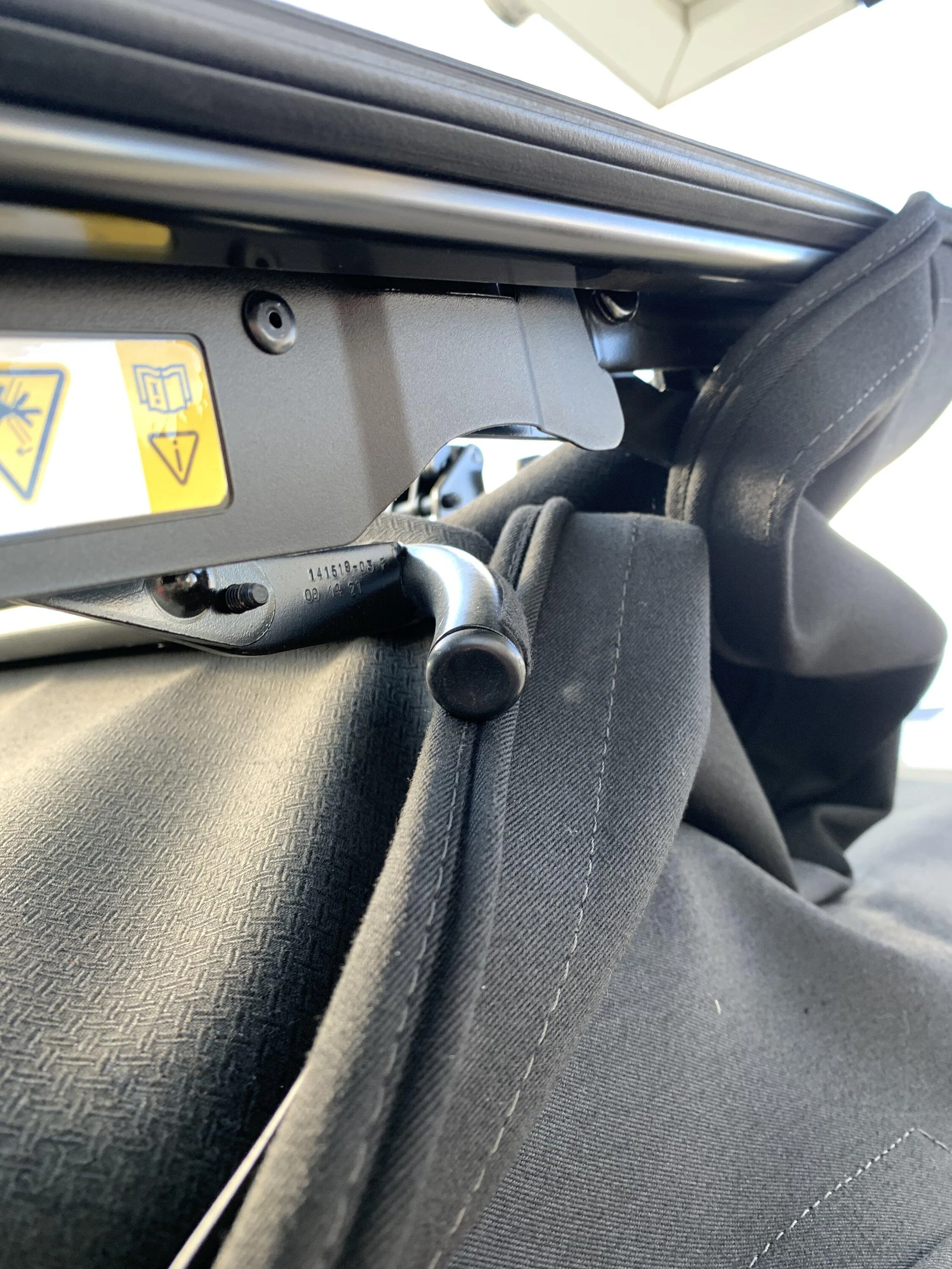

Can you post a picture of what the readjustment looks like? I have read about an S shape but am more visual so a picture would help.
AuroraMike
Aug 11, 2021
Chicago
Bronco Badlands 2.7, SAS

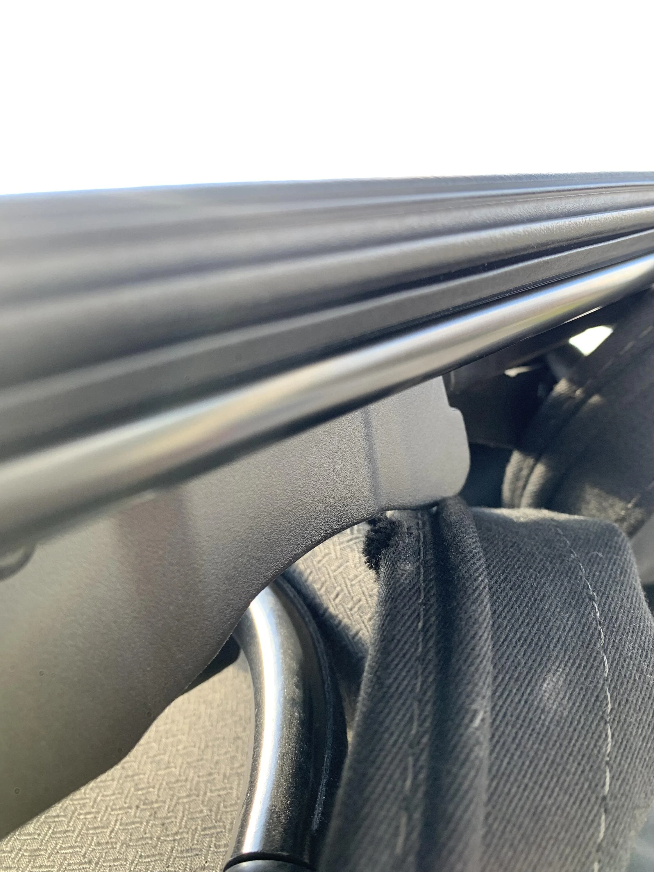

Just found these tears on mine. I ride in position #1 alot. Were you able to get it resolved? @EKOBX
EKOBX
Erik
Dec 4, 2021
114
121
SMF
I need to call my dealer and see the status on the replacement top. Ford approved a new top under warranty but the dealer told me it was on back order “for at least a month.” I’ve been on vacation most of the summer so haven’t made the time to connect with the dealer.

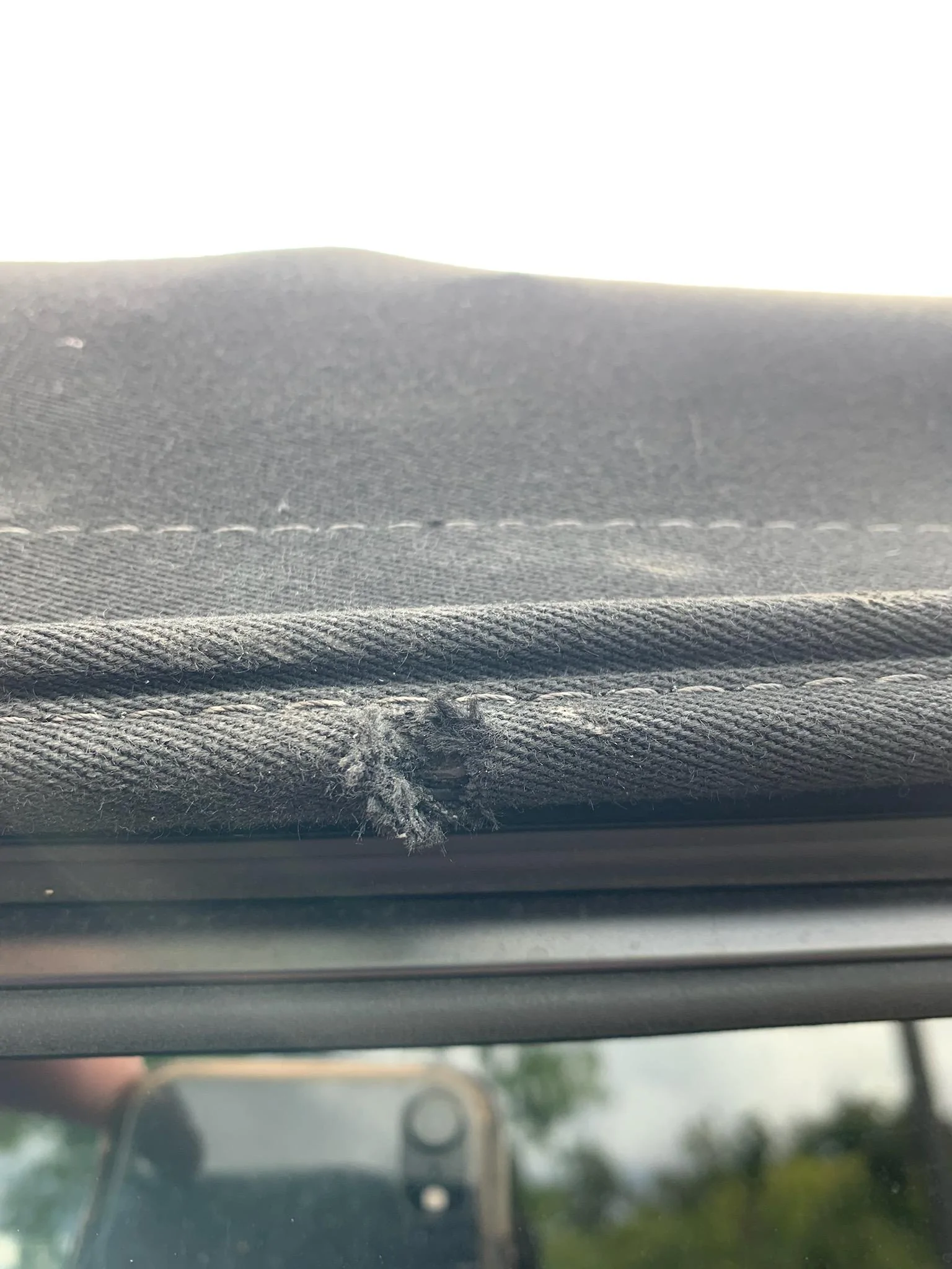

I think my soft top is experiencing the same issue, not 100% sure though. Noticed it this afternoon when I was cleaning the vehicle.
Ford Bronco Soft top tearing IMG_3998
zjc26138
Zach
Nov 23, 2021
374
789
Steubenville, Ohio
2021 Bronco Sport BB
So first photo is how it goes down which caused the tearing I think. Second photo is what I moved it to. Which I think is correct.
This on the drivers side. Passenger side is fine.
Ford Bronco Soft top tearing 4C93FD9B-1E57-4011-BCD9-A959C9993160
Ford Bronco Soft top tearing 93A3D301-8F98-458E-8913-D28C8C746B89
RaceRedOBX
Brock
Jan 17, 2022
134
165
Louisiana
2017 F-150
Mine has had the same issue. Small tear on the drivers side that I noticed after a week "only the drivers side". I started pulling it back to the "s-position" with no issue, but I do have a small tear on the soft top now..... Was this resolved under warranty??
