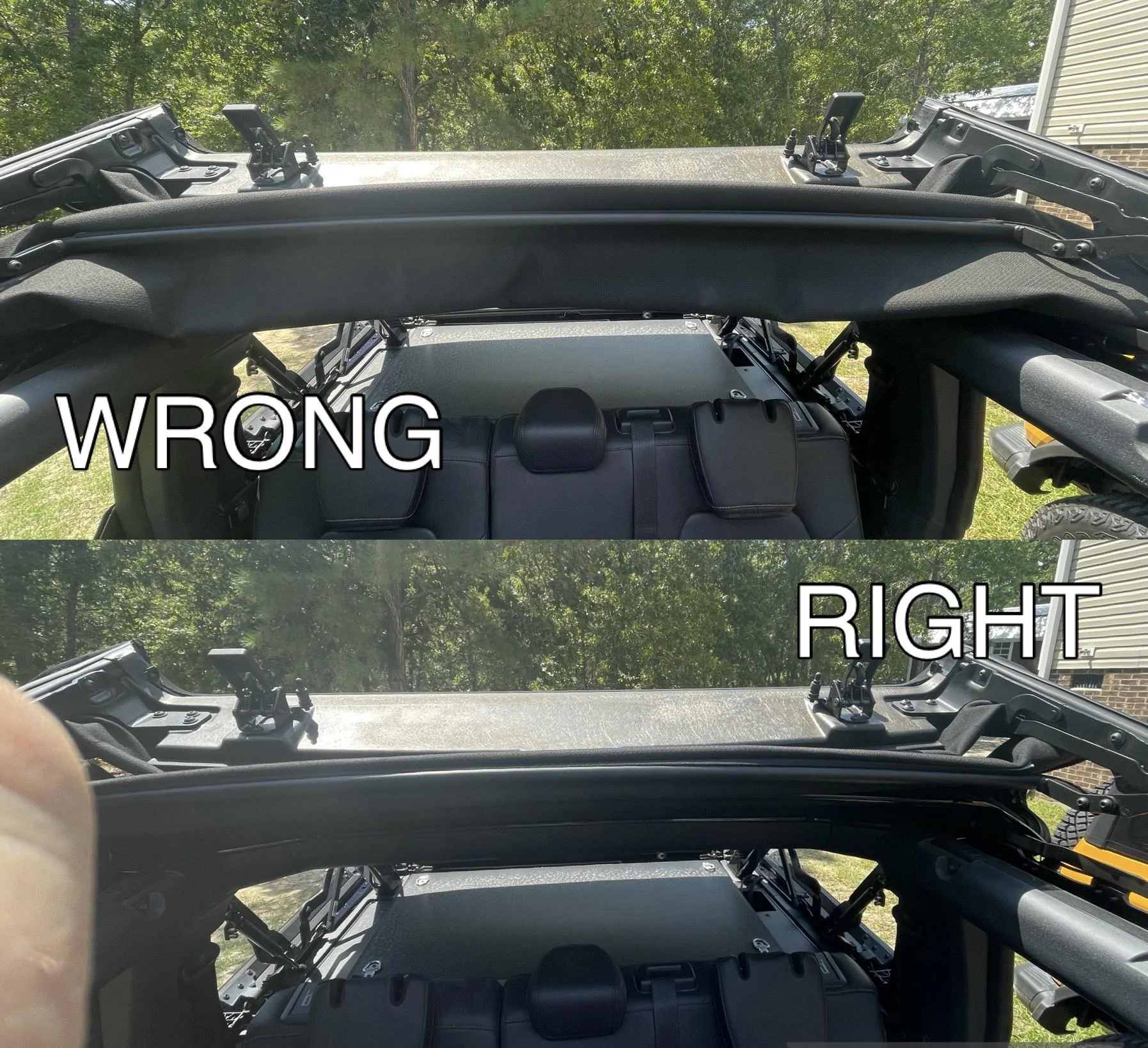

I think this happens because you may be just flipping the top back and not tucking it in like I do. Also takes the forehead slap away from back seat passengers.
