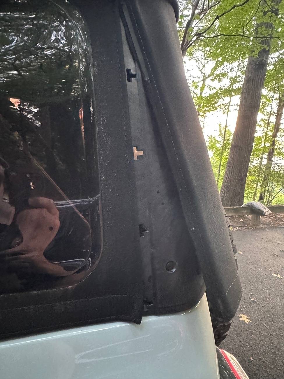

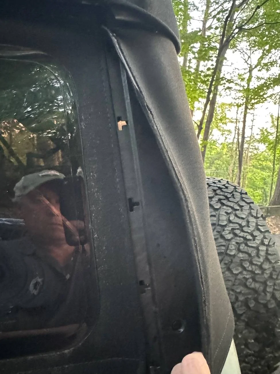

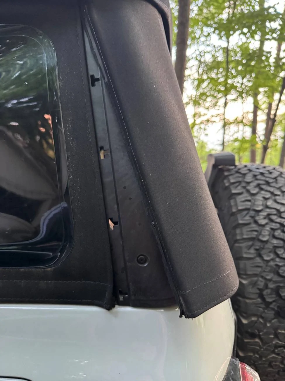

So the leftmost edge of rear panel detached from the plastic corner piece. See photos. Any idea how it was attached or adhered? Any suggestions for how to fix? Thanks in advance.

Appears yours is held by clips that broke off. Ford placed rivets(TSB)right where the clips would go. I can get you a pic tonight. Easy fix

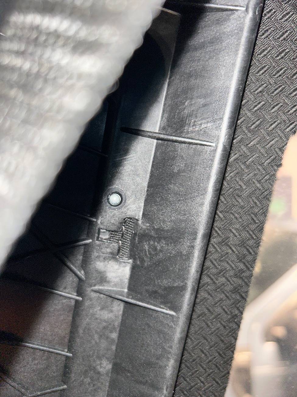

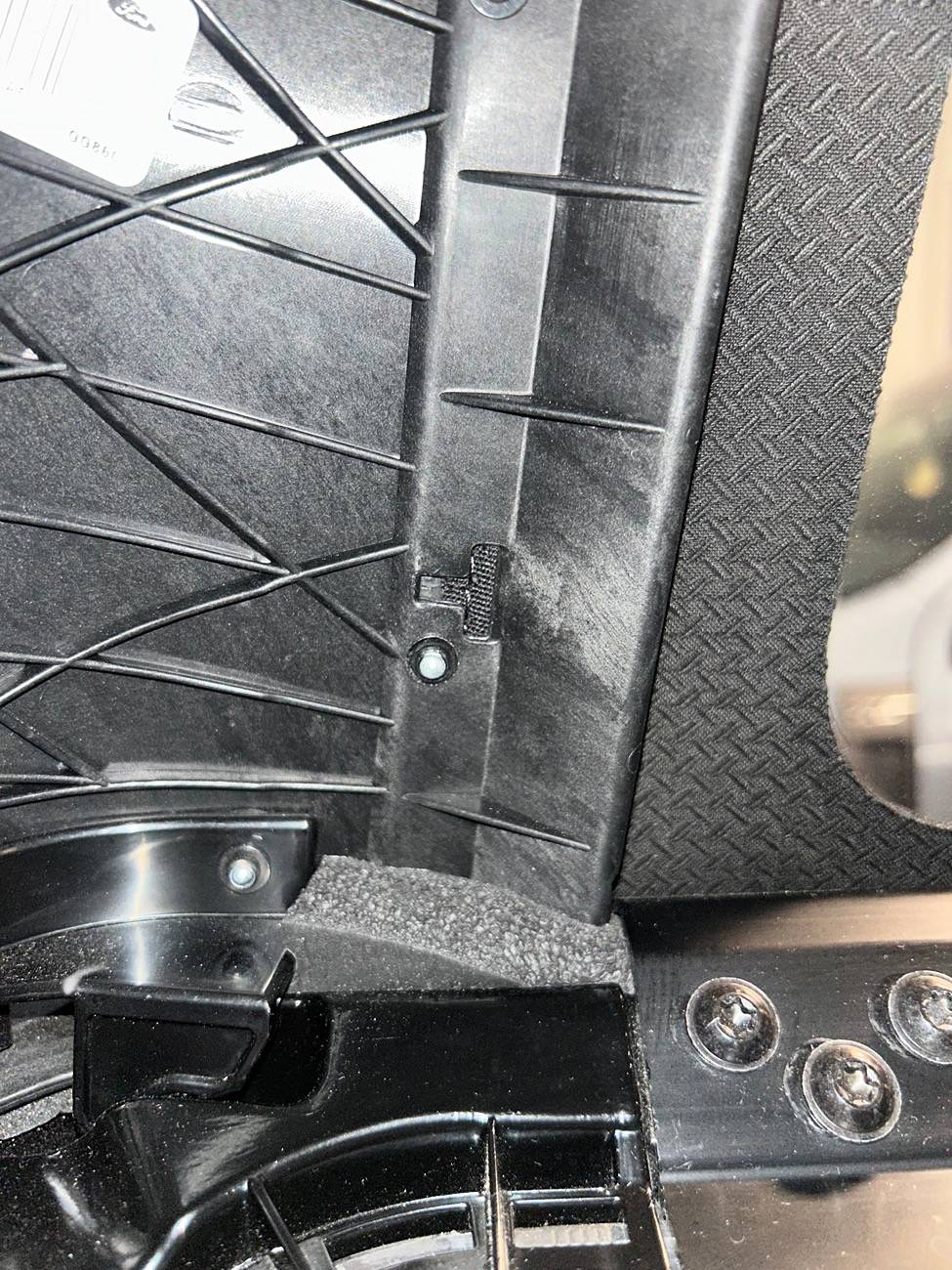

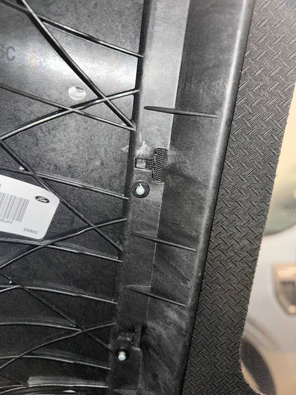

All 3 locations. Might be 4 but you get the idea.

How? Did you try to separate them? Or did it happen without help?

Yep, those are not meant to be separated. Ever. You just pop the whole corner off and leave it attached to rear window. Stuff they should tell you early on.
