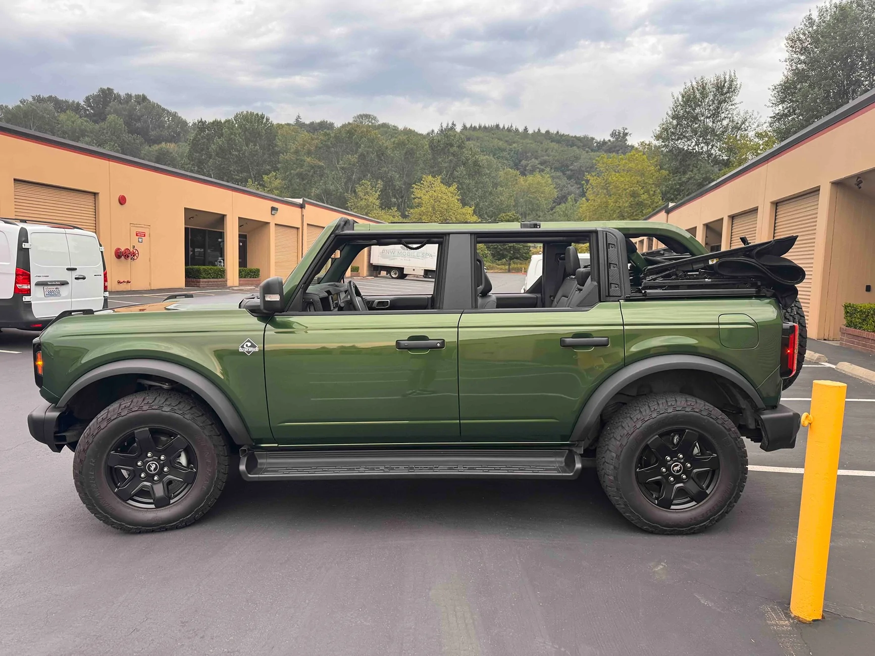

Thanks for this info ironmann. Was tremendously helpful, as the facebook marketplace soft tops I saw listed did NOT include everything.
My soft top is now installed!
