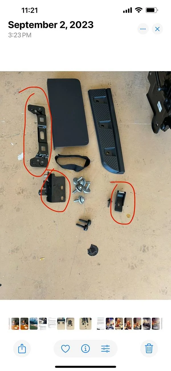

As soft top shipped on pallet in Bronco. Are any of the parts already on the Bronco or are all in the packaging/pallet.
Is it possible some parts are preinstalled even though vehicle shipped w/hard top installed from factory. If Bronco was shipped as hard top only, not dual. Would any parts be required not on the pallet.

Yup.
2 Side brackets in the cargo area.
2 Brackets on the top roll bars.
2 Lock down brackets by the tailgate door.
There is a thread with pictures of those items.

Thanks I actually know all the parts. Just not how they are shipped. Thank you. These circled would already be in the Bronco? X2 of each. Left and right side.
Yup those are the ones already attached to the Bronco when it come with the soft top or both tops
edit: also keep in mind, the plastic cover plates for the cargo area are slightly different, there is a slot for the bracket for soft top, the hard top doesn't have the slit. You can use the plastic cover with the slit for the hard top, but you can't use the non slit plastic cover for the soft top.

The rear lid latch (circled on the far right) - Ford had not too long ago jacked the price of those up to something ungodly - like $1,200 or something, for a small plastic latch. I hope they have fixed it, but in the event they haven't Mountains2Metal sells an all-metal replacement for a reasonable price.
Just an FYI if you end up needing to procure some of these parts.

Are there separate C-Channels that need to be purchased to hold the bottom of the rear windows and trunk window? Or are they already attached to the OEM soft top? I have the column C-channels. I am doing a hard top to soft top conversion.
All frame work is part of the soft top
